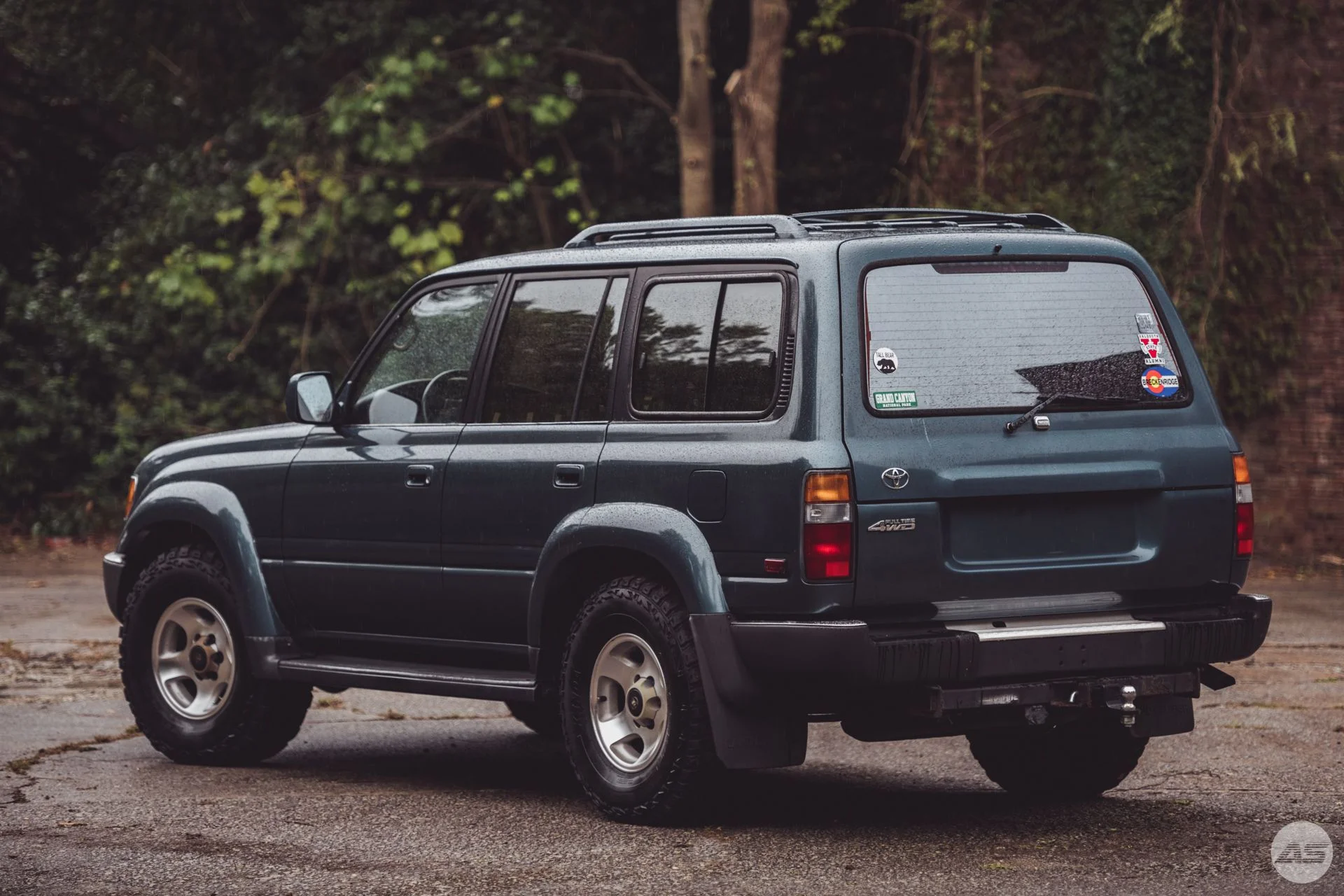

**Pictures taken by @andycarterphotography. Check him out on FB and Instagram. Photographs Georgia, TN, SC***

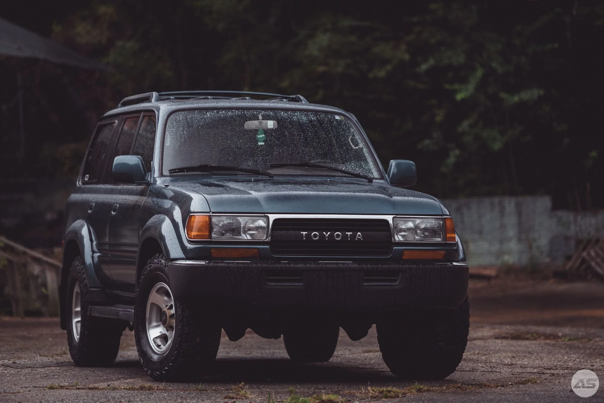

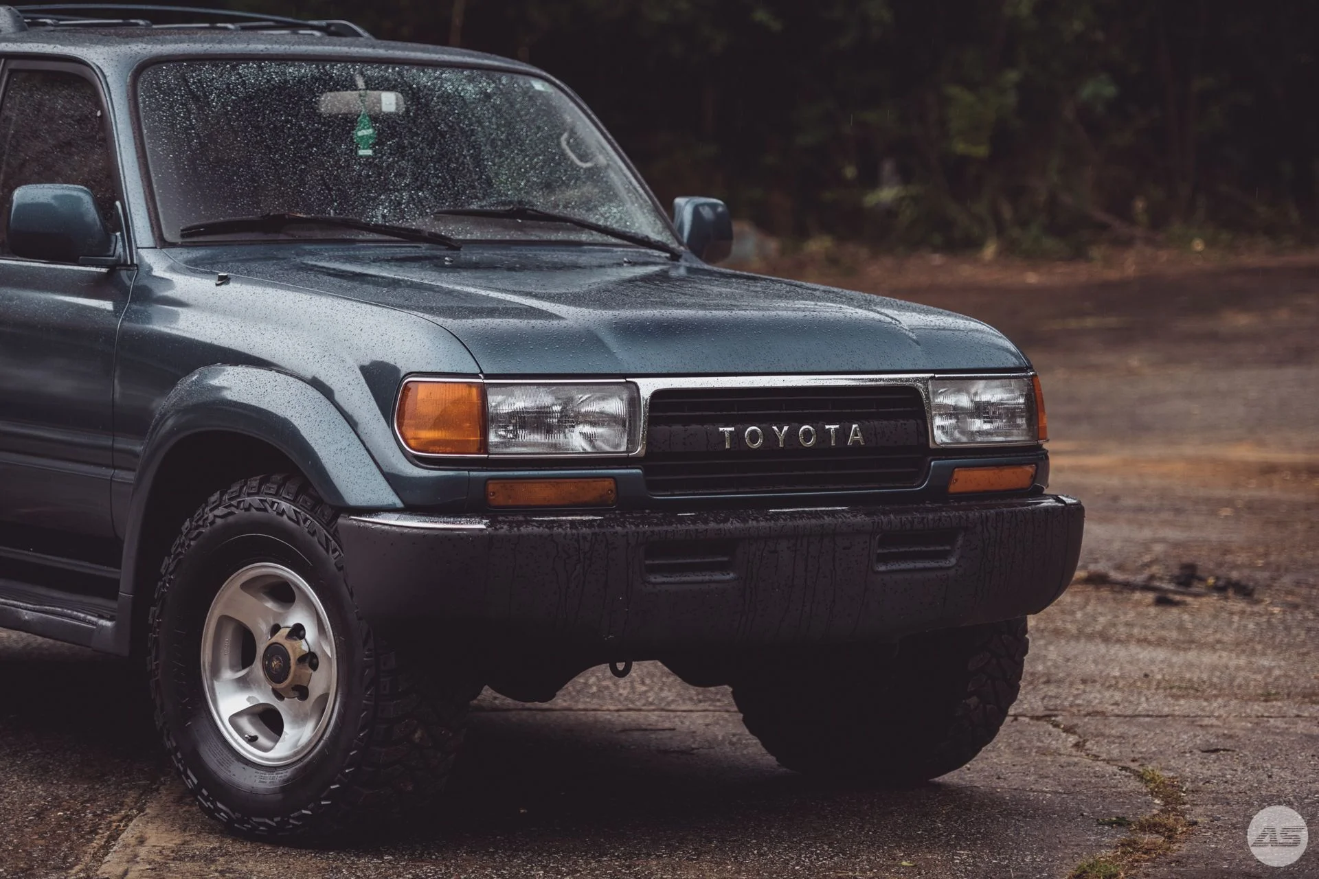

looks nice; great photos
Who took the pics? Ok kidding
Truck looks great. Almost to nice rubber coat it. Is that 6M1. If so I can understand ;) but still appears to be in good shape (for cloudy rainy pics)
Welcome. And enjoy the build whichever direction you go. Check out the local clubhouses as well. Old north state cruisers. Upstate cruisers. Georgia cruisers.
Lol gotta give credit where credit is due but thank you for the kind words.
Exterior color isn’t an original Toyota color and is fairly scratched up.. Clear coat is great and there’s not much fading. Still VERY undecided on paint color.
