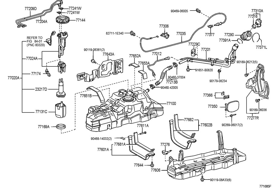

Curious if anyone knows the part number, and how tough it was to swap this. Doesn't sound that bad, maybe a little dirty that's all, I just want to order the right part.
this appears to be the exploded view
So which part of the filler neck has a lining in it? 77201 or 77213B?
No idea, that is what I was hoping to find out.

Well shoot, I was hoping to fix this tonight but alas no. I replaced part 77213-35370 which I purchased form Lexus Parts Hub.. $55 shipped. My thought was the inside of the tube had degraded and was clogged, and was hoping to find evidence of that. But no, what I found was what appears to be a perfectly good tube, and with the new tube installed my gas is just as slow as before to pour in.

What I did notice, is the tube has a pretty good kink in it, on the side away from the gas tank. it gets this because to install it, one has to bend the tube somewhat severely. So when I installed the tube, I actually gave it a kink, which matches the kink that the old one had before. So I'm wondering if some of you other guys also see a kink up there, both folks who also have this issue as well as folks who don't have this issue.. I tried to work the tube back on the other pipe as much as I could but couldn't really stretch it.. but just wondering if that kink is enough to cause a barrier to the gas flowing into the tank freely.
