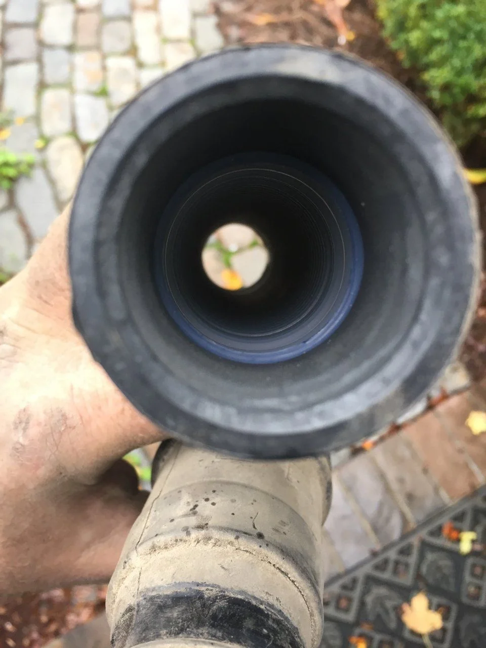

Finally some searching turned up someone mentioned a delaminated fuel filler hose (foot long rubber hose from filler pipe connected to tank). The hose has a plastic insert somehow welded to the rubber.
I ordered one from the dealer for $40. Yesterday put the rear end on stands, got under there and removed three bolts holding gas filler pipe in place (note that they are one time use), was able to remove the two clamps on the hose and pull it off the tank. The tank end was blind, did not lower the tank. Just enough room to fit my hand and a small socket.
Here's what I found, compared to the new hose
The plastic inside the rubber deformed, almost closing the hose, so fuel could not come in a full volume.
Not a bad DIY, luckily the clamps came off easily. I replaced with new ones from the dealer.

Similar situation - I've gotten mad at gas stations that took so long to fill my truck, while other cars had no issues. I assumed it was a problem with the pump. Problem kept getting worse though, and certain stations refused to fill at all, saying my tank was full. You can see the gas coming back up the filler tube. Only a slow trickle would work.
Numerous google searches found one instance of a TLC owner talking about the filler hose being deformed. He said dropping the tank was necessary to replace, which luckily I didn't need to do. Wasn't sure if all the hoses would have enough slack to come down without disconnecting.
My point of posting is to put it out there for all to see, and hopefully right key words to let a search pick it up. It's got to be happening to others.

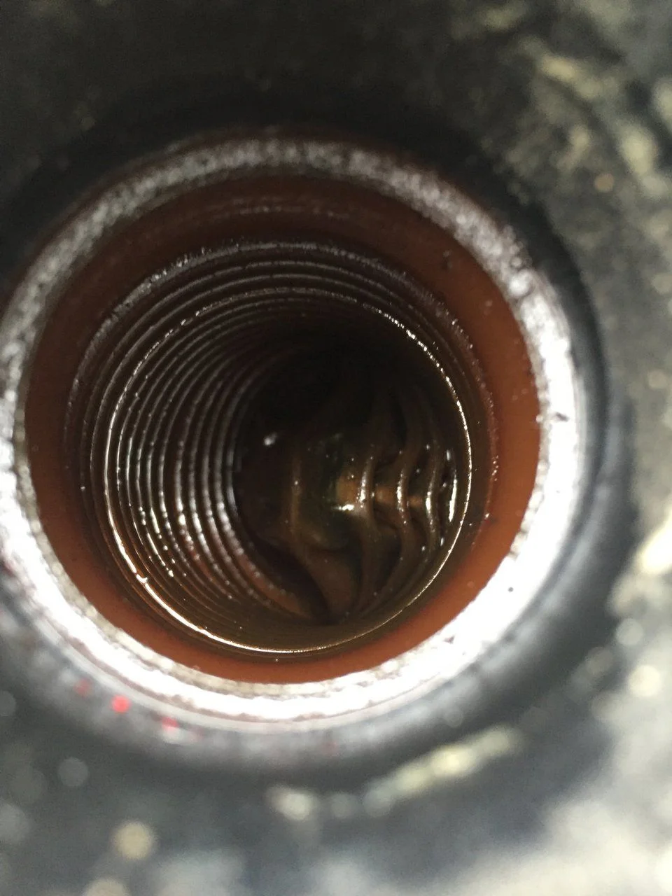

I wanted to bring this thread back from the dead and say thank you to OP. You saved me a lot of time. I had the same issue filling the gas tank. A slow trickle is all that could be put in without it backing up and spilling out. Found this thread and got lucky.
The job was very easy with the right tools (10mm socket and eye protection) and was just a matter of loosening two hose clamps and feeling around. Getting the new one on took some muscle and loosening the clamps quite a bit more than on the old hose.
Thank you OP!!

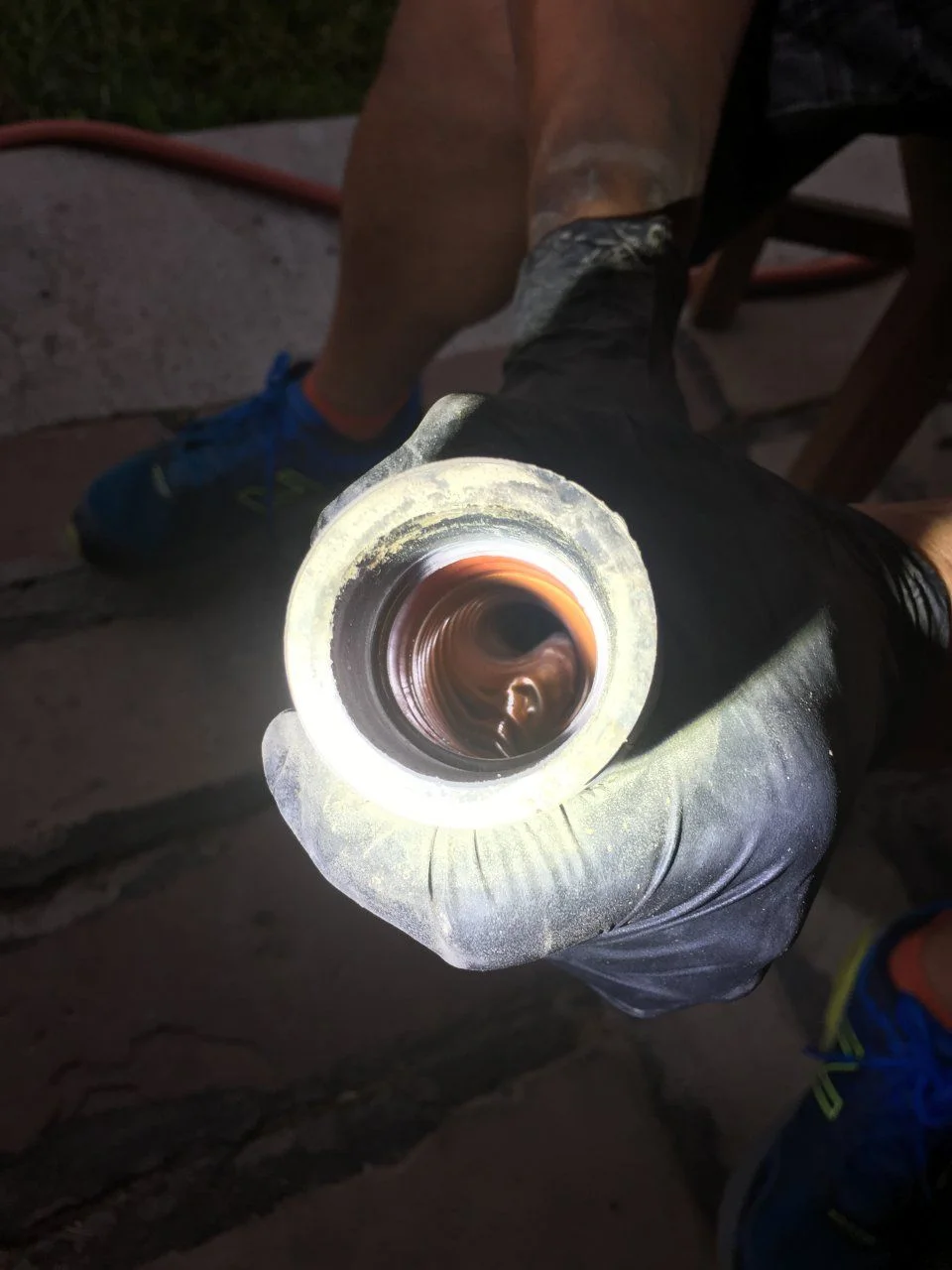

I think this part swap is in my future... Taking me 15mins to fill the tank and have to barely hold the trigger. Just inspected the part in question and it looks to be slightly kinked at the bend. 240k on the clock.

After 35 mins to fill the tank on my trip back from expo, it was time to tackle this. Yep, same problem as @lstamatis!
Here's what the new one looks like.
Took about an hour. Filled 22 gals in about 8 mins! Ahhh, that's better!
