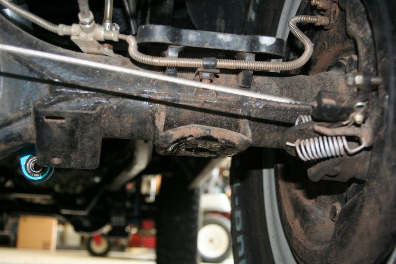

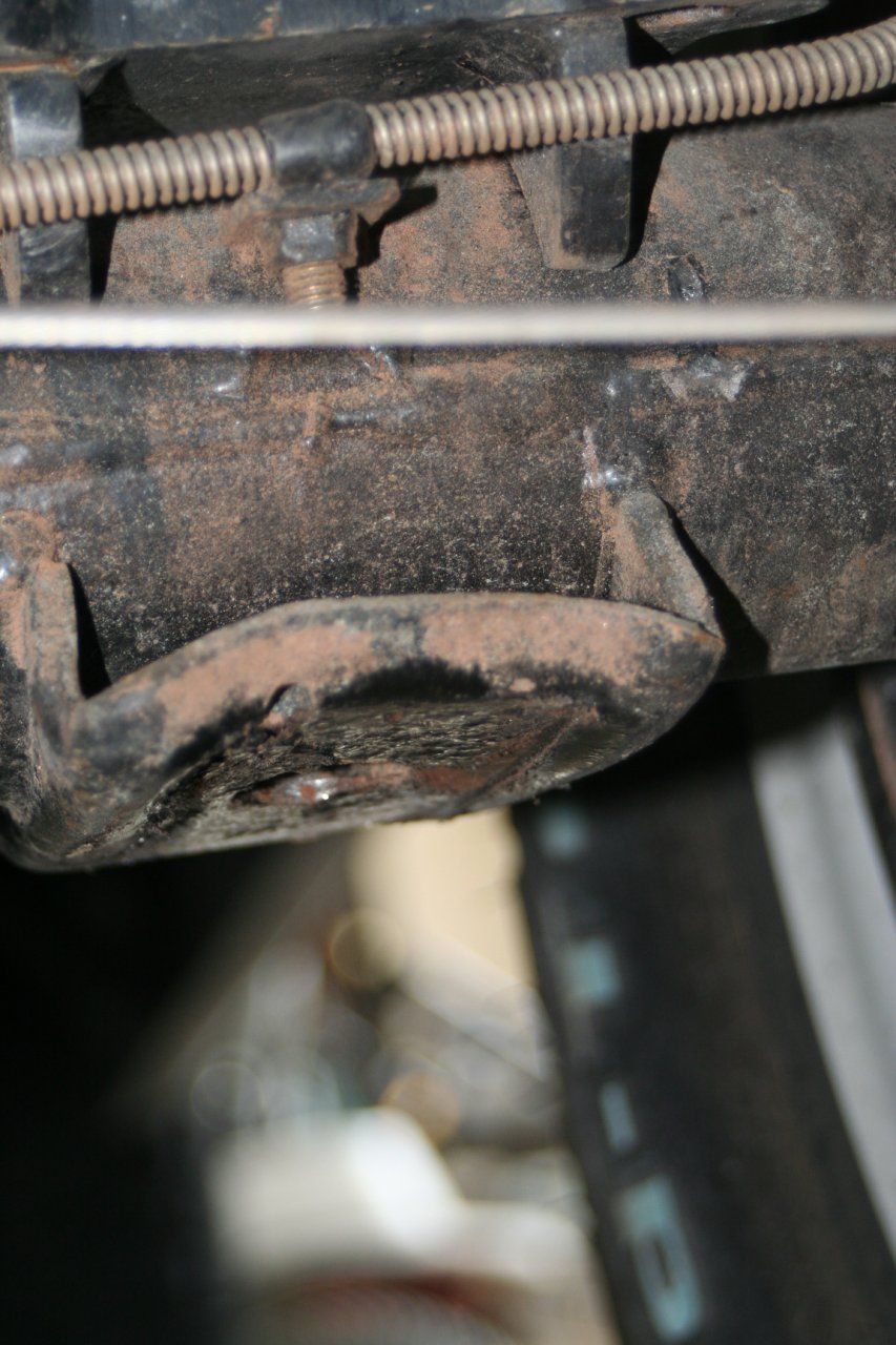

I took the rear spring packs in to get more leaves and found the spring perches have fallen victim to my over zealous tightening to cure the SNS ( stretchy nut syndrome ). So, now I need some opinions before pulling the axle housing out, cutting off the old perches and welding on new. Any better ideas? Heat and bend back, etc.

I blame J Mack, he lent me his extra long ratchet. :) Real problem was those damn shims. They were just a tad smaller than the perch. You can see the imprint in the perch.
You're right, cut them off and start over.
Careful when you weld in the new ones... It's amazing how much the housing bows with the heat from a good solid weld...
Having been down the road of welding in new perches, and developing a bow that ate the axle bearings, I'd weld new perches in and straighten the housing.
IMHO welding on a factory housing without warping it to some degree would be nearly impossible, you can do some pre and post heating to minimize but then you cook the oil on the inside creating other issues.
I would repair the existing perch with minimal heat and reinstall this rear end, if I remember correctly you were telling me that you wanted to build a full float rear and that would be the time to address all the issues at the same time with a fresh housing.
Good luck!!
Exactly. If you guys think it will warp, then I'm not going through all that to just replace it later with the FF. At the least, I should try to heat and bend back first before cutting off.
Hey J Mack, first thing I did after Moab was buy a long handle ratchet like yours, really like that thing!
If both sides are warped I would heat them and try to straighten them trying my best to keep the housing reasonably cool. If you can’t get them as straight (flat) as you want weld a ¼” plate to the bottoms trying to keep the plates as level as possible and run it until you get time to build your new FF rear.
