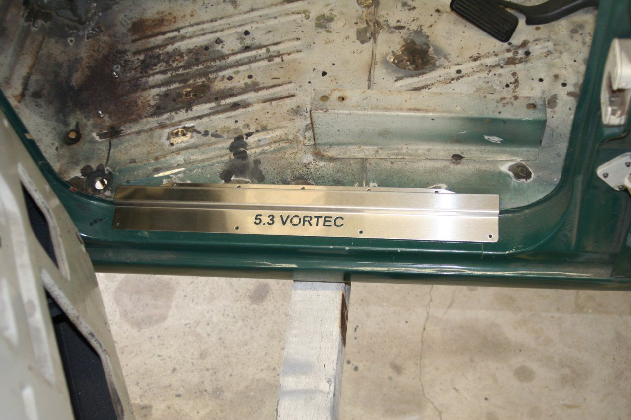

Hey Jason,
Those pictures don't do the plates justice. They are really nice stainless pieces. I'm waiting to get the wiring done and then mount the plates.
Bob's your guy, he knows his stuff.
Hey Jason,
Those pictures don't the plates justice. They are really nice stainless pieces. I'm waiting to get the wiring done and then mount the plates.
