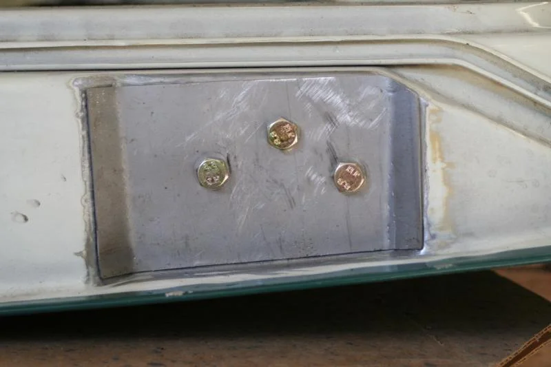

Jumped around again and started to repair the door cracks. Before I start to weld, I need some opinions on if this plate will work. I need to put in some rosette holes, but I think it will work.
Question: Will I need to space out the other hinge, the same amount, in order to keep it square.
I used 16 gauge sheet metal, hope it's strong enough.

That's kind of what I did. I drilled a few holes on the interior of the plate to create an area to weld it to the underlying metal (like a spot weld). I'm not sure if it's necessary but ....

You did right with those holes. They will give that whole plate more strength. I didn't post a picture, but I put five holes in mine, besides the hinges bolt holes.

Here's how it looks after welding. I didn't want to get too crazy with the heat.
About the thickness of the plate, instead of milling the bottom hinge, would I be better off adding a plate to the top hinge. That way I'd have all the hinges beefed up and sitting square in the frame.
Just do all of them and be done with it. What's everybody think?
Is the effort worth it?
Here's how it looks after welding. I didn't want to get too crazy with the heat. About the thickness of the plate, instead of milling the bottom hinge, would I be better off adding a plate to the top hinge. That way I'd have all the hinges beefed up and sitting square in the frame. Just do all of them and be done with it. What's everybody think? Is the effort worth it?
Yes it is worth it! Aligning your hinge pins on the same axis will make your doors smoother swinging and you won't have to worry about weather or not they will align. Plus you have them apart already.

This could be done on all the hinge lands and be adjusted via the pillar side bolt/alignment hole slop. you may loose a bit of overall adjustability in the doors by the thickness of the plates essentially pushing each door back a 1/16" when closed, and therefore leaving less forward adjustability>prolly no BIG DEAL;). Plus you get the beefed hinge pads...NOW, I still don't see how the pivot point changes in relation to the door or the frame if the pad of the hinge were milled for the thickness of the re-enforcement at the door side. If this were the only door requiring repair, I'd think about the shave on the hinge; if just one more hinge MIGHT need repair, I'd plate all the hinge lands and adjust at the pillar side...clear as mud? YMMV, just my 2 bits
If I replate all hinge pads and run into an alignment problem, then shave the hinges down. If no problems, all's good and I have the beefed pads all around. Done deal.
I agree with Napster, worthy of the effort.

Edit: When welding up the pad, I put a wet rag on the inside of the door and had no problems with fire. I saved the LSkin!

Update on the doors. Almost done with the reinforcement of the hinge pad area. I'm doing all the doors, as I found two bad ones.
