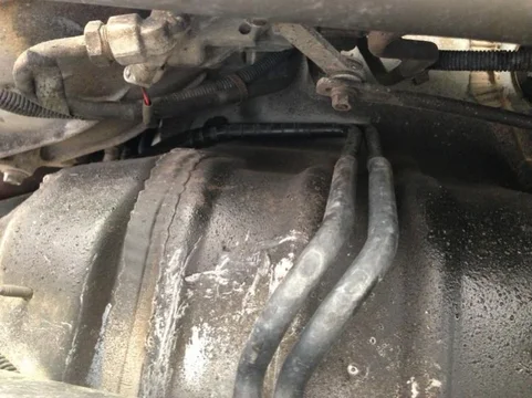

Running lines external the tub was just a thought after crawling around on the 80 to measure the heater. I dislike the overall design of the 80s hosing for the rear heater, since it can fail....but most at 18-19 years, but my thinking was eliminating the additional radiant heat source in cab, plus eliminating the hoses, allowing for a form fitting flooring.

Chris, you could run the heater lines under the floor, but in the winter the extra heat off the hoses is welcomed. Plus two holes in the floor, that need to be sealed good.

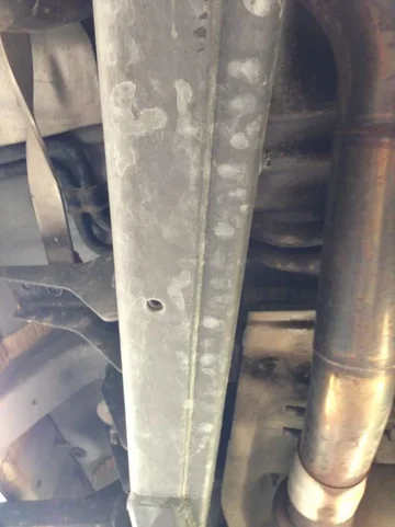

If I can't, will address at that time, but know the 60/80 heater will fit perfectly in the footprint of independent buckets, there's perfect placement for heat shielded (to ensure longevity) heater lines on the outside of cab, and the 80 floor pan grommet (??) for lines to pads through will work.

If a guy wanted to, he could solder some copper lines for the underneath heater lines and use screw on bulk head fittings, for a leak free connection. Now you got me thinking, it would keep the footwell clean.
