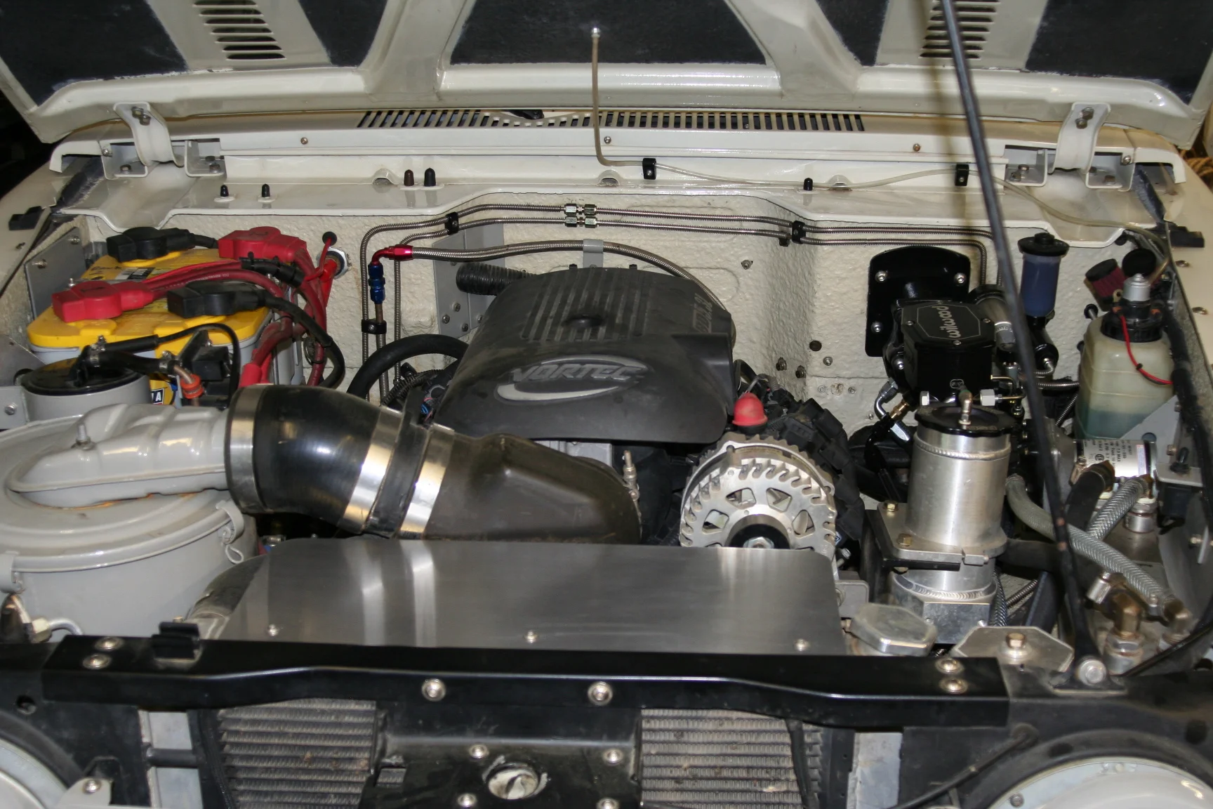

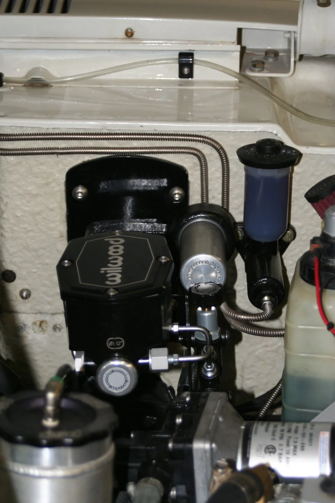

Hydroboost is finally in and plumbed. I wound up making new brake lines and using the new Eastwood flare tool. It's faster than the hand held Mastercool tool I have, but if you have to make a flare on the vehicle you're better off with the Mastercool tool. Everything fits good with the new clutch master, which is actually a single circuit brake master and the hydroboost. I'm going to grab a grandson and teach him brake bleeding, then mount the new tires. It's getting a little close to the trip for me feeling good about this.

So Clean!!
Looks great! If it's anything like the difference I experienced after installing mine, you'll be very pleased.
Thanks guys for checking in. Fun project for sure, but It dragged on too long. We have a lot of new additions that haven't been road tested yet.
