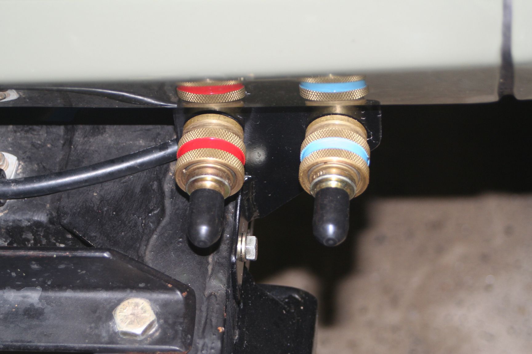

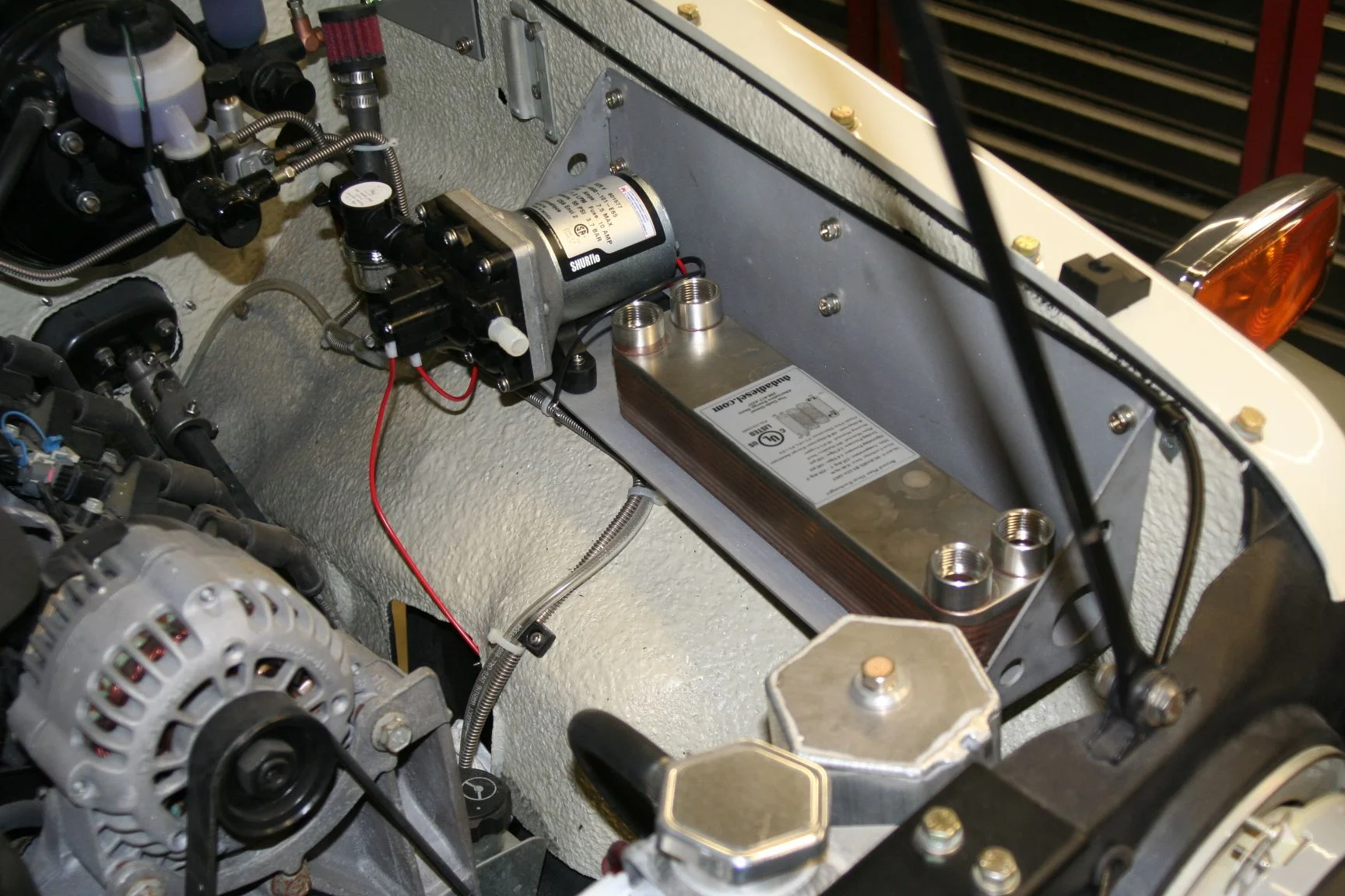

Finally got a rare factory option installed. Never offered to the North American market. After four days of camping at the pig party, you guys will be looking at this one. :)

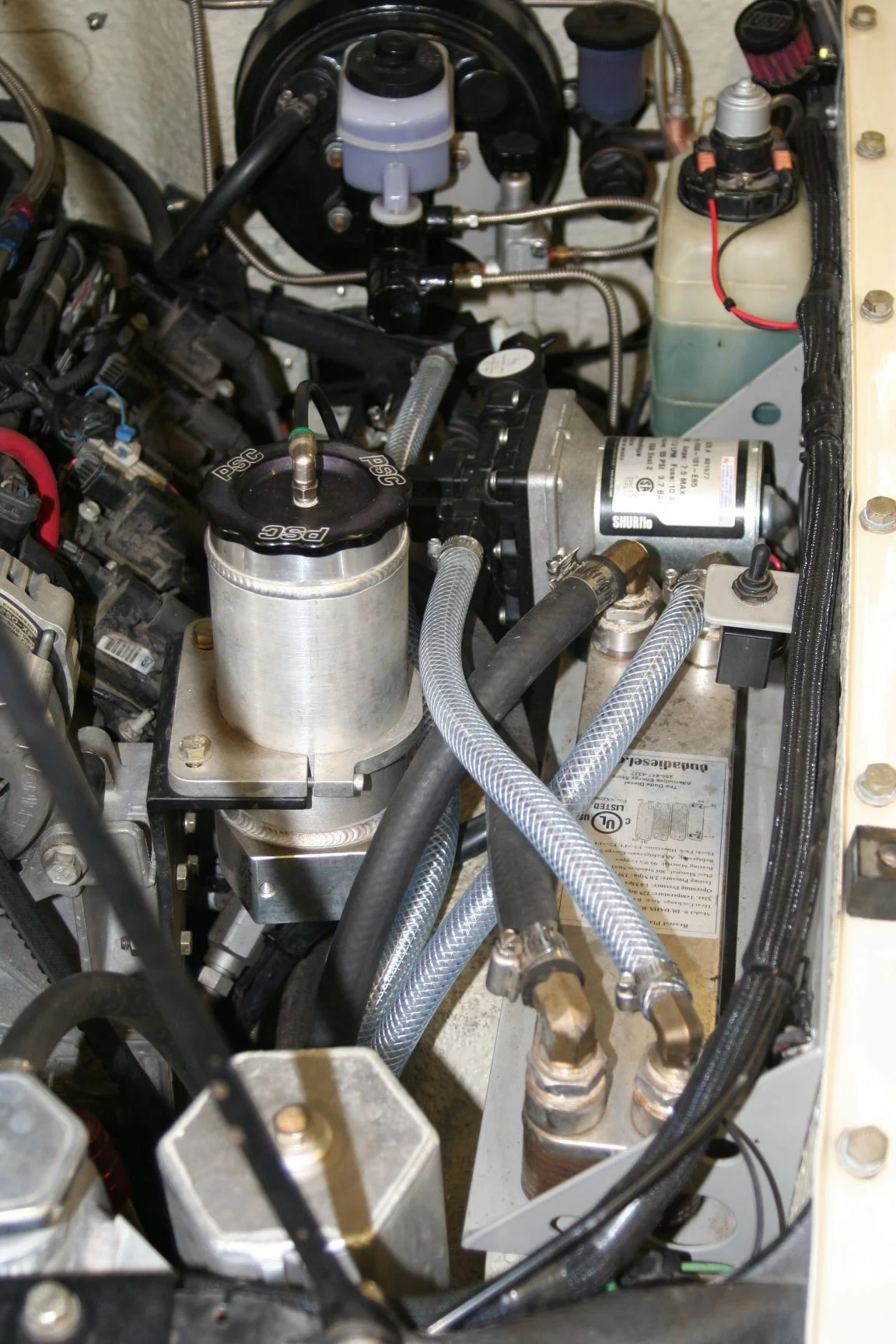

I was just joking, it's an on board hot water shower. Pump, heat exchanger, filter, etc. all mounted under the hood. At the end of a long day on the trails, just pump some cold water through it and you have a hot shower. Helps with the Wifey points, too. I need all I can get.
Here's a picture as it sits today. it's getting pretty jammed up in there. We haven't tried it out yet, that's coming in April.
