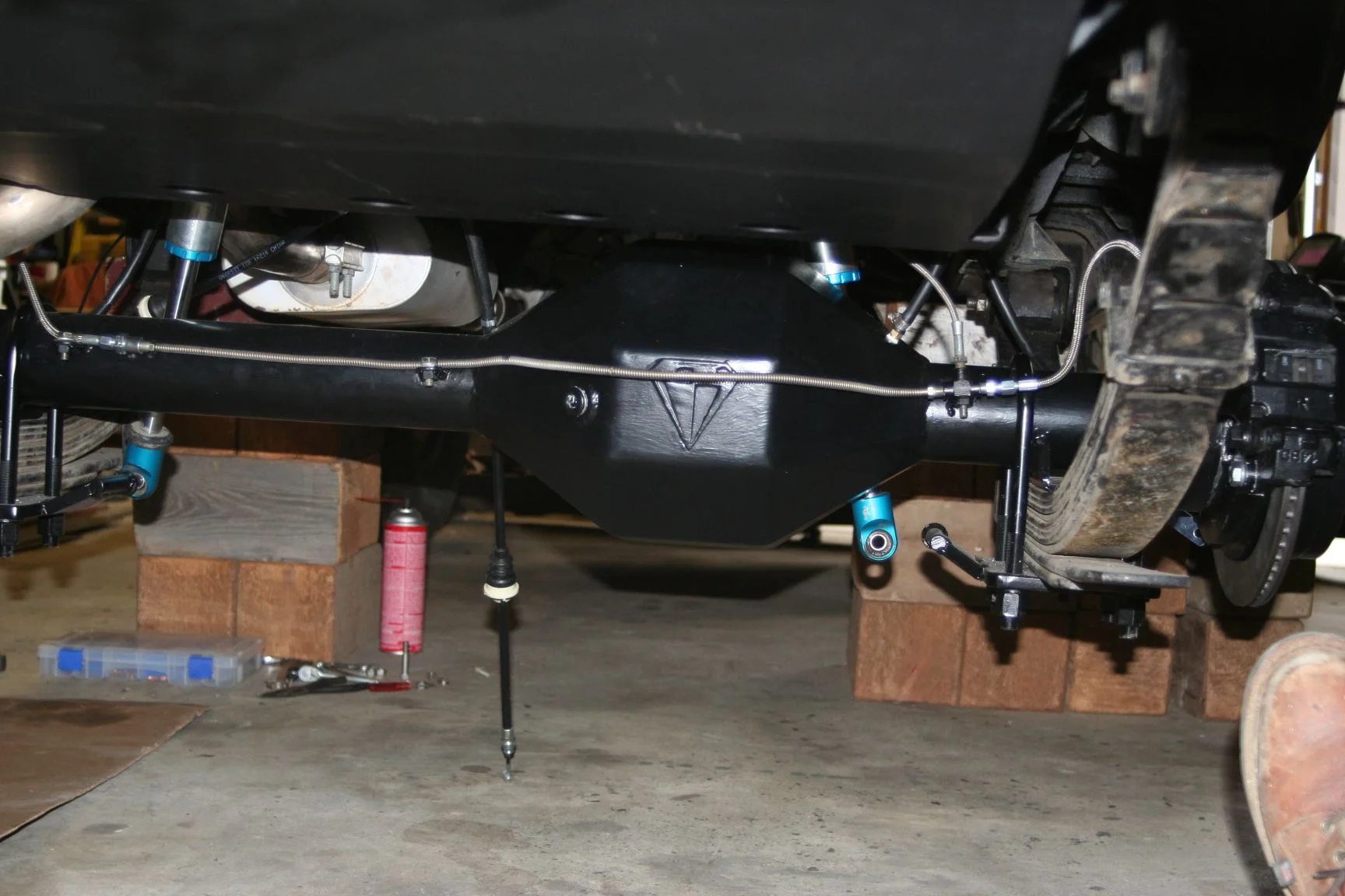

Small update on my rear axle. Some of you know I had ordered a Rough Stuff axle housing, waited two months and never got it done. I since learned about Front Range and their Diamond axle, so I went with them and everything turned out good. If I had questions or problems, I called and talked to Brian the owner, very nice.

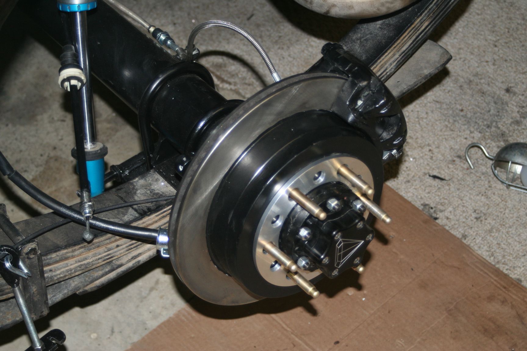

There can be a lot of small details that pop up that you just have to work through. We used 4runner brakes which I used up front, also. Thinking that would work with my wheels, oh no, I had to grind on the calipers and used a 1/4 spacer to keep them off the wheel. pulled everything apart and put in longer ARP wheel studs.
Then there's the parking brake cables. Not that easy to match up two 4runner cables to one 60 cable, a lot brackets and experimenting. Just about have it wrapped up and I'll move on to the exhaust leak at the header collectors. Need to get this done, CruiseMoab is coming up fast.
I'm very happy the way things turned out with this axle, a good company and I didn't feel bad spending money with them.

Couple questions, when you say “We used 4runner brakes which I used up front” are you saying you used the same calipers front and back or 4runner brakes front and back? How did Front Range and or Diamond axle address the oil seal at the hub side to prevent oil from mixing with the bearing grease?

the front brakes are from a mid nineties 4runner and are front brakes, dual pistons. The backs are from a 2007 4runner and are rear brakes, single piston. I just assumed they would be fine with my wheels, so much for assuming.
The Diamond axle has an inner seal at the end of the tube, next to the pumpkin.

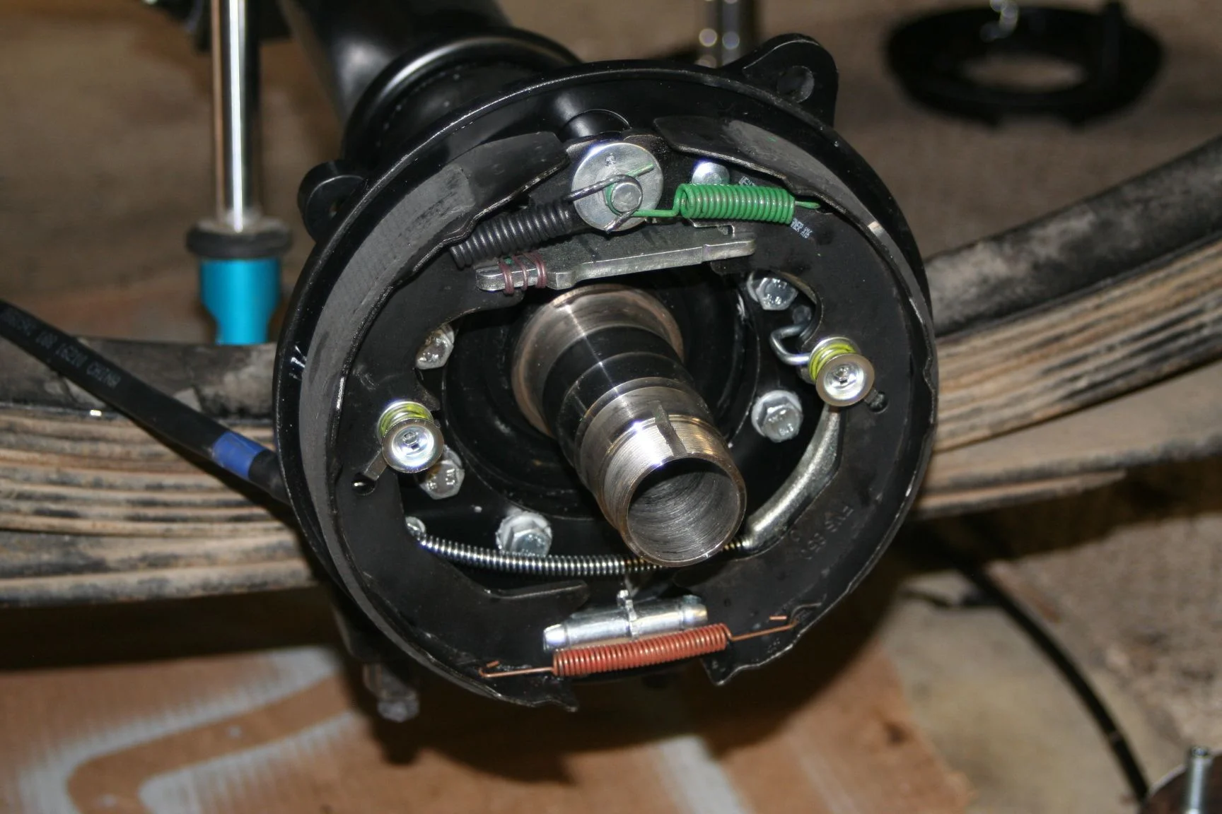

Crazy! So that is the 4Runner parking brake set-up?
Yes, Front Range has a machined plate that the brakes bolt to and takes the FJ60 hub. You have to use the newer 4runner brake cables, then build something to adapt them to your cable that runs up to whatever handle you use. I have an FJ60 handle mounted outside of my seat with the cable running back. The bracket I made holds the two 4runner cables and will pull tight when I set the brake. I'm on revision 5 today! :) Should of just went with Line Locks.
Problem is, I already have 16" wheels. I did some grinding and added a 1/4" spacer. I'm determined to get the cable brakes working, but still might add Line Locks, just for back up.
once you get the cable drama worked out, you'll feel fine with the mechanical ebrake.
I'm back on it today, hopefully get past it and on to something else. I've got to notch one of the frame braces, so the cables function smooth. Sat under the 55 for an hour yesterday with three different cutting implements, testing which will work the best. Sure it's in the worst spot possible!
