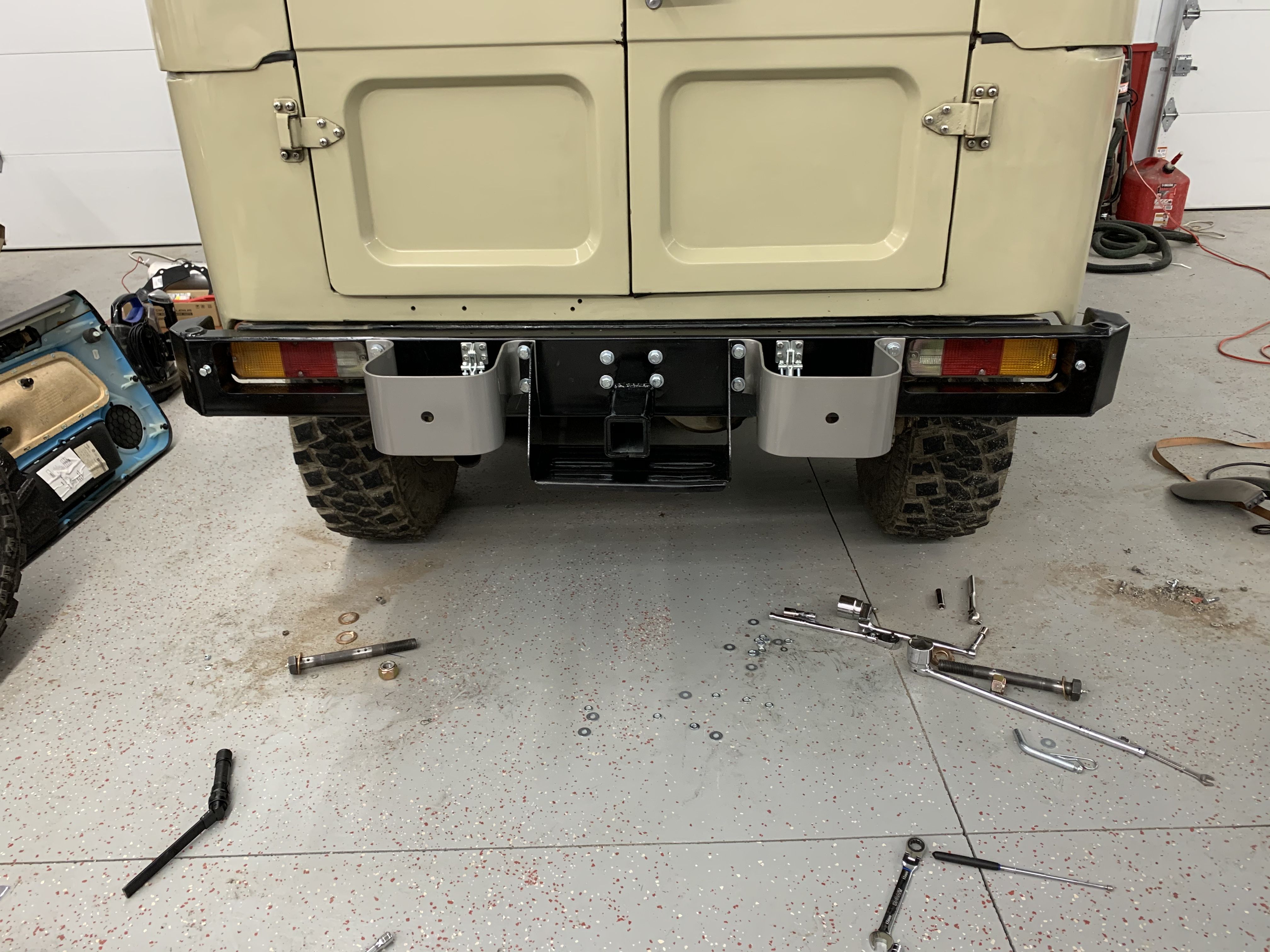

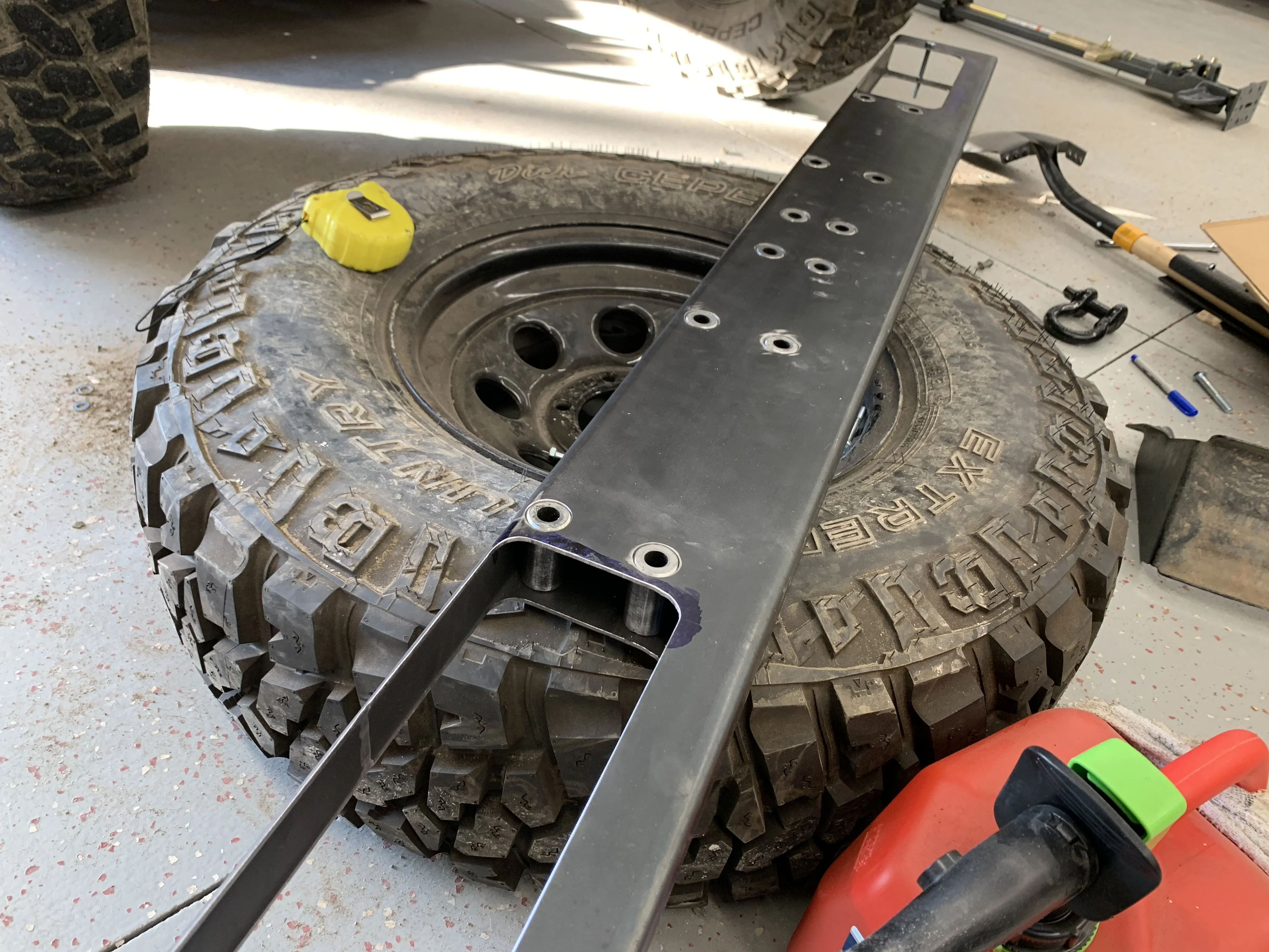

I built a bumper. It's pretty easy when you're social-distanced at home, but home has a welder and a nice garage. When last I posted, I had gotten my steel order delivered, but hadn't started building. Well here's the whole bumper build in one convenient post! Vacuum-packed for maximum freshness!
The main influence/inspiration for the bumper's design was the dual-swing bumper from 4Plus. I really liked their design, but I also wasn't super gung-ho about spending $2000+ after shipping on something I was still probably going to have to tweak to fit on my truck. I also wanted to try and keep a lot of the character of the rear of the truck, so utilizing the factory tail lights, bumperettes, and step were also goals. Finally, there were a couple additional functions I wanted my bumper to have.

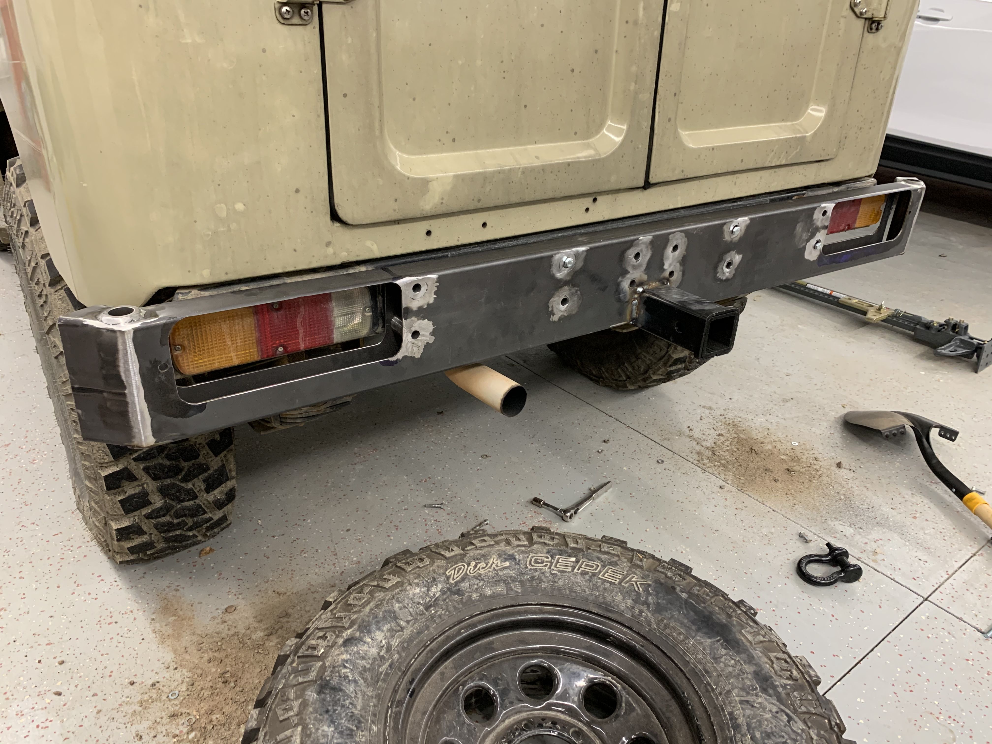

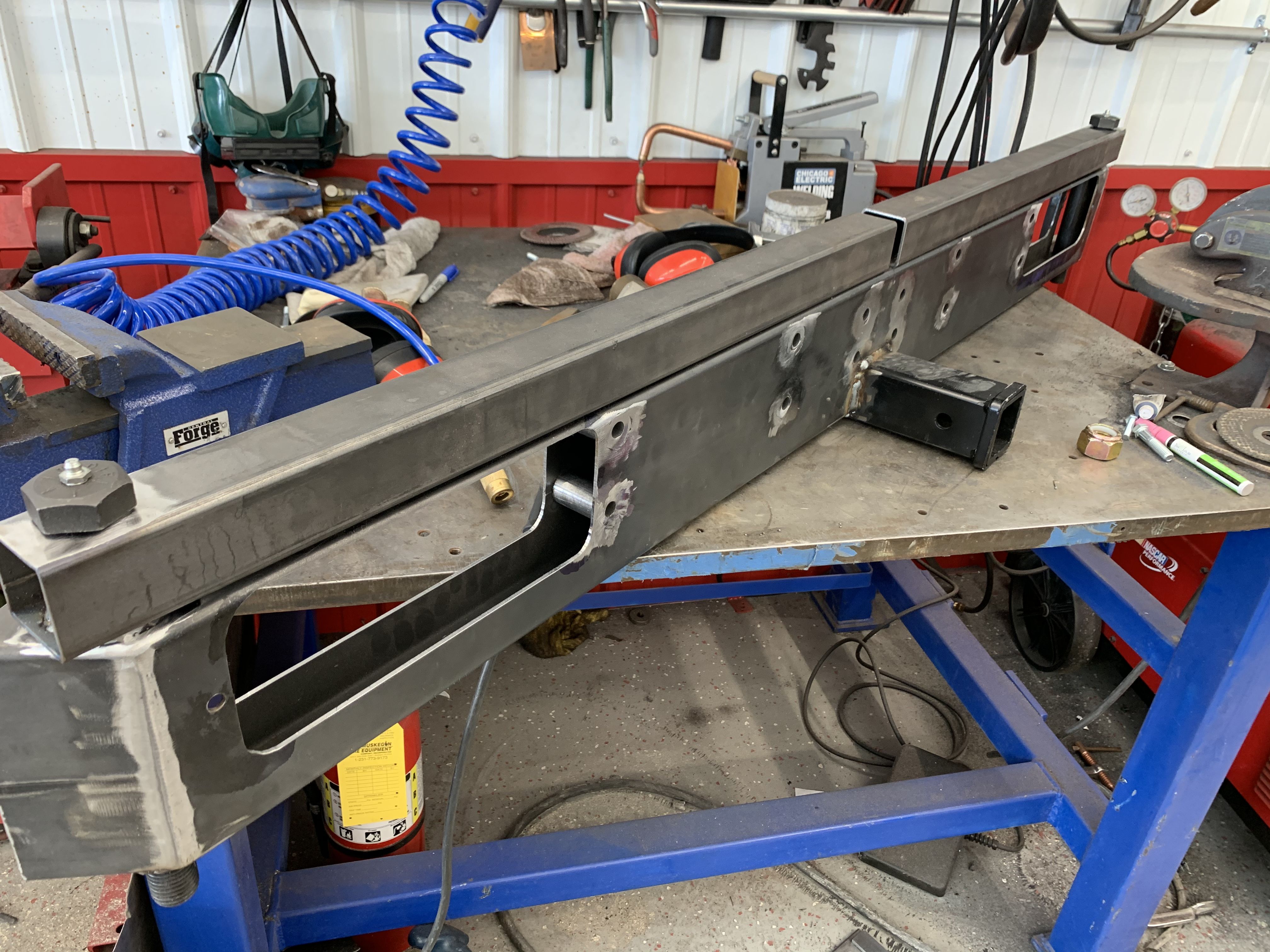

First, I cut the main bumper sections. (2x6" 1/8 wall rectangular tube stock)
full

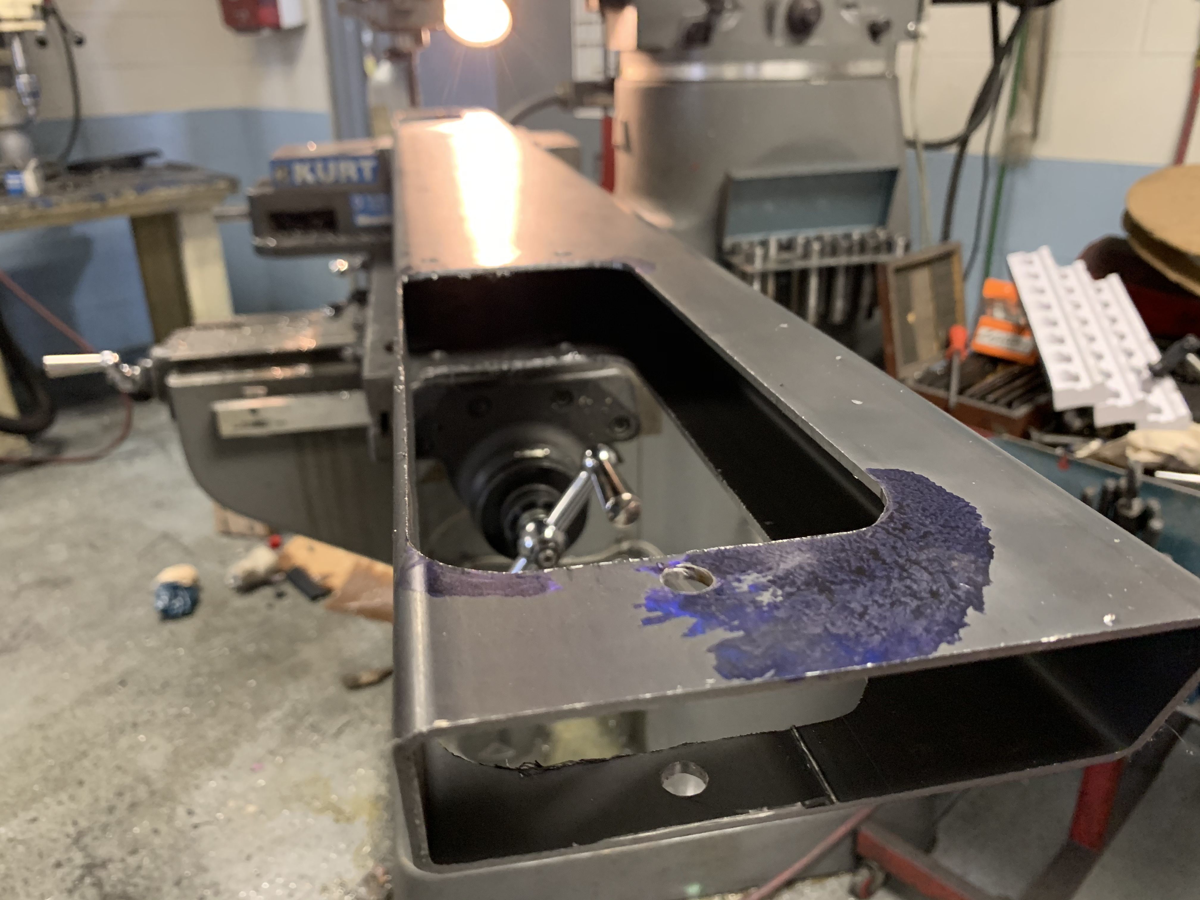

Next I milled out the openings for the tail lights, and drilled holes for the mounting bolts.
full
The bolt holes are VERY oversized so I could slide lengths of super thick-walled tube stock into the holes and weld those in place, so the bolts aren't just crushing the bumper. Like this.
full

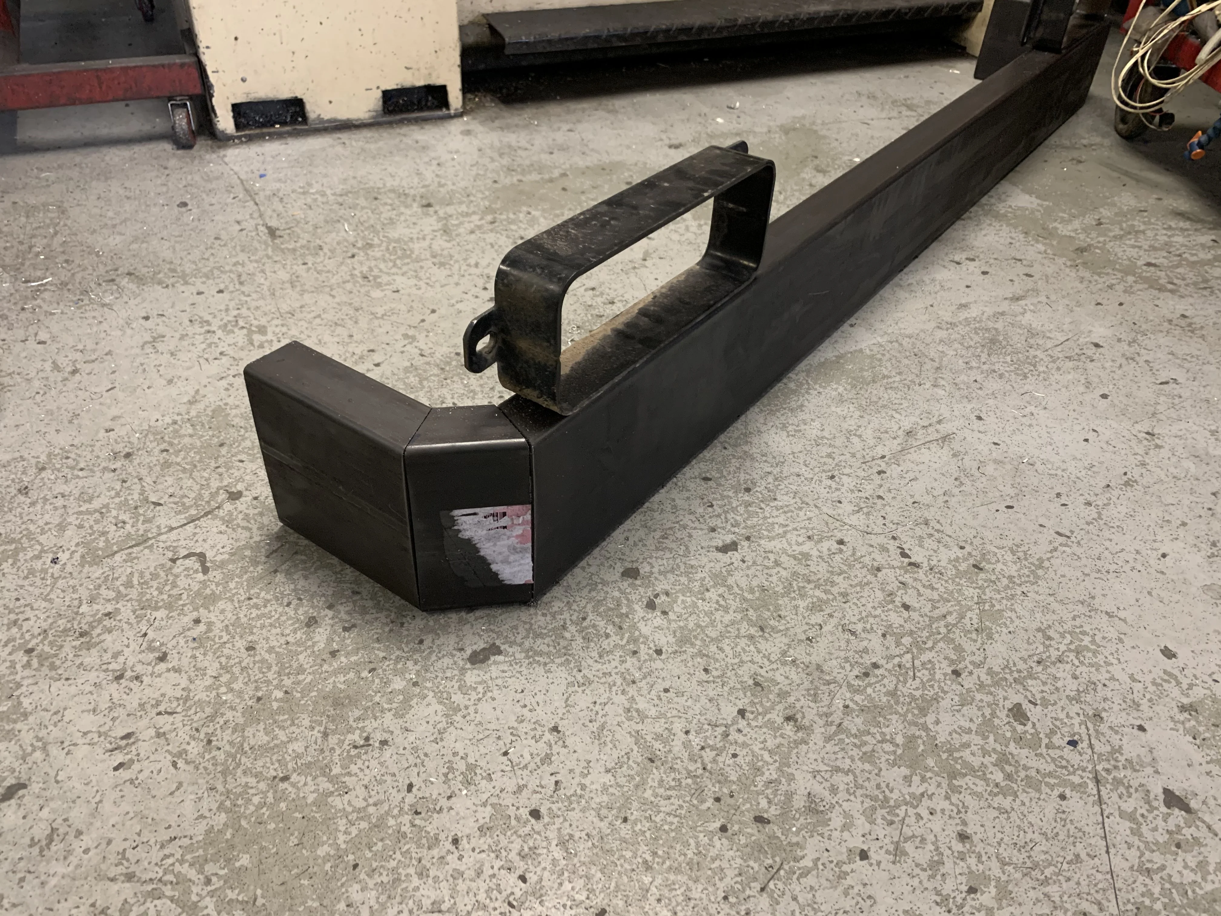

The pivots for my arms are made from 1" ID thick-walled tube welded into the bumper (seen here) and MASSIVE 1" bolts. I also cut up and welded in a hitch receiver. I don't anticipate towing anything big, but I wanted some sort of rear recovery point, so a hitch shackle will do nicely, and if I ever want to use a bike rack or something, I can.
full
And here's the first benchtop test-fit of those arms. The bolts have a hole drilled down the center with outlets and channels for greasing the pivots.
full
And here's the test-fit of that whole ensemble, plus the end caps of the main bumper and the original tail light guards cannibalized and welded in. The end caps have bolt holes in them so I can attach a roof rack and arm for a hammock later. (some of the extra features I mentioned) At some point while moving the truck's spare parts or cleaning out a workshop, I must have lost the original bumperettes. Did you know you can STILL BUY THEM DIRECTLY FROM TOYOTA? Fun! I was hoping that by buying these ones, the originals would turn up. No such luck.
full
Now to make stuff to stick on those arms! Left arm (behind the passenger's seat since this is a RHD truck) is getting the tire carrier plus a place to attach that Hi-lift jack that keeps getting in the way. Right arm gets a basket to carry my knock-off yeti cooler and a license plate so the cops don't bother me about it being taped in the window. How do you make a basket? Take a bigger basket and chop it up, then weld it back together. In my case it began life as a hitch-mounted utility carrier from Harbor Freight that my dad used on one trip, and never needed again. Waste not, want not! This is partway through the construction. Later the basket will get reinforcements, hooks for a cooler-securing ratchet strap, and an expanded metal mesh floor.
full
With everything in order, it's time for paint! or, well, primer.
full
And then paint!
full

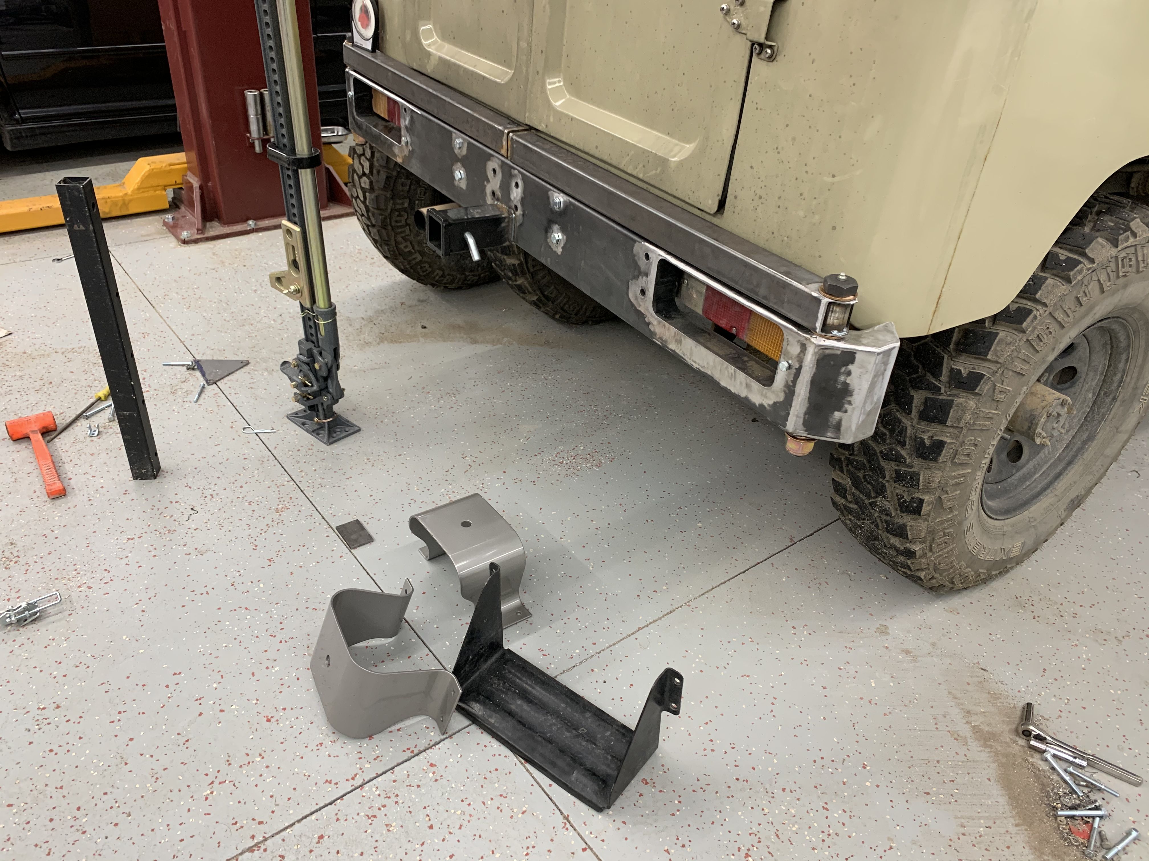

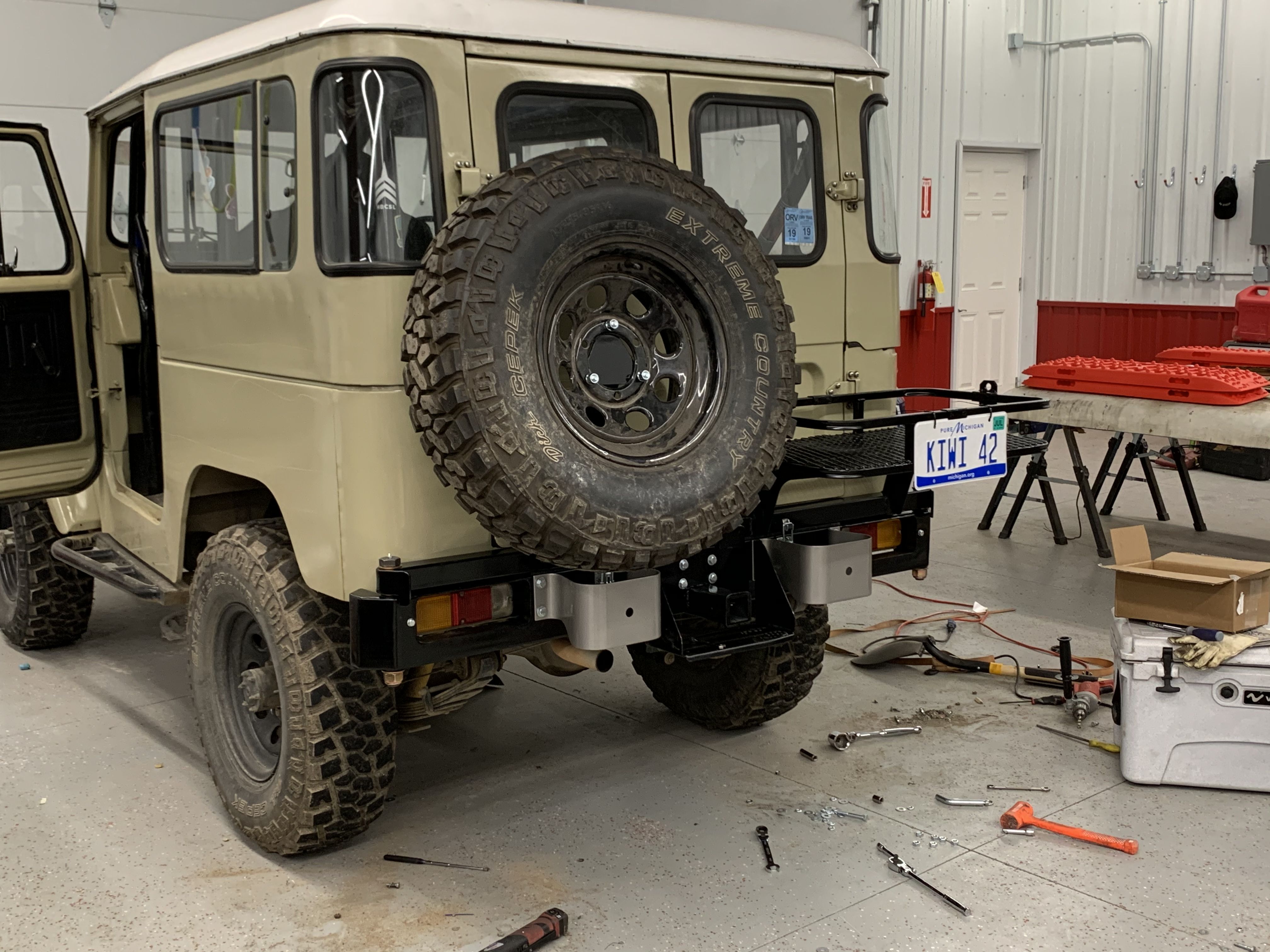

And now it's assembly time. Here's the main bumper fully attached, with the bumperettes and step, plus the latches for the arms tucked neatly behind the bumperettes.
full

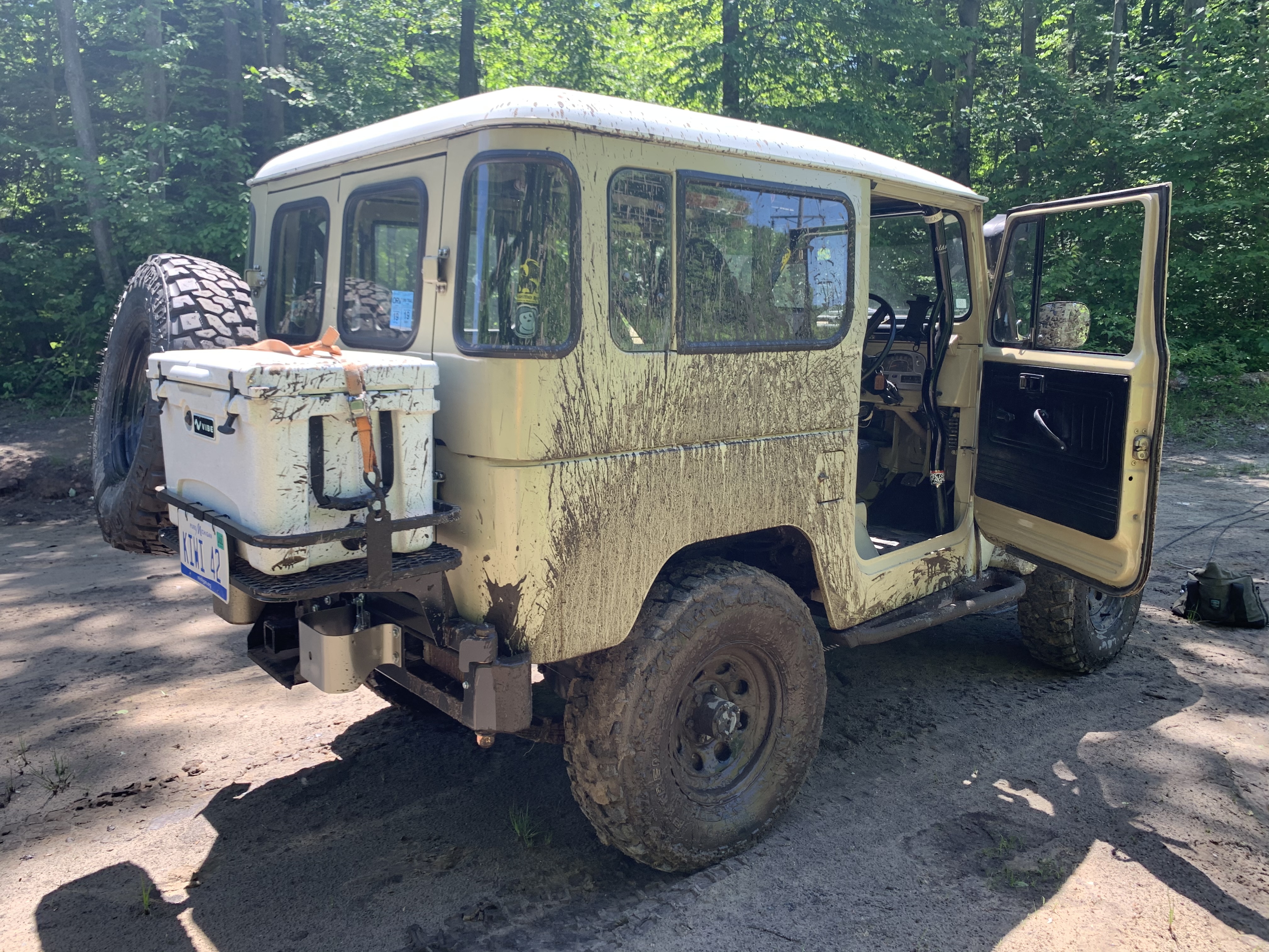

And here's those arms attached! The tire mount is intentionally angled a couple degrees so the tire sits down onto it more easily.
full

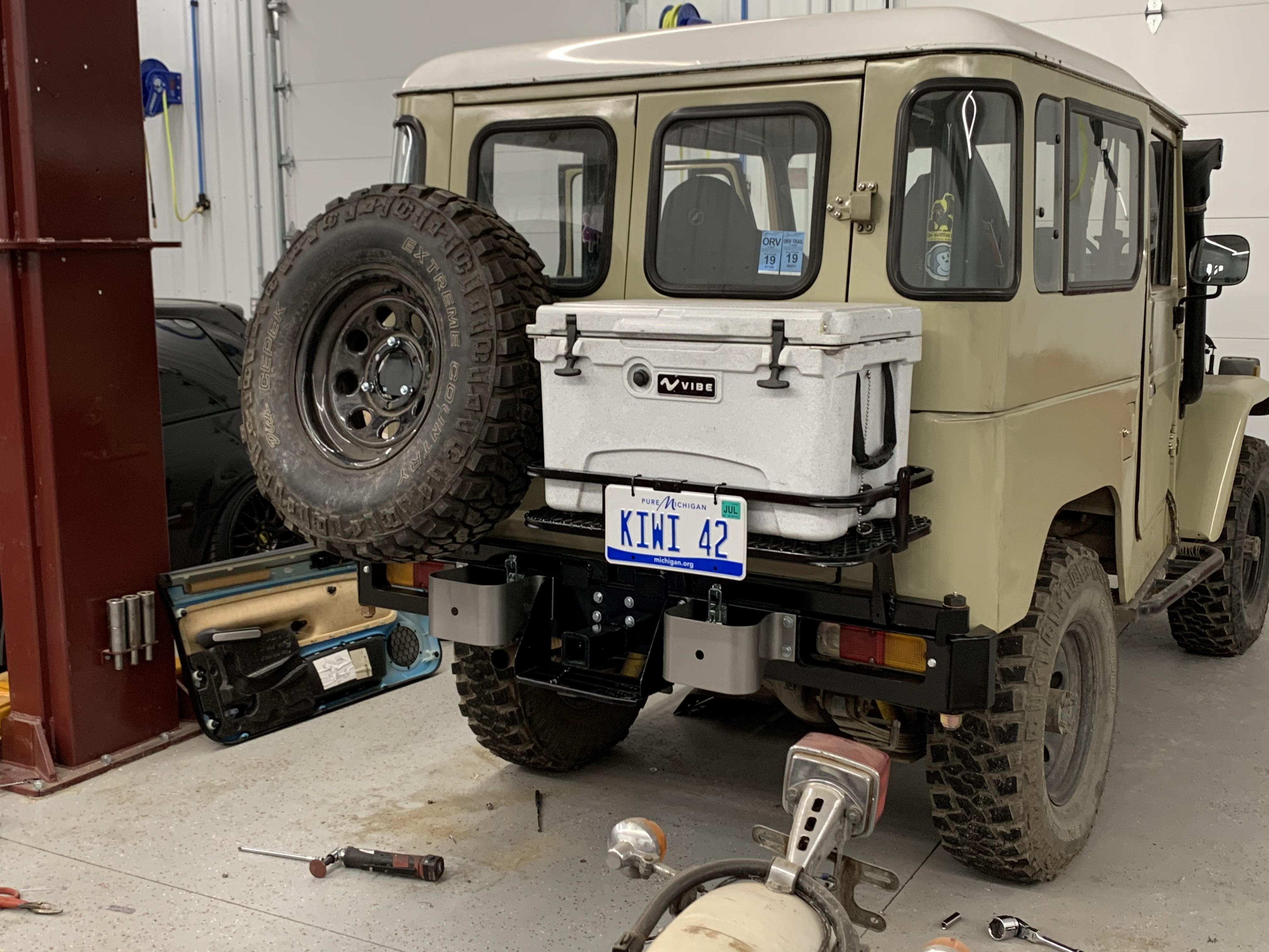

And here's from the other side with the cooler. I swear I'm not sponsored, unless the owners of Vibe are on here and want to get in touch.
full
The arms have tabs welded to them that prevent them from swinging wider than this. And the doors won't hit the arms when fully opened either. Don't want them to hit the body work. If I'm gonna wreck my paint, it's gonna be on a trail.
full

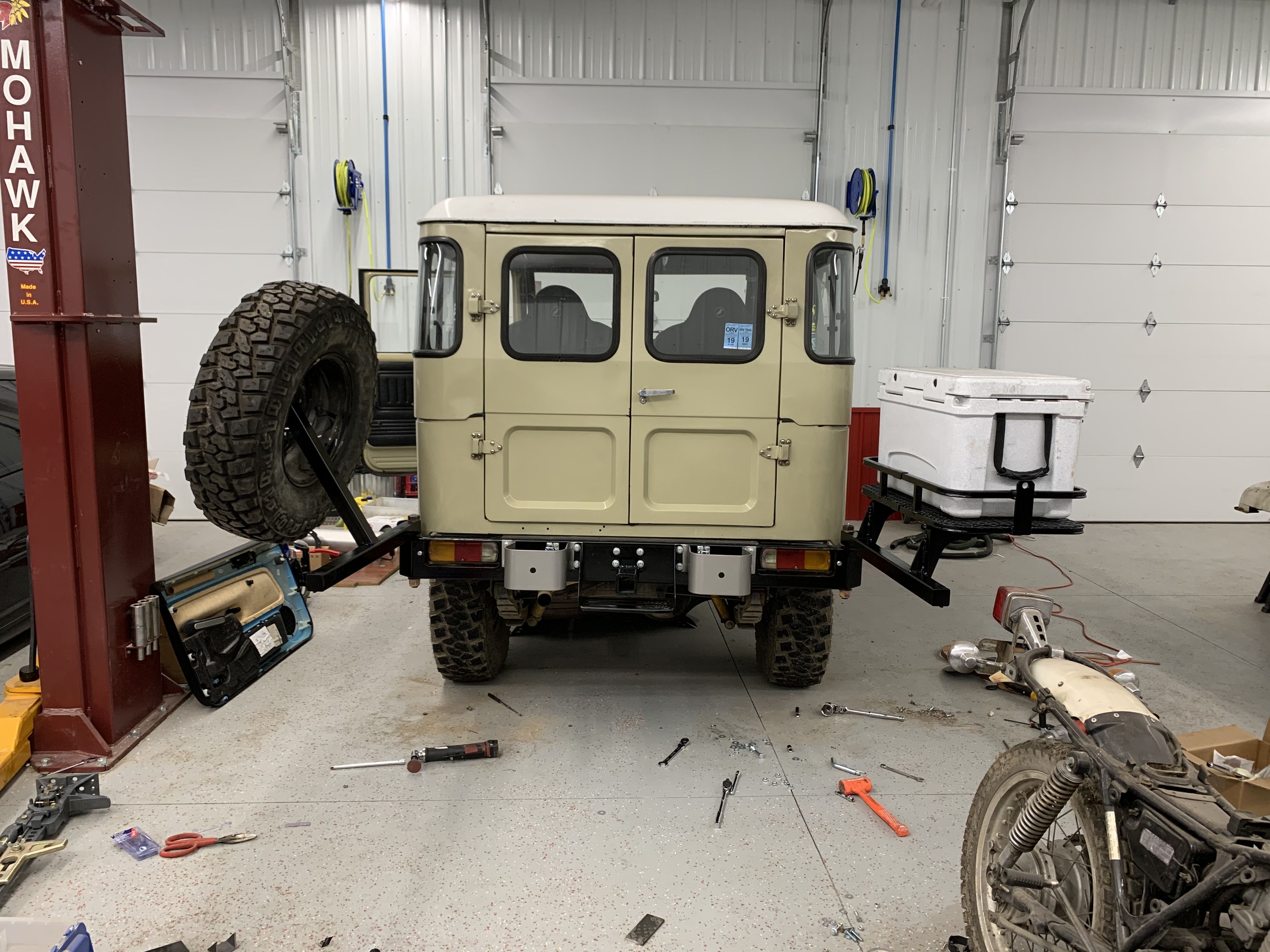

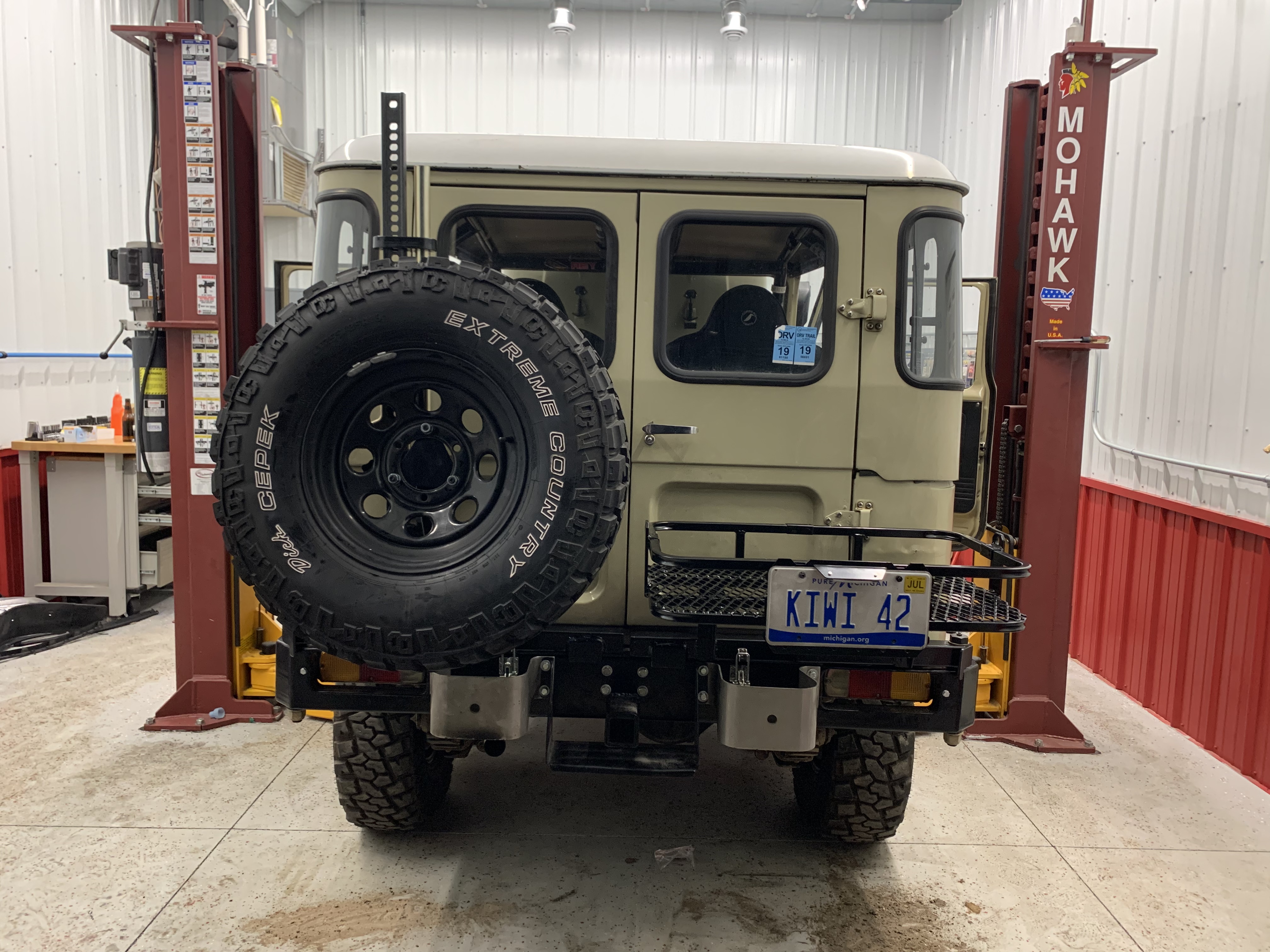

So, there we have it. Full tire carrier basically complete! I want to tweak the fit a little bit, reinforce the tire carrier, and I still want that jack mount, but that's the majority finished.
Aaaaaand glamour shot.
full
'Til next time!

No, both the arm and bumper are smooth-bored. the bottom end of the bolt has a lock nut on it.
Literally just finished last night, one drive around today, so I haven’t had a lot of time to check for rattles, but I haven’t noticed any as standing out to me.

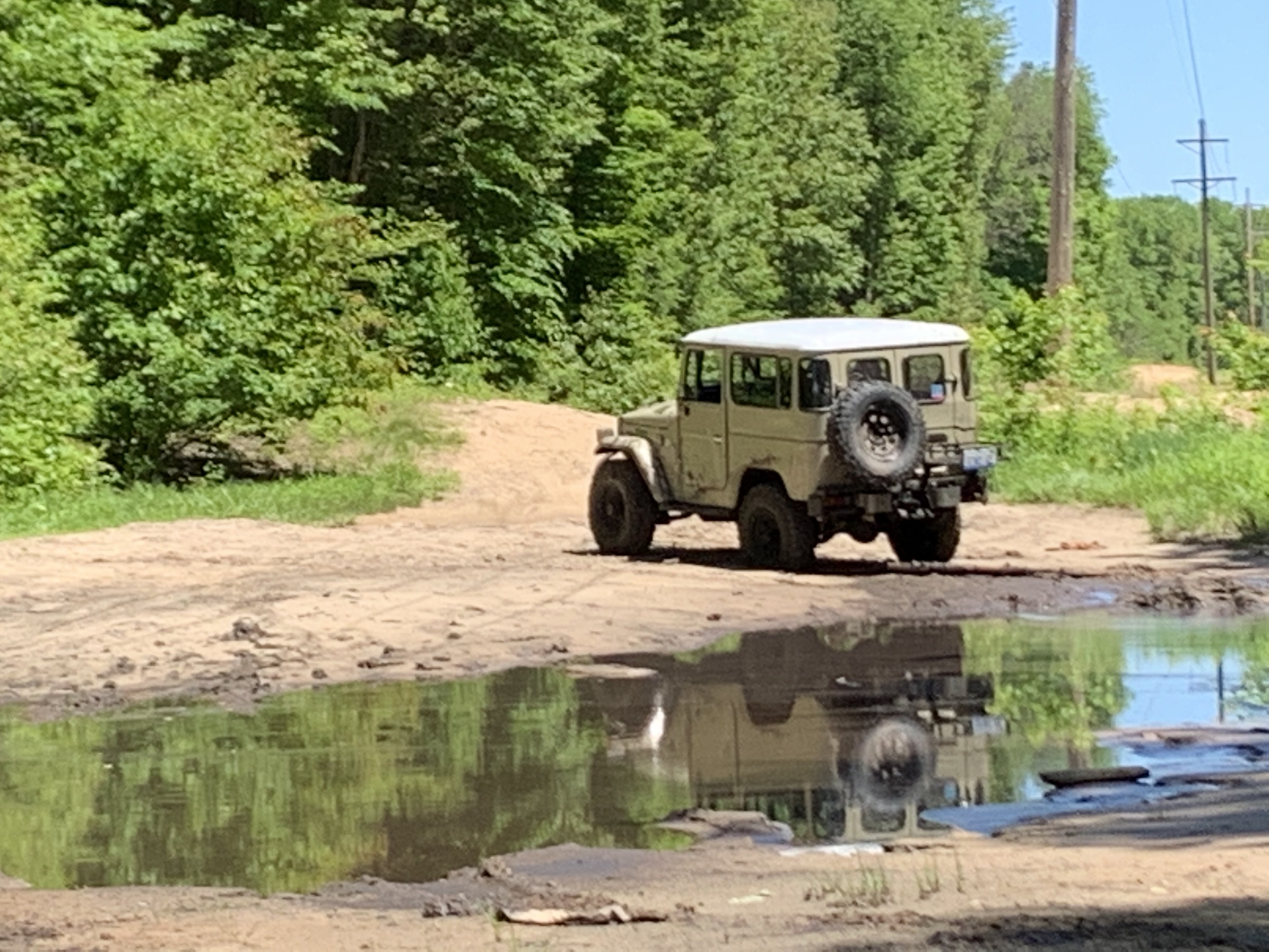

Well look at that, it's been over a year again. Oops. I guess I'll give a few little updates. About a month after I finished the bumper, I took it on a little inaugural trip for an afternoon off-road picnic. Drove it down into the first puddle and promptly got stuck. No biggie, that's what the winch is for. Stopped to take a quick post-mud photo:
full
Continued on for a bit, then got it stuck in the NEXT puddle too! Winched it out again, but as I'm just getting clear, I hear a hissing sound. I had sheared off a valve stem. Hooray for high-lift jacks and carrying a breaker bar in my tool roll, I guess!
full

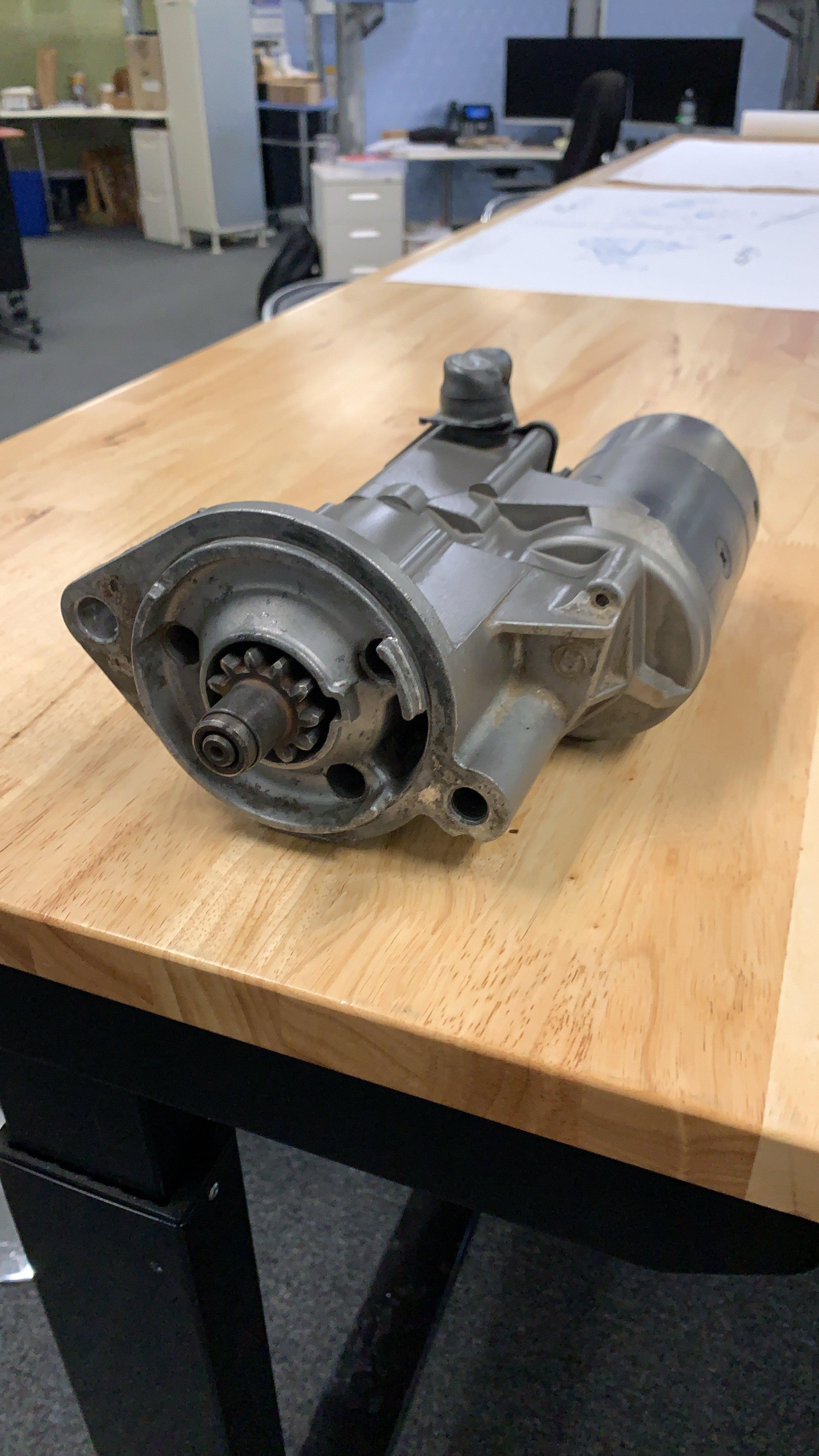

A few weeks later, Kiwi started to take more and more effort to start, until eventually it wouldn't start at all. I'm guessing the starter wasn't a big fan of its undersea adventures. There's a shop just down the street from my work that rebuilt the starter quite easily, though.
full

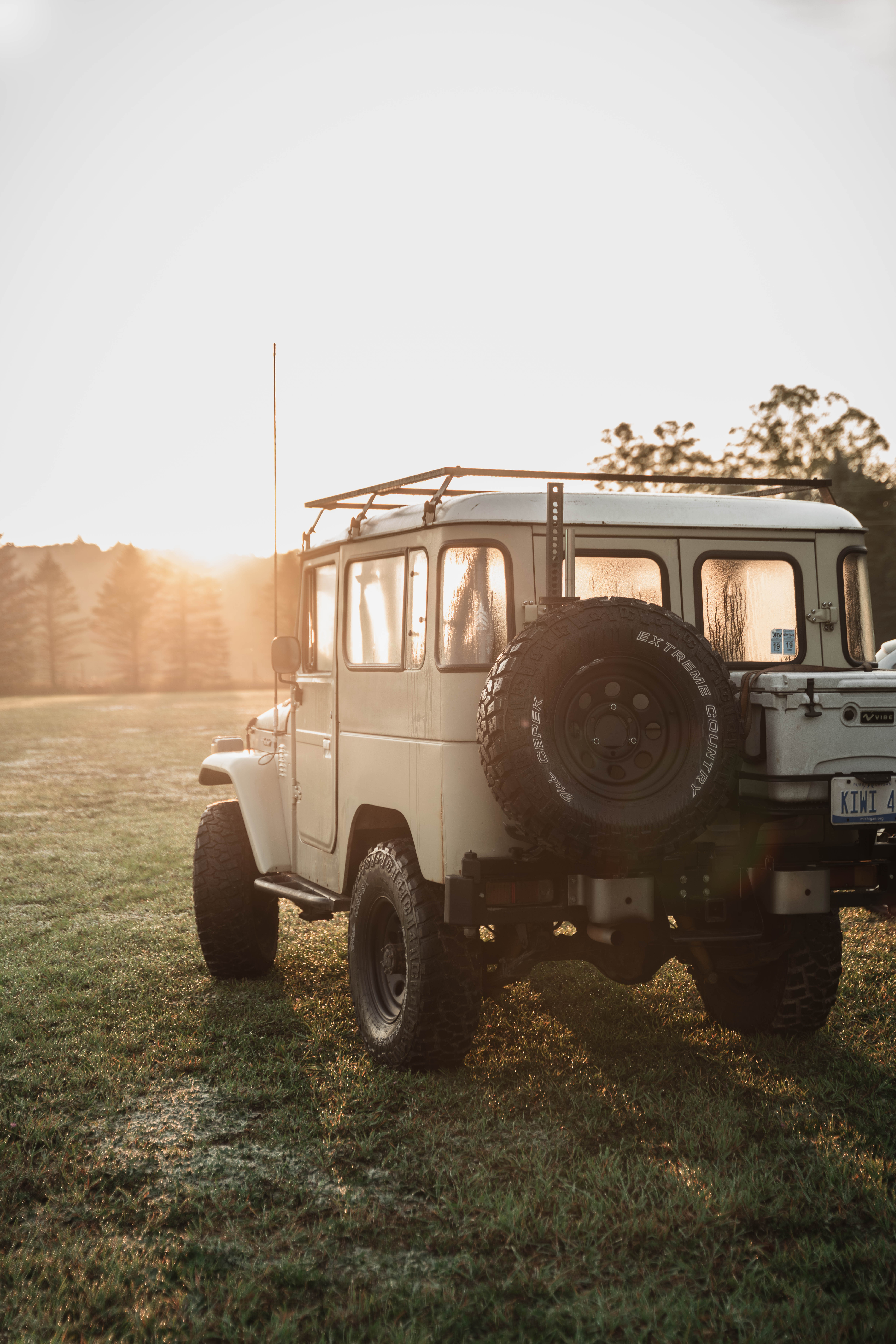

So that's most of it. I'll leave you all with the best photo I've taken of Kiwi.
full

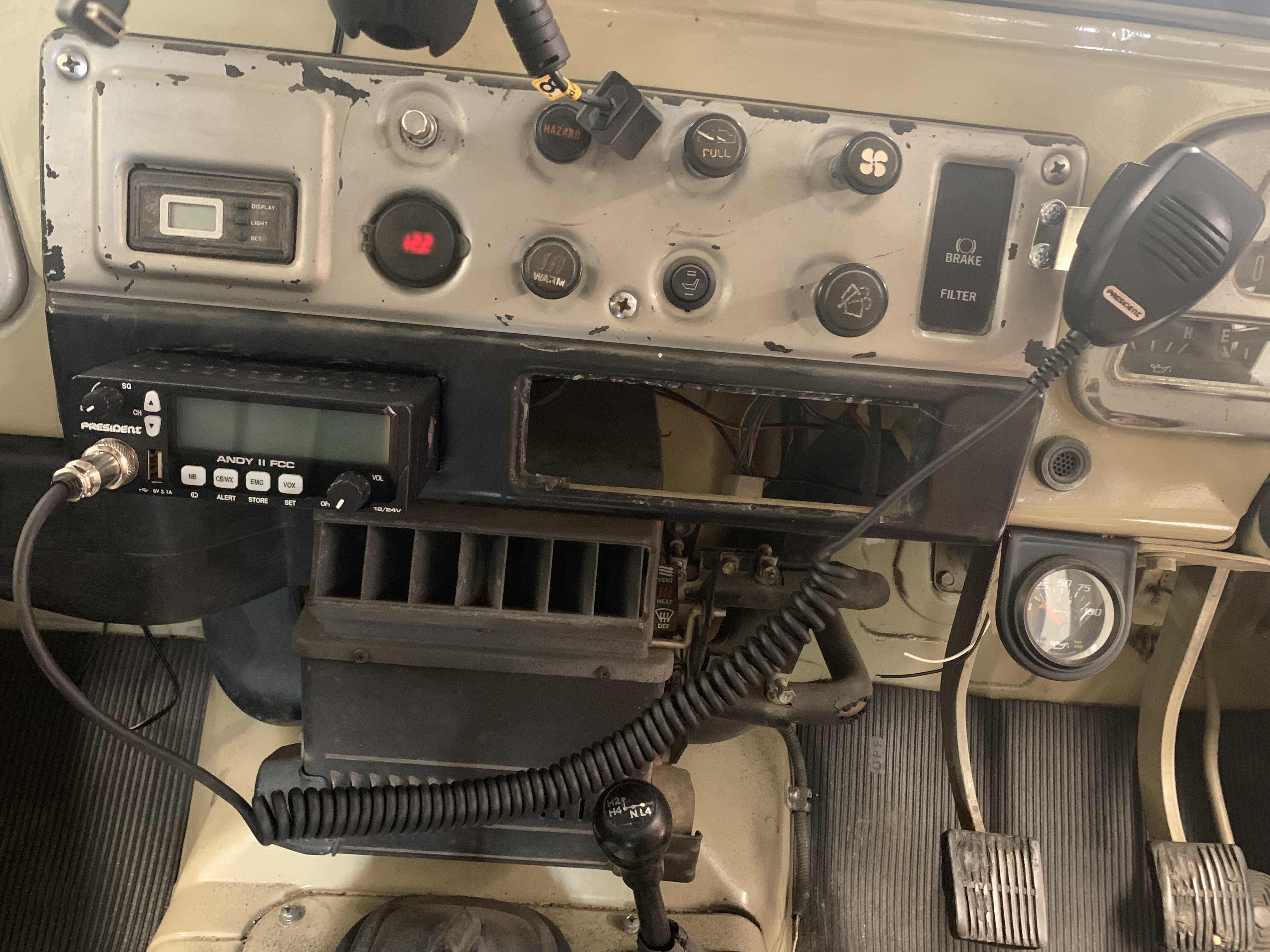

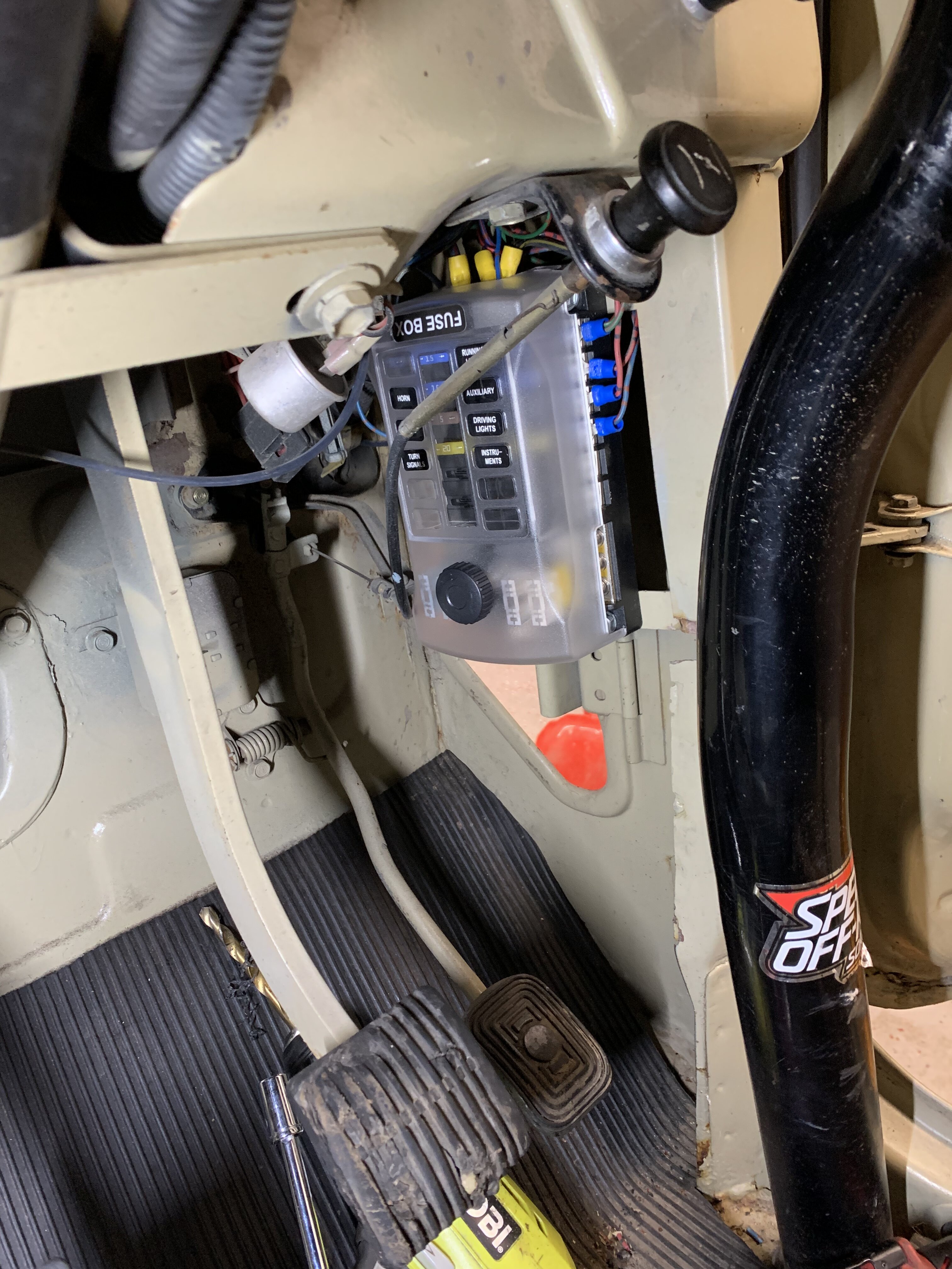

First I pulled out the old tube fuse block, swapped it for a blade-style one with a few extra slots.
full
It was like 20 bucks on Amazon. I think it was meant for a boat, because some of the optional labels for the cover said things like "Fish Finder" and "Anchor Lights" but hey, it works great!
The electrical system upgrade was useful, as it made it much easier to hard-wire in my GPS:
full

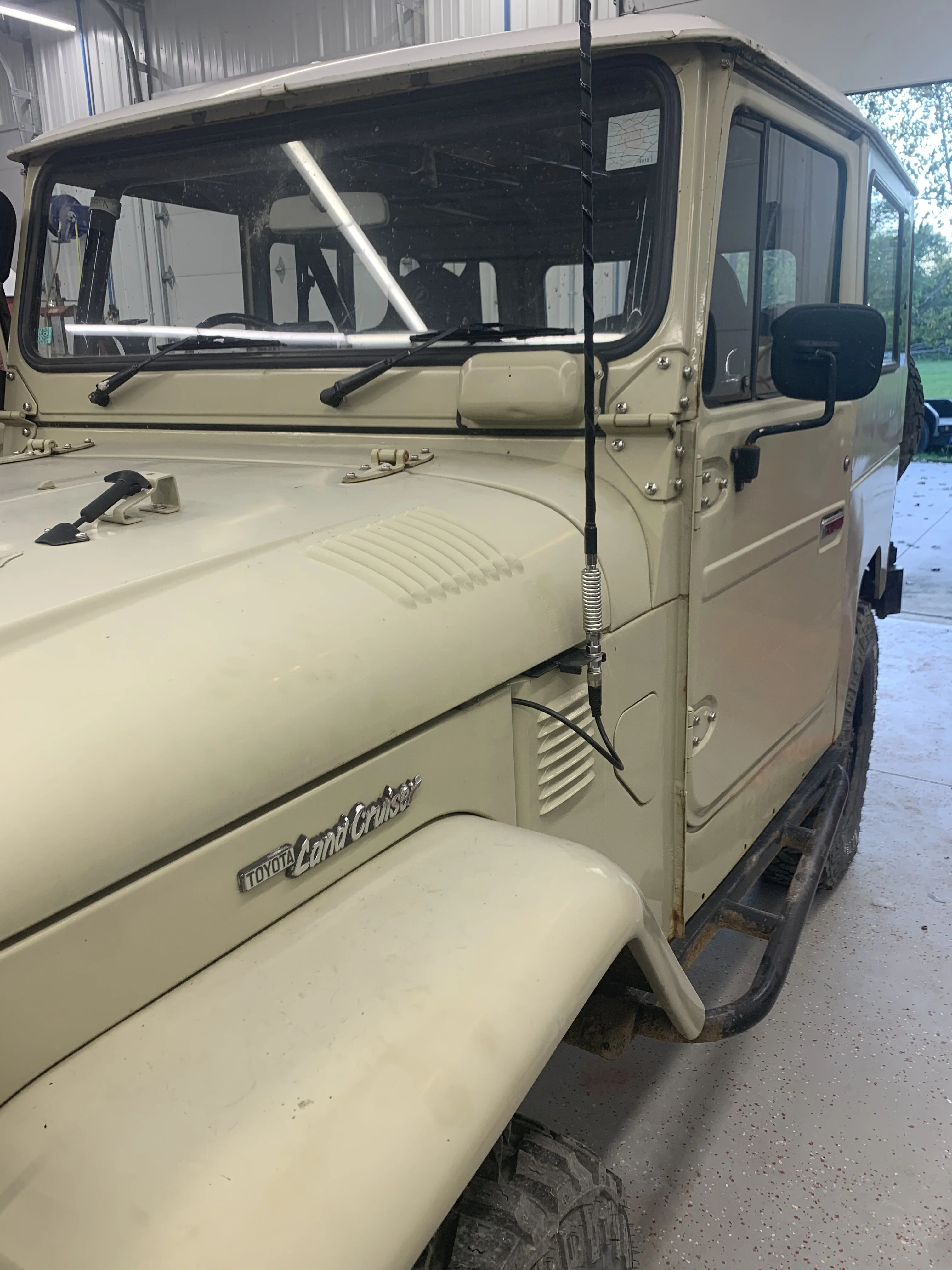

and a CB radio:
full
(I showed you my 4' whip antenna, pls respond)
full

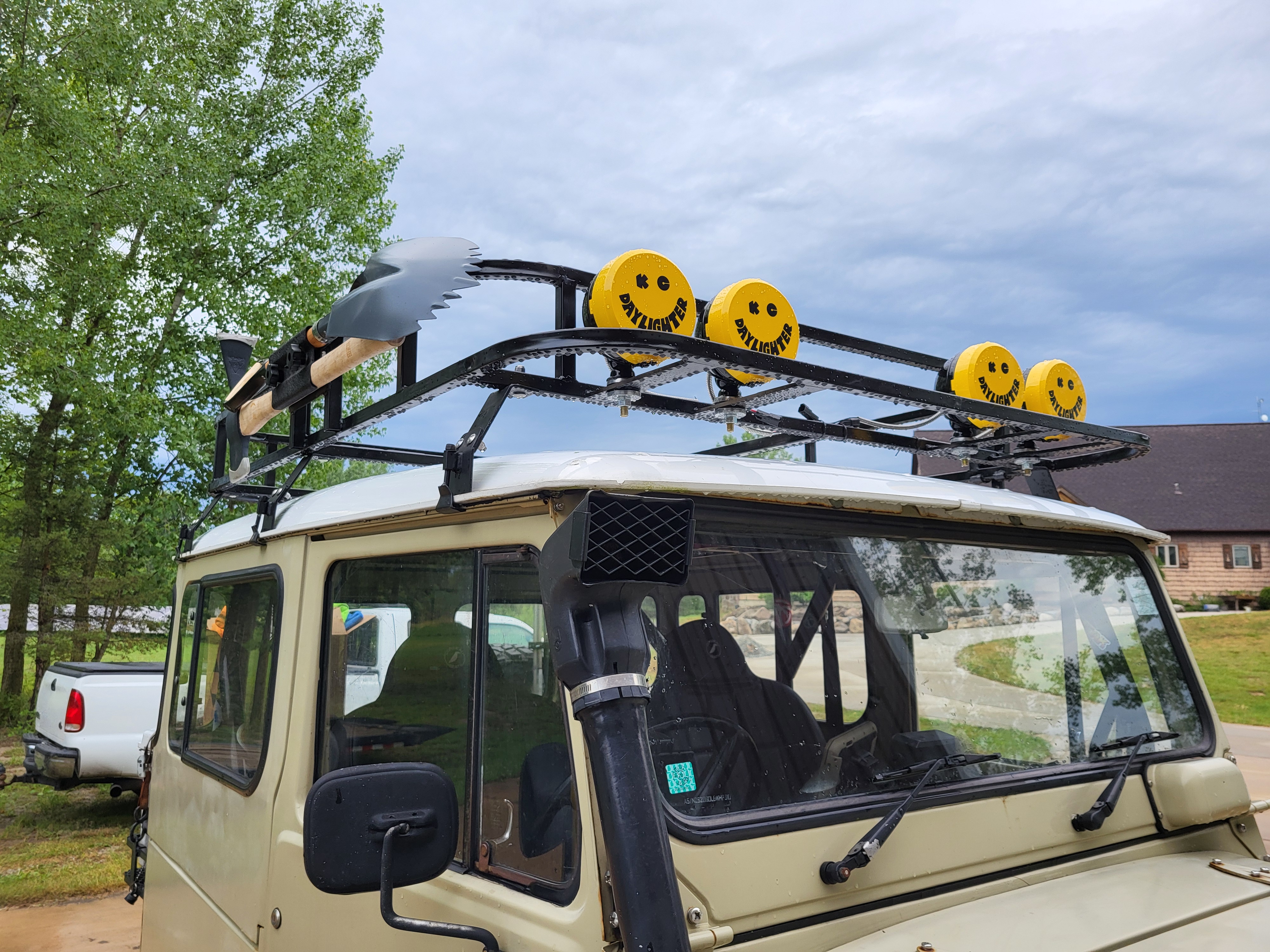

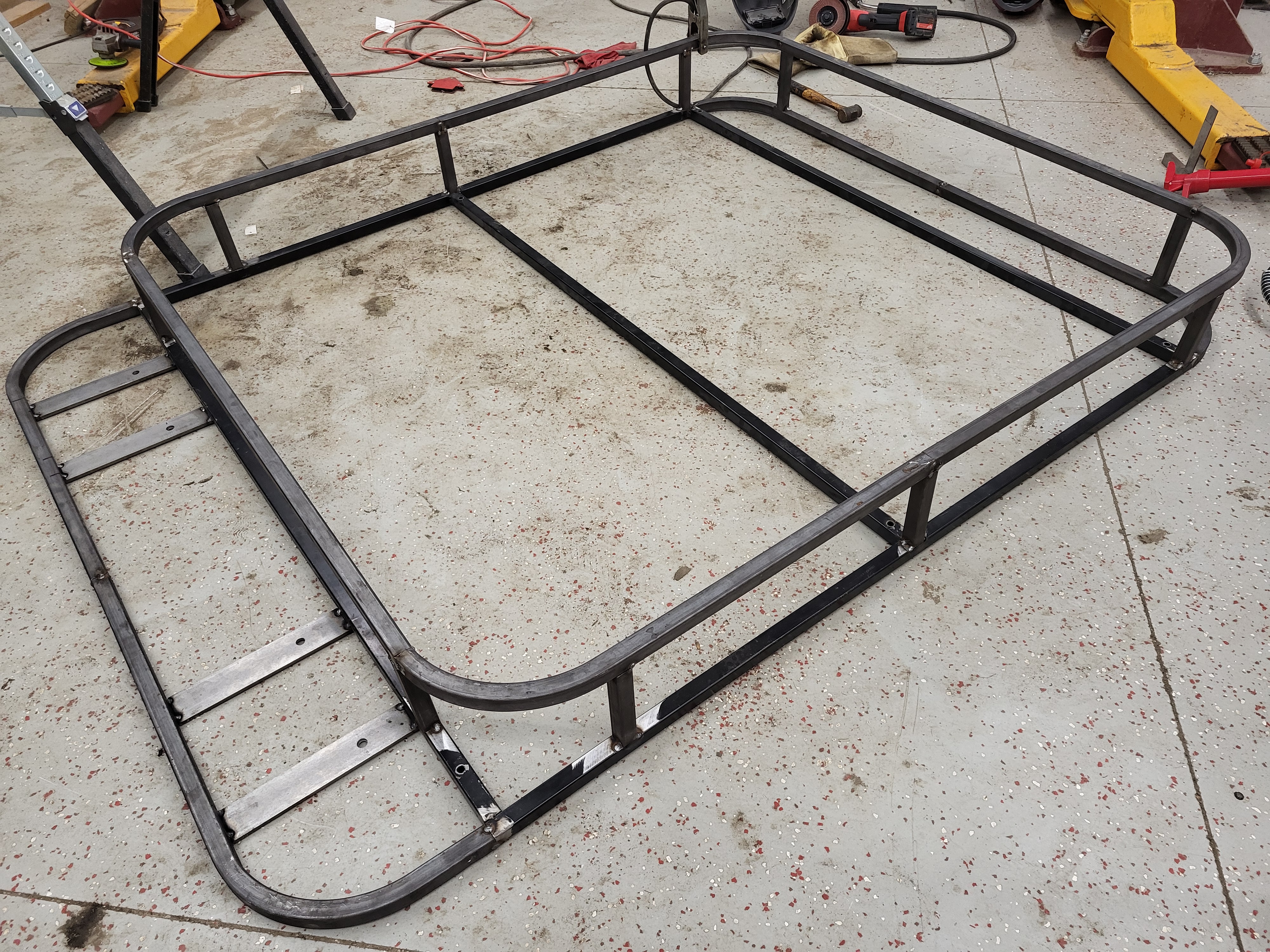

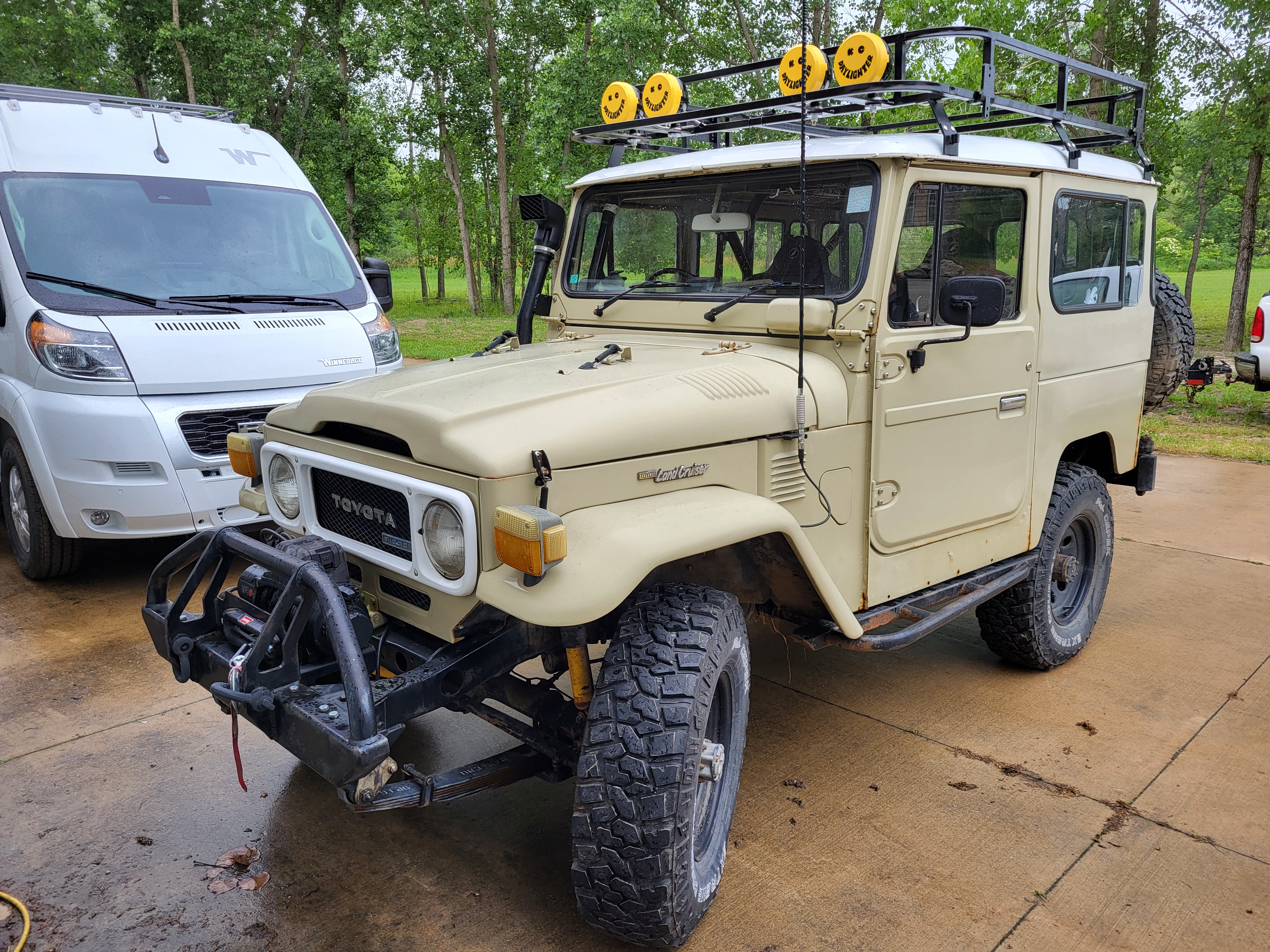

Then I began "phase 1" of a roof rack. Phase 1 was simple. I bought 6 of the rain gutter mounts from Specter Off-Road and welded together a simple square frame between them. I don't have any photos of the process, not much to see. I then took it to a weekend retreat with friends, one of whom took some NICE glamour photos of it. At least this way you can see the starter roof rack.
full
full
full

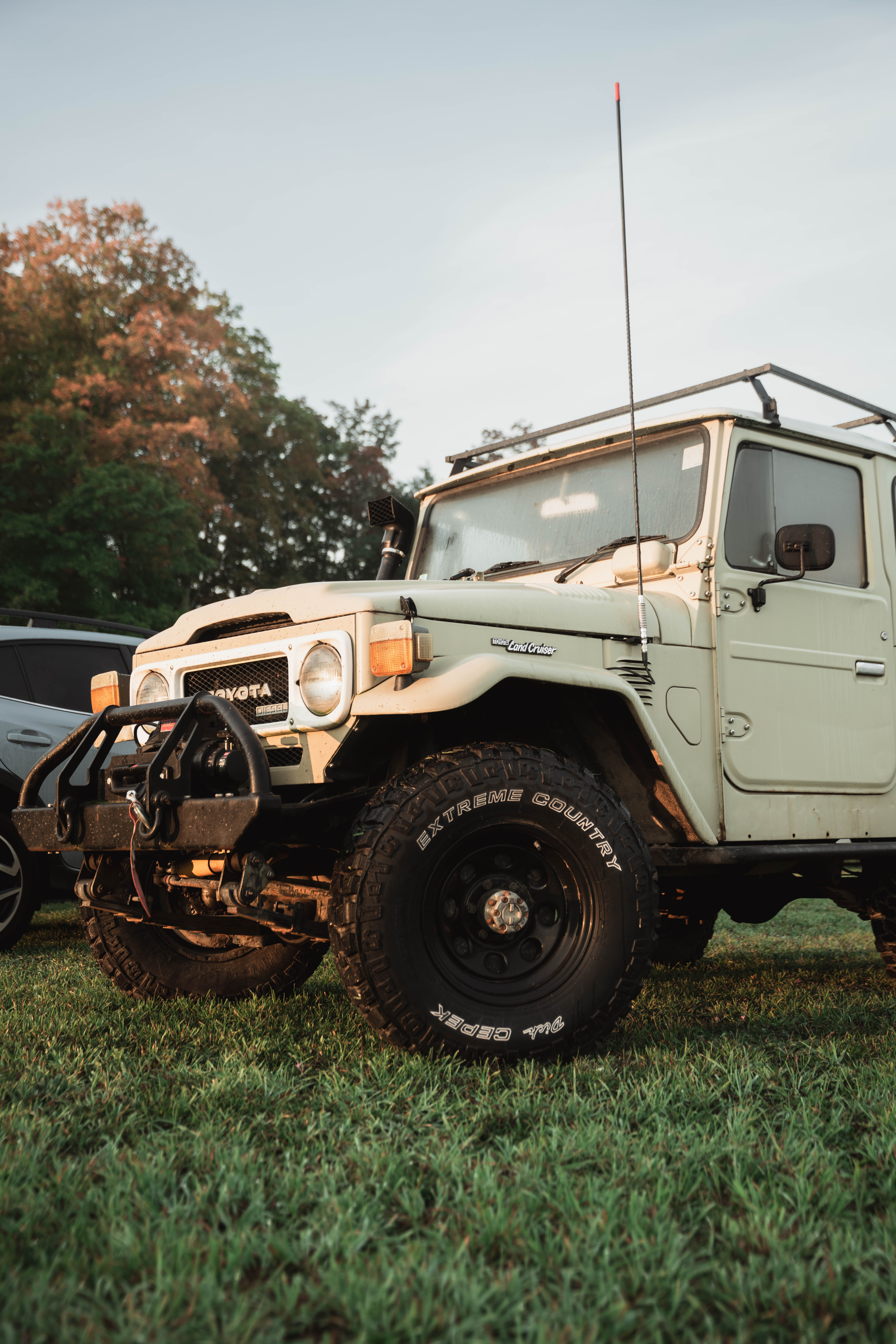

Took it to a car show on Labor Day weekend. I didn't win any awards (Because the judging categories are SUPER unbalanced) but far more importantly, the truck was some much needed shade for a puppy, so who who really won?
full

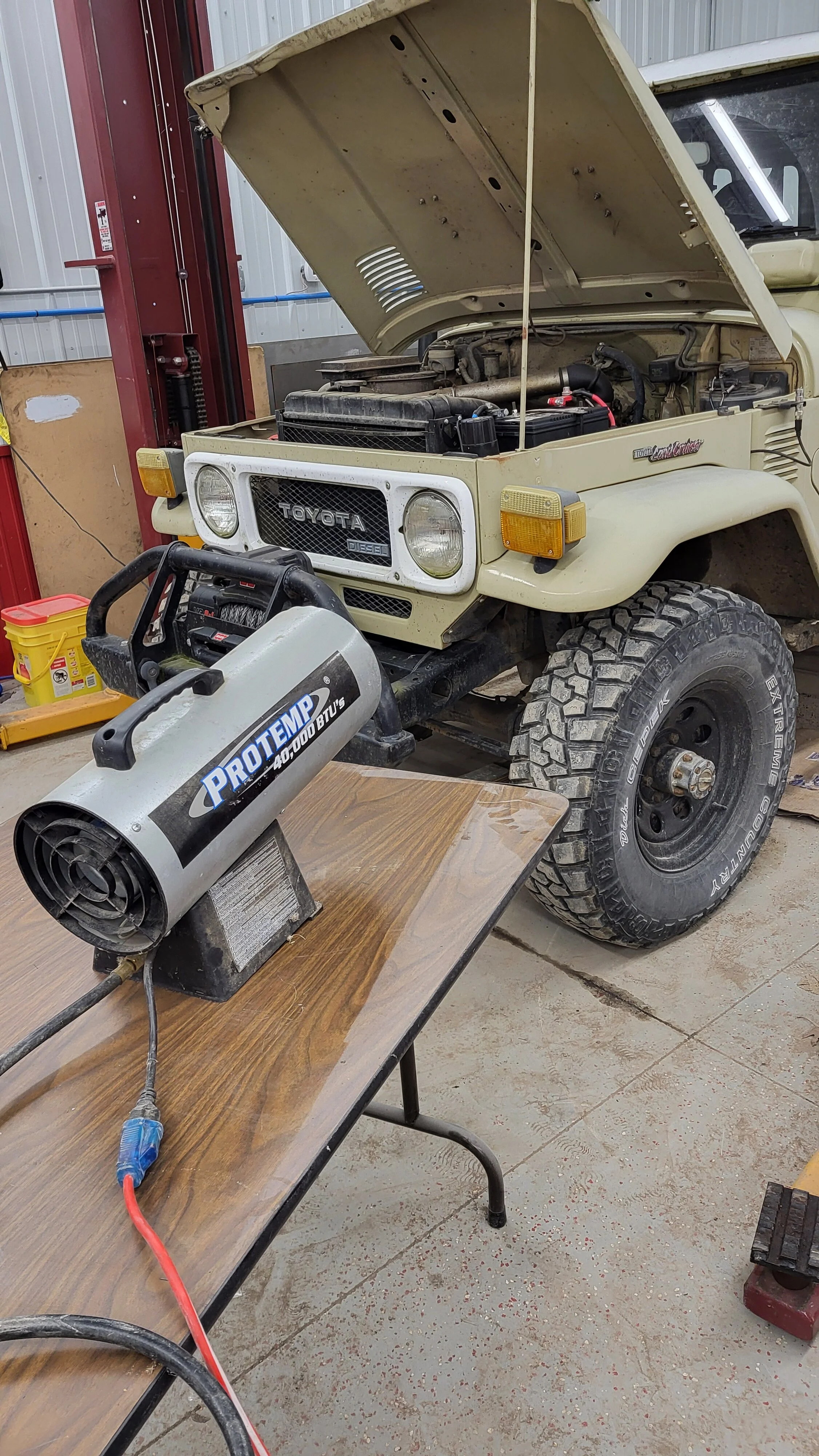

In February a bunch of friends made plans to meet up at Rouch Off-Road Park for one of their birthdays. Did you know untreated "summer" diesel gels up at 16 degrees Fahrenheit? Because it was 15 degrees overnight.
full
That killed the old off-the-shelf diesel pump I was using to supplement my weak injection pump. Went back to O'Reilly's and got another one, but not in time to bring Kiwi to the event.

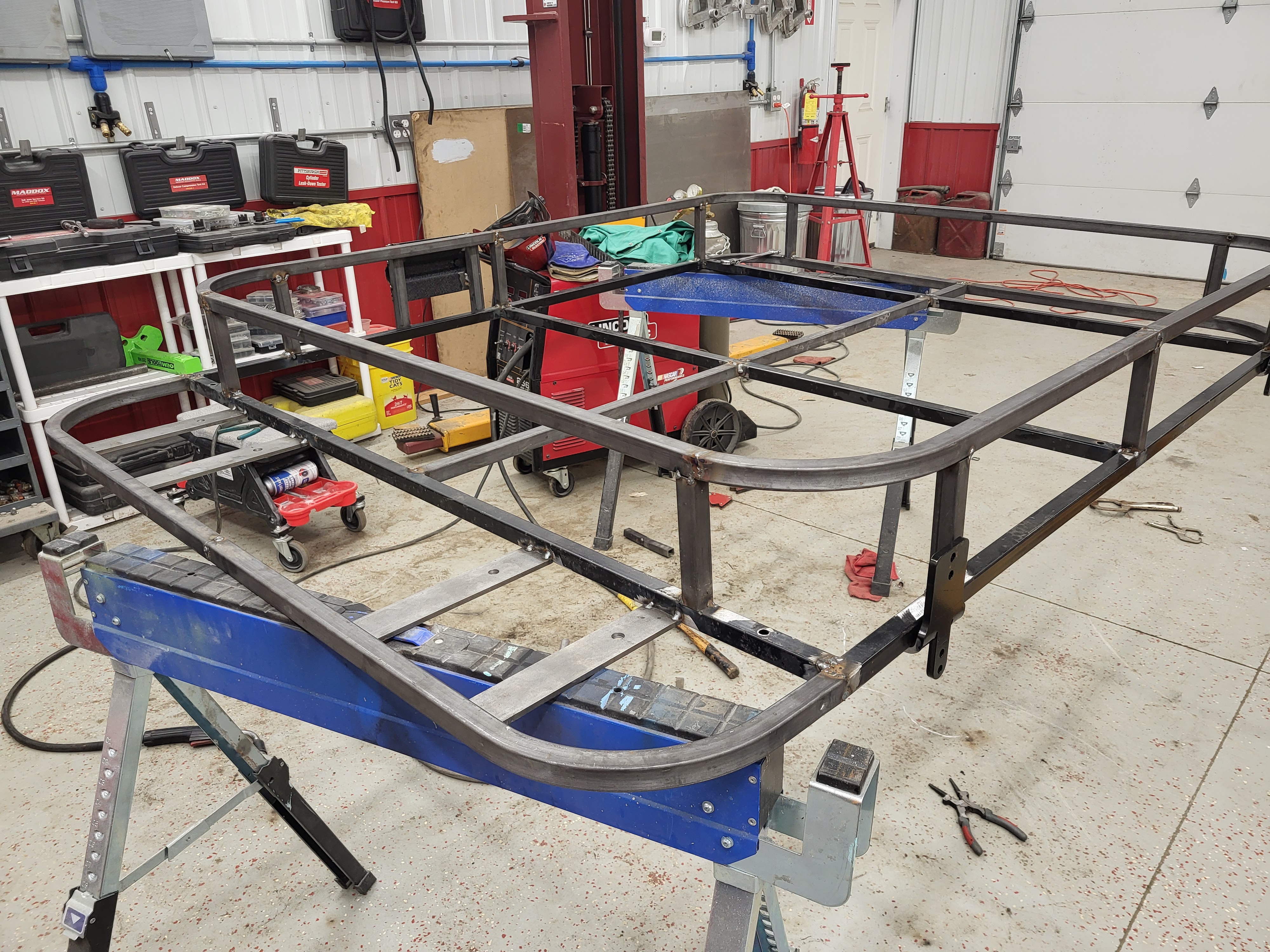

And then in May-ish I started on phase 2 of the roof rack. Grabbed a square tube die for the bender and got to bending, cutting, fitting, and welding
full
full
I added on a couple of little brackets, two to hold the awning, and one for the axe and shovel
full
Then just a quick rattle-can black paintjob for now. Phase 3 is coming sooner than 2 took, I'll powdercoat it then.
full
Here's the test-fit with the KC HiLiTES Daylighters:
full
Those lights are so happy. I love them.

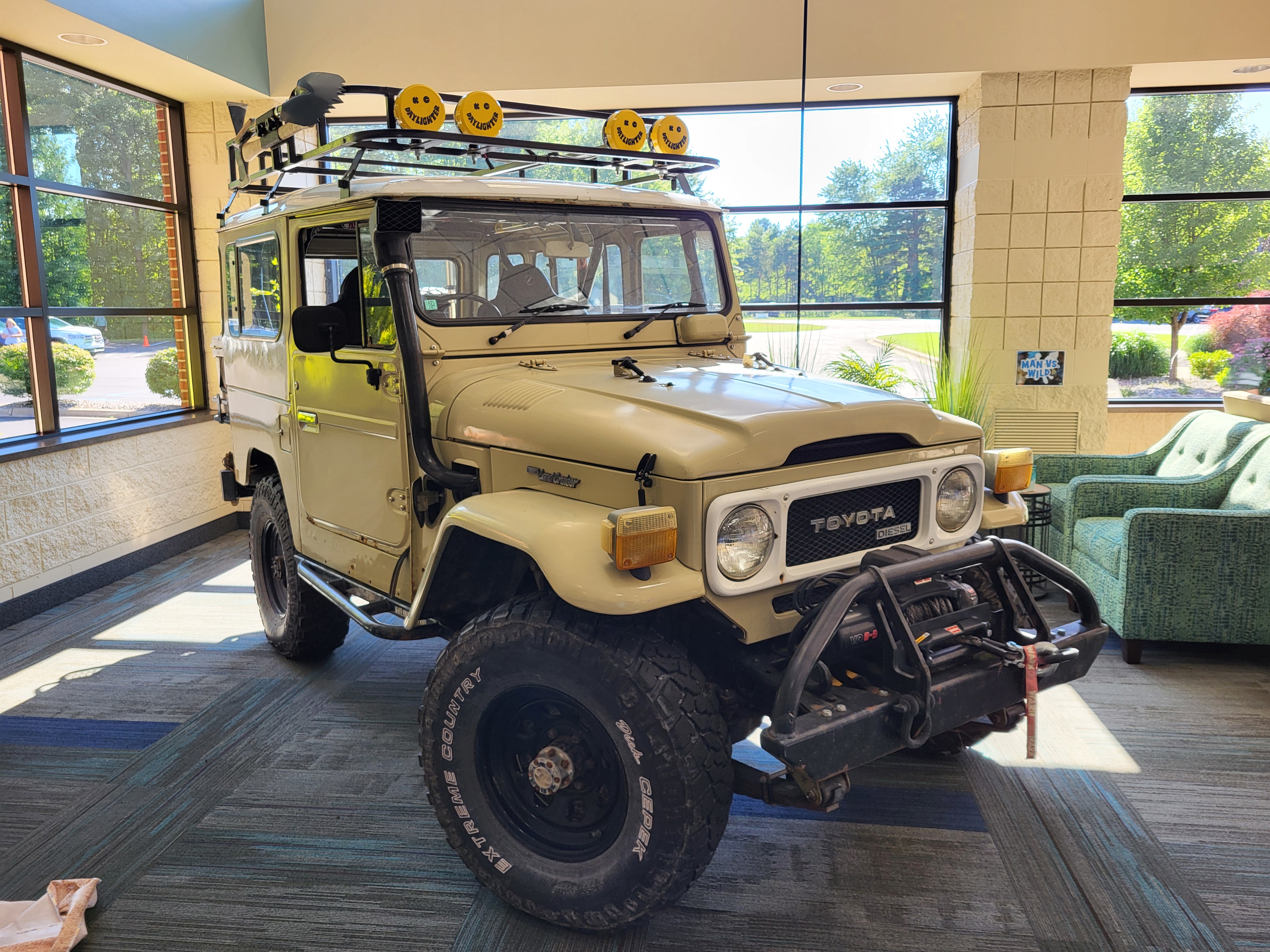

Then I did something a little strange with Kiwi.
My church was doing a summer kids day-camp (VBS, if you speak churchgoer) and the theme this year was a nature safari sort of thing. And, well, Kiwi looks like the quintessential "Safari Truck" so I loaned Kiwi to the church for a few days. And they put it INSIDE THE LOBBY.
full
Not shown: The absolute ordeal it takes to get a lifted Toyota Landcruiser through multiple sets of double doors and down a hallway without starting the truck and filling the church with smog. I had to take the rack off to fit through the doors, so that's why it's not actually clamped down.

Next steps are finishing up the roof rack (It needs a proper floor in the rack, then I can actually carry things IN the basket) gonna do some modifications to the seat brackets (I, at 5'8", need the seats ALL the way forward to reach the pedals) and build the center console while I'm at it. maybe.

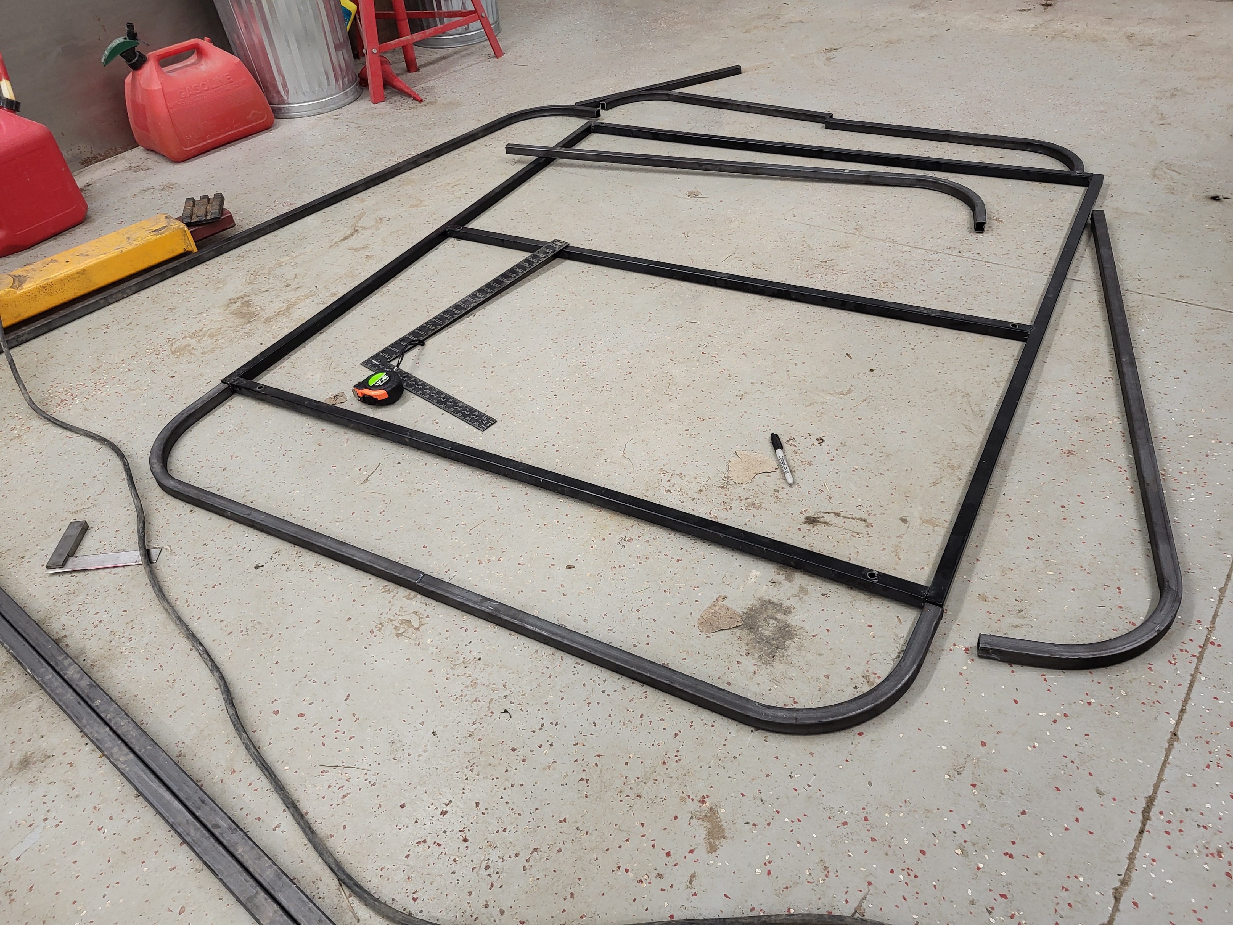

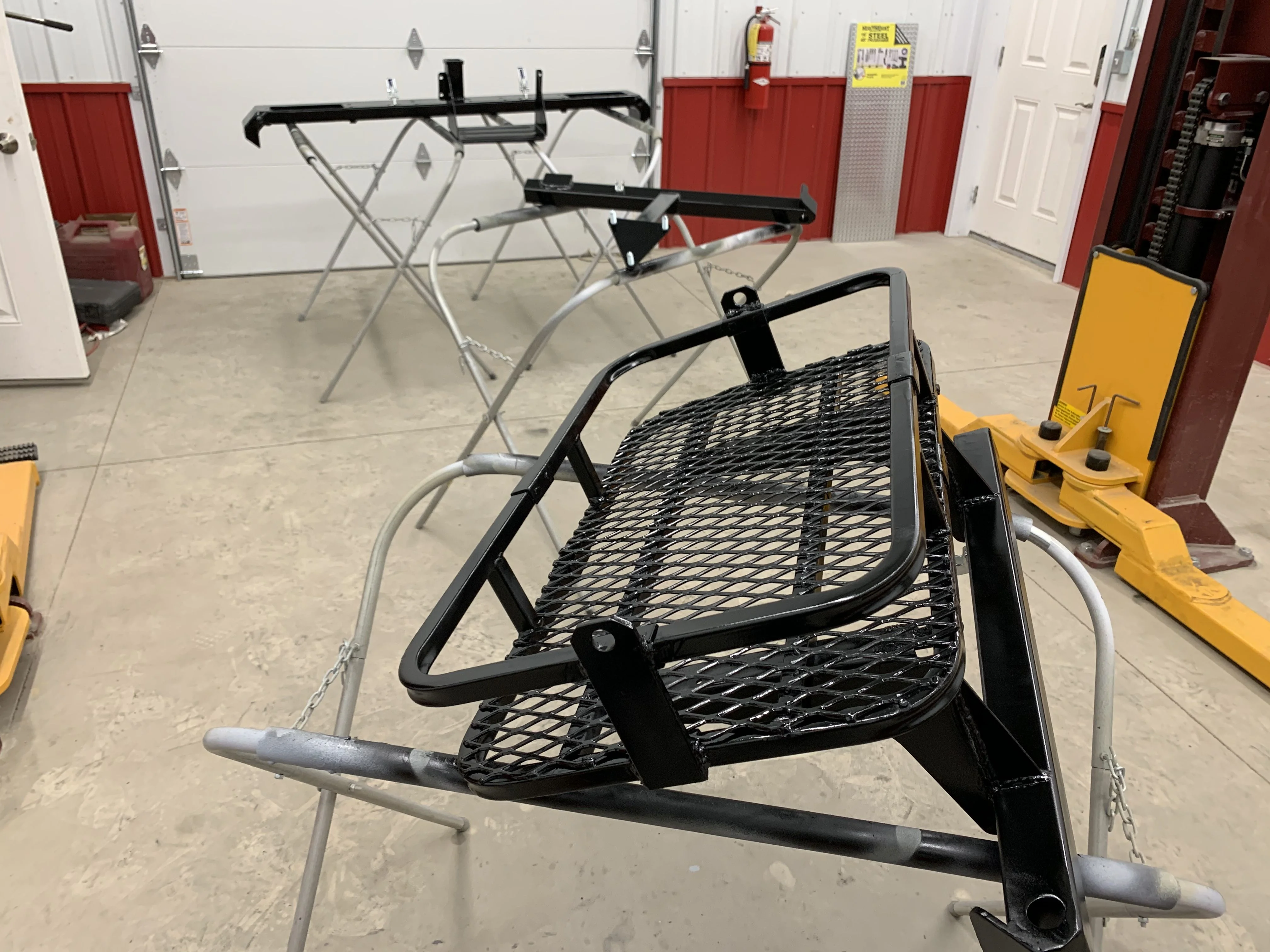

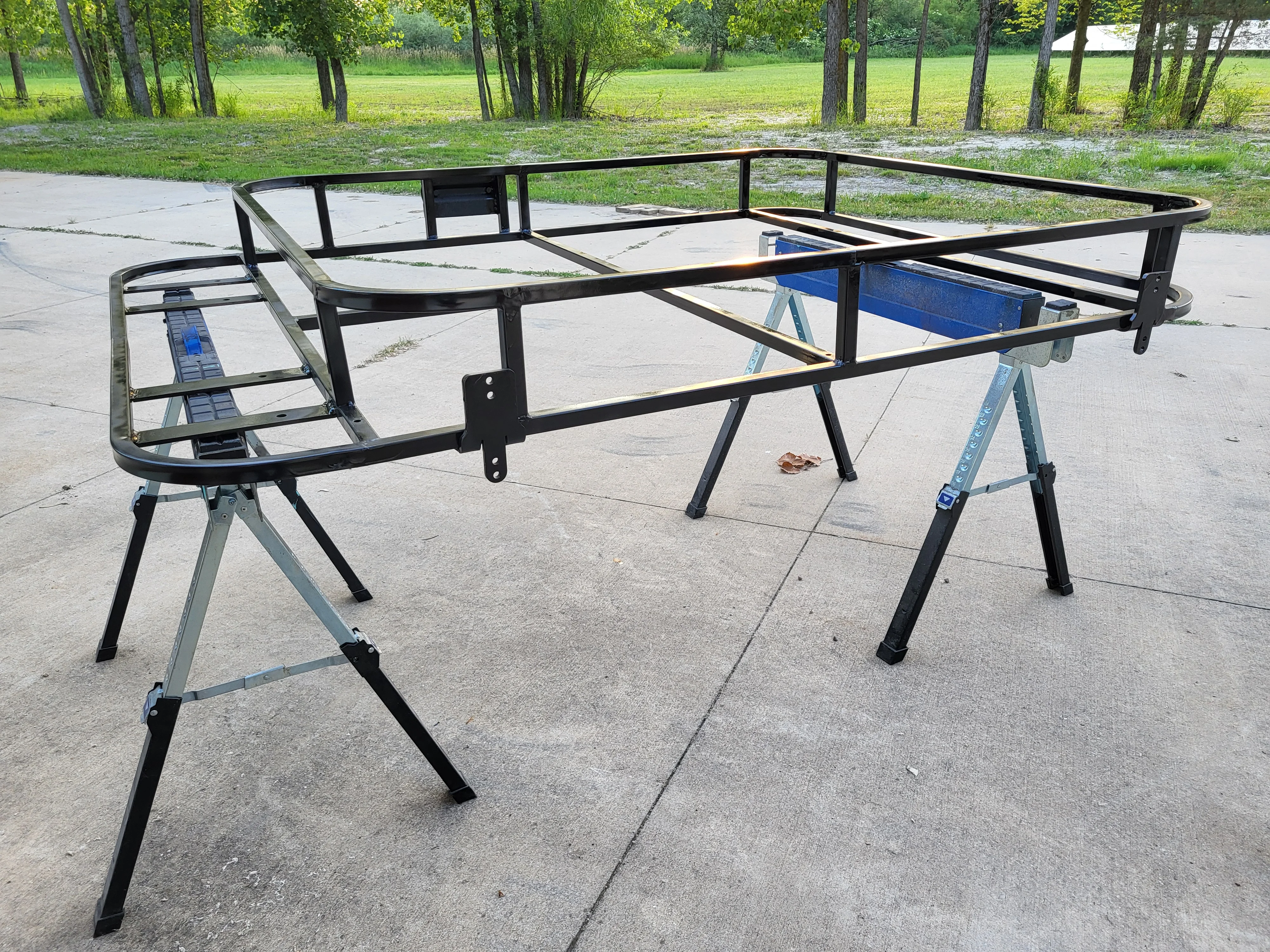

This spring I did what I said I was gonna in the last post, I put a floor in my roof rack.
full
Since the rack is more than 4 feet wide in both directions, I kinda had to piece it together out of 2 sheets of expanded steel. I set the 2 sheets on the floor edge to edge, flipped the rack over on top of it, and traced the outline. Then I just cut a little inside the lines and finagled the 2 resulting halves in. At that point, I realized I should have probably stripped the paint off the rack BEFORE I wrestled the floor into place. I guess I'll try to rermember for next time? A bit of shifting the pieces around while I lasered the paint off and I got the job done. After that it was a simple weld and grind process.
full
My dad was a HUGE help and painted the rack for me, plus he threw together some brackets to hold the recovery boards. Then it was the usual rigamarole to get it back on the roof. (This would be easier if I were taller.)
full
Next came a little side-project that made use of an unused feature of my previous work. When I built my rear bumper in 2020, I thought I was going to build an exo-cage at a future date to mount my roof rack to. In hindsight, I am glad I didn't. It would have been a lot of extra engineering, and I prefer the cleaner rack setup anyways. BUT that meant there was a set of mounting holes on the ends of the bumper that forever served no purpose. Well, I found a purpose! At the beginning of the year, I got a dog. He is a very good boy, but he's also much too strong to tie him out on a normal ground anchor if I take him camping. So I found a retractable tie-out cable that's rated for (well over) his weight, and welded up a bracket for it that will bolt into those unused mounting points. And here's the good boy himself modeling the result.
full
Shortly after this photo was taken, he crawled under the truck and got a HUGE grease stain on his back. 🤬

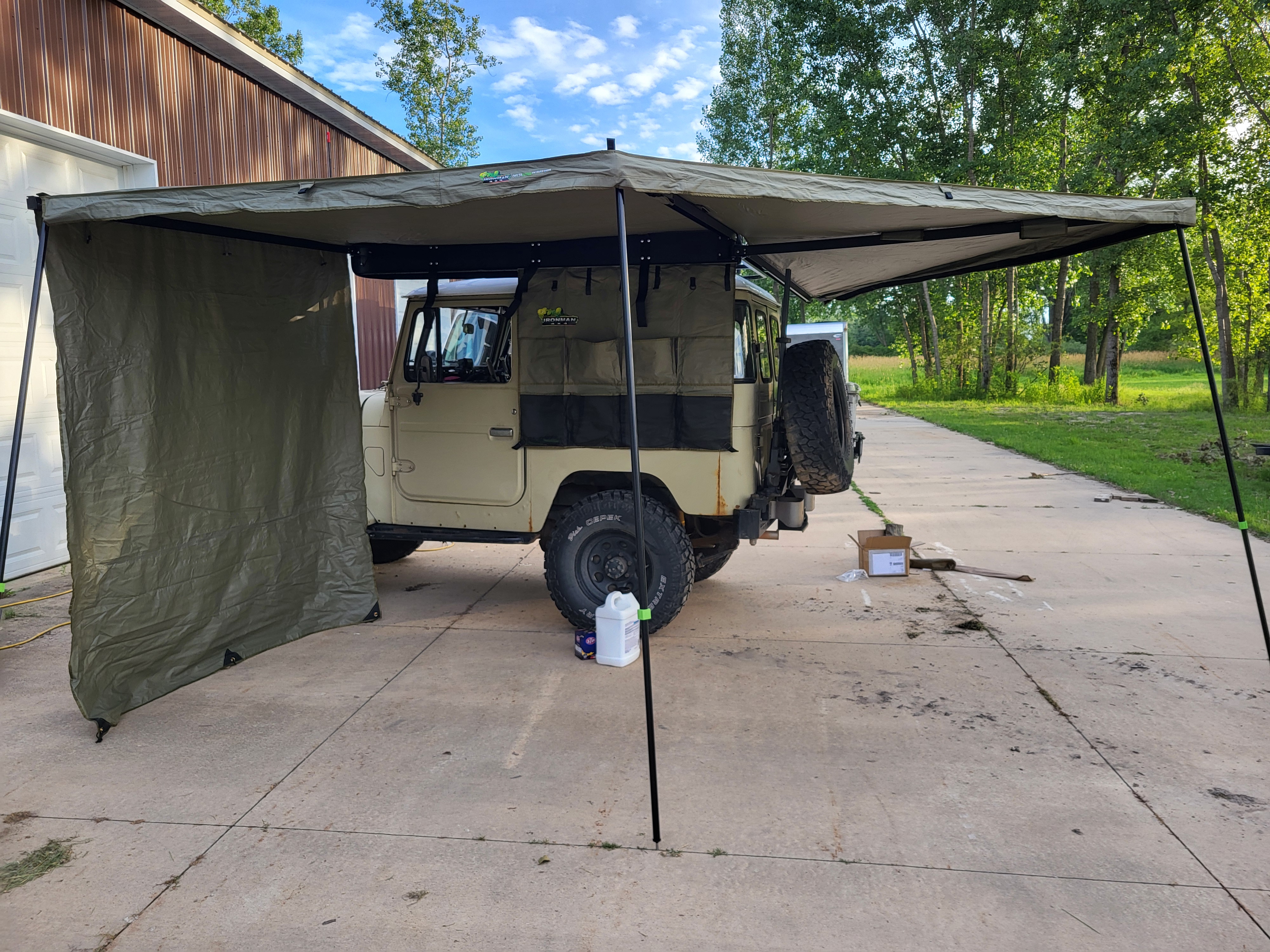

And then it was time for the usual camping trip that rains a bunch on day 1 and reminds me why I got an awning.
full
