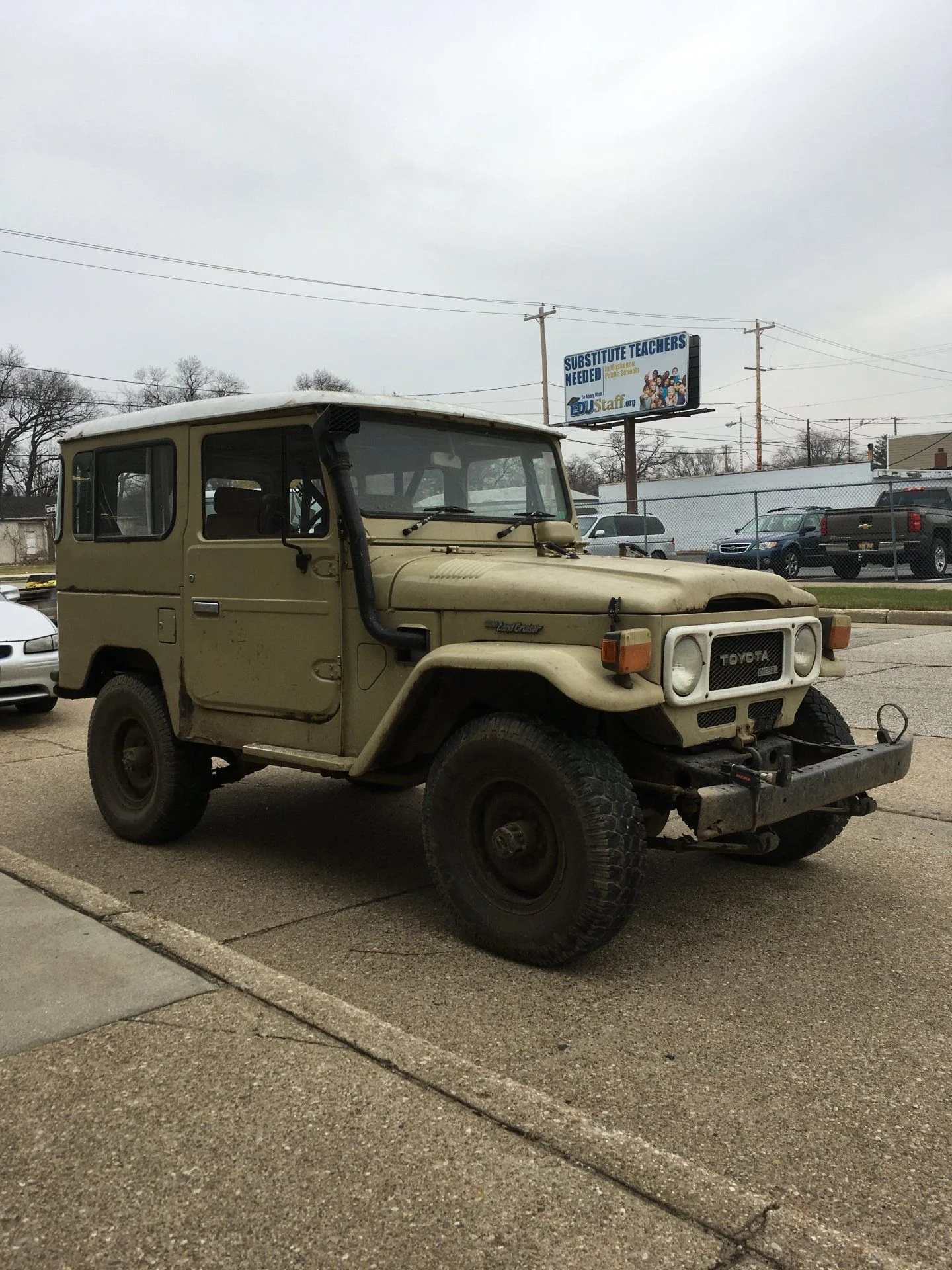

Well, I finally did it. I took the plunge after over a year of agonizing and planning and searching. Last weekend I was kicking around on eBay, and found the OBO ad. The truck was close by, so I sent the seller an offer, pending an inspection. He accepted and my dad and I hopped in a car to go check out what may be a huge mistake, or may be the truck I keep forever. It's a 1980 BJ42, Right-hand drive, P.O. imported it from New Zealand. It's rusty, to be sure, but the frame is solid, and the original motor starts right up and runs like a top. Our test drive of it was an hour of chugging past cabins and offroading through a national forest. I was hopelessly sold. We came back the very next afternoon with a tow vehicle, trailer, and a stack of cash. Here's what we brought home:
full
I'm wildly excited to start working on it! It filled all but one of my wishlist, for half what I was planning to pay. (for the savings, I can add an H55 myself, if I want)

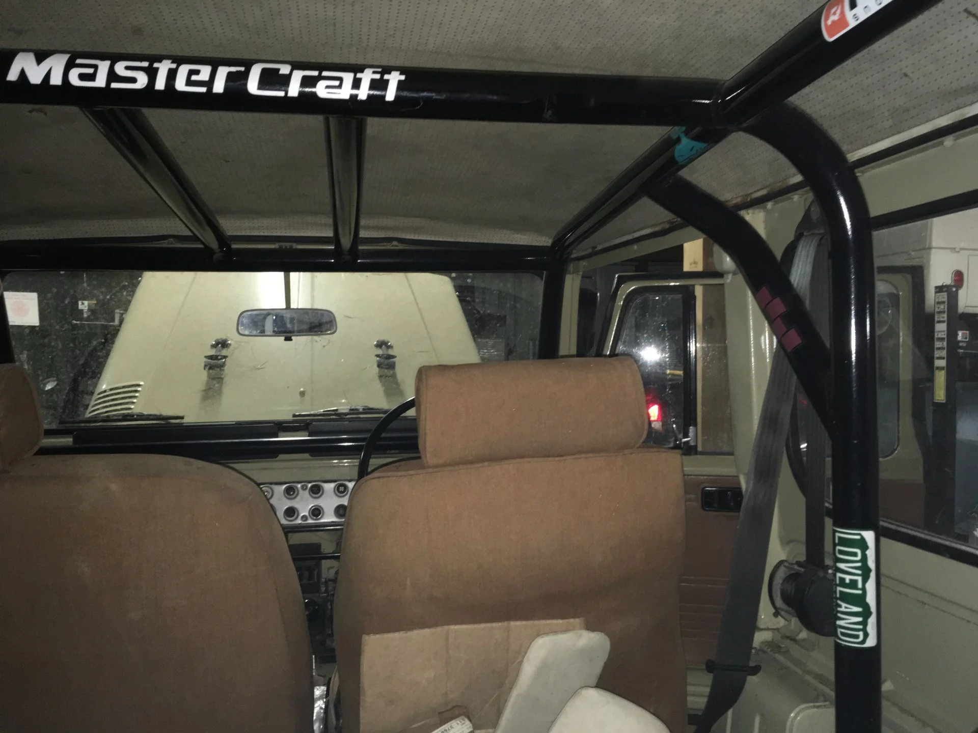

It even has the exact same roll cage installed I was planning to put in

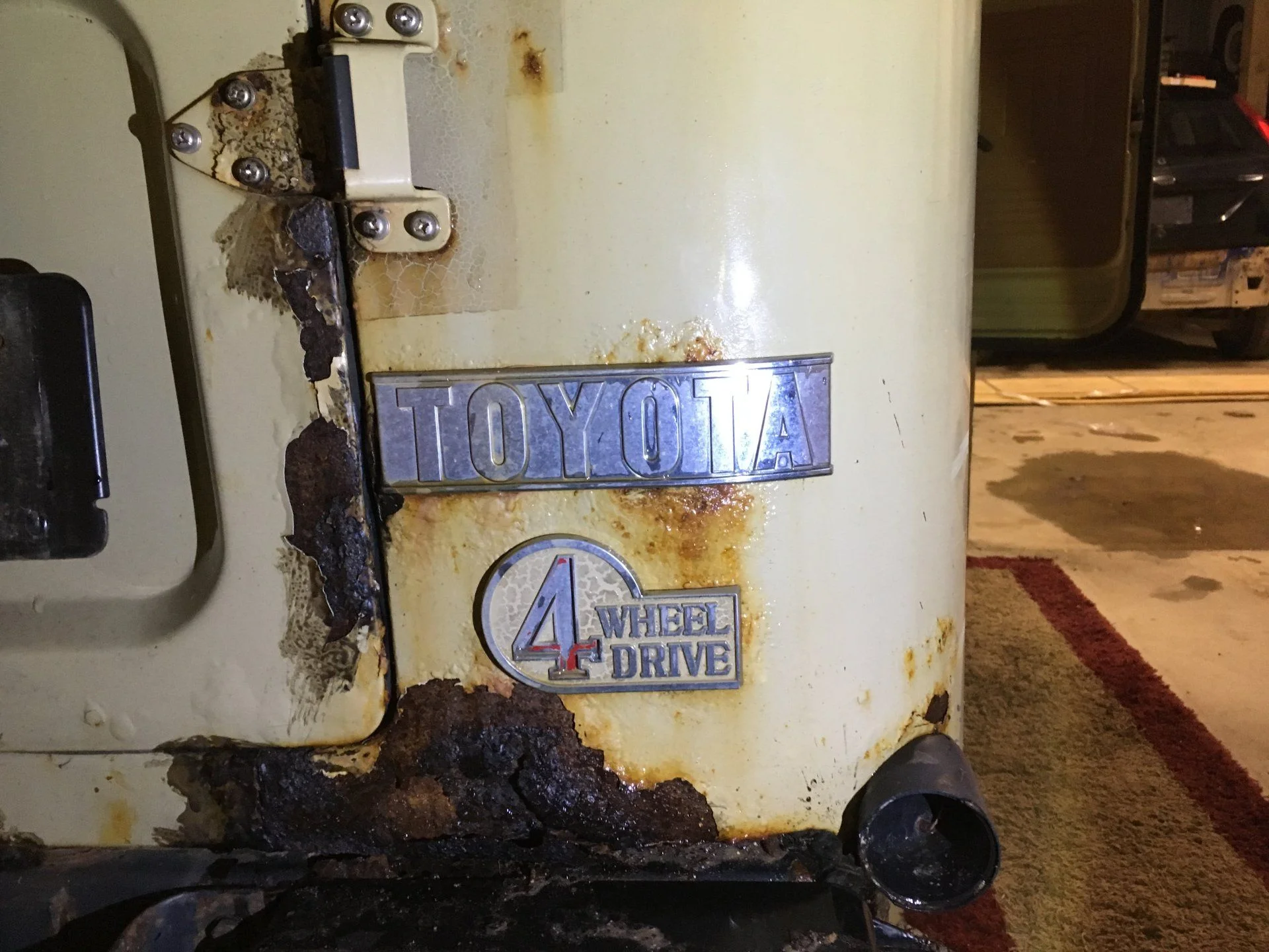

This is some of the worst of the rust. Nothing we can't fix.
full

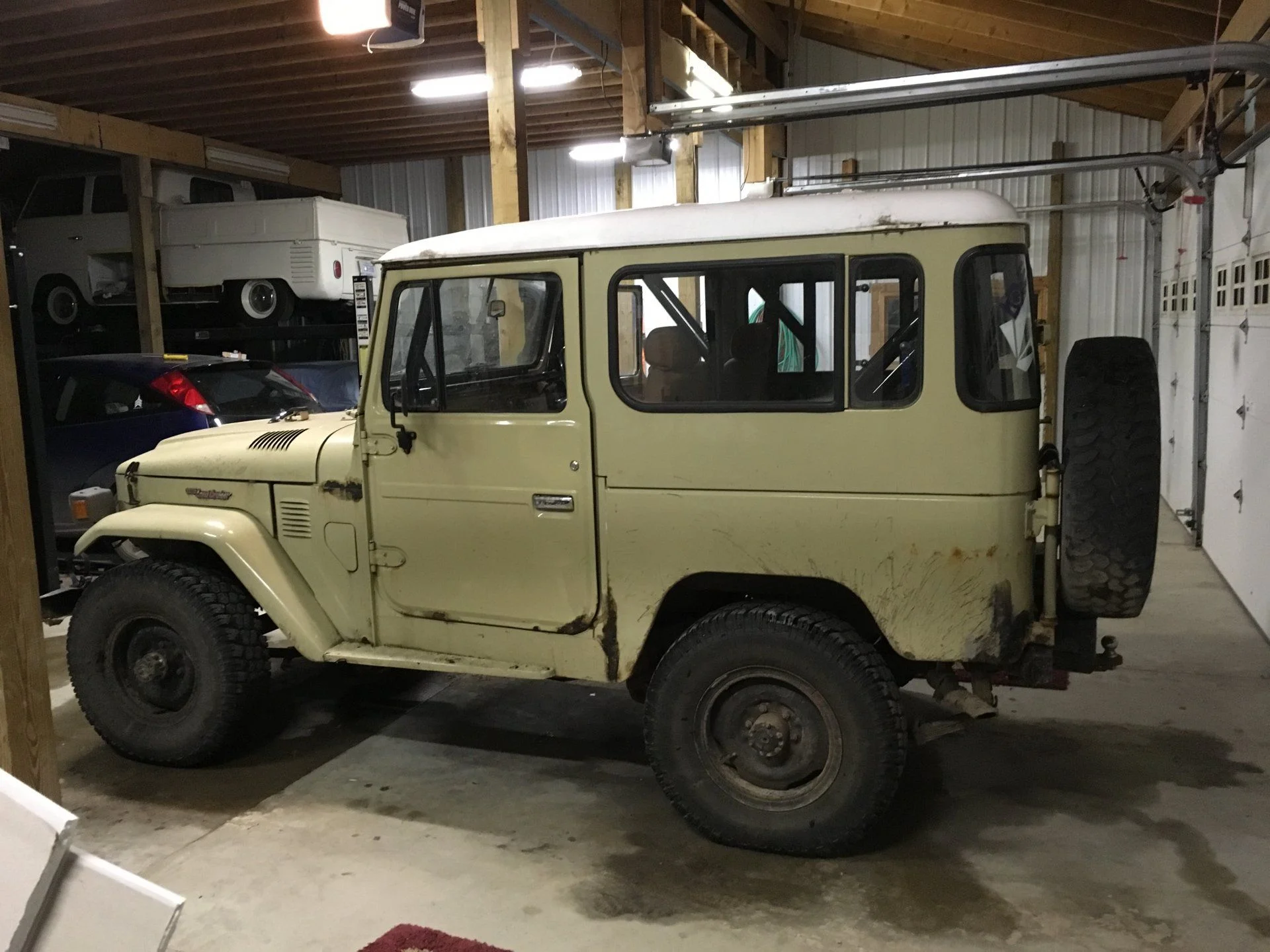

Out of the garage at home, now it's parked at its winter home, the shop where we'll be working on it.

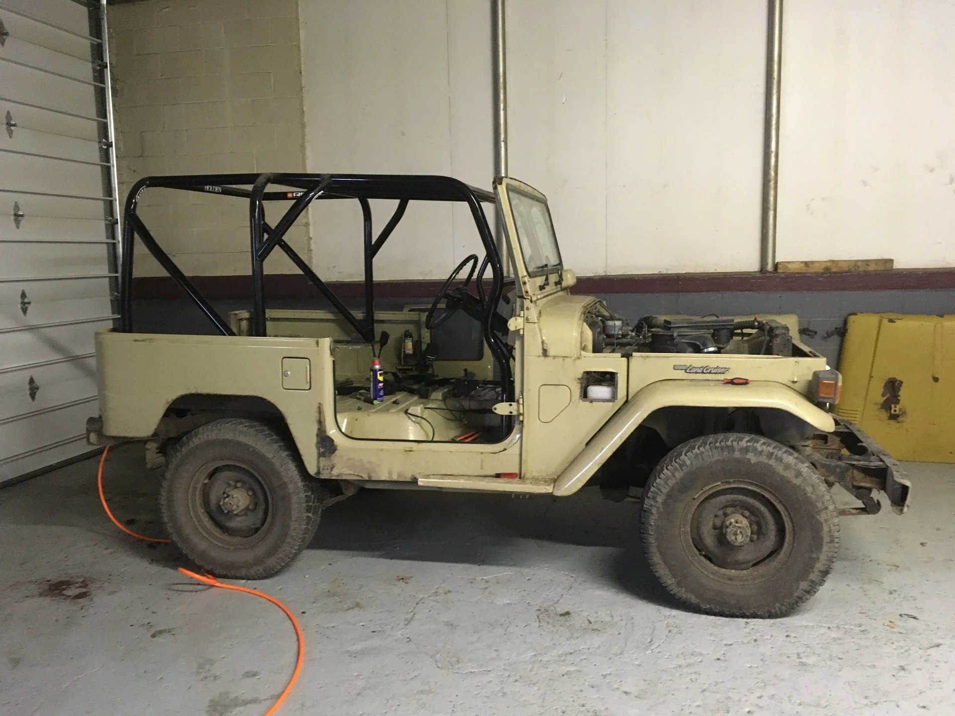

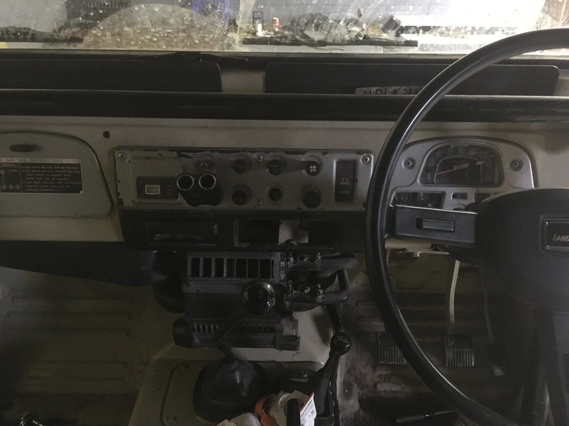

Here's a dash picture. I didn't see the interior shot request until after I had stripped the interior, by which I mean pull the seats out.
full
Here's where I got to by the time I got done working around 3:00 this afternoon.
full
Seats out, doors and hood off, snorkel removed, roof and sides disassembled and removed. (Oh, and Yakima bike holder on bumper removed)
I'm sure that's no great accomplishment for you old salts, but I'm pretty pleased. Next time we'll know what we're doing, and the bolts won't have 36 years worth of rust holding them in.

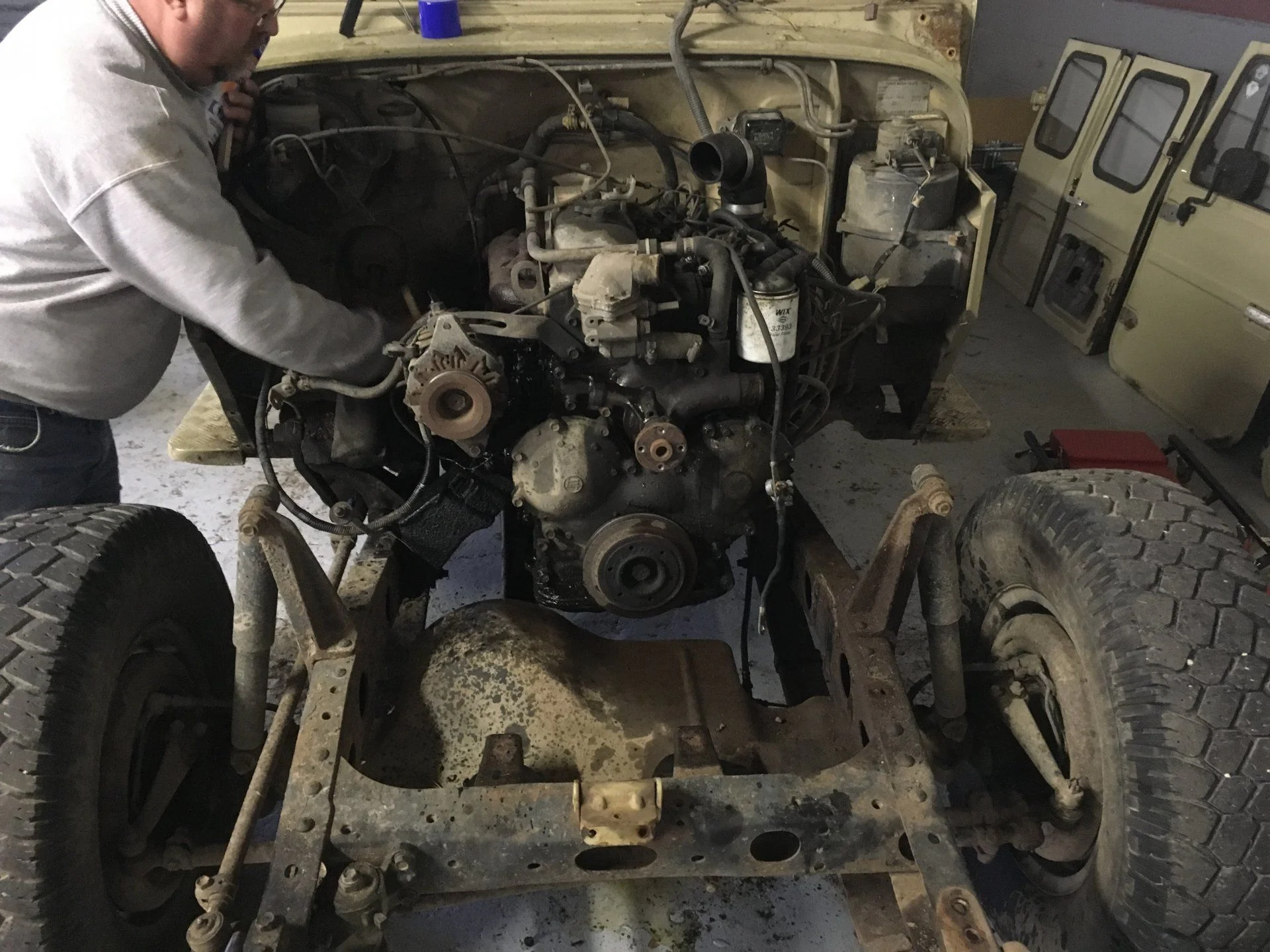

And the front stripped down.

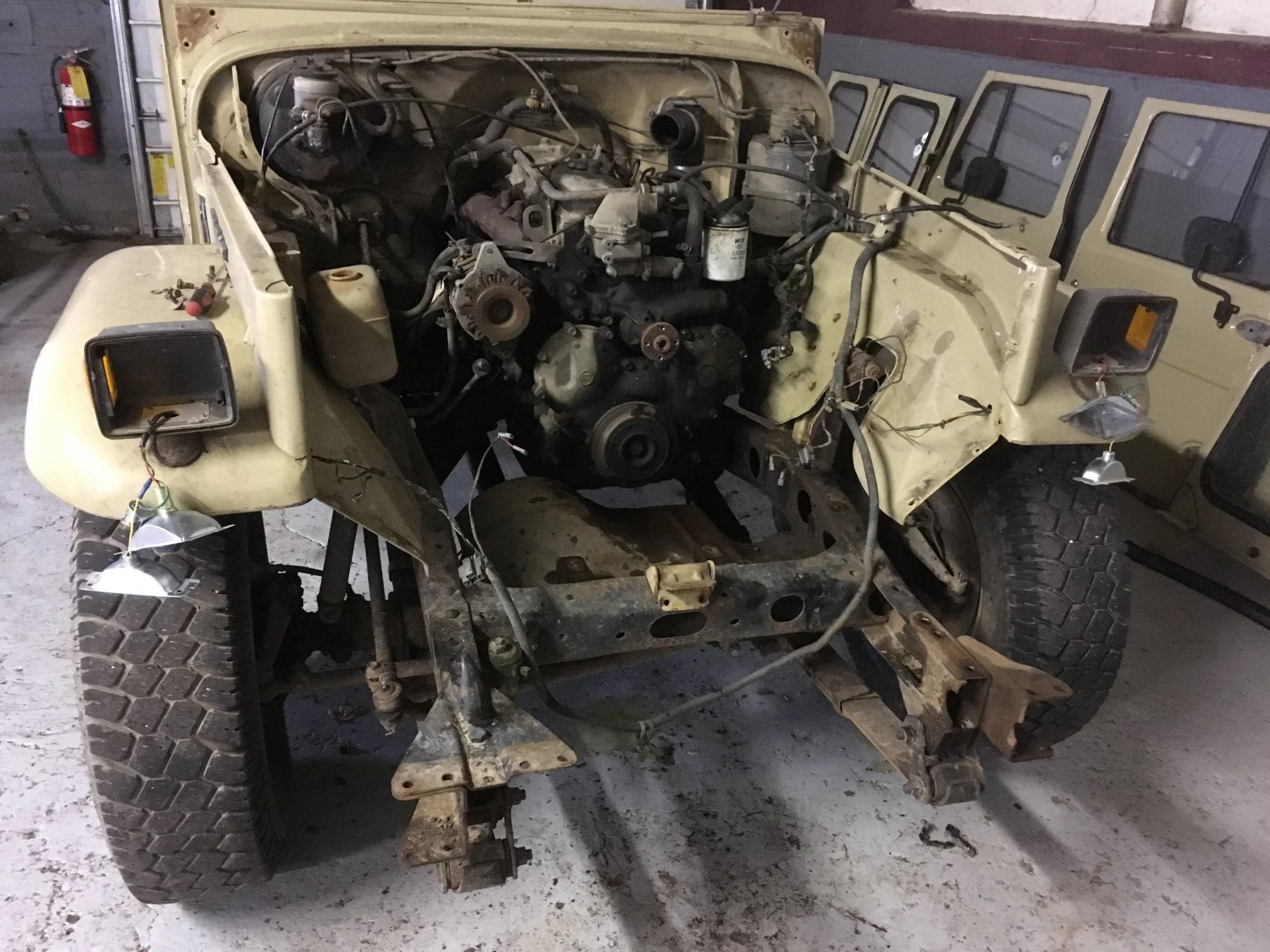

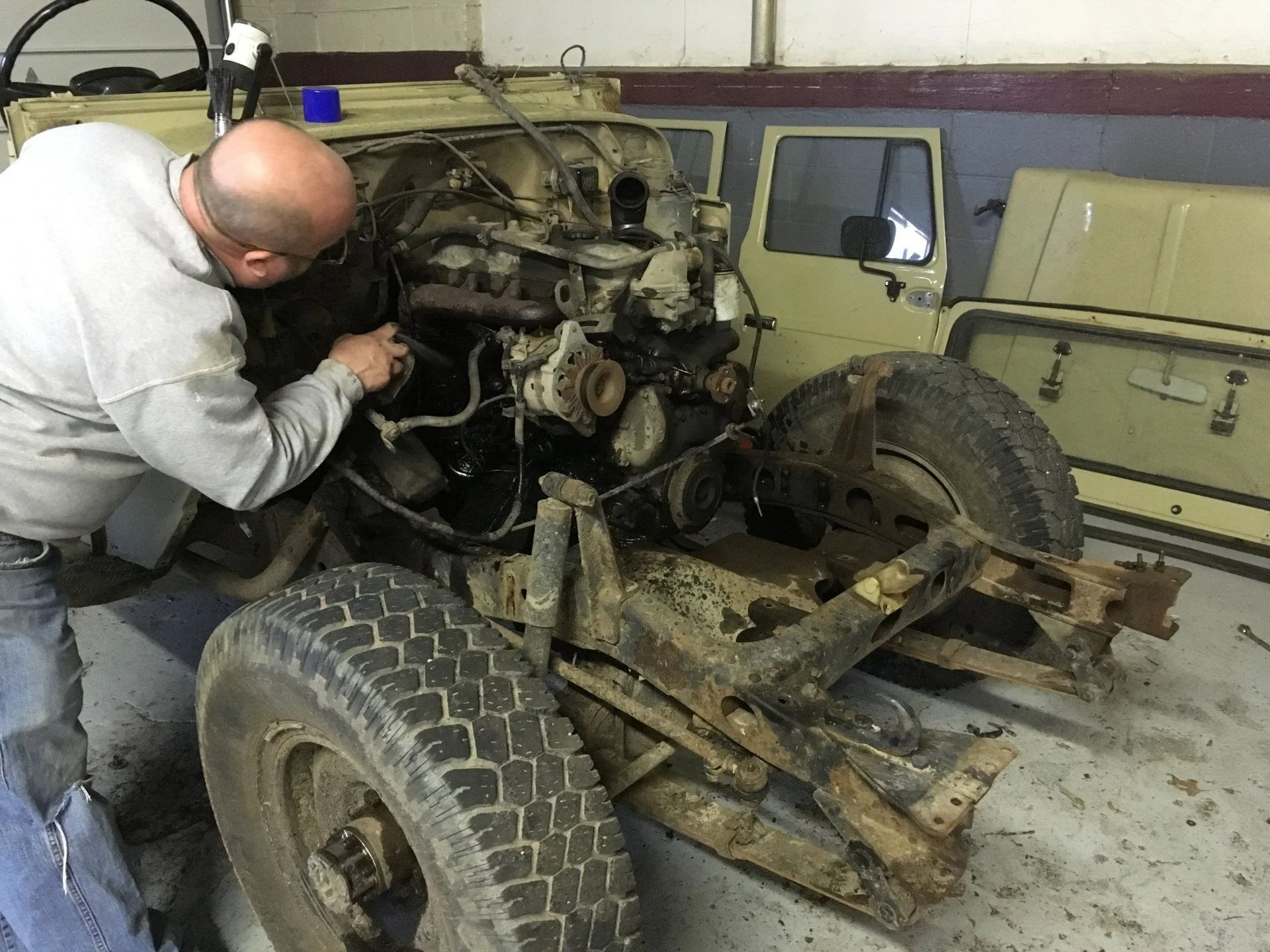

Partway through the day. Radiator drained, radiator and frame removed, radiator fan and frame removed, bumper removed, wiring disconnected, air cleaner removed.
full

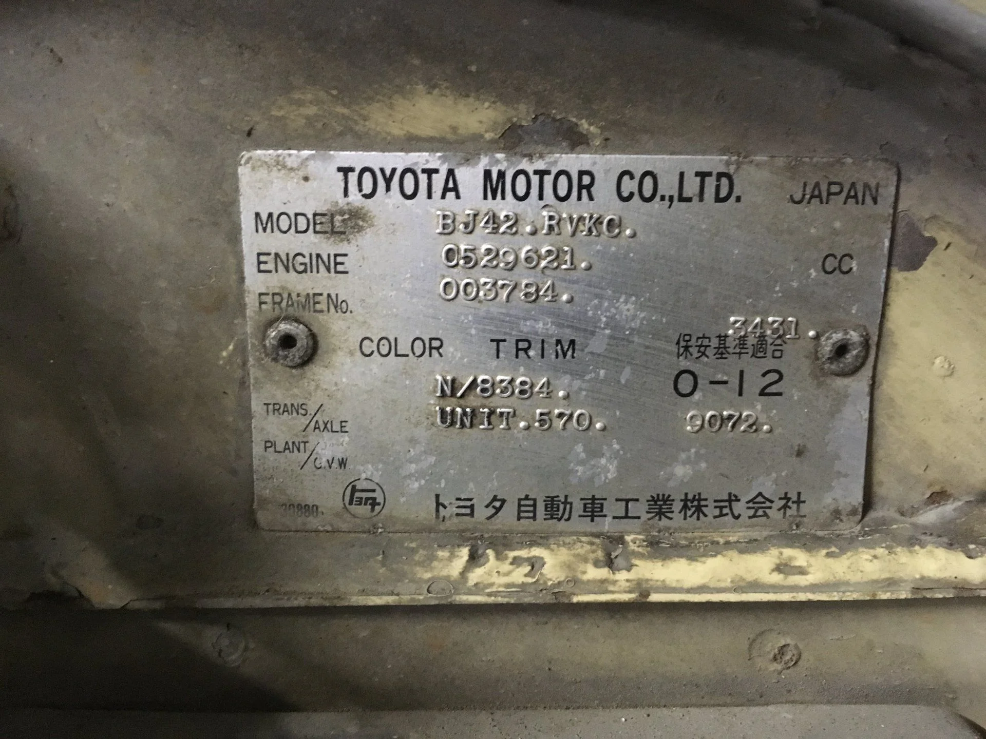

the data/VIN plate, after a bit of cleaning. I'll have to find the MUD thread on deciphering these things.

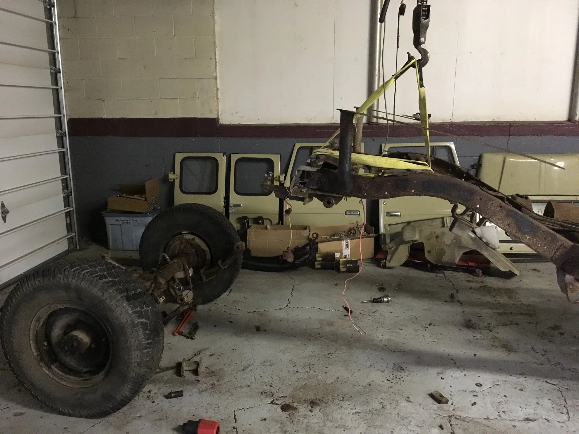

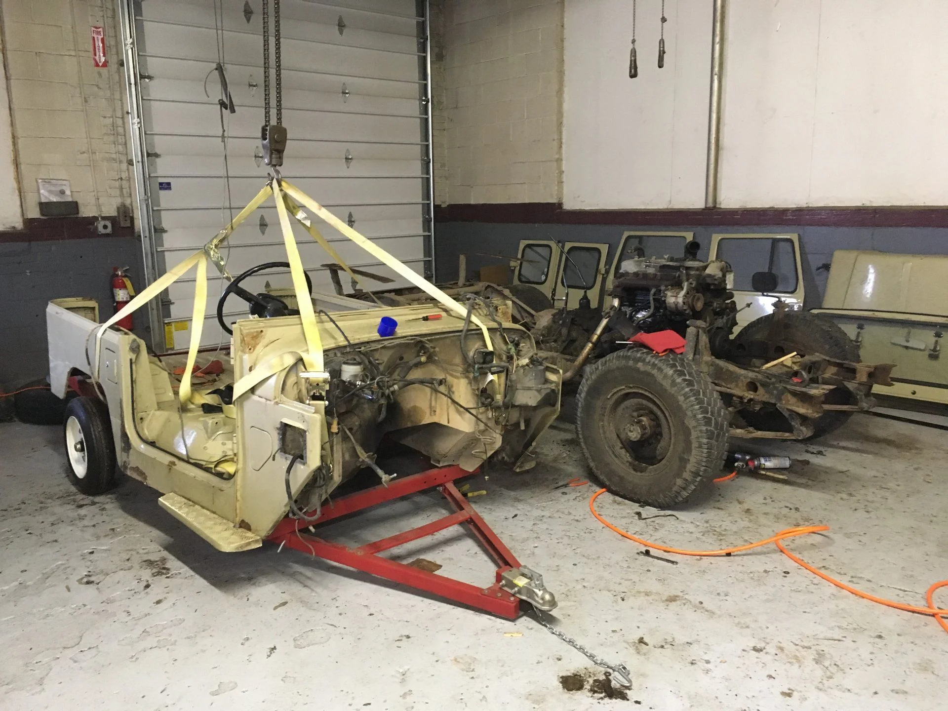

Day 5 though, (this past saturday) We have LIFTOFF!
full
Thank God (and the tool and die shop that used to be in this building) for the 5 ton gantry crane. Made this stuff EASY.
full
I had to cut a diesel line to get it free. My hoodie will never be the same. And I might have stunk up the washing machine. (sorry, mum)

And here's how we sit now, (or as of 1/14/17) with the tub resting on a harbor freight utility trailer.
full

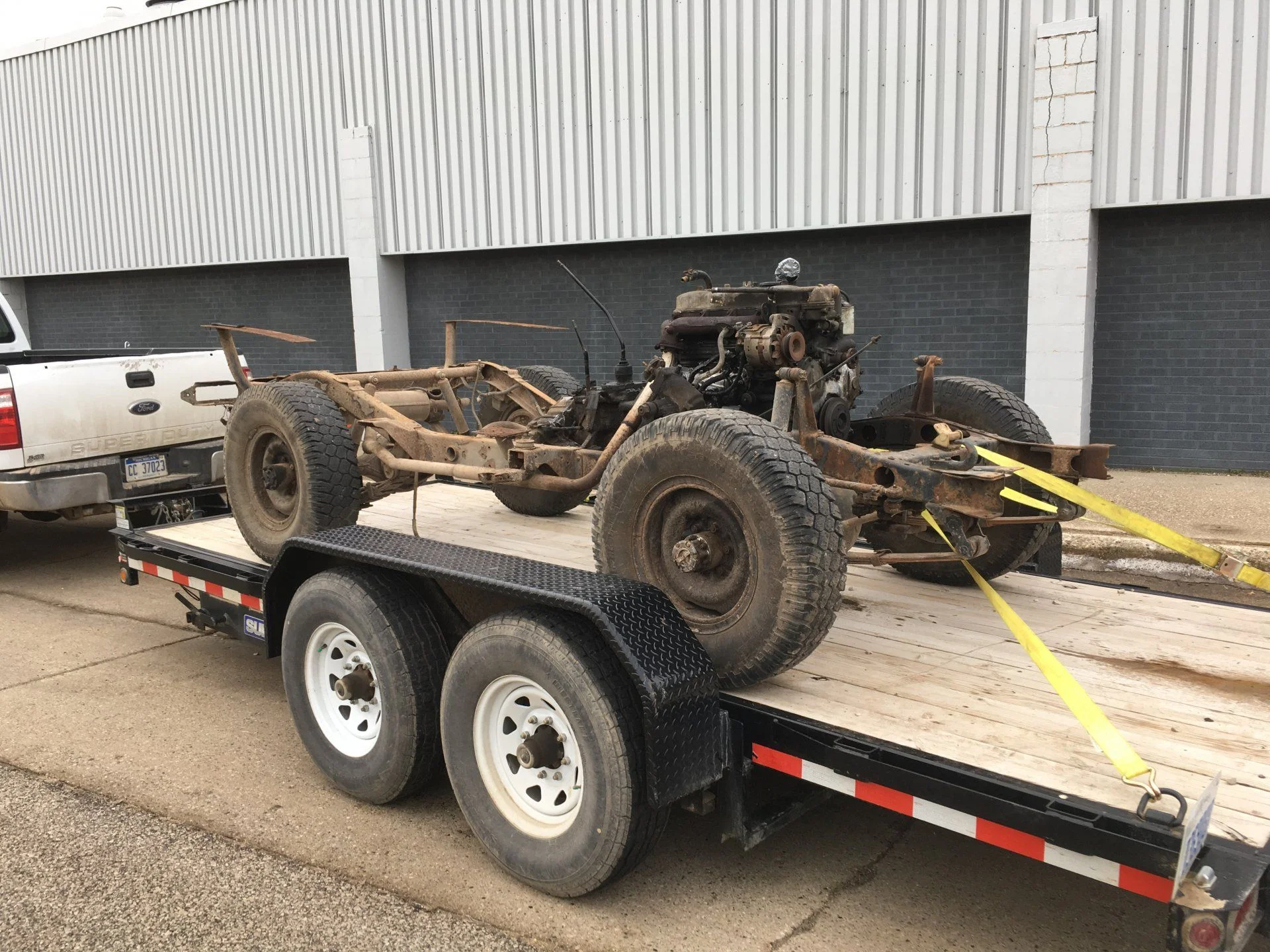

Hi guys! It's been a while, but I finally got to work on the truck again! A vacation a couple weeks ago, and prepping for the Superb Owl ate my last few Saturdays. I worked for a good while today though!

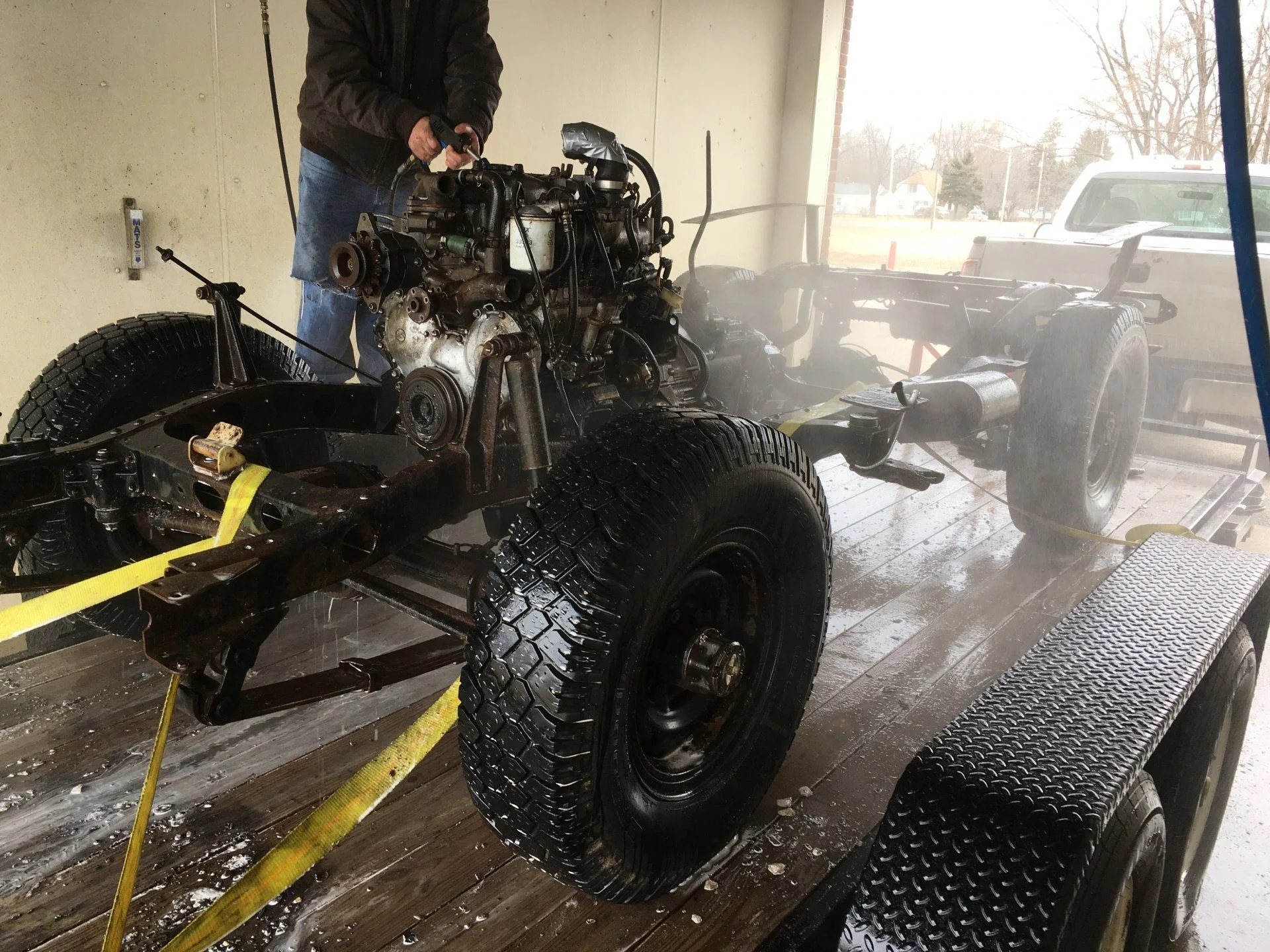

First, we loaded the frame onto a trailer.
full
Then we took that trailer to the local self-serve car wash and cleaned it down thoroughly.
