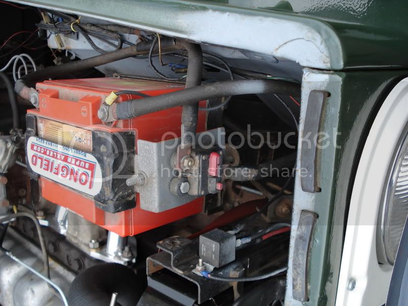

It has so far been real easy and cheap. I've never seen this yet but i'm sure it has been done. I thought about usein 7" channel but could not find it in a smaller piece under 20feet which cost over $100
I bought 20 feet of 1" 1/8 angle bracket for $11.50 at the local metal yard. All i've used so far is 57".
10" of 6inch flat bar 1/4 thick.
all I did was cut 2, 20" angle bracket and 7" drilled to the factory holes of the support and weld them all together after sizing them up with the batteries.
All I need to do now is hold downs which i'm going to by from advance auto, and wiring.
