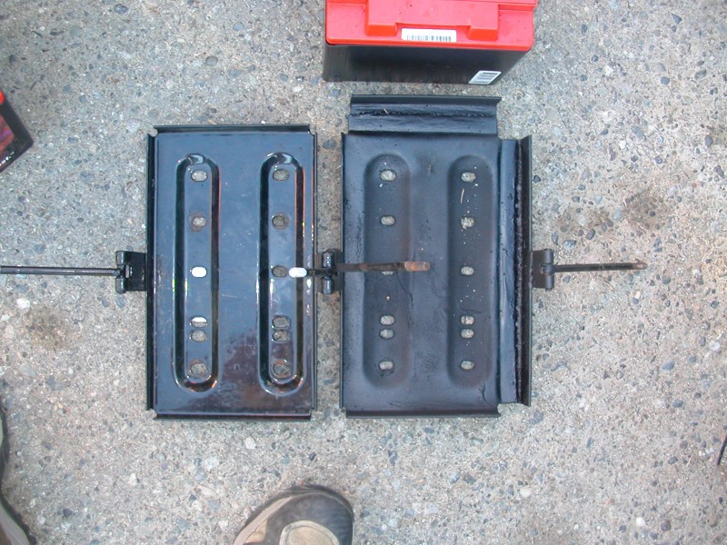

Simplest dual battery tray
I know what your talking about saving money that's what I'm all about at this point in my life. I'm not sure what all the battery trays where made out of but aluminum would be pretty nice. I know it's expensive but if affordable it's nice! Those steel trays aren't going to take long to be "rust covered".
(are those bolts already rusty or is it my eyes?)
Yes they are rusty. Do you think I should not use them? I don't really think its a deep rust. I'm going to coat everything in rust bullet and in rust bullet black top coat.

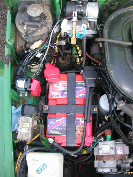

mine was also very simple, took a stock tray and made it bigger to fit a pair of Odyssey 1200's in the stock location, used stock holes etc etc. I made a simple hold down. I covered/painted the tray with some bedlinner stuff, didnt' have to move anything, ARB comp sits on the firewall using the AC bracket
tight. Are your batteries wired up in just parallel?

i took the stock tray and flattened the sides out and put two batteries on it side by side. only modification was to fab up a hold down system. a piece of flat stock on top and bottom with allthread to hold them down was what worked for that part. simple, cheap, quick and easy.
