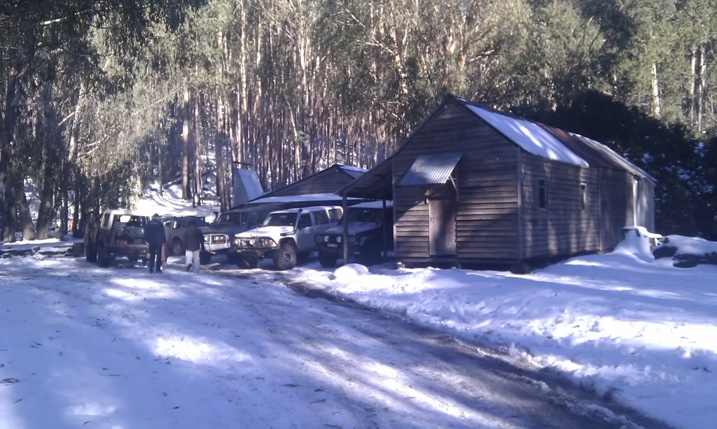

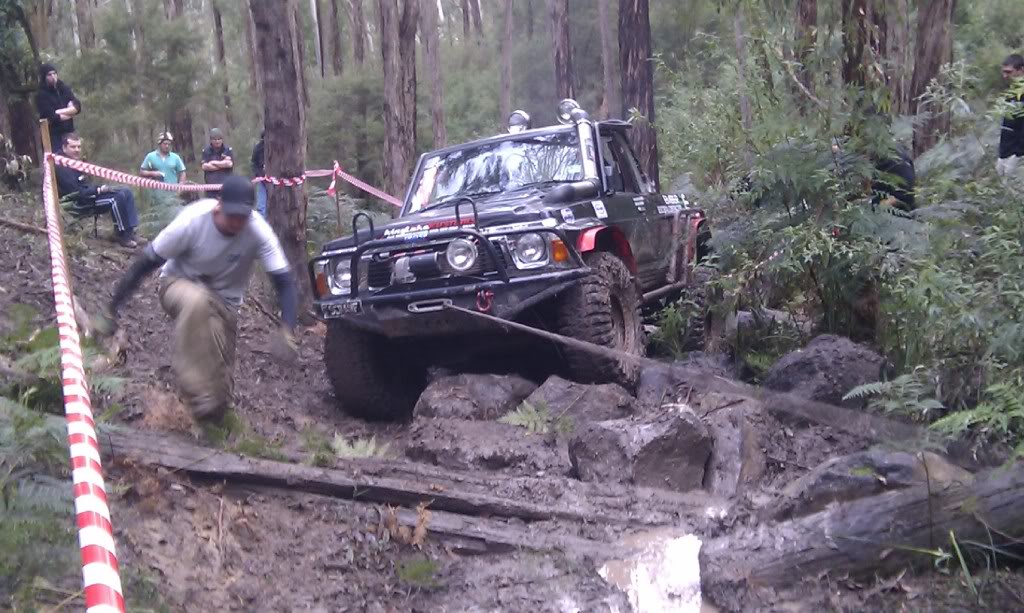

Was supposed to go out racing on the weekend, I was the pit crew for my mates, but they had issues with the permits and we couldnt race. Silly thing is though we could do the exact same tracks, just without stop watches. So it turned into a "free" drive and I was able to take my car out. Here are a couple of pics.
Cool pics mate your rigs looking good ,
Is that the "Vic high country"
That 80 looks like it surely means business
Nah private property near Warragul, here are some crappy phone pics.
