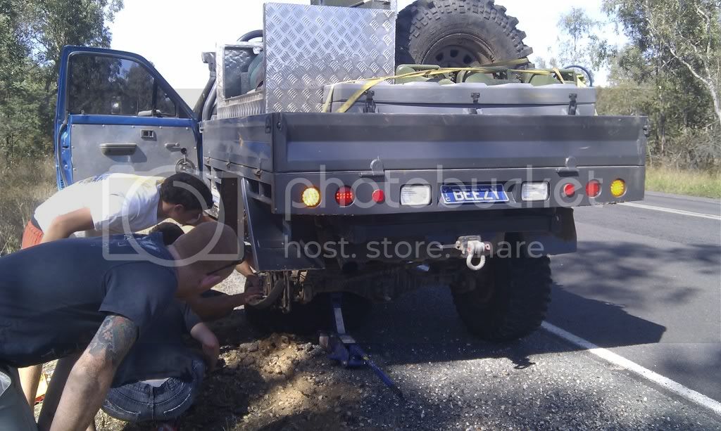

Coupla pics from a recent outing, in total broke 3 lancruiser rear axles, one patrol front cv and one patrol front axle.

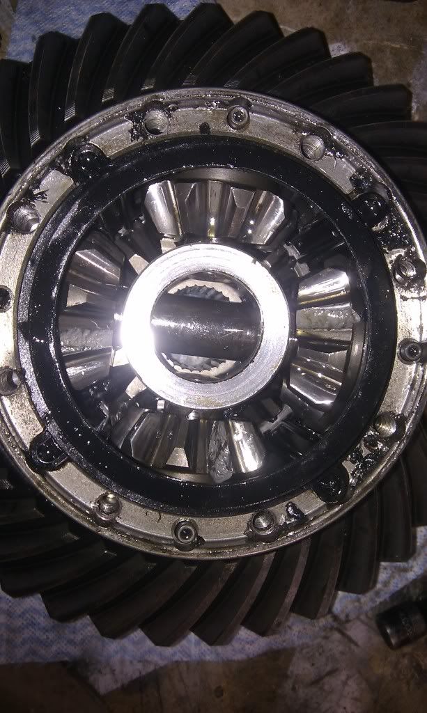

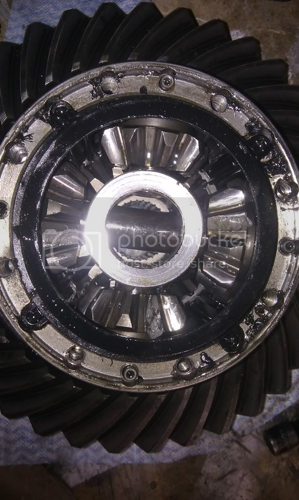

Yeah its an RD33 with bolt in seal housing, which I think is older than the clip in models. I think its around 5 years old, I think it broke on the previous trip above when I broke an axle. Didnt realise the locker broke, continued 4x4ing and a 200km drive home, didnt notice any problems. Parked the car up, went to get it ready for the next trip, drove out my driveway and found it was permanently locked.
Major damaged - 3 pinion gears, shims and the plastic piston. Minor damage, gouges and a heap of marks to many other various interior parts.
Getting prices now on the bits.
