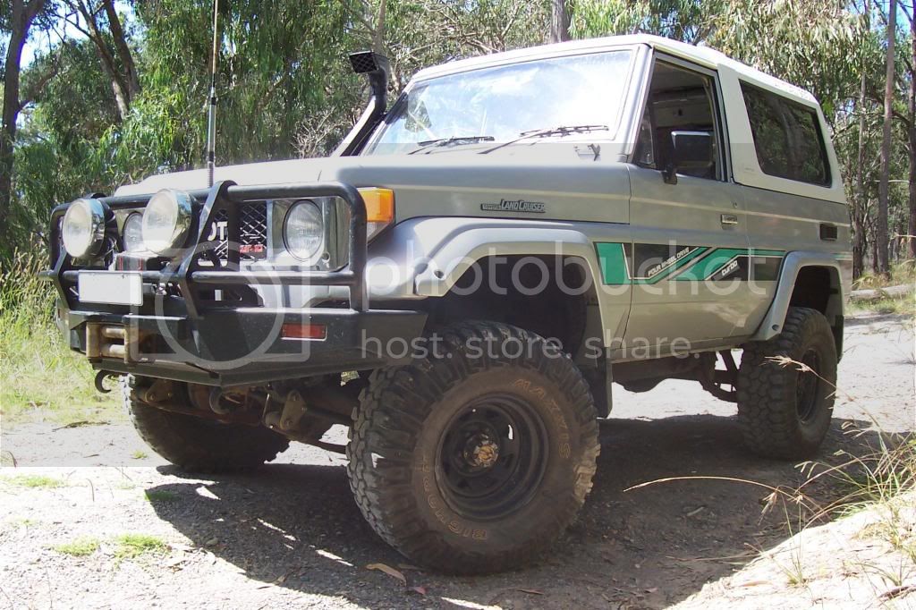

The drivings lights are IPF lights fitted with 55W HID globes and the ballasts are mounted inside the bullbar. They are AWESOMELY bright.
I've had a bit of time off over the xmas period and scored a Safari Snorkel kit for xmas.
I have fitted the Snorkel and removed the standard intake to the airbox. The space left will be filled with a ProVent 200 Air/Oil seperator system.

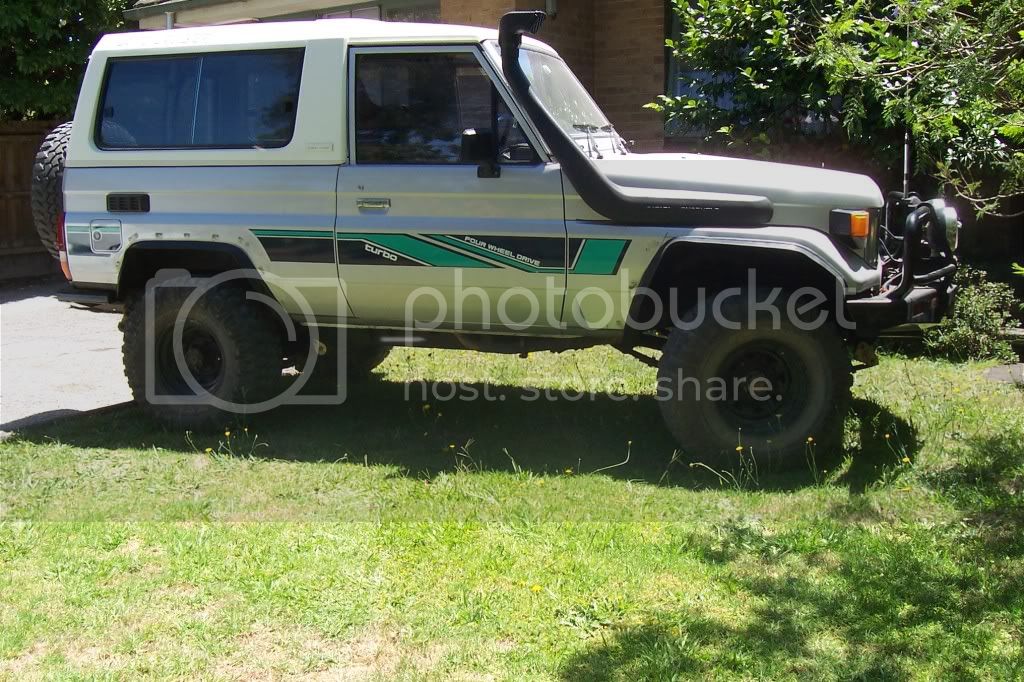

I've had a busy couple if days. Got the front and rear gaurds done. Fronts chopped 60mm and rear quarter chop.

Is there anyway you can chop or lift the factory flares to match the chopped guards?
This thing looked so good with the factory flares :)
What are your plans for mudflaps with the 1/4chop?
I will get some pics of the LED lights soon. Yes the flares are up for sale, complete with all mouting brackets and the lower rubber toyota mud flaps. I also have another spare flare I am selling with it all that needs some minor repairs.
I will get a side shot, basically I have cut the guard out to the body line that runs the length of the car and lifted the inner guards. Gained approx 60mm, plus 25mm body lift so thats 85mm!! my 35''s should clear mostly now. Maybe I should start looking for some 37'' treps!
I had a good look, if your a handy fibreglasser it is possible to mod the factory flares to suit a guard chop. I deemed it not worth the effort, even though it looked sweet. They would have been smashed off anyways. Atleast this way I can sell them to get some cash back.
Should fit 37's with that much extra room, there was a photo of another troopy somewhere with 37's after a guard chop and minimal lift, I think that one filled in the gaps chopped out of the inner guard with rubber belt screwed on.
If you get a chance, please do get some side on shots of the front guards, and inner guards, showing as much detail as possible.
Can you explain a little more about lifting the inner guards, how did you do this?
Did the whole inner guard get lifted or just the edge where it connects to the outer guard?
Did it affect available space in the engine bay, where the batteries and air cleaner are above the wheel arches?
I'll probably need some extra room under the guards eventually, so am really keen to see how/what you have done.

Pretty much done,will attach some quick pics. I still need to clean it up. If you look at the inner guards they drop down to the outer lip. I lifted this whole dropped area to be more flat. As the inner guard is curved I had to slice it and hammer it up. I then fitted and additional inner guard made from 150mmx3mm plastic screw/riveted and sealed with urerthane. I'm very pleased with how it sits, nice and low and my 35''s should fit well.

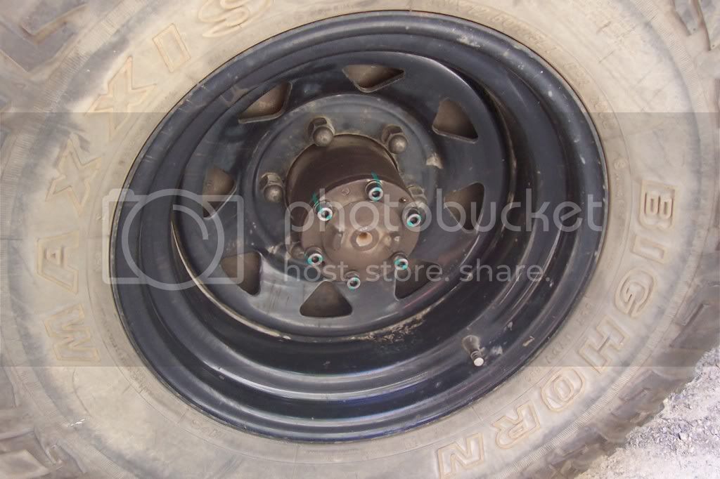

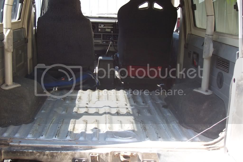

I have stripped out the carpets and rear seats in preperation for some rollcage work hopefully in Feb before my big trip. The rear table is in and I have decided to try someting with the rear axel retention. I am using capscrews, will be interesting to see how the go and if they hold up.
