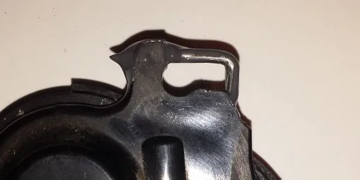

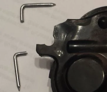

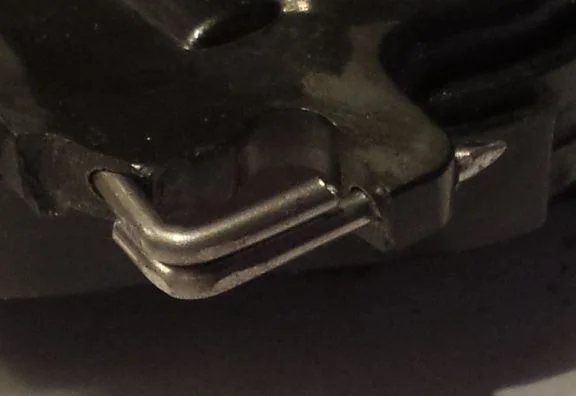

I was looking for more removable option (able to install and remove the mirror if needed) so I decided to drill a couple of holes, bend some nails and epoxy them in place. Sounds a bit 'jethro' but it turned out better than I thought and it was very easy. It did take longer then the two zip tie method.
Broken tab with the two nails

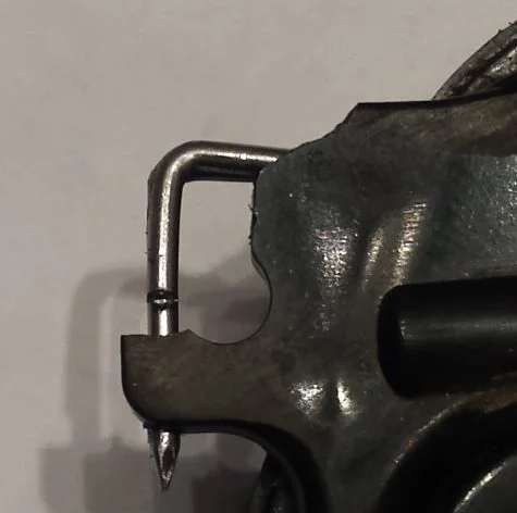

Nails in small holes drilled in the plastic. The drill hole in the top piece was about .25" deep.

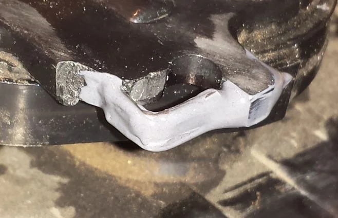

Covered with JB weld so everything is held well.
All done and ready to be installed.
I can't say how long it will last but my guess is over a decade. Well, I hope it lasts that long.
