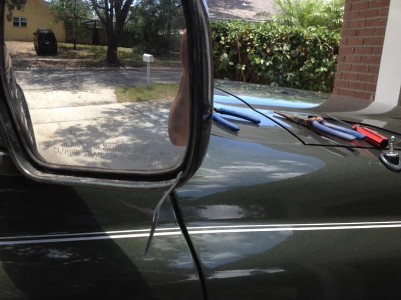

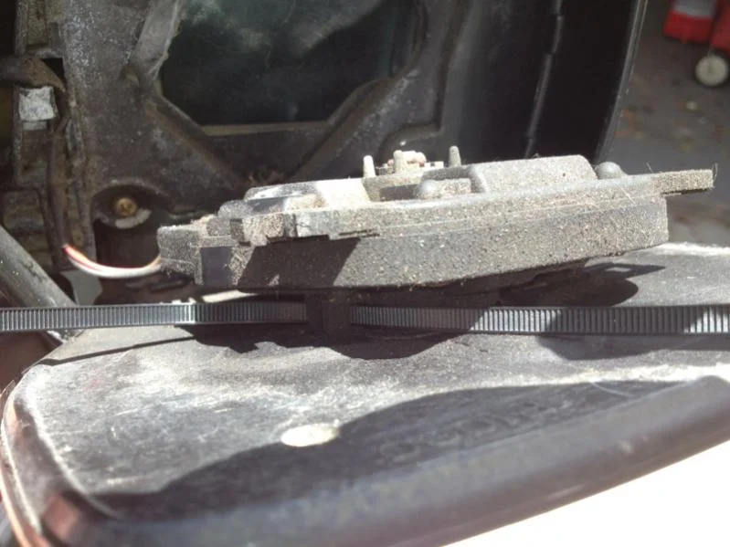

Attached two zip ties together. Run through here.

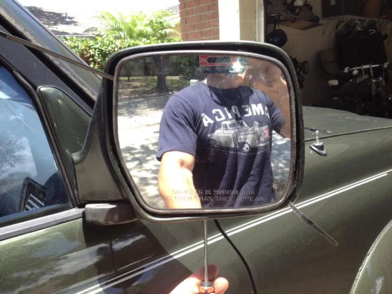

Then run the zip ties through here and attach to make a loop.

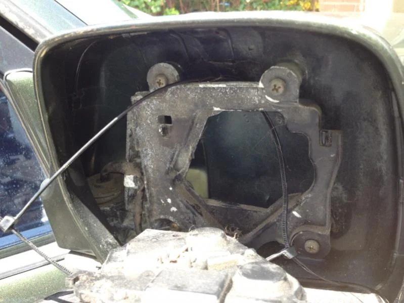

Don't tighten your zip ties yet. Tighten this bolt first.
Now tighten the zip ties and tuck the excess behind the mirror.
This is the same fix I use for my driver side and it has held solid for six or seven years.

How do you take the mirror apart? There does not appear to be any visible way to drop it out as the picture shows. Thanks Dan
Great thread, thanks. I have been looking for a solution.
Remove the screw through the access hole on the bottom of the housing. Gently push up and pull out from the bottom. The mirror hangs on two little hooks at top.
