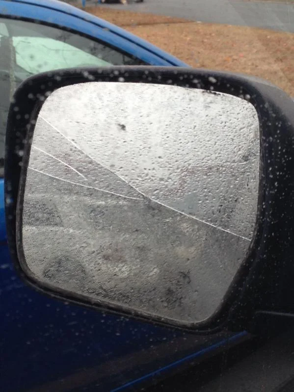

Zip tie repair fail... But it DID stop the shaking!!!
I did the same thing on one if my repairs. (Done 4). Search eBay for replacement glass- about $12.
Pat
Cool! Yeah, I wasn't thinking "Hey, this is glass and it could break" when I was trying to shove the zip tie behind the mirror… Boneheaded mistake on my part. It's broken, sure, but there was no shaking whatsoever on the mirror! It still gets a thumbs up from me!
That sucks! But yes, you can find a replacement easy. If not in eBay check cruiser solutions or the other 80 suppliers. Will cost more but at least you'll have glass!
Thanks for the suggestions! I picked up some glass from a part out on here (thumbs up to SuperStan26 for providing quick service) as well as the eBay replacement glass. The eBay replacement glass is applied to the existing backing plate with adhesive tape, has anyone had a bad experience with this? Just curious… Thanks again for the awesome suggestion with this repair!
