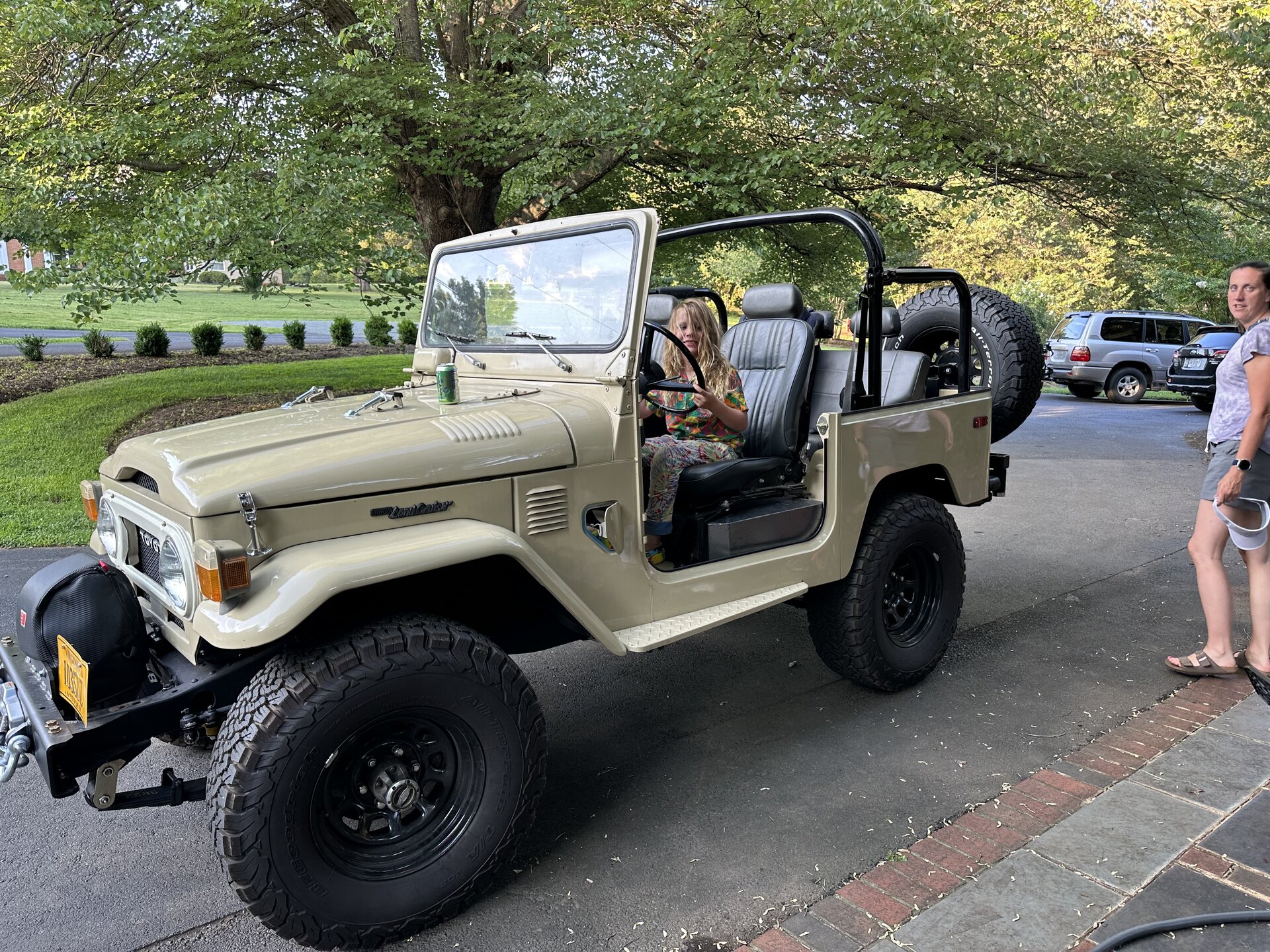

friends and colleagues,
I finally got my turbo installed on my 78 BJ40 3B (from a 1981 BJ60) and had it running well when my engine seized during shut down a couple days ago. We’re going to pull the oil pan soon to discern whether there may be a simple fix, but if there isn’t, I am very interested in hearing about vendors who would either rebuild my 3B or be very skilled and undertaking a diesel swap for something more up-to-date.
