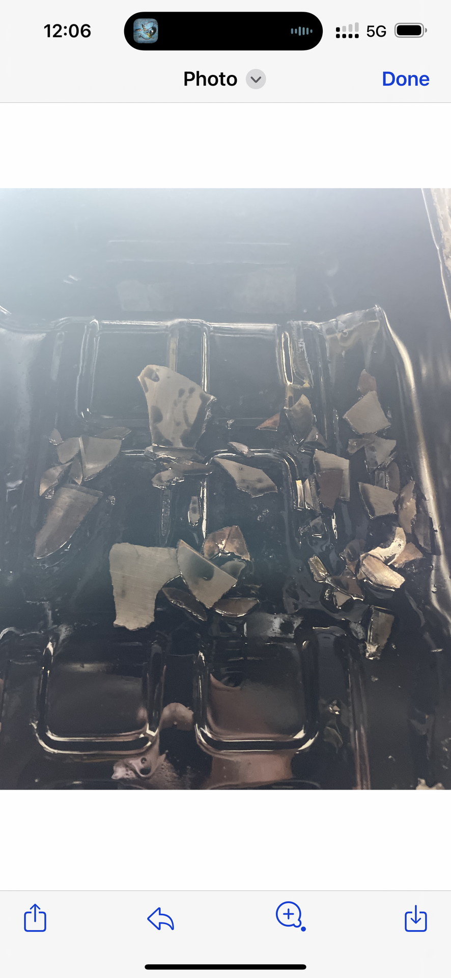

I finally got my turbo installed on my 78 BJ40 3B (from a 1981 BJ60) and had it running well when my engine seized during shut down a couple days ago. We’re going to pull the oil pan soon to discern whether there may be a simple fix, but if there isn’t, I am very interested in hearing about vendors who would either rebuild my 3B or be very skilled and undertaking a diesel swap for something more up-to-date.

I have an after market temp sensor that was also reading nominal, but I heard a very slight sound of boiling coolant when the engine fell silent. As such, I felt that coolant hoses, which felt nearly empty. My fear is that the temp sensor wasn’t working because it was dry.
After it cooled down, did you check your coolant level? Anything there? Is it possible your mechanic forgot to put coolant in after all the work done? If so, I'd have a straight up talk with him about that; as the failure would be his fault. Driving a while with no coolant is enough to seize an engine.

The head had received no treatment whatsoever - the head gasket had been installed incorrectly by whoever worked on it previously.
Did it have a parent bore type headgasket installed on a liner block? This can cause liner failure.
What’s a parent bore gasket? You were absolutely right that the liner failed.

The coolant was low by a quart
that Pisses me off that we lost a 3B to that kind of failure. Mechanics failure.
How did he fail? I supplied the gasket.
Oh, what do I know... did you supply the gasket? seems like the mechanic should know the gasket is wrong?
