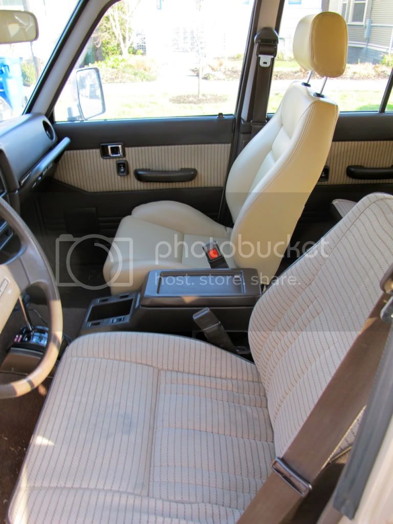

WOW... now those look great Flanders!! Mind divulging cost (with shipping/tax) to you and how long it took you to install? Which version did you end up getting with which add-ons (if any).

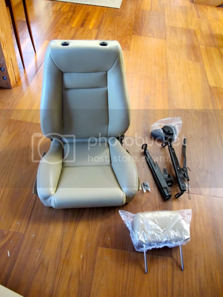

$517 for 2 seats
$12.95 shipping
$19.00 over size charge
$602.95 total.
No add ons for the seats and they are the "standard" ProCar Elite. Scat/Procar 80-1100-54L - Scat Elite Series 1100 Seats - Overview - SummitRacing.com

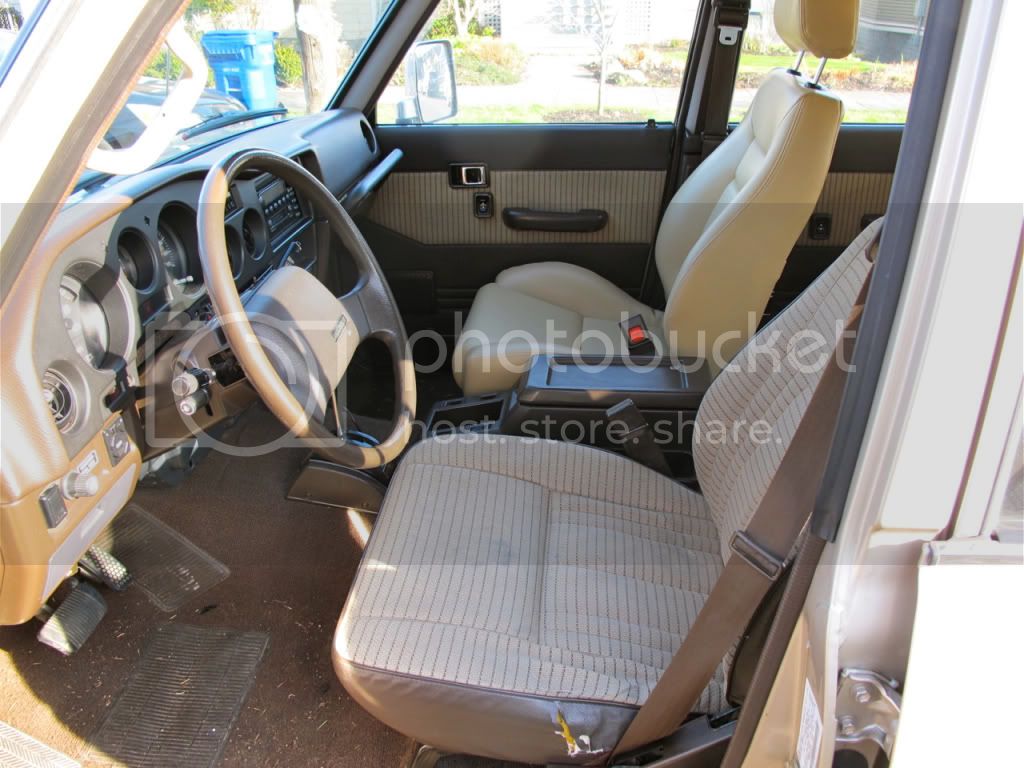

The installation was a breeze:
1. Remove the old seats (4 bolts per seat)
2. Remove the slide bars from the old seats (4 bolts per seat)
3. Bolt the old slide bar to the new seats (super easy and they are sized exactly the same)
4. Put the new seats back in, 4 bolts per seat and done!

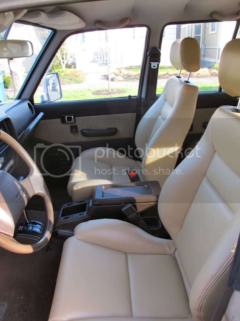

Wow is right... and the velour (cloth) seats are $100 additional!
That is not bad at all for those seats and they look great. Guess that will be something to add to the list of things to do since 90% of the cruisers out there have the ripped seats. Also glad to hear that they swap in so easily, no extra money needed to be spent on adapters and what not.

Thanks for posting the pics and the details.....I've got to get some new seats too, especially the drivers. My truck is tan as well so looks like a good match, but comfort outweighs color.
Whats your take on the comfort level...etc?

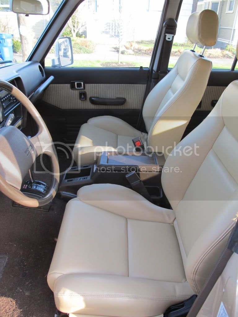

got the seats the other day and installed them this morning. They were super easy to install, look great and are very comfortable!
Damn those look really good. Since you're using the stock sliders, I take it you don't gain any more footspace over stock? How is the ride height compared to the OEM seats? When I did my Mazda seats with the first set of brackets they sat way too high (about 4" or so higher than OEM) and when I made new brackets it put them about 1.5-2" higher. Big improvement, but my main reason for the Mazda seats is that they gained me a TON more legroom in the front thanks to long sliders.
My Smitty seat went down and back about one in
Sent from outer space via my mind
**** those look really good. Since you're using the stock sliders, I take it you don't gain any more footspace over stock? How is the ride height compared to the OEM seats? When I did my Mazda seats with the first set of brackets they sat way too high (about 4" or so higher than OEM) and when I made new brackets it put them about 1.5-2" higher. Big improvement, but my main reason for the Mazda seats is that they gained me a TON more legroom in the front thanks to long sliders.
Leg room seems about the same as does the ride height... Maybe I'm sitting a little bit higher but it's hard to tell since the original seat had a pronounced "lean" to the left!
As for comfort... They definitely are FIRM! My other car is 2010 Audi A4 and I thought those seats were firm. I did about a 2 hour round trip drive last night and although they firm, they are much more comfortable than the original seats. One thing to note. I'm 6' and about 190 and the seats are almost on the tight side. If you're on the big side, the side bolsters would probably make the fit too tight!
