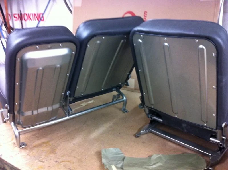

No hog rings on that setup IIRC. The seat will use wire and screws that hold it down below backing plates. Use the search section, there has to be a write up somewhere.

Weekend Project: Stock Seat Restoration
Found @Millardo’s thread during search. He does top notch work. Maybe he’ll chime in

You may not have hog rings, but don't fear them. Use a needle-nose vise grip pliers to bend open the old ring and remove it, and buy a set of hog ring pliers (and a big bag of rings) to re-install. You'll be upholstering like a pro in no time.
