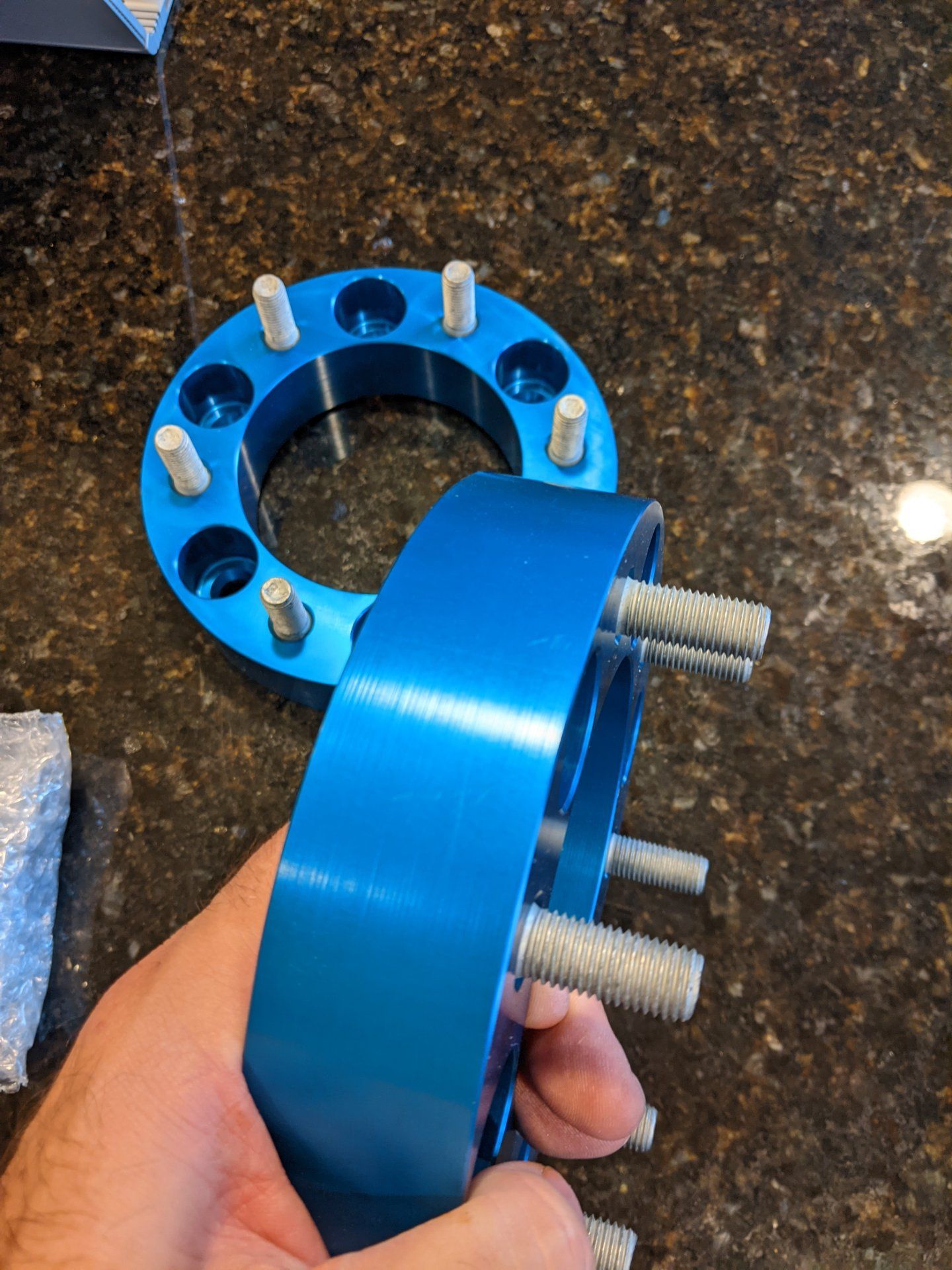

Are you going to put slackers behind those wheels? I think you won’t get that center caps on otherwise.
and it looks great. It’s making me want to tear mine down. But I am still putting a list together of what I want to do.
Center caps fit both front and rear when I added spacers yesterday.

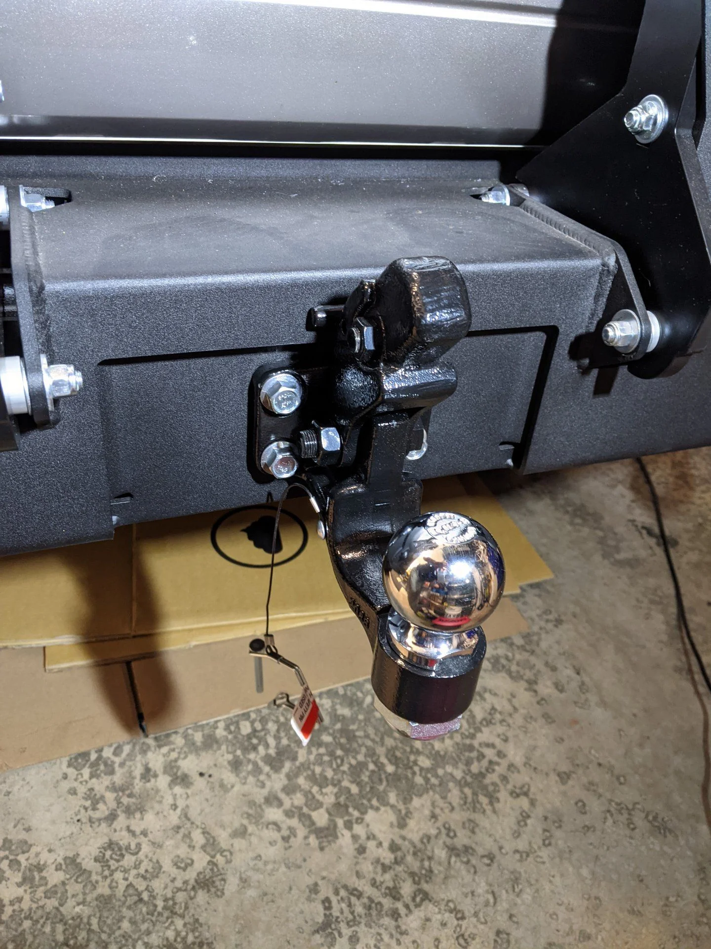

Surface mount hitch is on. Perfect fit on the frame holes. The pintle is way heavier than the frame is rated for, but I have it as a tow point for convenience, not pulling a big trailer or taking a ton of tongue load so I don't think there will be a problem. There's about 1/16" between the frame rail before it bumps in to the DVS rear bumper if there is any deformation or spring ... and I don't think the DVS bumper is going anywhere ever.

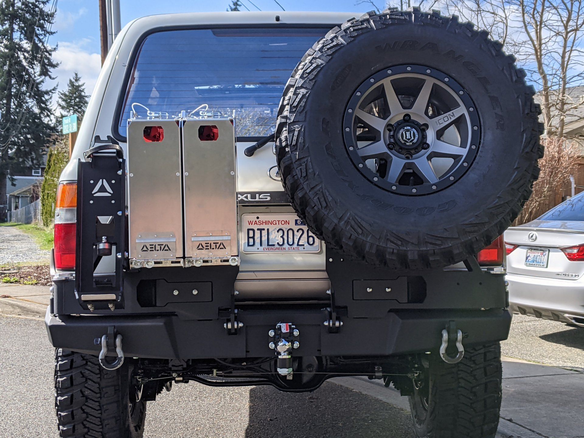

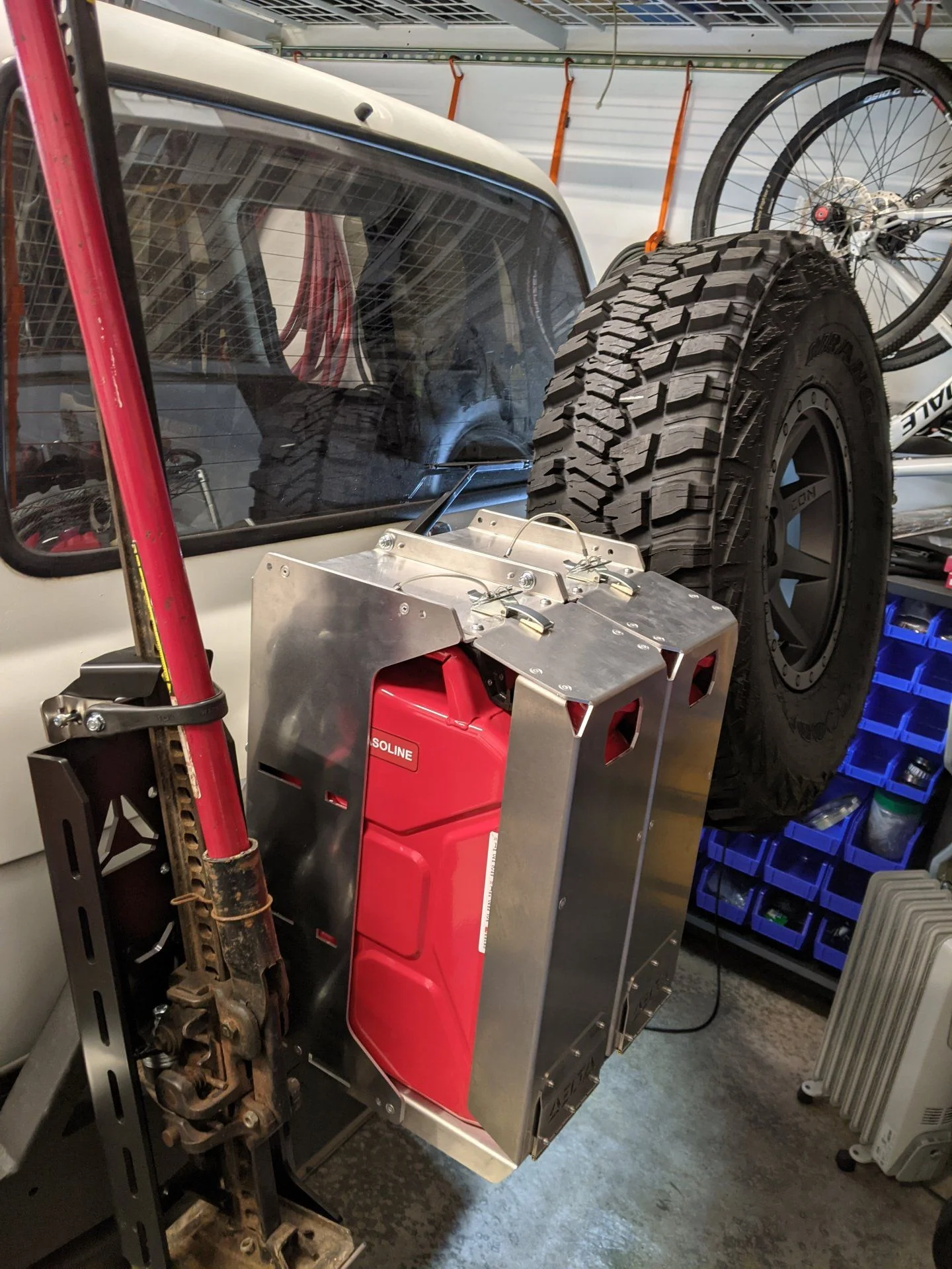

Bolted all of the DVS accessories to the rear swing outs today. Everything fit better than expected and actually preserved view of my license plate, even with a 37" spare mounted. Pretty impressed.

Love the bumpers & the save story esp.
-Open question as I don’t do it myself-
Is there a good reason to leave shackles in the eyes?
-I always thought it just ate out the eyes screwed the bumper finish & made annoying ”ka-thump” sounds on trails - but I’m seeing it alot nowdays so I’m curious if I :::missed the boat::: -on a good reason here.
Not to mention good shackles are still ~IDK how much as I went all synth for the Tundra & boat/quads, but I still keep a hard shackle in both rigs & boat for a tree/tow/anchor -strap.
:meh:
:meh:
I never used to leave mine in, but now with the isolators that seem to come with pretty well every shackle they no longer thump and bang when you're driving or beat up the bumper finish. I figure this way it's one less thing to find a storage spot for.
I don't have a great amount of experience with this as the 80 is the first vehicle I've had armor on. But I have isolators on the shackles on my bumpers and I never hear any noise from them. Without the isolators I probably wouldn't carry them this way because they would vibrate and clank against the bumpers all the time.
