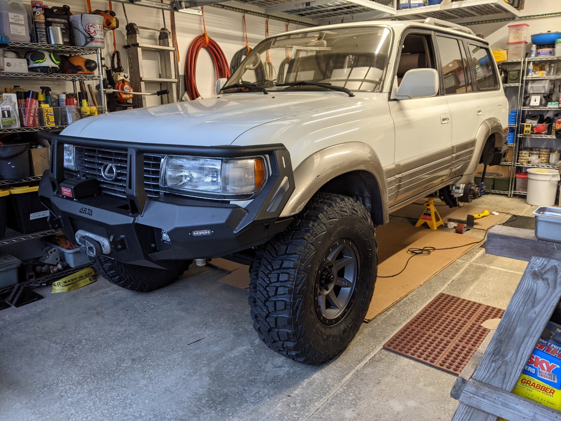

Incremental progress. Finally have the front boots on.

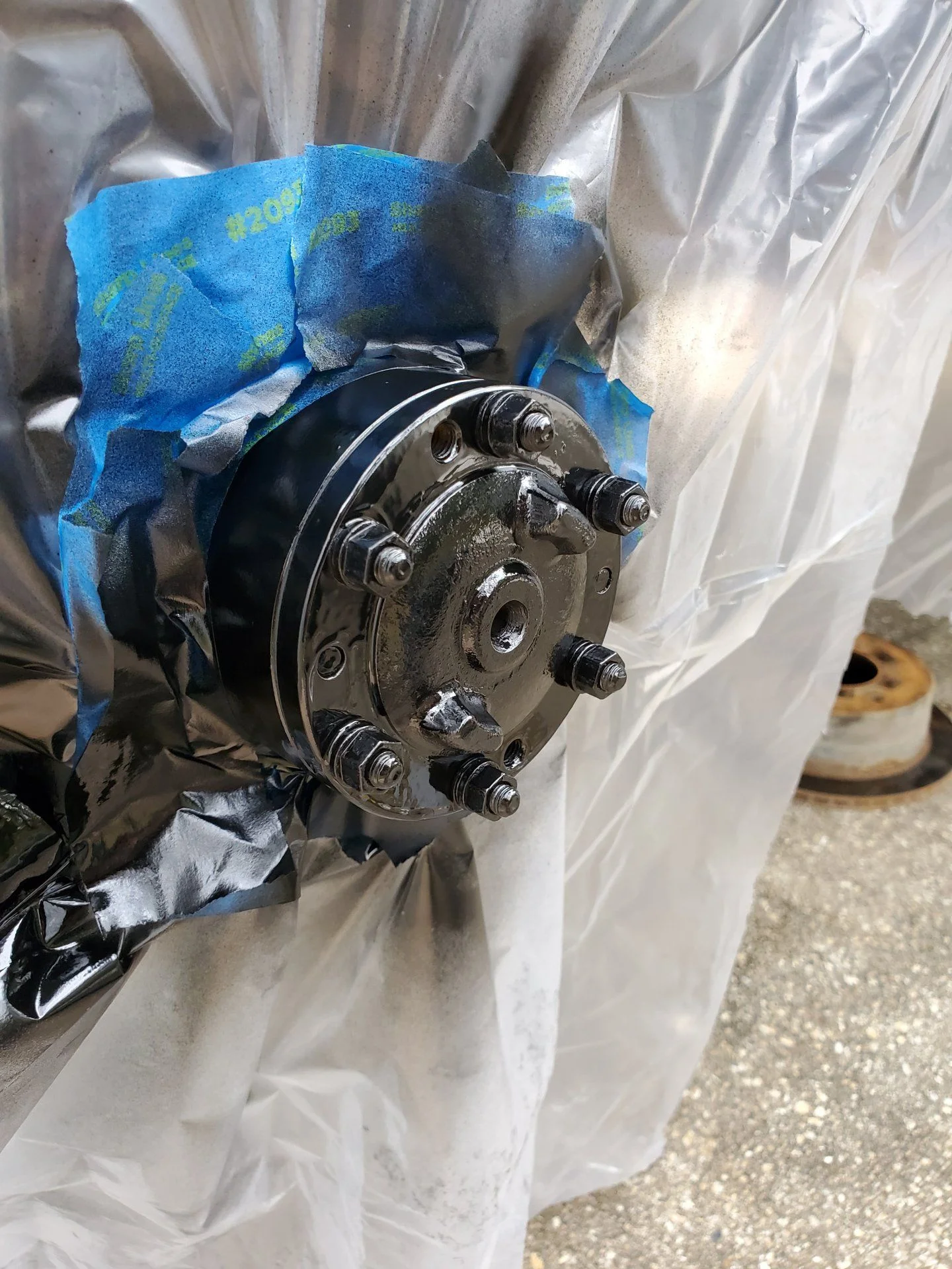

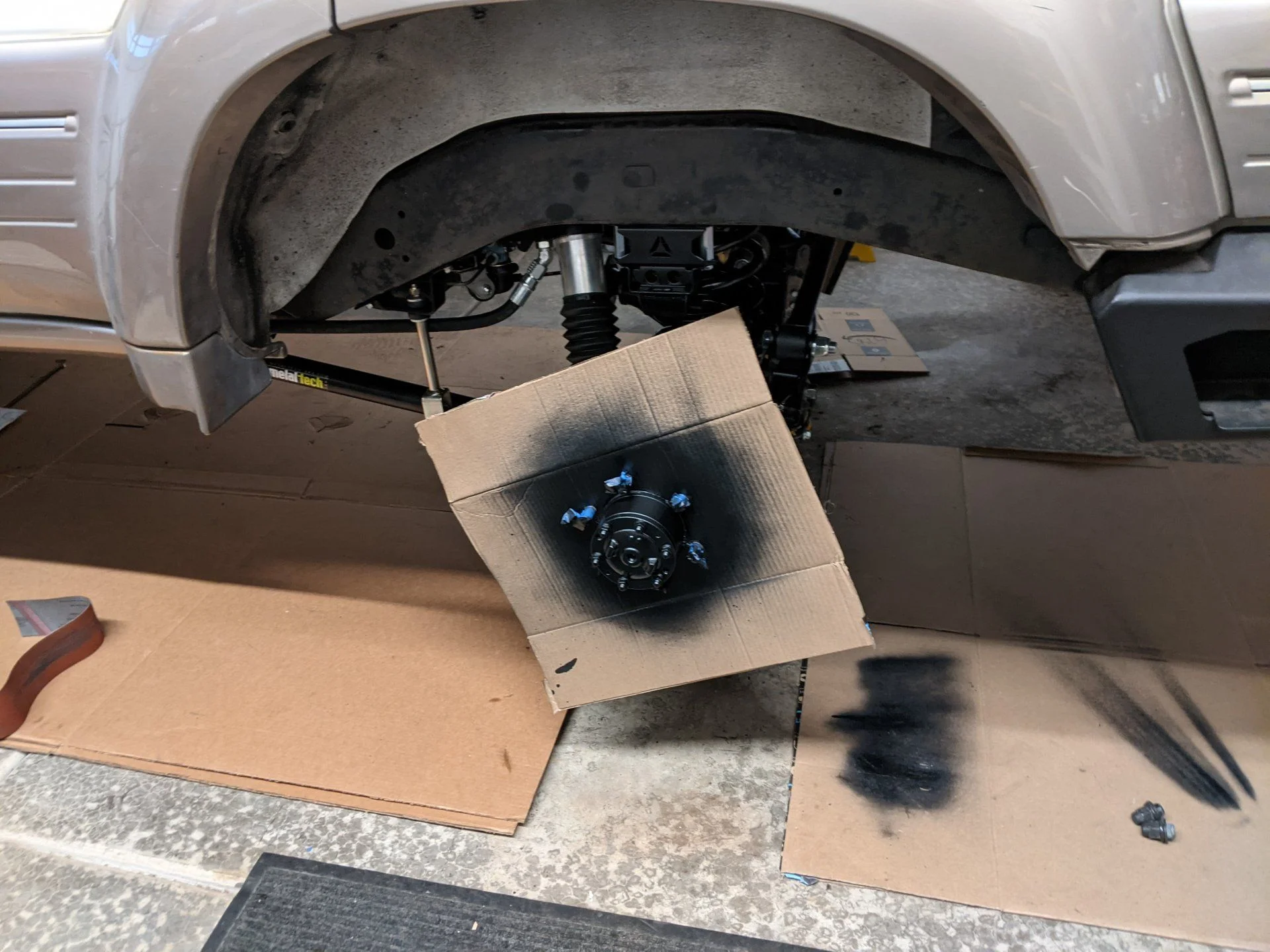

Painting the rear hubs tonight and hopefully it'll be resting on 37s all the way around by tomorrow.
Was surprised the drivers side is 3/4" shorter fender to ground than the passenger. More of a difference than I expected. Checked the back as well - Same deal.
It will be cool to see this thing in person. With the Delta VS front bumper you could really use the JDM side markers that go in the fenders.
I really like the way the critter catcher fits on the bumper and matches the lines of the truck. I've had rogue branches from trees hit the leading edge of my hood on other trucks while wheeling twice in the past, significantly messing up body work both times. Given how expensive/ hard to source the sheet metal is on these rigs it seemed like cheap insurance.
Doesn't hurt that I think it looks good, too. :)

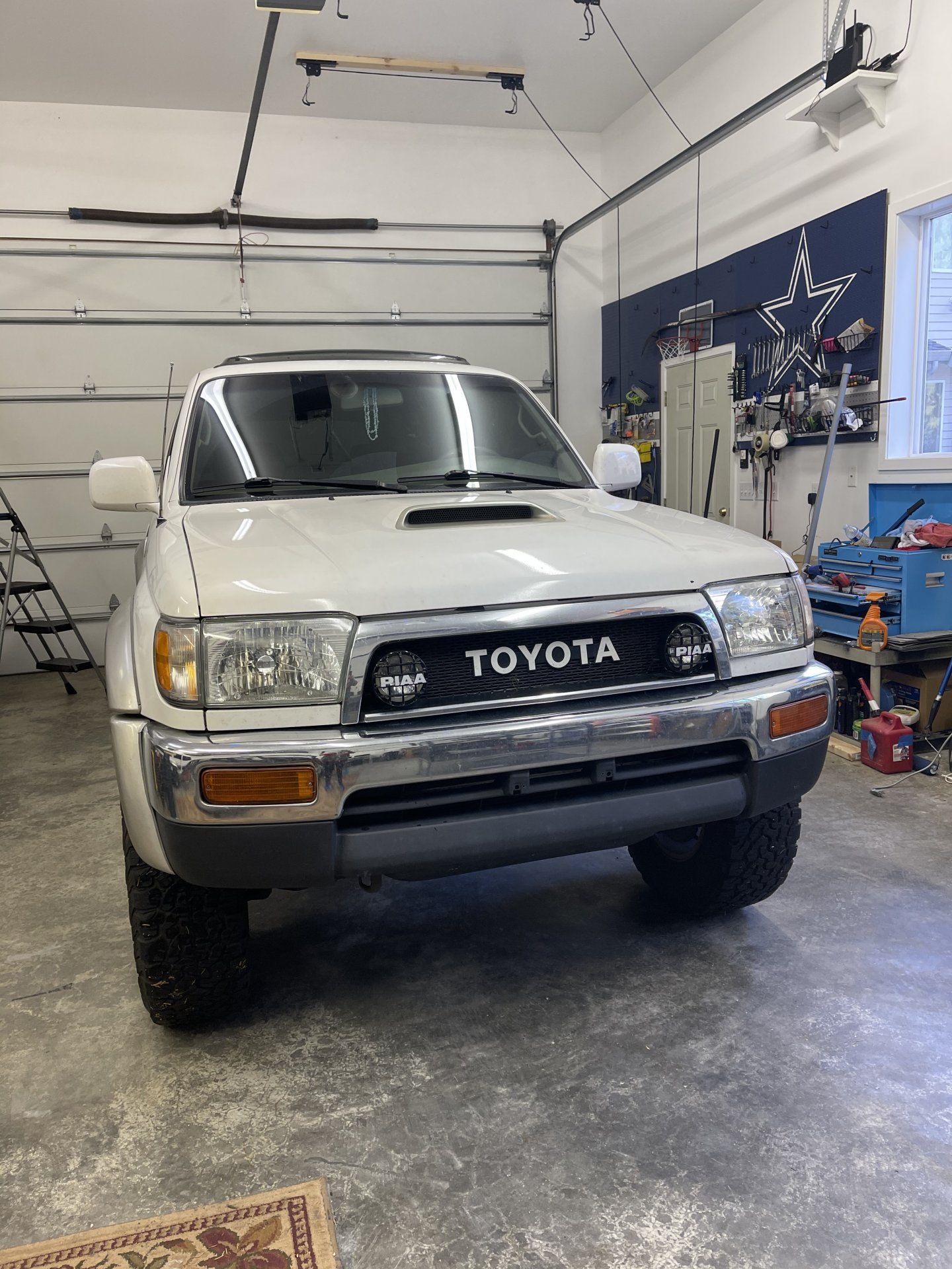

You can roll with this but Lexus 😂😂. This is my daughters rig. I picked up the hood at certifit and painted it LY.
but your rig will look good no matter what. I am curious on the rear bumper. You got the tire carrier and what did you do on the other side? jerry can 2 or 3?
2 jerry cans and a high lift mount for the other side. Haven't mounted any of it yet, since it'll get in the way while I'm working on the truck. Actually wondering how it'll all work out with a 37" spare. Looked like it would be right with a 35. Assuming I may have to offset the spare a little more than I originally planned with the bigger tire.

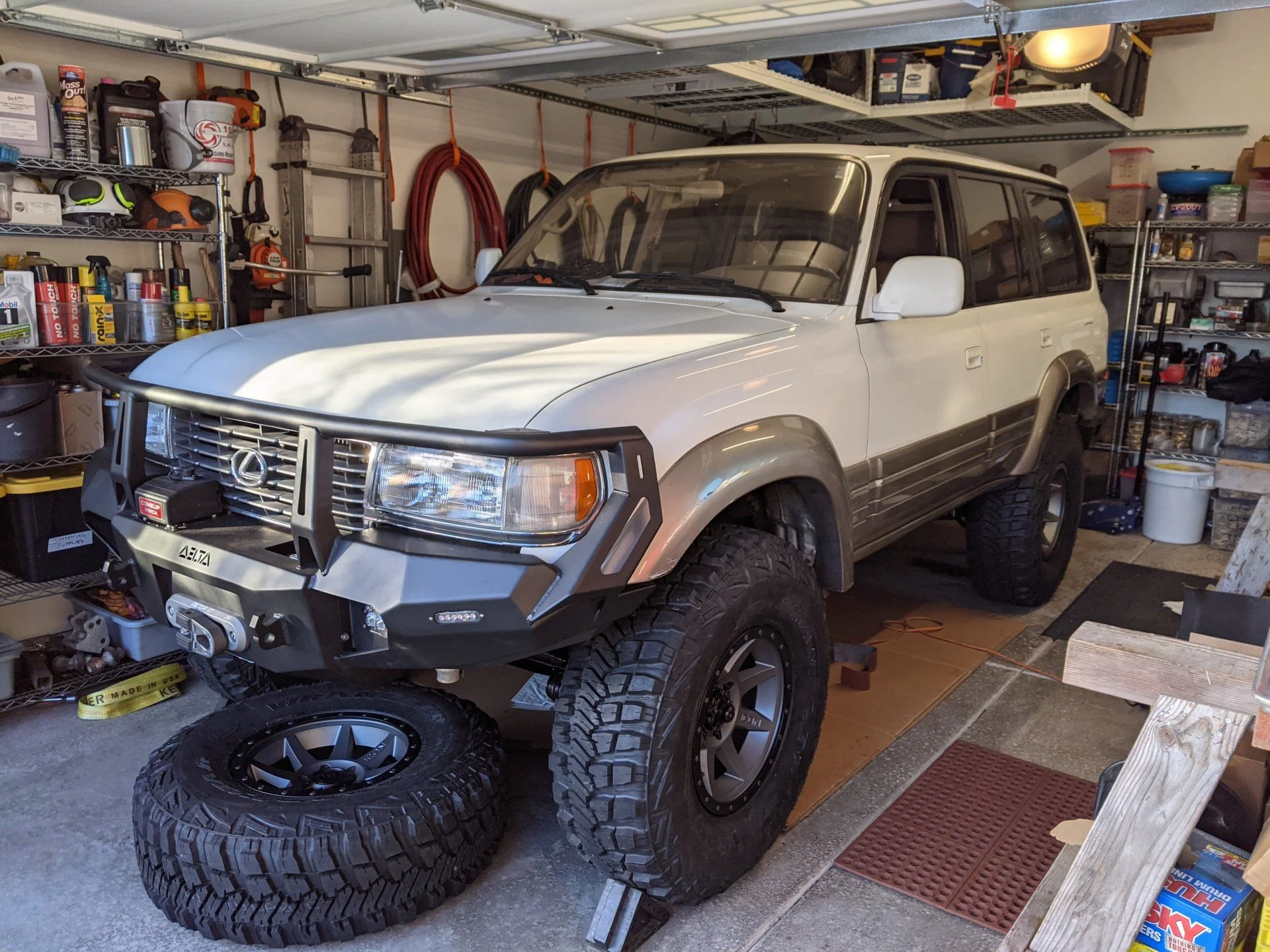

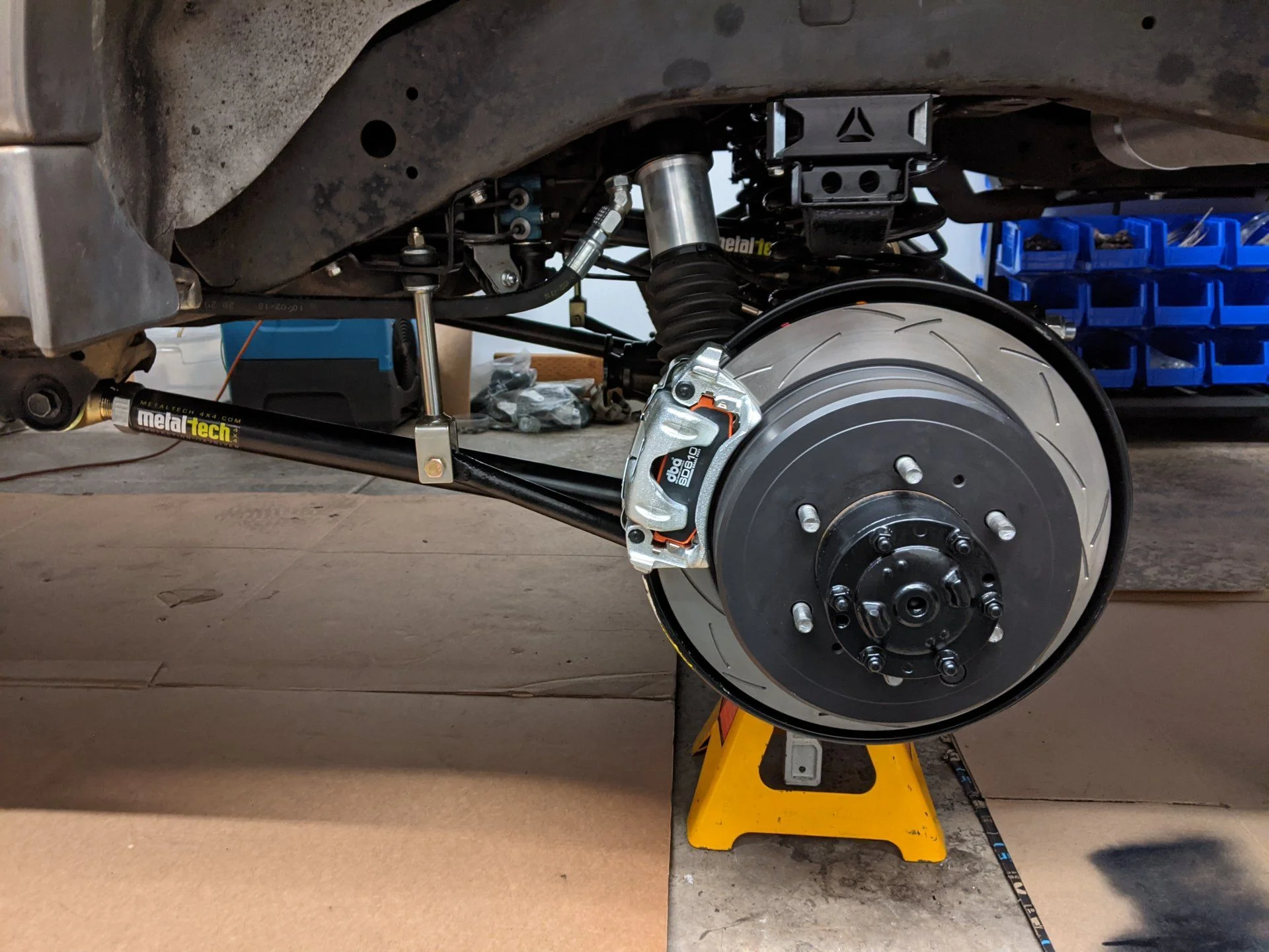

Rear end all came together last week and finally have tires on all the way around. I think I replaced or refinished basically everything on the rear, right down to fasteners because I had a horrible case of "while you're in there-itis". Tires fit well with the lower trailing arms set to +13mm and the uppers set to give -2 degrees on the drive flange. Just ordered a set of spacers, though - Rear tires were about 3" off the frame which I'm betting would rub on full stuff and lines up with what most other 4" lift/ 37" tire trucks have said here.
Really impressed with the quality of the DBA rotors. Guess we'll see how well they perform. Was surprised how well the braking system bled as well using a power bleeder. I was expecting all kinds of issues, but seems to be good. Fingers crossed.
Would have liked to get the truck outside for a picture in the sun today, but that's a little tough with no drive shafts at the moment. :doh:
Are you going to put slackers behind those wheels? I think you won’t get that center caps on otherwise.
and it looks great. It’s making me want to tear mine down. But I am still putting a list together of what I want to do.
