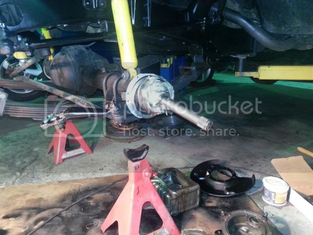

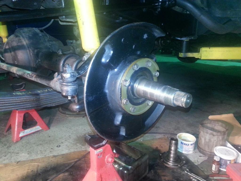

Packing in new grease
Using the 60 series knuckles
Backing plates in
Quick question for you... back when you did this upgrade, did you use the 60-series birfields? Or are these the original from the 45 itself? A lot of the write-ups I see for using the parts from a 60-series or mini-truck include using the birfields from the donor rig and grinding out the inside of the axle ball.
Joel
The birfs are original from the 45. Did not change them. The knuckles, backing plates, and everything outside of that are from the 60. Is there a reason the writes are recommending to use the 60 brifs? Are they stronger? I'd imagine that would be necessary if your running larger tires and/or do heavy wheeling?
Did you do your swap yet?
I think the reason they recommend this is because, in the North American market, drums were associated with the old coarse six-spline birfs. But both yours, and mine, have fine splines on the outer birfs. So I think I'm fine... As you were. The 60-series hubs require fine splines.
Did not know that! Learn something new every day.

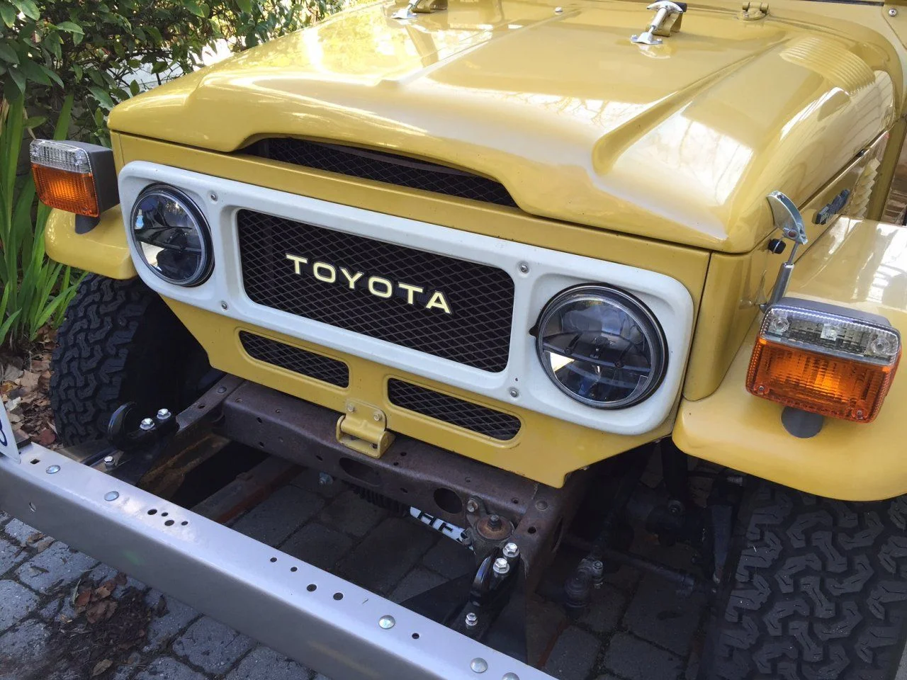

Just yesterday I finally managed to upgrade my lights to LEDs, and they're excellent. Fit like a glove!
Stock lighting
LED's installed. Literally a simple plug and play
Low beams
Hi beams
And parked behind my daily driver in the non-winter months
