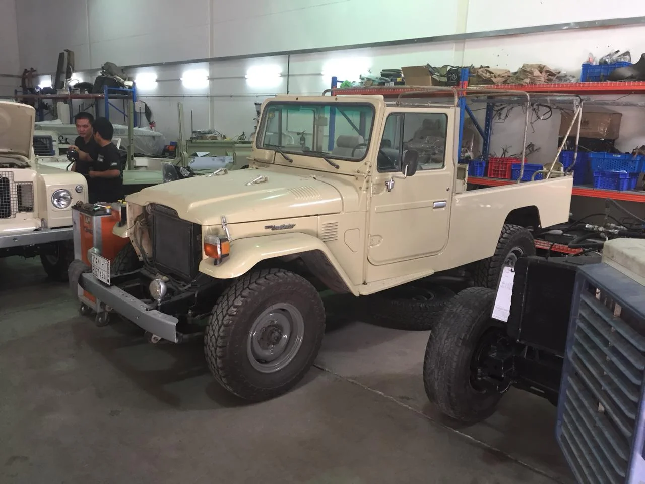

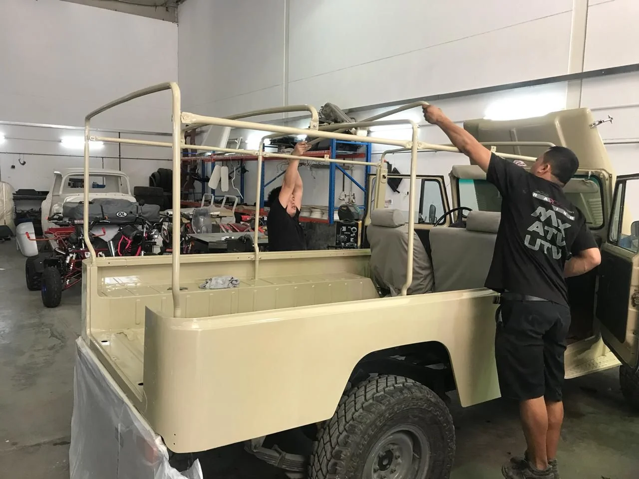

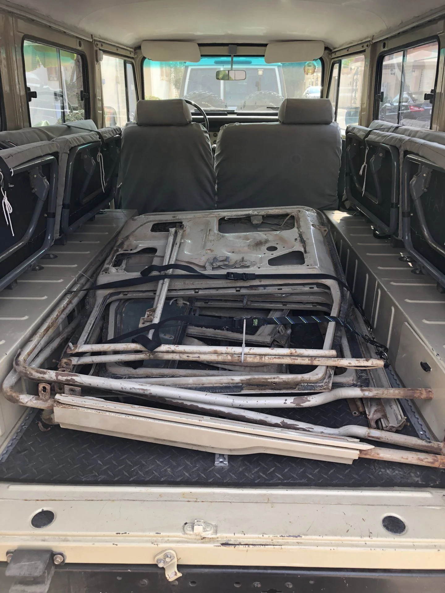

Bought the soft top bows and rear doors from @Arabian Cruiser and sent the Troopy to Dubai. A gent by the name of Seb does clean work out there restoring 40's and Defenders, and one of his projects caught my eye with its specially ordered Troopy soft top from South America.
All the goodies loaded inside. The bows were butchered, so Seb and his team had their work cut out for them.
Loaded up on the transporter to Dubai. I've done the drive myself in 17 hours. The truck driver quoted me 2 days. He took nearly 4 as he prayed in every mosque along the way.

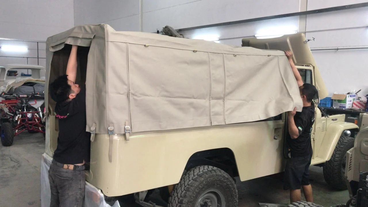

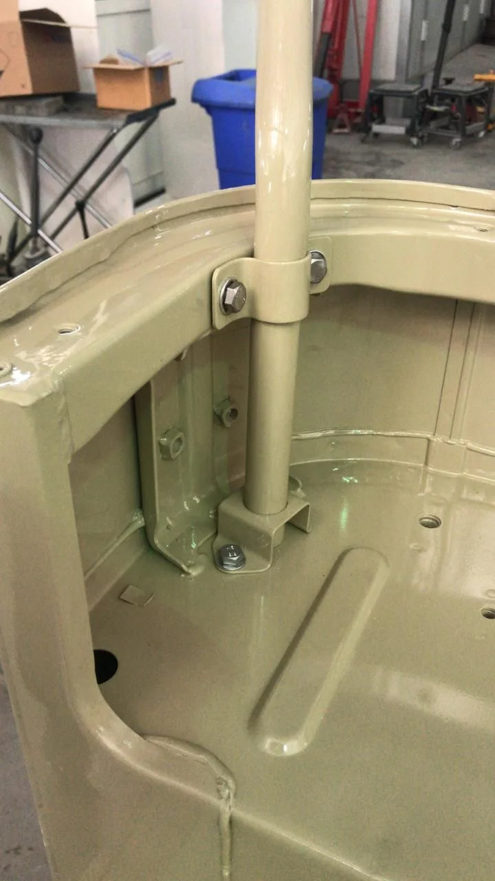

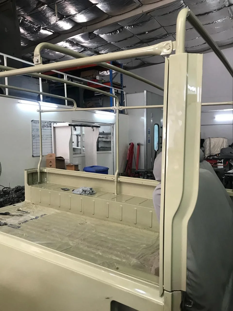

Here are a few pics Seb sent on the WhatsApp.
They turned out super clean and straight.
A few more shots.
The B pillars also came from the @Arabian Cruiser body.

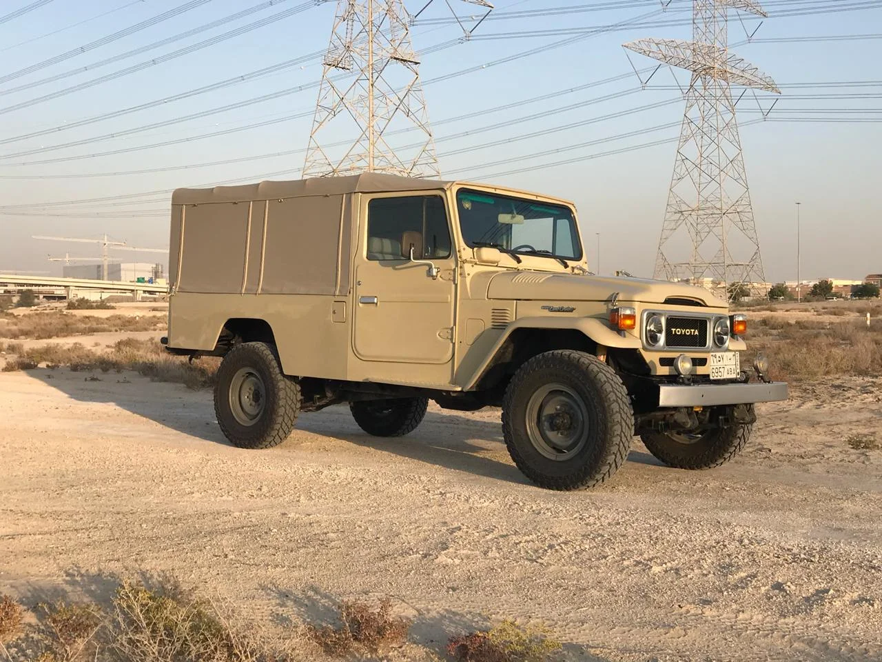

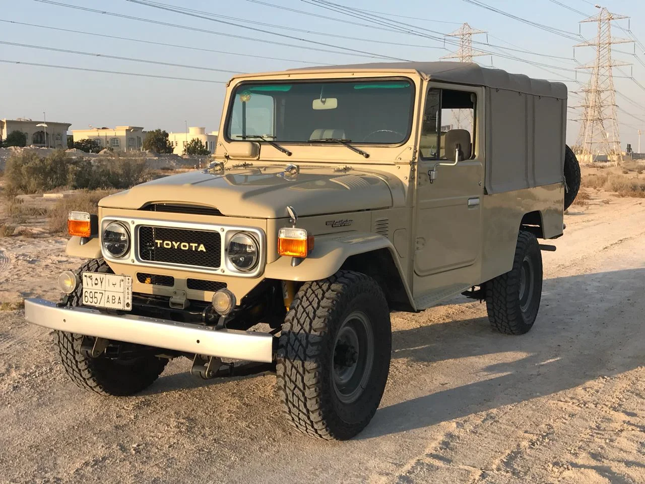

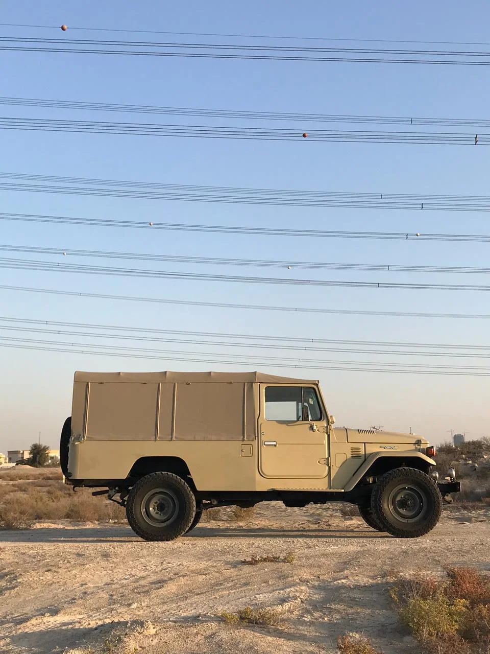

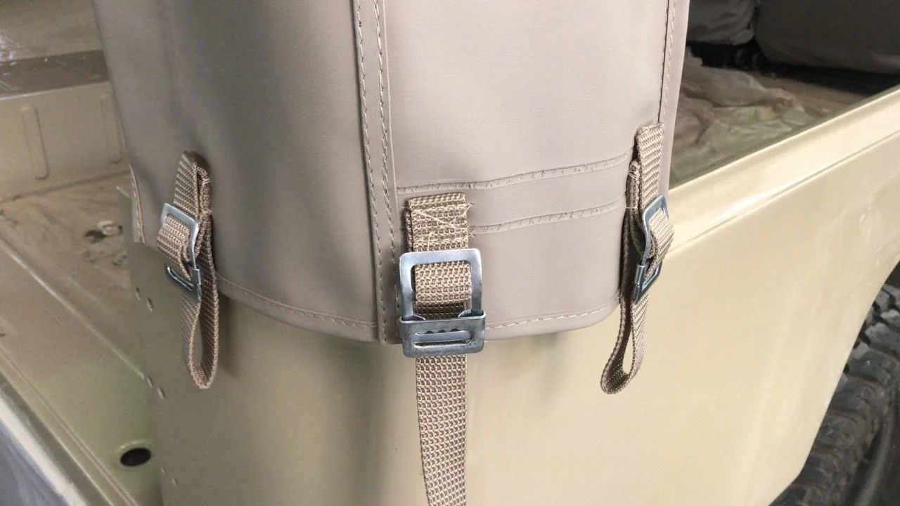

When discussing the project with Seb, I don't know what kicked on in my mind, but I decided to go for a windowless canvas. It was a punt, but lets see how it turns out.
Turned out alright. The top fits like a glove.

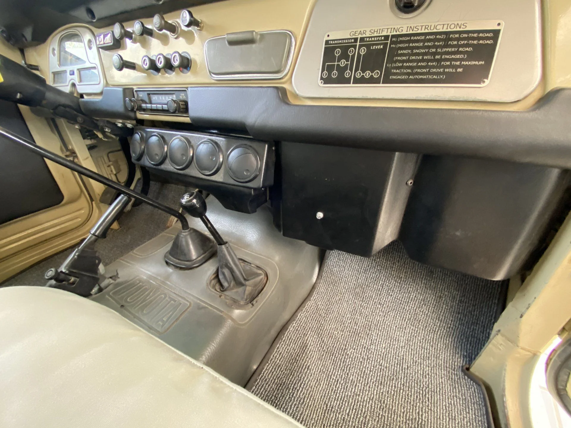

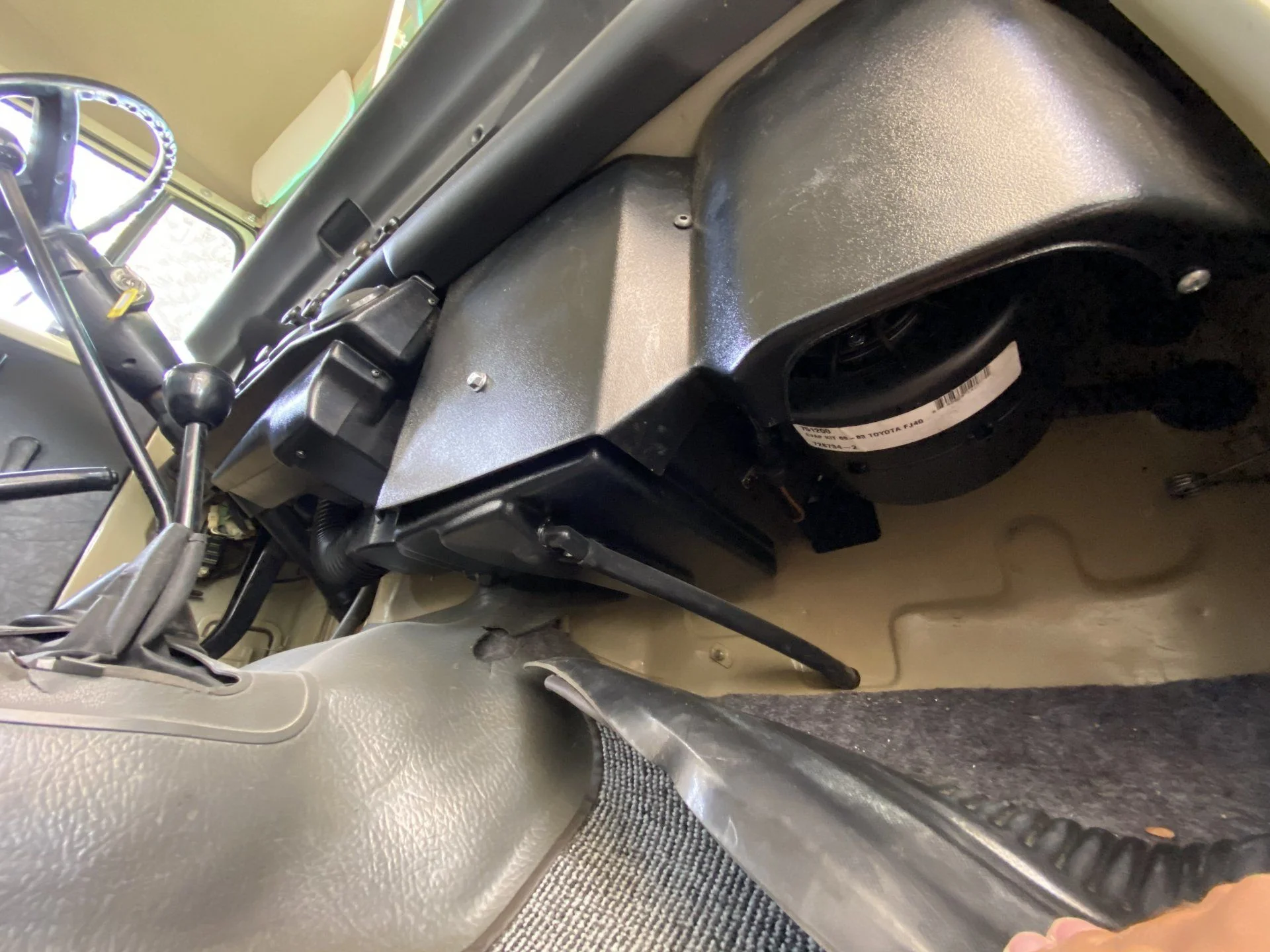

We also had a Vintage Air AC installed. Don't have any pics, but I test drove the Troopy yesterday and it blows ice cold. Will load up pics as soon as the Troopy makes it way back home to Jeddah.

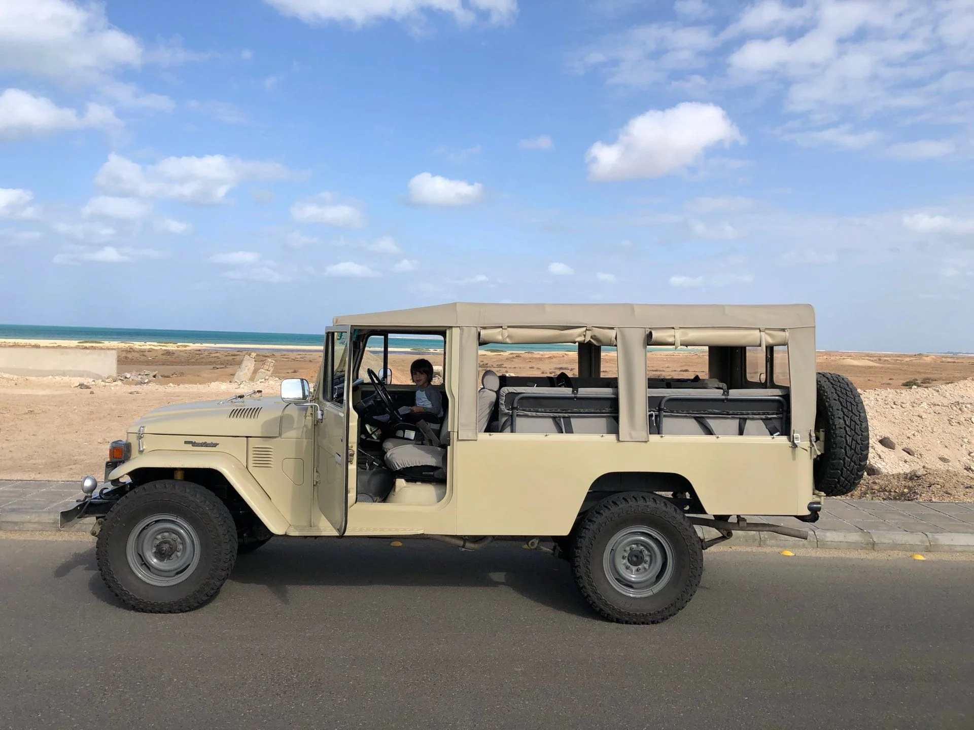

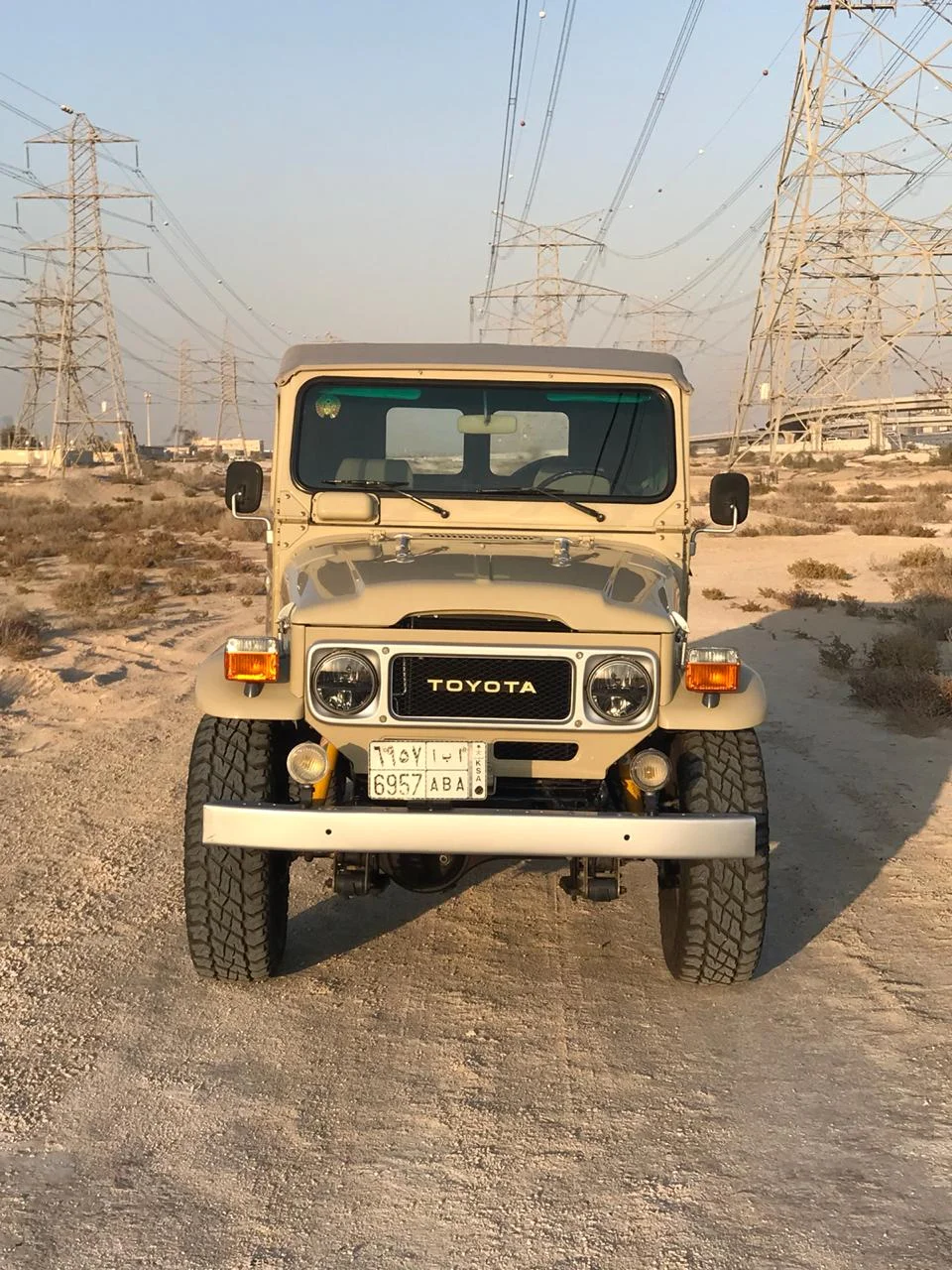

Not much tech other than we rolled the sides up, and took my son out for a cruise along the Red Sea coastline.
Always brings a smile to our faces.

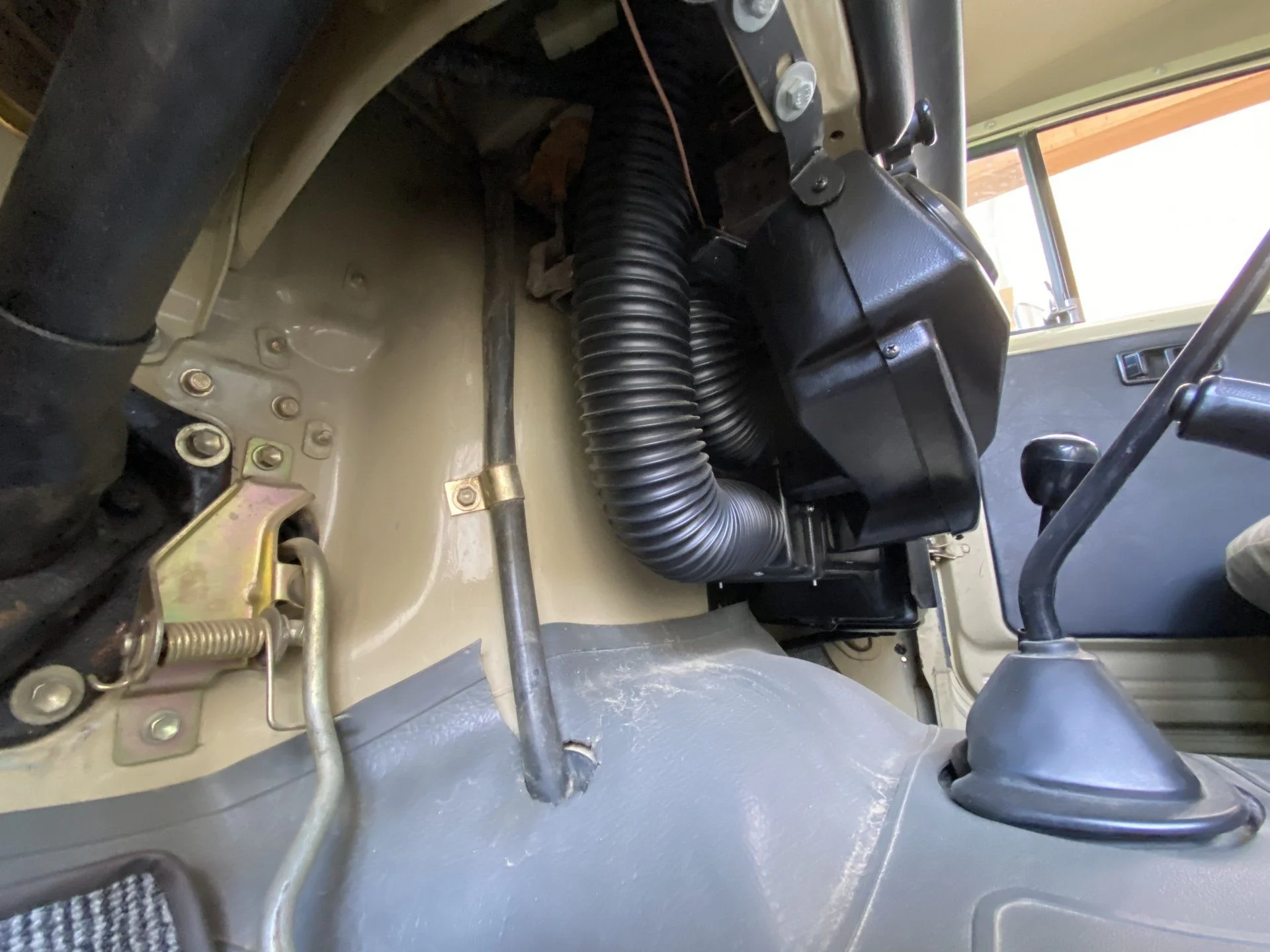

Hey man, you have done a stellar job with your troopy. Have just finished my HJ47 here in Cape Town. Am really quite stoked with how it came out, have just done a 2.000 km drive without a hitch.

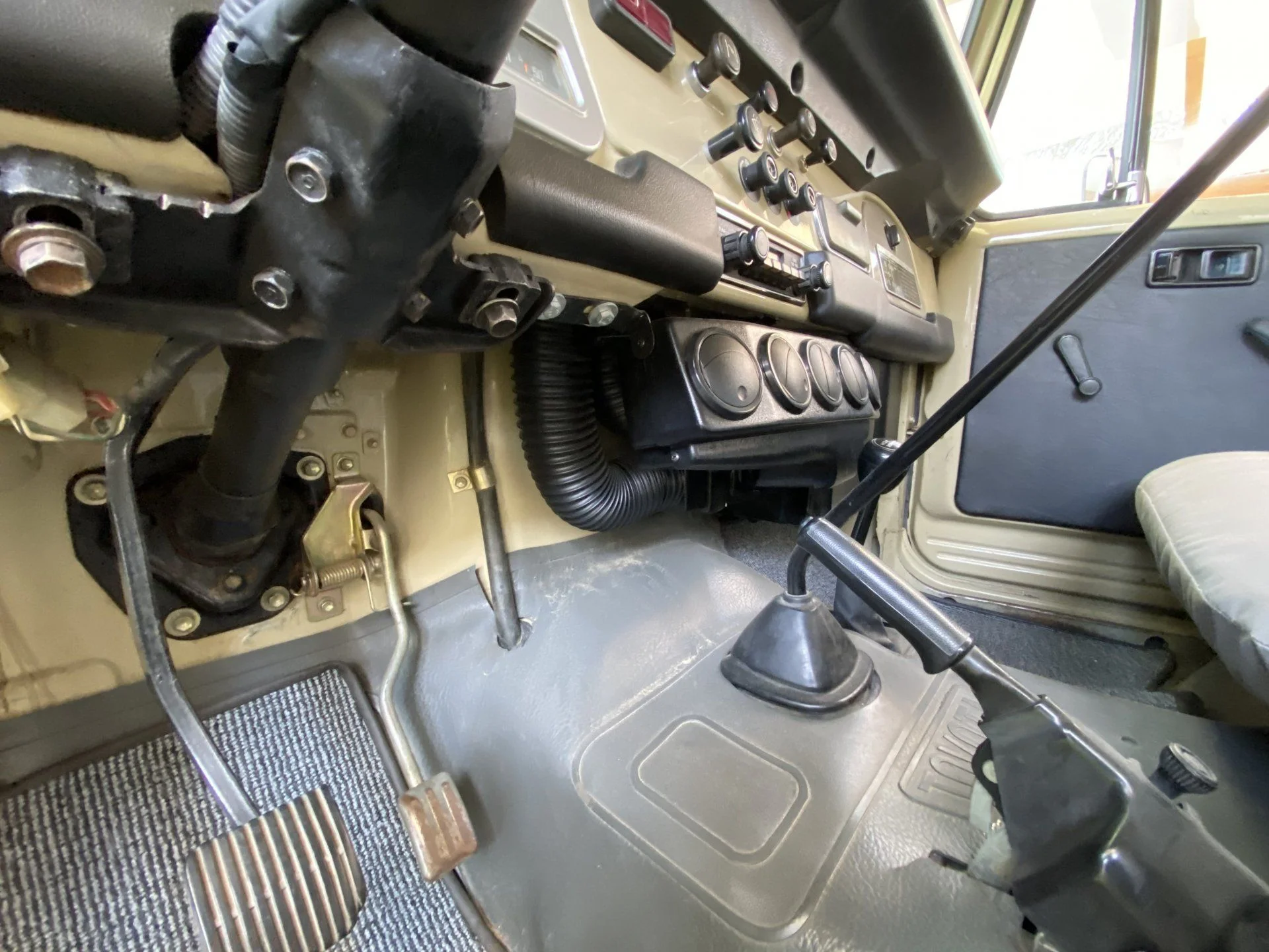

I have a small question for you. In my cruiser I am noticing that when the engine is hot there is always warm air coming out of the heater. The heater valve is functioning, because the waterpipes leading to/from the heater are not hot. The heat seems to become more went I pull the "vent from outside" knob on the dash, which leads me to think that I am drawing in air from the engine compartment. The blower is located on the same side as the exhaust manifold and there is a gap between the blower intake and the louvres on the side apron, so maybe the blower is sucking in heated air from the engine bay instead of through the louvres? How is that on your cruiser? same issue? sorry to bother you but havent been able to find anything about this ...
Would also love to see how you built in the Vintage Air unit if you have time ;-)
Would also love to see how you built in the Vintage Air unit if you have time ;)

Never mind, I now see you don't have a heater at all 😂
Still interested in the install of the Vintage Air though ...

With the stock heater on an FJ40, you should be able to take out 3-4 screws and unplug a wiring connector to remove the fan on the top half of that "box" where the intake and such is and see exactly how it works and it's current condition. There should (at least on ~70's US import) be a cable pull on the dash marked "fresh"(?) that moves a flap back and forth inside that box, under the fan.
And, even with that water valve closed, it's not going to totally stop the transfer of heat, only really slowing down the flow of water on one side.
Plenty of guy's on the board in the US from places like Montana and Colorado that are probably very familiar with the system (where it gets kinda hot in summer, and really cold in winter).
