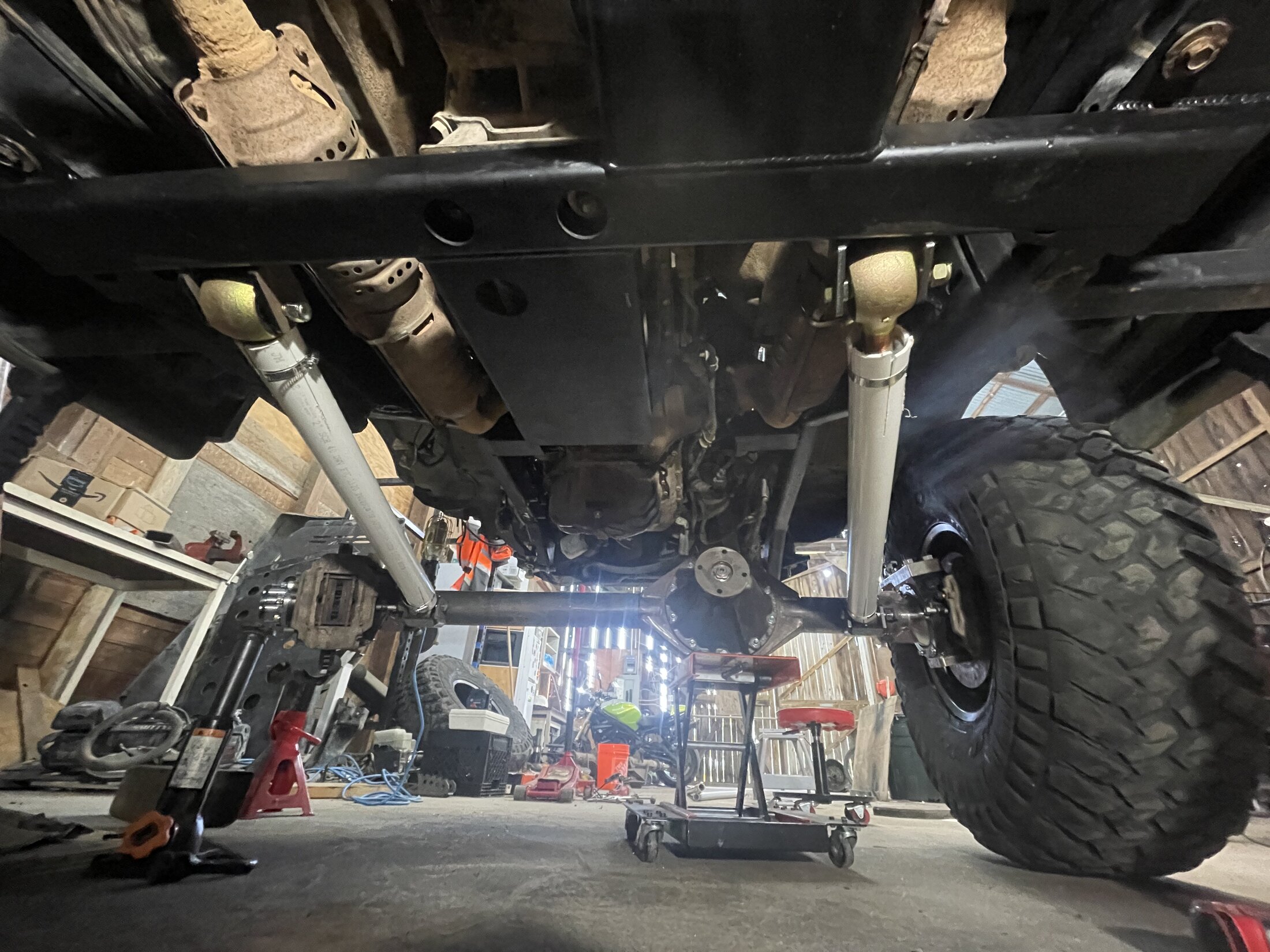

Working on steering now. Axle placement is roughly based on how well the 40” tire fits in the wheel well.
Approximately 114” wheelbase, roughly 2” longer than stock.

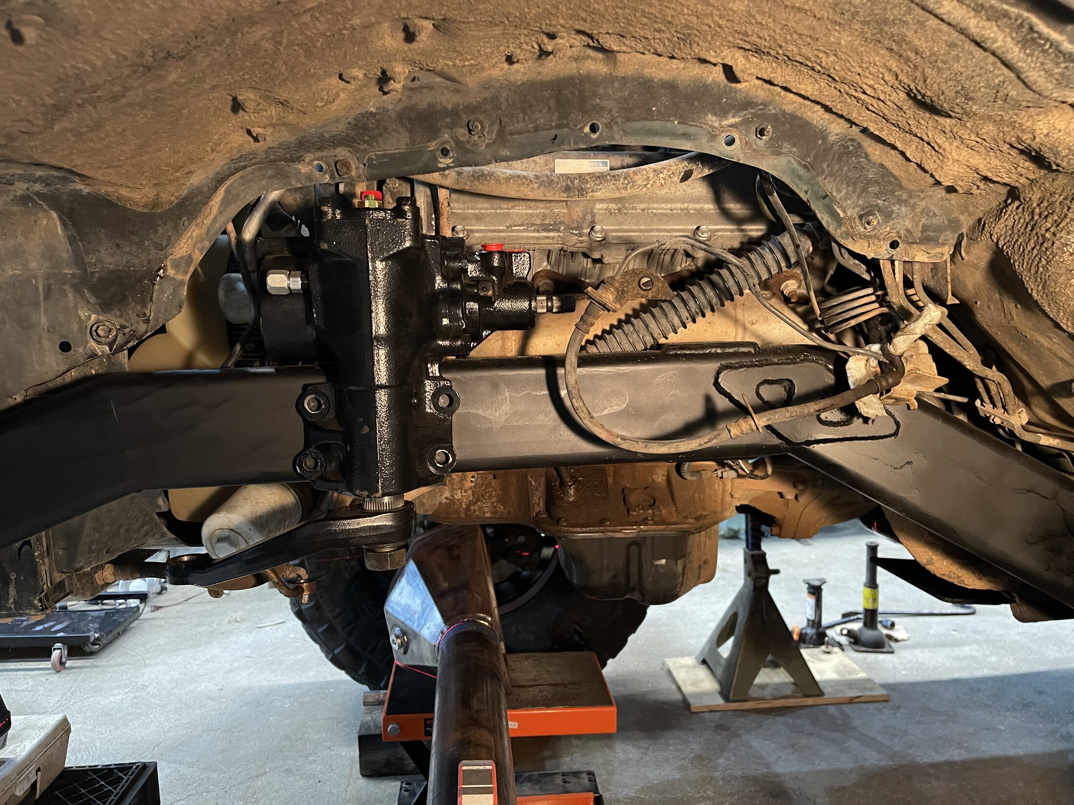

I knew I was going to run into some engineering issues when I built this new frame, and here we are. The steering box is much higher, and now the drag link will interfere with the oil filter. No biggie. There’s some UZ based oil filter relocation brackets available on eBay and such.
Does anyone have experience with these?

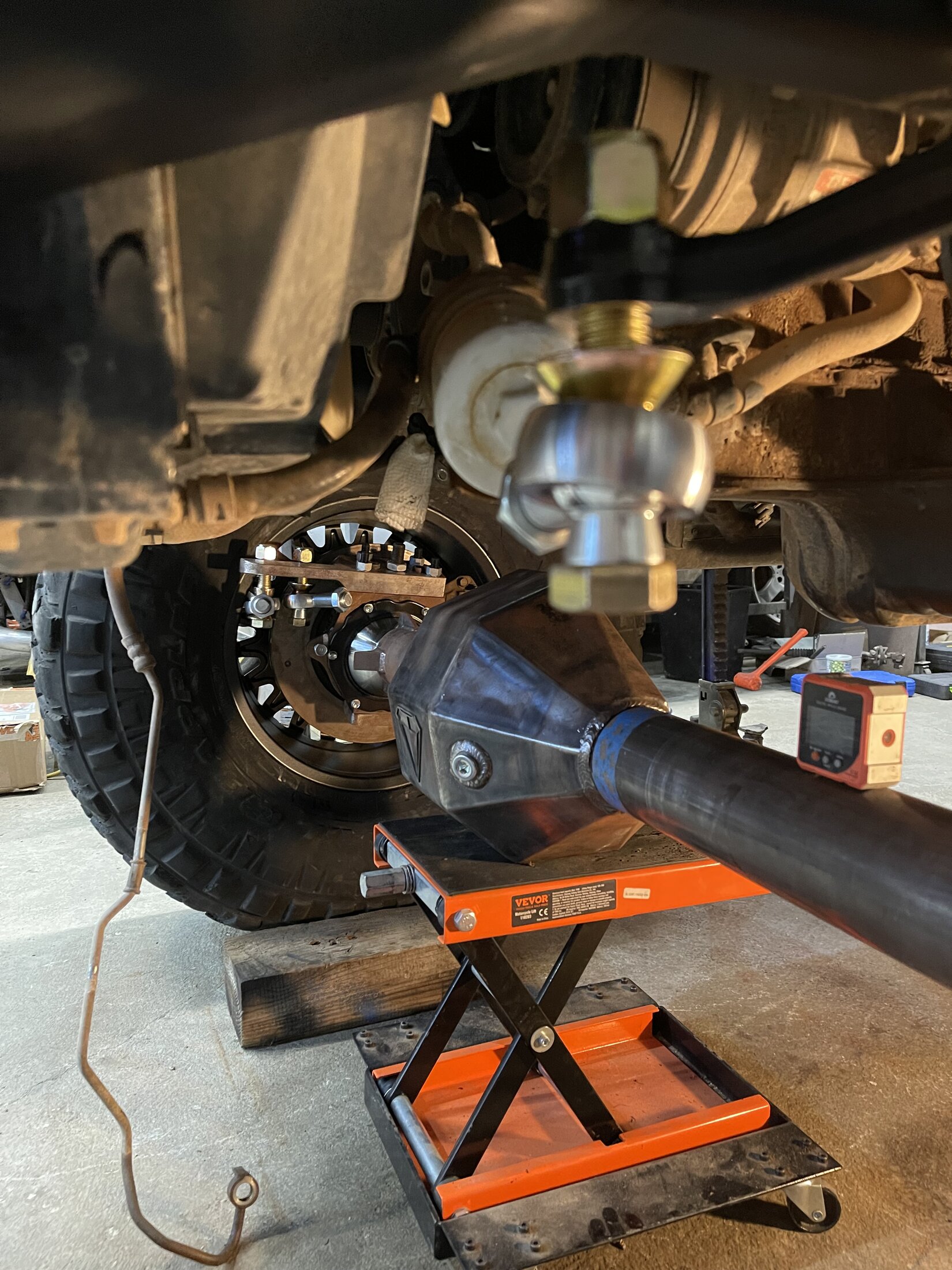

Rear axle pushed back ~1” and pinion angle corrected to ~3* utilizing metal tech’s adjustable upper and lower links.
I’ll double check the factory pinion angle off my dad’s LX470 and come back to set mine up again. Mine was at 8* with the Dobinsons C59-615V springs so I think I’ll be alright with how it is now.
Steering box is mounted, intermediate shaft built. I have a few support bearings to keep it steady that I’ll mount soon.
Now I’m looking to mount the lower links.

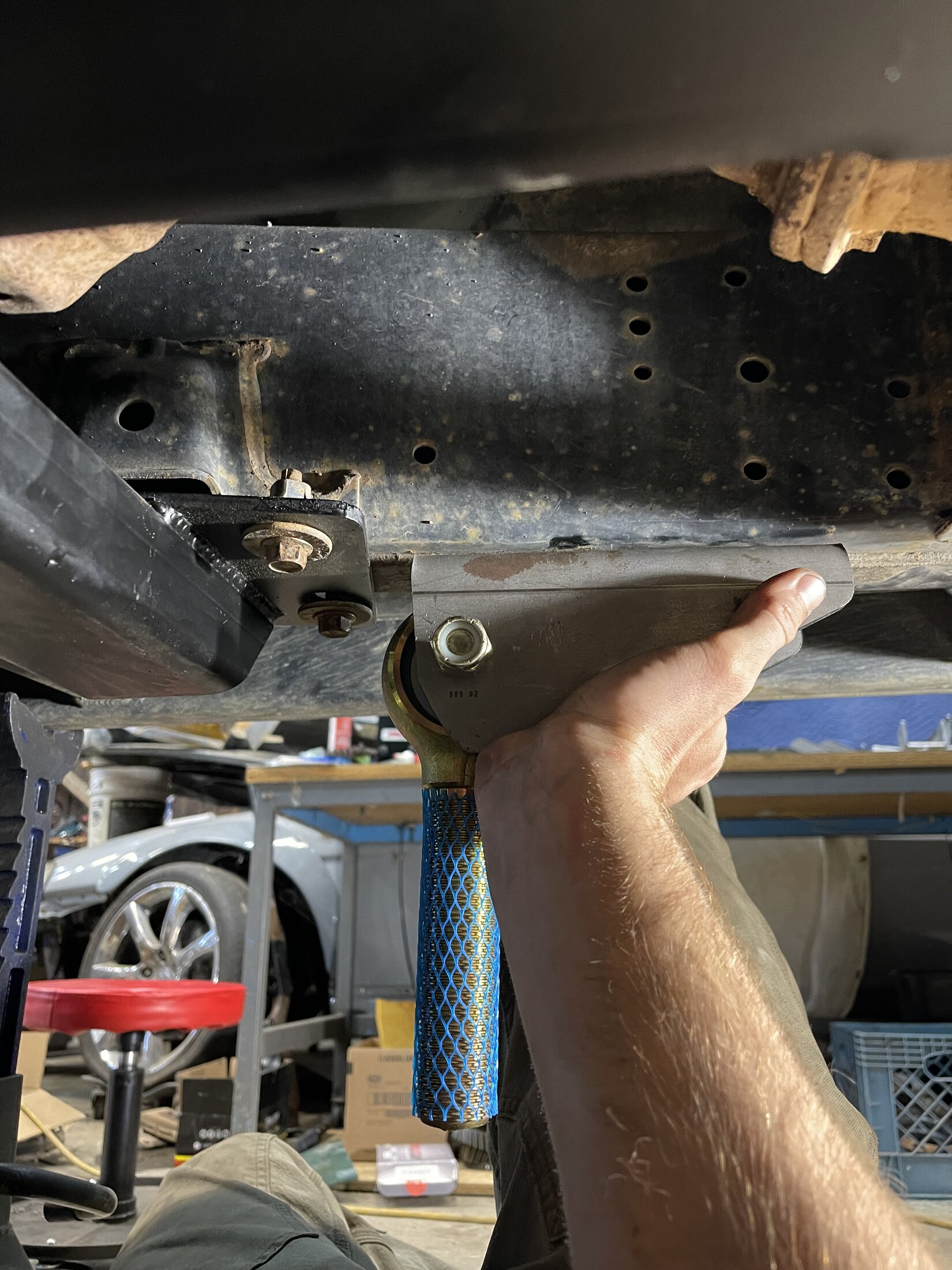

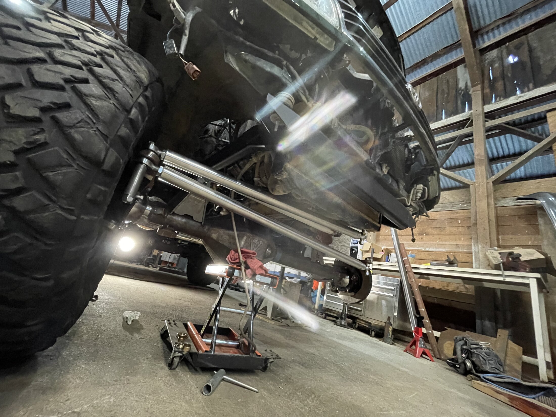

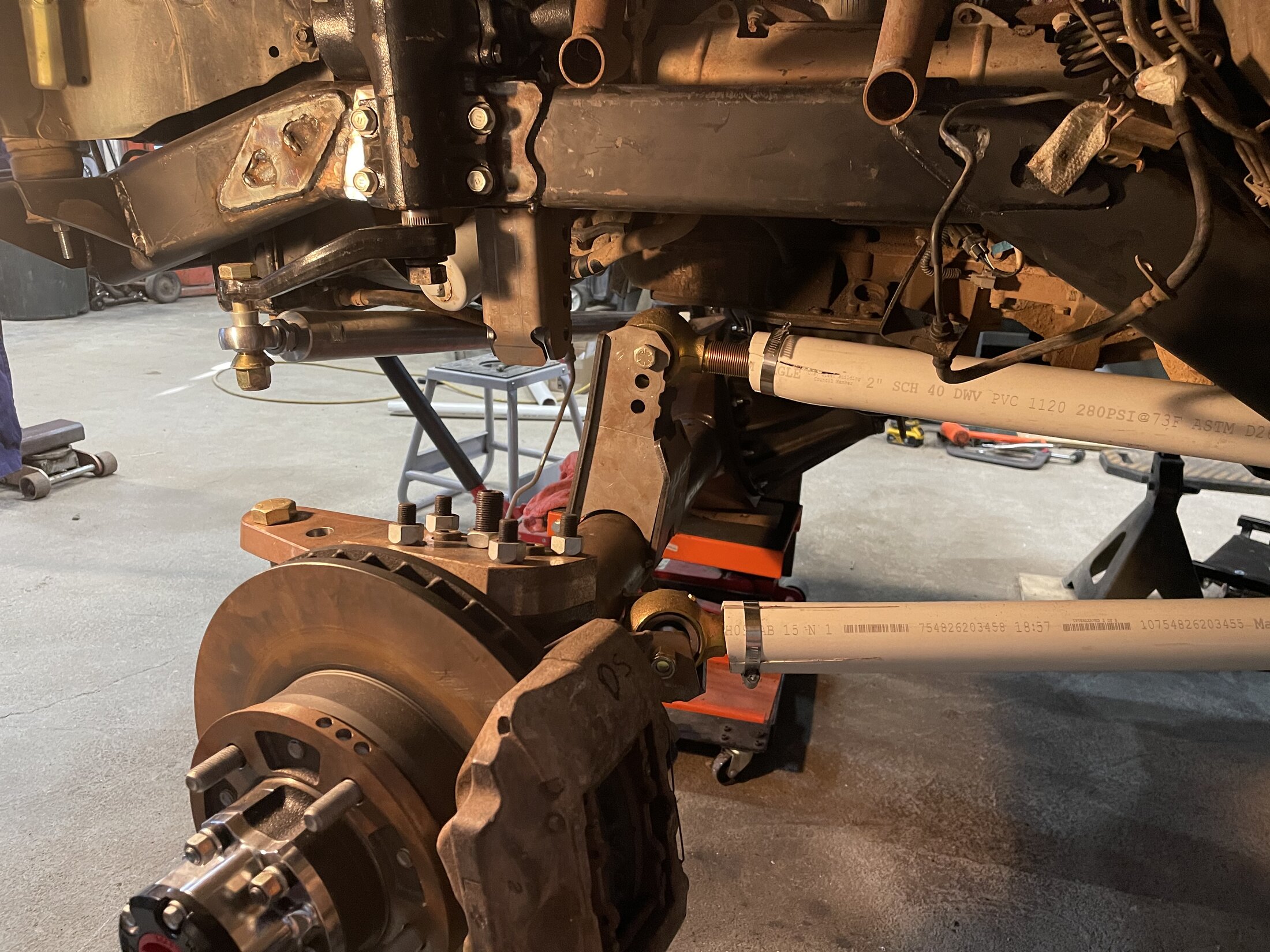

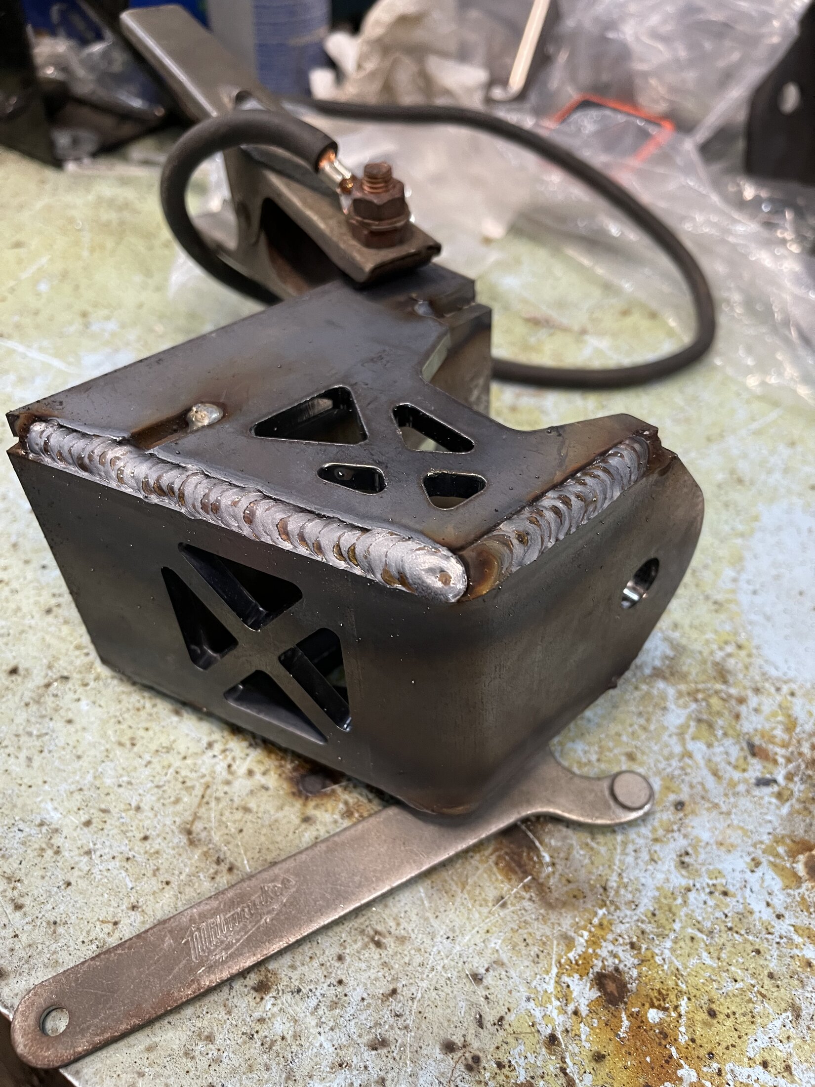

The trail tailor T-case crossmember is in the way of viable placements for lower links. After poking around I think I’ll French the lower link brackets into the cross member. Gives me a good length lower without it to far forward or aft. These were my considerations:
In order of pictures:
1. Frencher into the cross member
2. Behind the member
3. In front
Any critiques as why I shouldn’t French the brackets into the member?
I understand this will put a lot more stress on the 4 (each side) bolts mounting the cross member but it’s not uncommon to mount link brackets into cross members. The benefit is a good link length (~36”) and the ability to create some triangulation with the lowers, reducing stress on the panhard AND reducing my roll axis. Both positives IMO.
If the bracket is behind the member, the link will most likely contact under compression.
Too far forward gives me short links, approximately ~30”. That might induce unwanted binding.
Couldn't you just craft a drop pitman arm for the steering box?
I’ve considered it. I plan on welding a double sheer tab to the arm already, and maybe I’ll ad a small spacer to drop the heim further down. The problem is when the pass side is under full compression it’ll most likely contact the oil filter either way, drop arm or not. I’m not certain on this yet. My drag link and tie rod should be here in a week or so. I’ll mock it up when it’s here but using my PVC mock up tube, it was contacting.
FYI you may want to reconsider the steering shaft. The OEM has the accordion section that is designed to collapse in a head on collision and keep the steering wheel from being pushed into the face of the driver and killing/seriously injuring them. I think some folks will add a shear pin to serve the same function when DIYing a shaft for a custom application like this.
Gotcha. I was wondering what the purpose of that was. Good catch, thanks.

Working on link brackets now. Once the geometry is settled I’ll work on the accessory items; oil filter relocation, PS lines, hydro assist lines, brakes, etc.

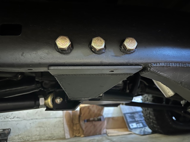

Having issues placing the upper link bracket. I want my upper shorter than my lowers, but these 4 cats are a bitch to work around.

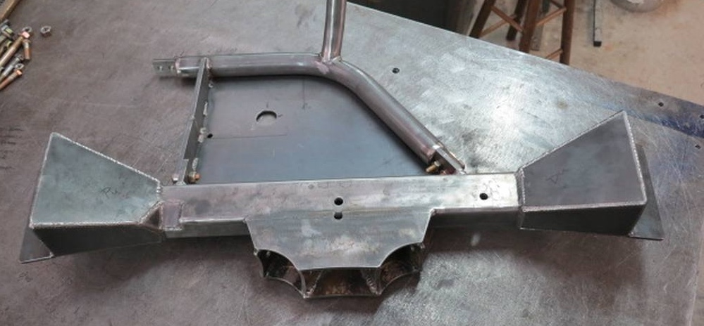

Re: Creeper Skid... I do feel like it needs a more substantial gusseting and mounts. You likely have to remove the OE mounts on the inside of the frame rails and build something there. For ideas, this is the crossmember we came up with. The frame was then sleeved and the crossmember bolted to the frame. Maybe overkill but it serves the same purposes as yours.... suspension mounts, transmission mount and skid.
View attachment 3665796View attachment 3665797
As for Ackerman... what matters is the relation of the tie rod mounts to king pin. Basically, you want that line pointed towards the center of the rear axle... doesn't have to be exact. To clear the pumpkin, offset TRE's might work if you can figure out how to make it work without interfering with the drag link.
Talk about Grade A 70/30 BEEF. That’s a gnarly skid. What was that application?
