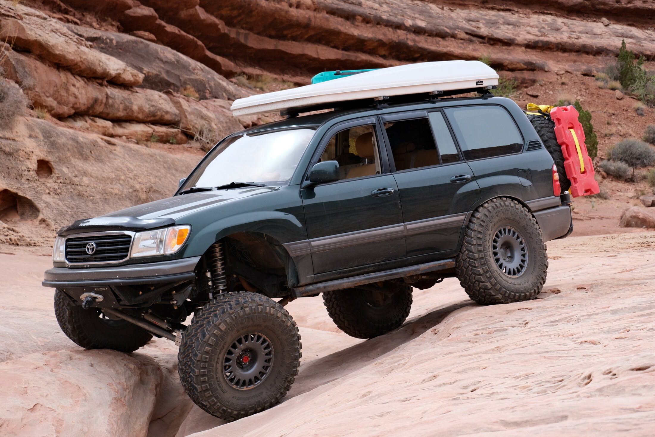

Well done, curious to know what are your coil overs and what are the specs. Thanks
Fox 2.5 DSC resis 14” travel. Tuned by Accutune, I got them used from another dude who had a Cummins swapped 60 series.

The car did great for all 3500 miles of a shakedown. White rim road was rad even though it snowed on us. Top of the world was a blast, and Hell’s Revenge was next level. I tried all the hard lines and barely made it up Hell’s gate even after getting stuck momentarily.
I found 3 of 8 loose motor mount bolts and a rear upper control up missing a nut when I got home but no broken parts (maybe a scratch or two). All in all it was a sick trip. The car was able to hit 90mph in some downhill sections but I was cruising at a happy 75mph for most of the trip. Going up mountain passes wasn’t fun, she needs more power to spin those 40s. Supercharger anyone?

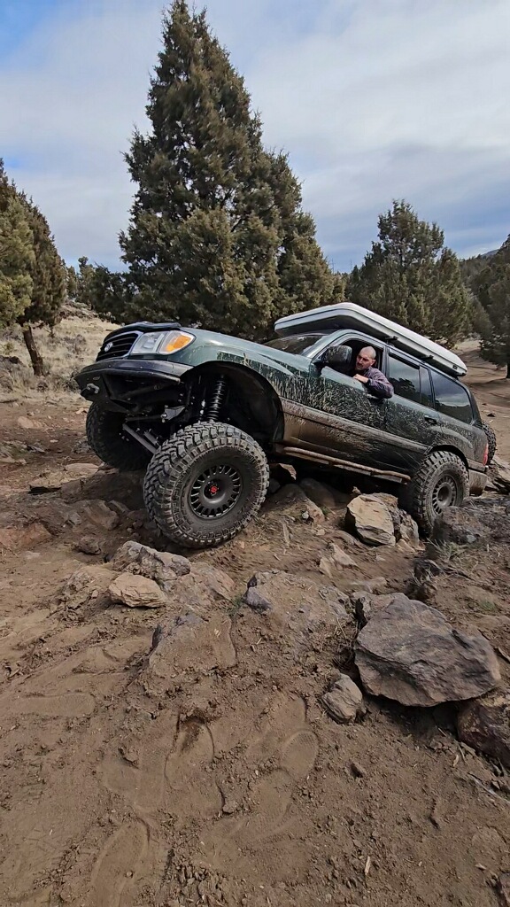

Wheeling it was fun, but it will take some time getting used to the width. I slipped off the right wall coming up hells gate towards the end because I thought I was wider than I am. Counterintuitive because it’s such a large car now.

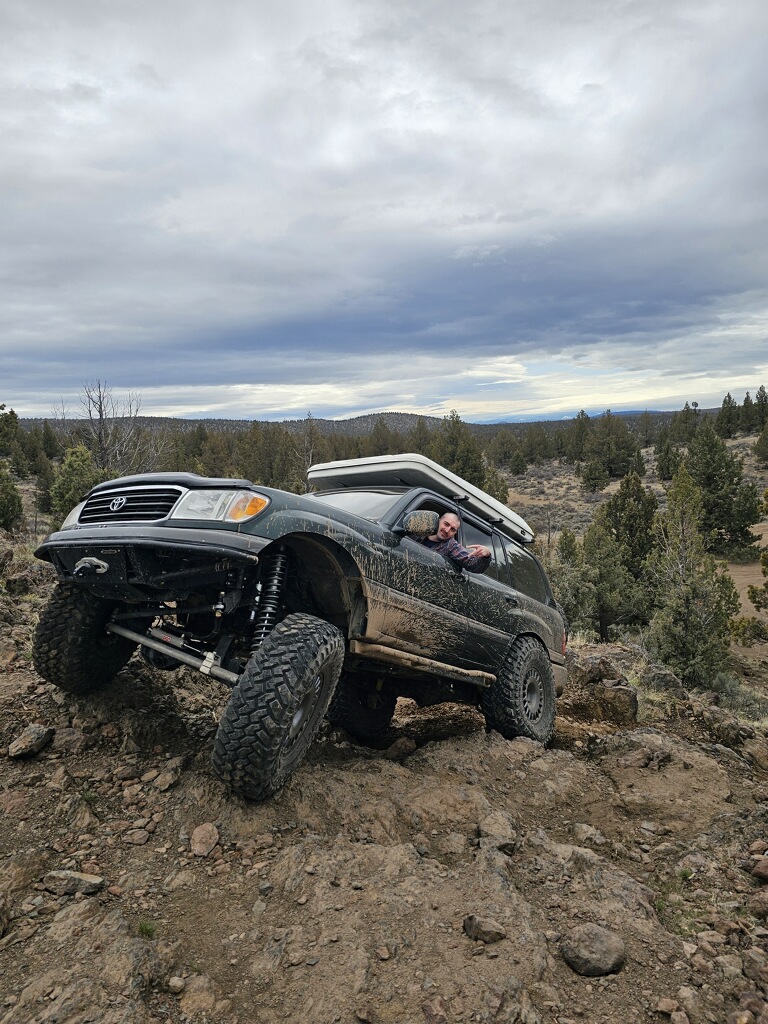

Trevor knows how to pick the hardest line and get up. Who needs lockers when you got balls. Watching him break a sector shaft on top of the world was fun. Within 5 minutes he, Riley and I figured it was an internal gear box problem and 10 minutes later the box was off and the problem discovered. I barely had time to finish off a beer before Trevor’s sick nasty solid axle 100 UTE was back up and running, enough to finish the trail and get to the top like nothing ever happened. Wheeling with competent people helps. There was no stress, no concern. Just fix the problem and keep going. We had contingency plans but didn't need them. Maybe we spilled a little steering fluid but we came out net even because we found an old camper shell that someone dumped and took it back to the camp to drop it off and keep the trails clean.
