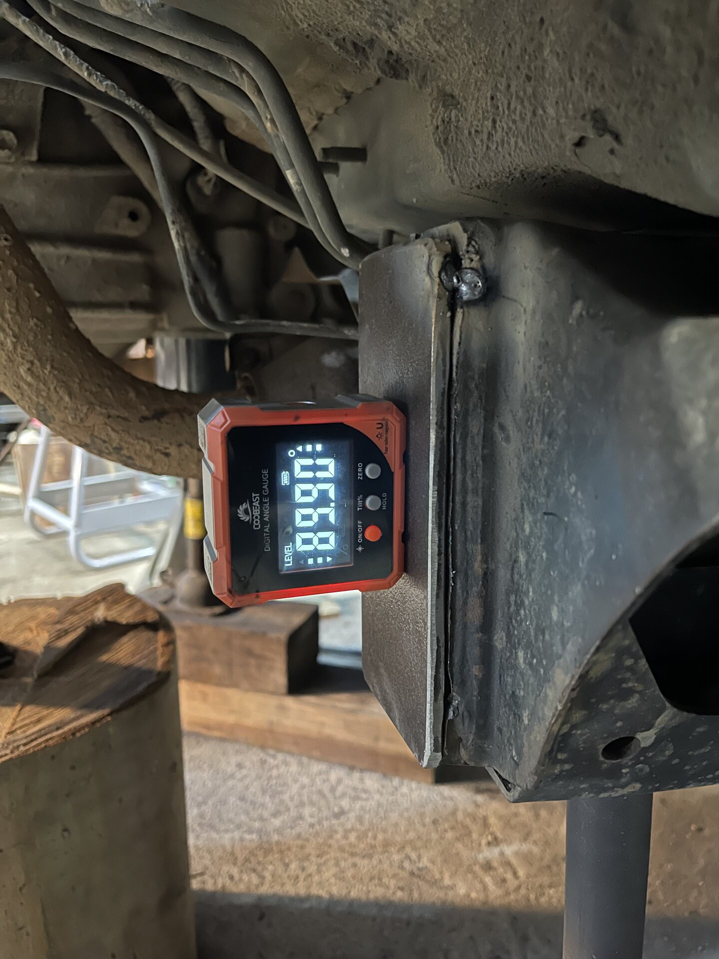

Going back through my emails from FROR/Diamond axle, I ended up with a 15 degree caster at pinion neutral, so with a 9 degree pinion angle (pointed at the T-Case) I should be at 6 degrees of caster at ride height.

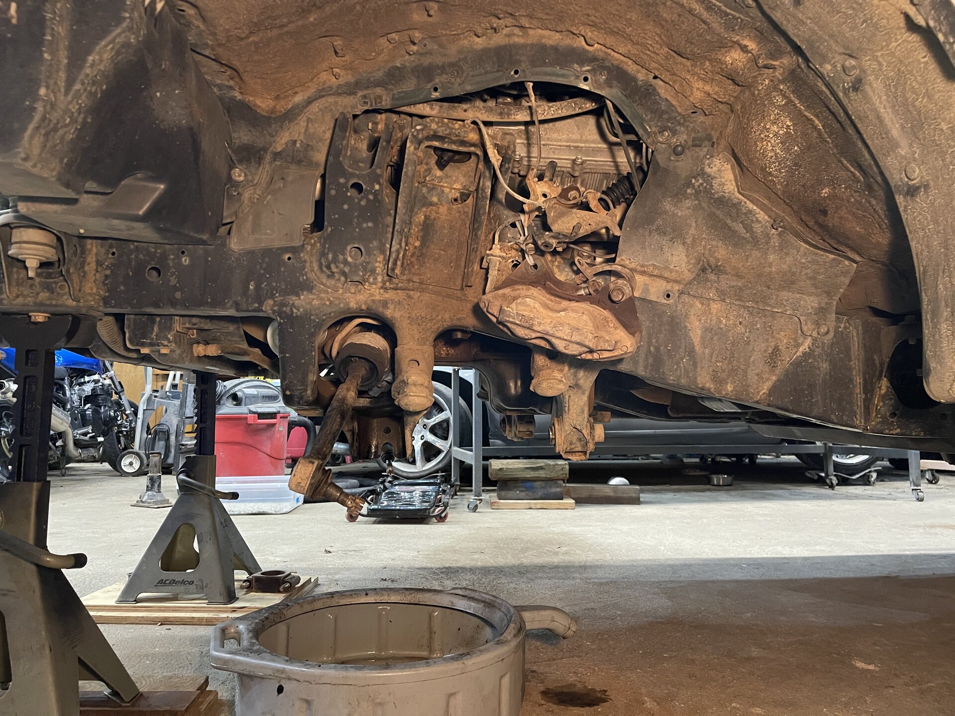

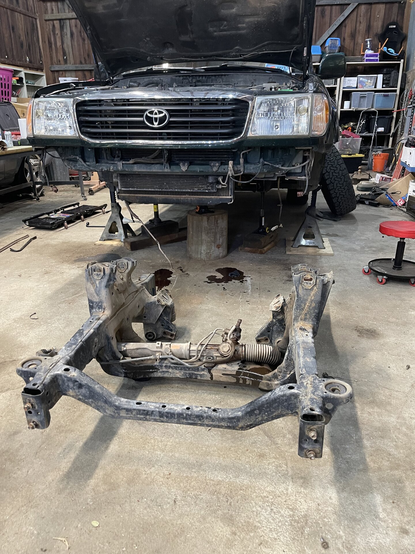

Wrapped up week 1, got all the front suspension and drive out. What’s left in the gargantuan IFS bracket cradle is the steering rack. Saw some videos on how to get it out and decided against letting coolant, oil, and PS fluid drip into my mouth.

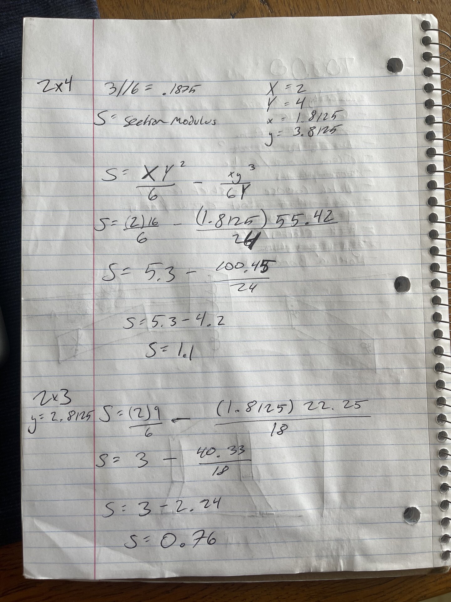

After doing some research, I believe 3/16” 2x4 tube should be acceptable, but this is a 6000lb car… would anyone suggest 3x6 tubing?
Now I am not a mechanical or structural engineer by trade but I’m not a complete novice. Any professional opinions on the matter of frame chopping and rebuilding to get a higher clearance?

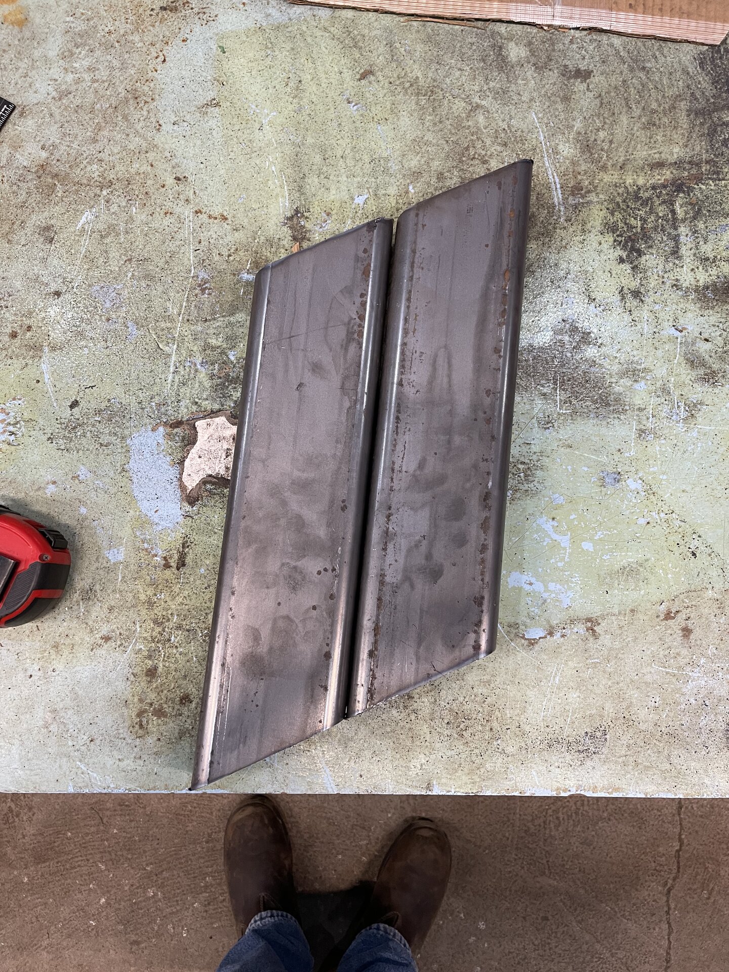

Week 2, April 1-5: Frame cut, new supplies purchased, designing/ building new frame.
I'm using 2x4 3/16" rectangular tubing. Decided on this material versus 2x3 because of the dimensions of the steering box (4 1/2"x2" bolt hole mounting location). I guess I could have used 2x3 but I feel like the 2x4 gives ample space as well as a stronger frame section, less prone to twisting/bending/ etc. I was researching a bit about the section modulus of rectangular tubing and found a formula to determine the section modulus between 2x4 3/16" tube vs 2x3 3/16" tube. I came up with S (section modulus)= 1.1 using 2x4 and S=0.76 using 2x3. I'll post a picture of my calculations below. What do those numbers tell me? I have no idea... I'm just a paramedic. The most math I do is choosing between 1 vial or 2 vials.

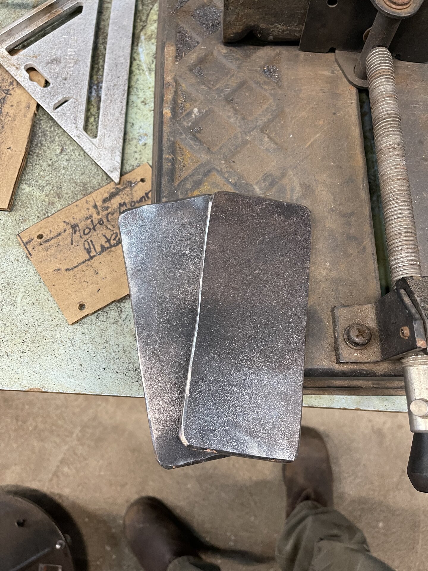

Anyways, new frame is coming together. Busy 7 day work stretch between April 5-12 so won't get much done between now and then. Motor mount fab parts are on order as well as a handful of gussets (gussies as my lady calls them) and fish plates for the new frame section.
I set my first cut frame section at nice easy 30* angles because it's easy to cut and then set the length to a slightly arbitrary 15" section. That places me at level height with the bottom of the motor mount holes on the block almost equal to the top of the new frame section. I did this in order to build the motor mount come out at a flat 90 to sit on or inside the new frame using the KISS method. Figure Occam would approve of this frame build. I'll get to the next section next week.
The frame caps are leveled at ~90* and flush with the cut OE frame, mirroring each other. EZPZ, no special angles needed to consider, just equidistant from each other at the outside measurement/inside measurement. These will be finished welded once more of the frame is complete, gusseted (gussied) and plated.

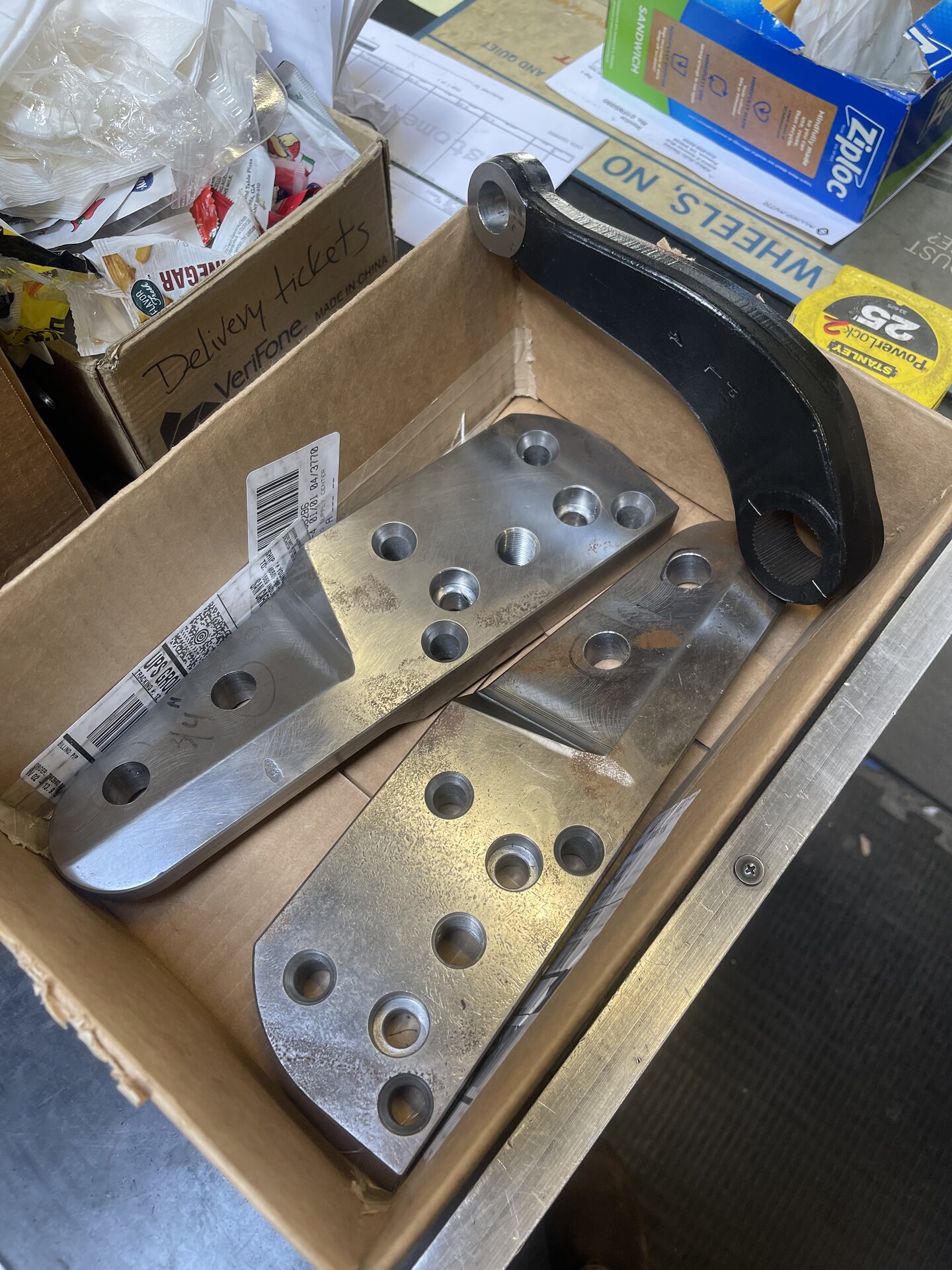

I have all the hardware for my axle now so I'll be putting that together in my garage here and there this week if I have time or energy. I got my hellfire high steer arms back from a machine shop. Arms and 105 pitman arm are drilled out to 3/4" to accept big ole heims, aiming for a double shear set up on the cast pitman arm and hellfire knuckles, similar to how Adam at Stellar Built fab'd up that 80 series.
anyways, pictures:

Good on you to do some basic calcs. Essentially, a higher section modulus means for a given moment (force applied at an distance), there’s a lower internal stress on that cross section. So, bigger section modulus means less stress. Stress is bad, but you know that cause you’re a paramedic :)

Good on you to do some basic calcs. Essentially, a higher section modulus means for a given moment (force applied at a distance), there’s a lower internal stress on that cross section. So, bigger section modulus means less stress. Stress is bad, but you know that cause you’re a paramedic :)
That’s funny cause I like stress.
But thanks for the simple explanation, makes sense
