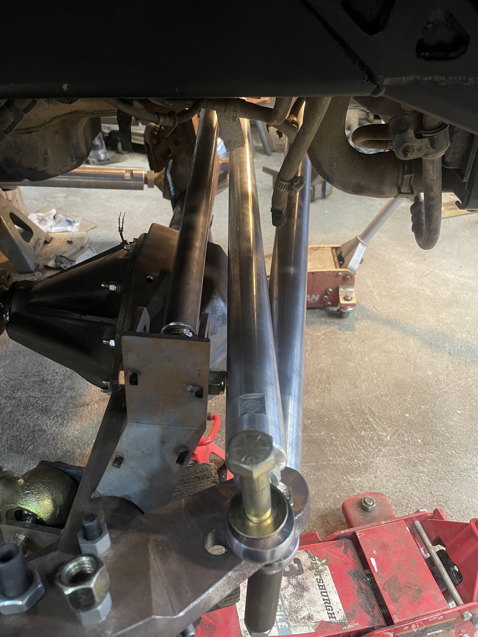

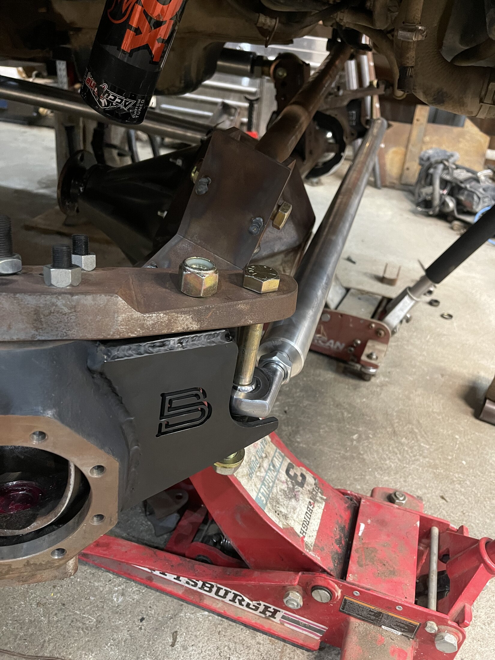

I’ve tried fussing around to get the tie rod to fit in the near hole for proper ackermann. The 2” diameter rod doesn’t like that tight of a fit. Pics to follow.
With the tie rod underneath the steer arm, it won’t fit because it contacts the drag link (also only fits under the arm) as well as contacting the front of the diff housing.
On top of the steer arm it contacts the panhard axle bracket. I cannot move the panhard axle bracket further back because then the panhard/ track bar will contact the diff cover on top as well as contacting the oil pan on full stuff/ pass side compression.
In order for the panhard/trackbar to not contact those big items, I have to move it further towards the front of the car anyways.
I even adjusted the tie rod 1” forward to check clearance if I had offset heims and it still would contact the panhard axle bracket.
Kinda bummed. I tried…
It's because the knuckles were originally designed for the 8" differential. Offset TRE's might work but quite a bit of room/offset is needed. Or just try forward holes and see if it works out.

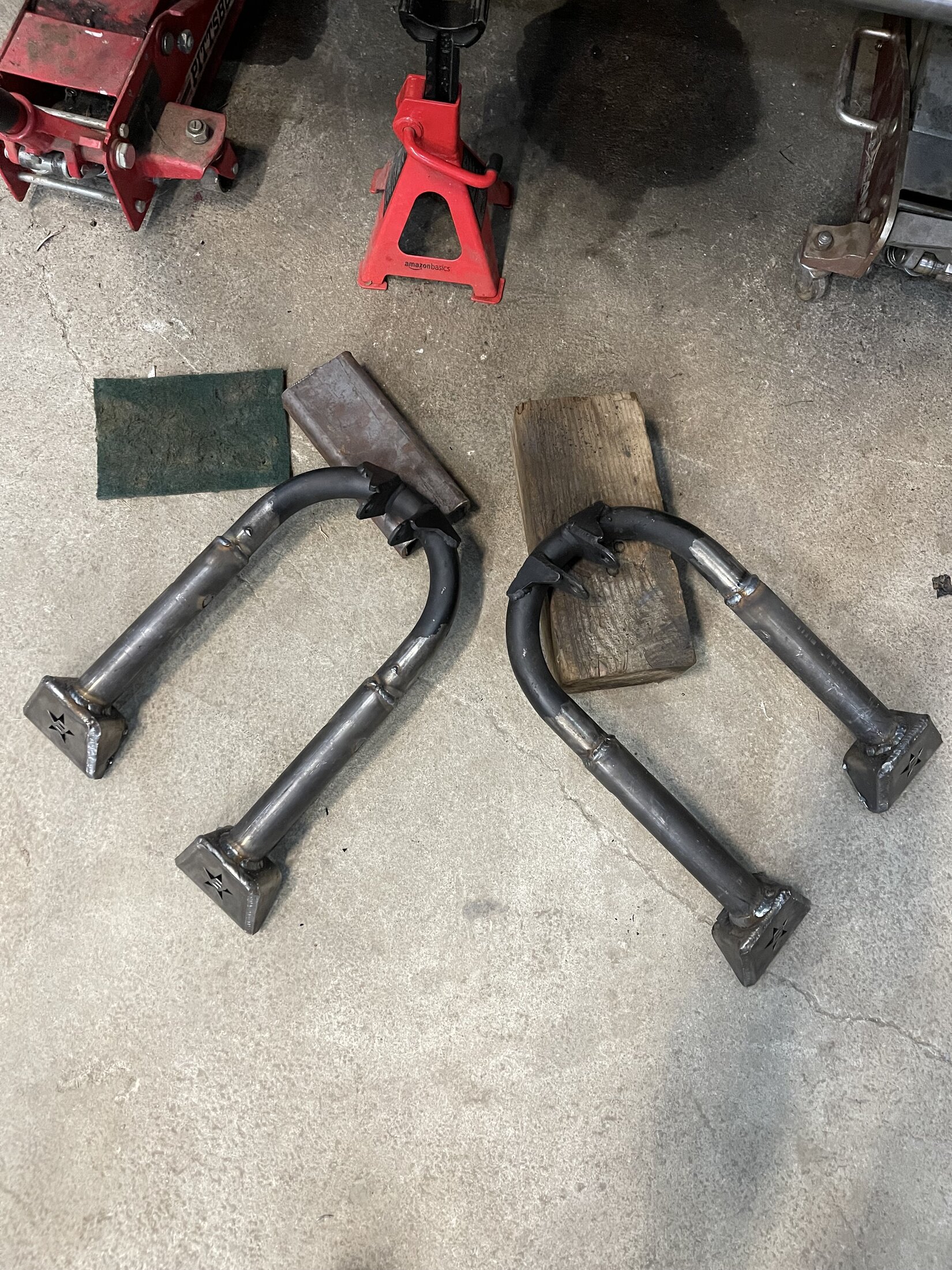

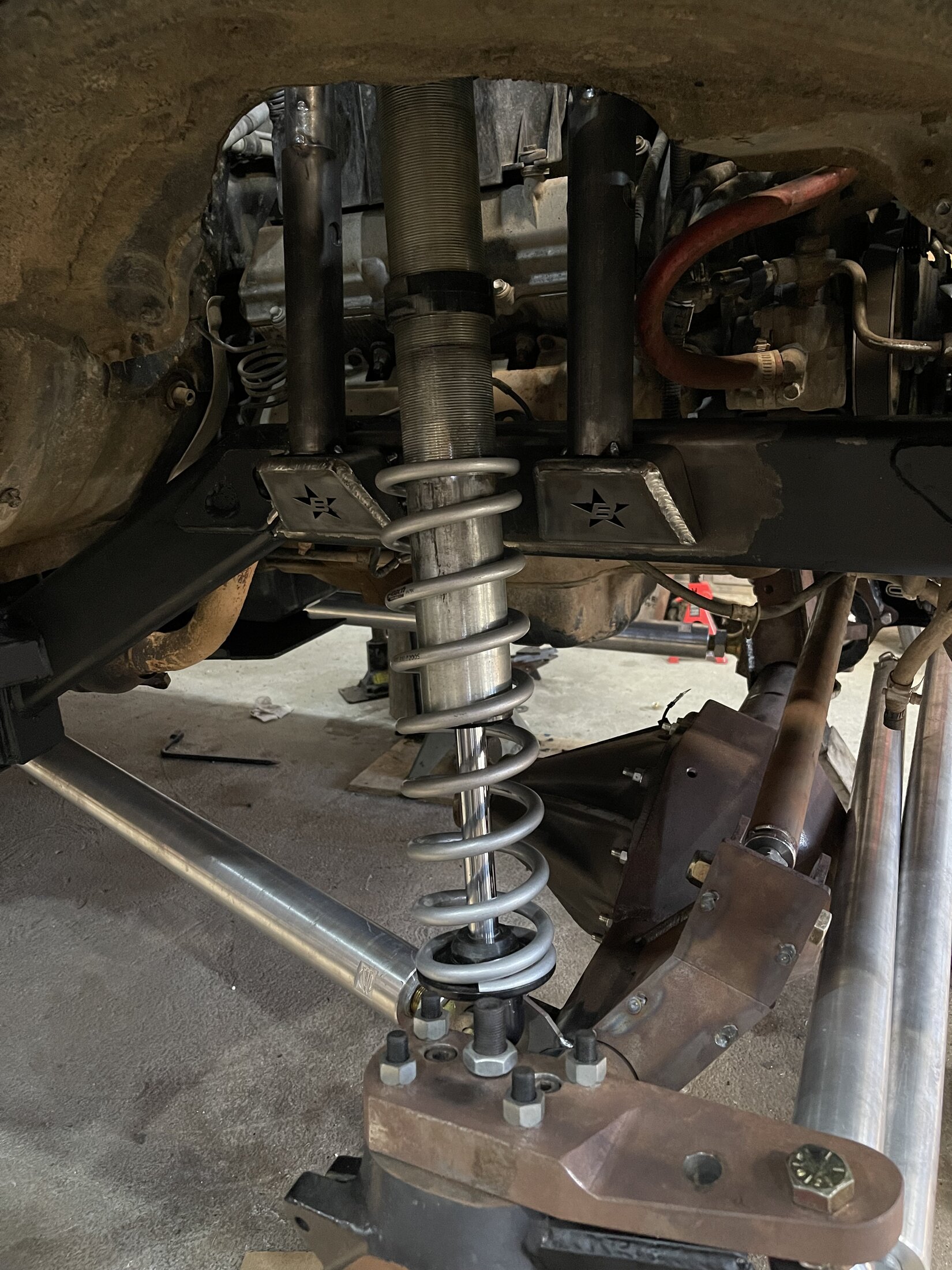

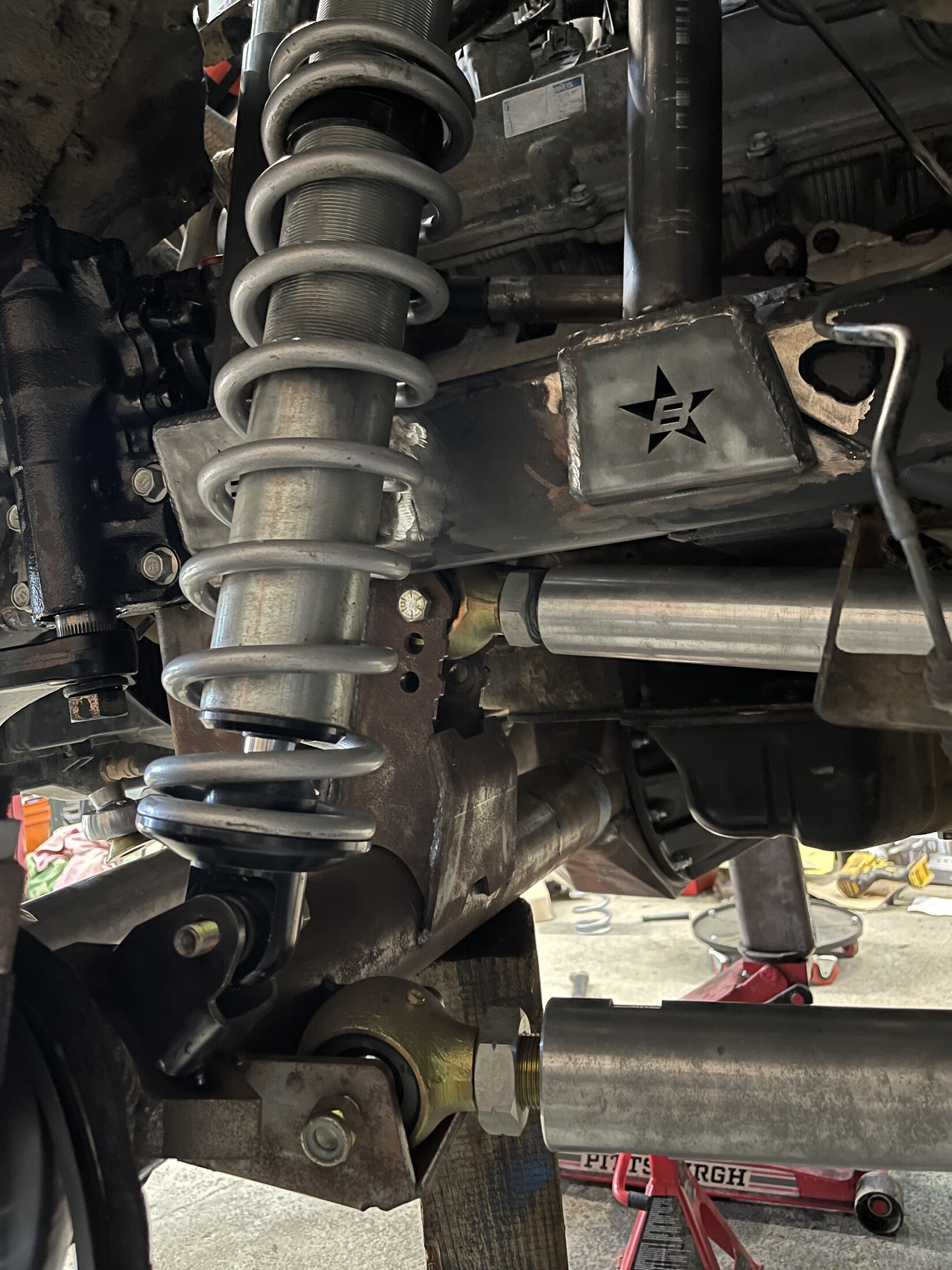

Coil over hoops took a while to get dialed. I didn’t use shock towers because they couldn’t fit with the brake master/ accumulator assembly, or at least I didn’t want to make them fit.
I had to sleeve the hoops to extend them because of the long 14” coil over I’m using. I sleeved the hoops with 1.75”x .120 wall DOM and now I have approximately 6” shock shaft showing at ride height which will be bumped to 5.5” up travel and limited to 7.5” down travel.

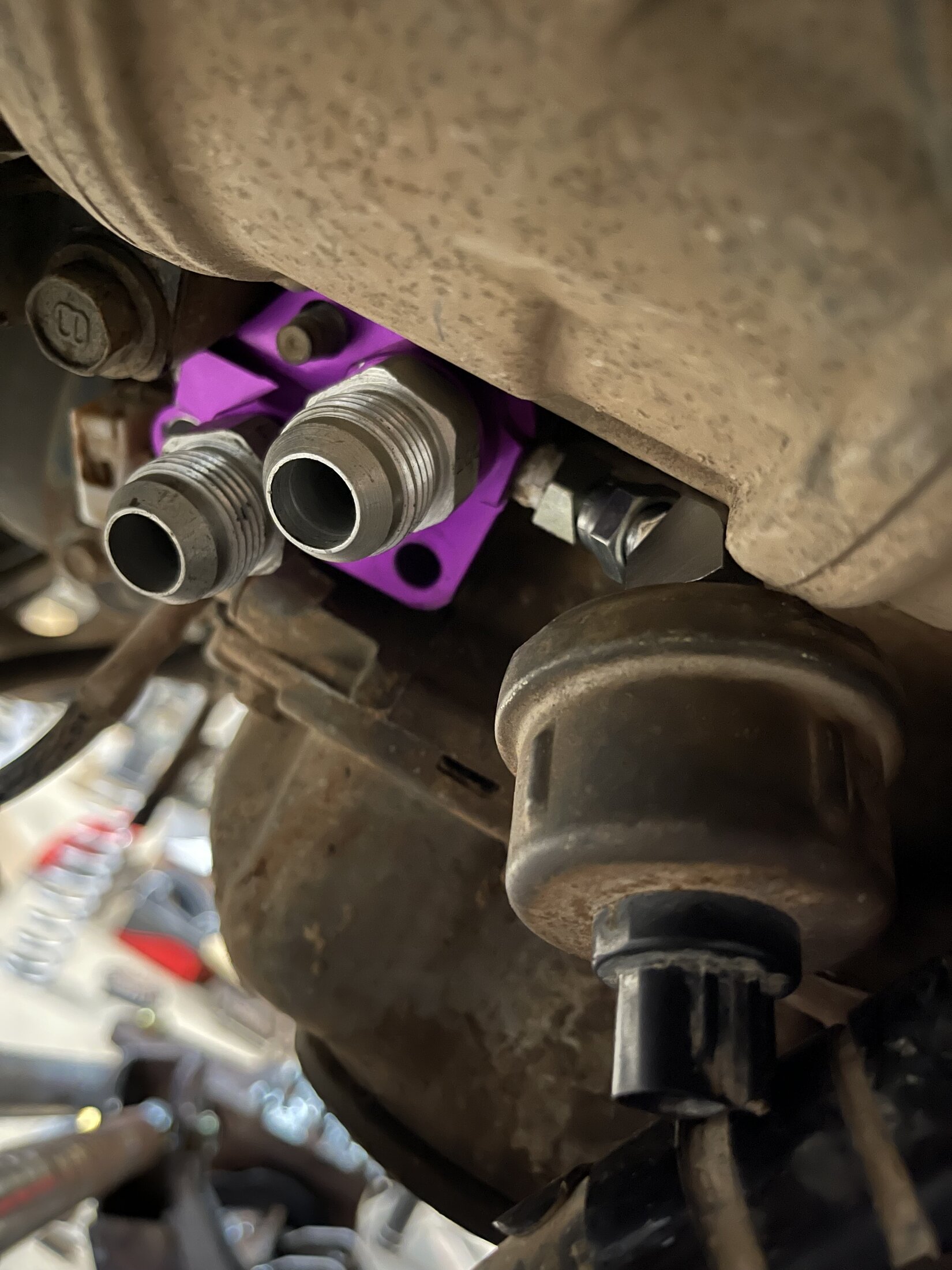

I’m also in the process of relocating the oil filter.

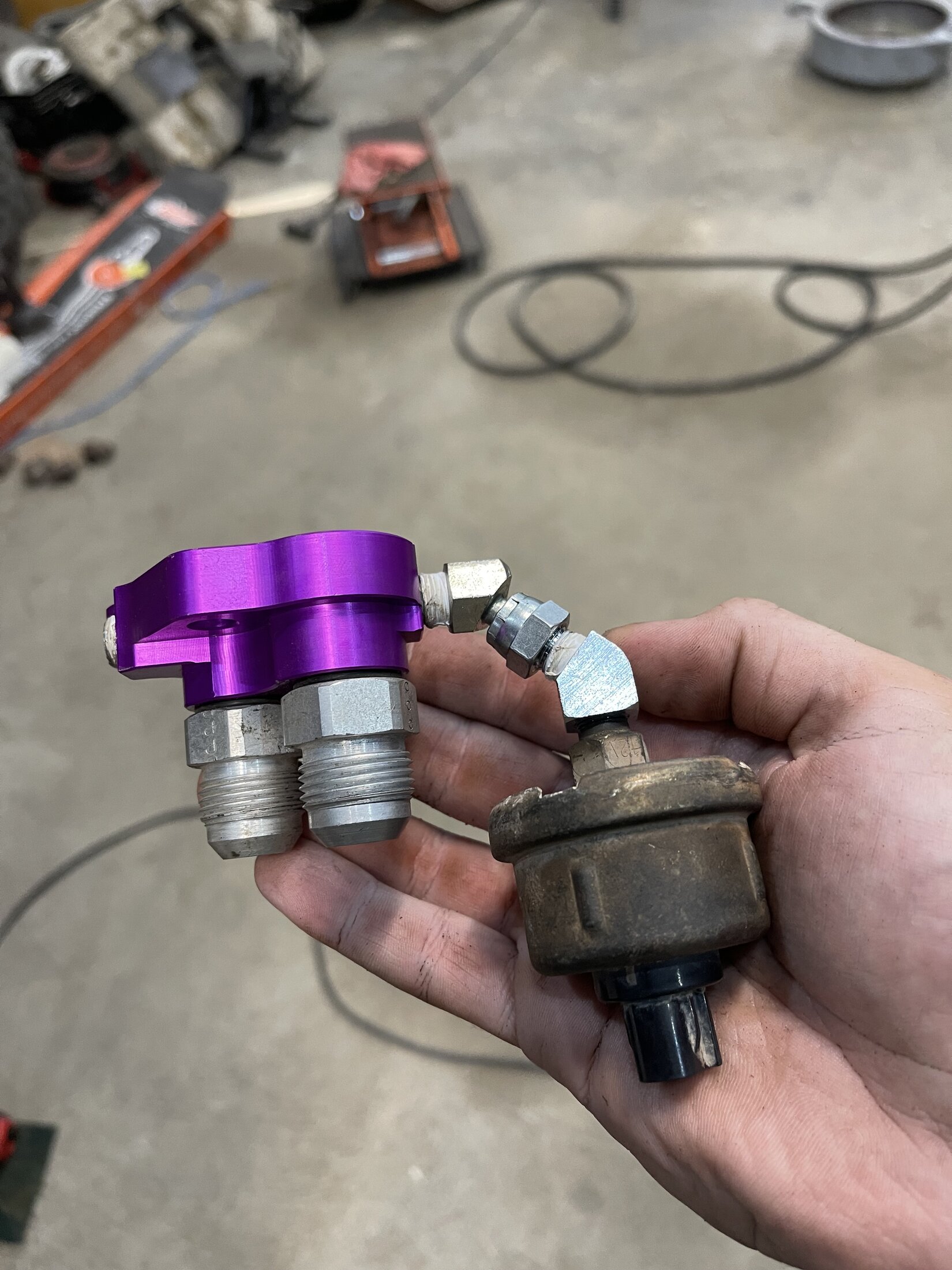

I won’t be using the coolant housing so I’m thinking of using a small universal 10 row oil cooler (radiator). Any hesitations with this? Will the small passageways in this radiator affect the oil flow/ pressure? Should I cool the oil before the filter or after the filter?
Also, right now the oil pressure sender won’t fit next to the block with the new adaptor so I’m working on fitting it with multiple 45 degree 1/8 NPT fittings.
This looks janky right now, so it’s a temporary fix but does anyone have suggestions to fix this problem?

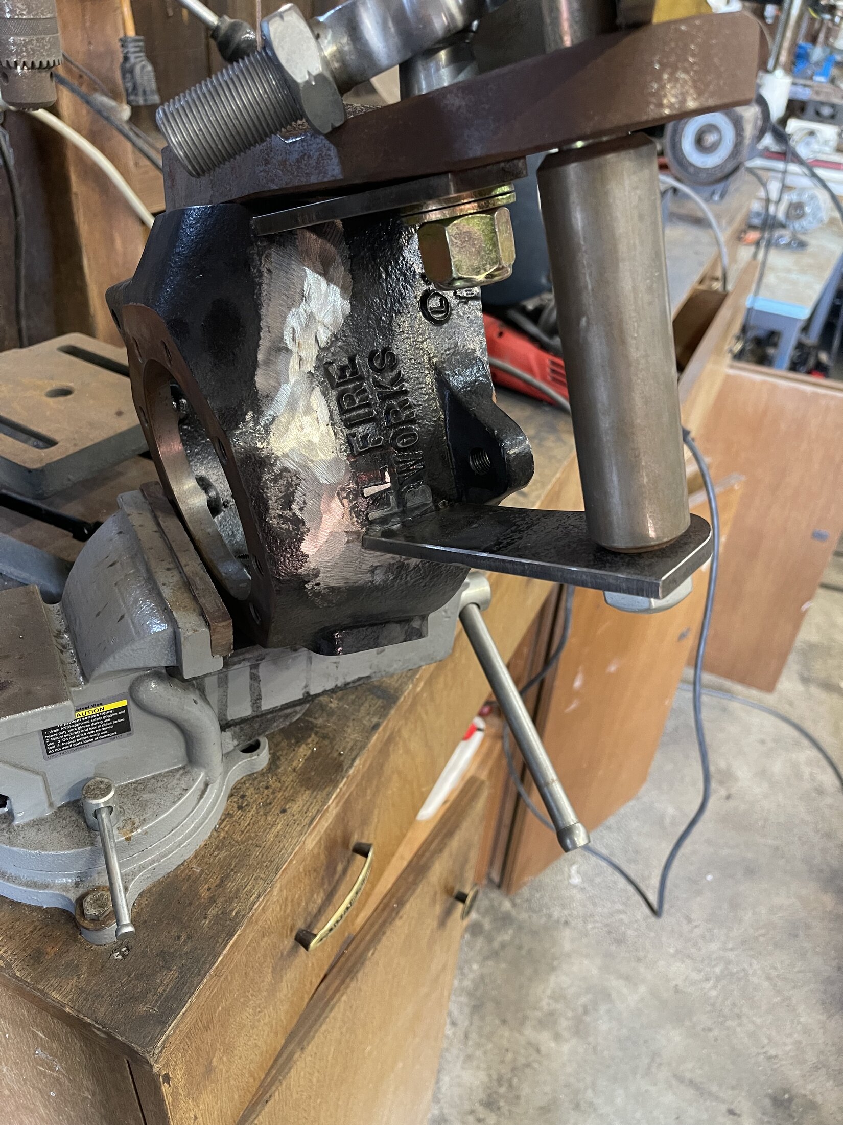

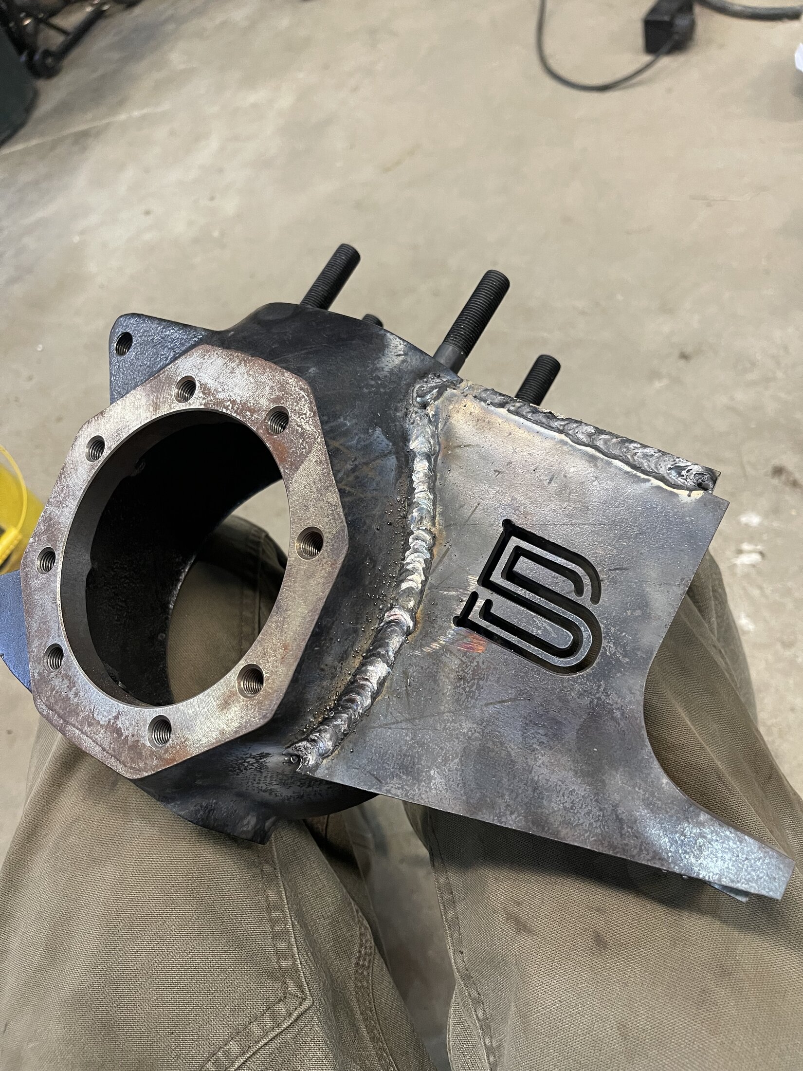

Also double sheared the steering knuckle. I attempted to weld the mild double shear bracket to the cast knuckle. Preheated to 550-600 Fahrenheit and then used dual shield welding process (MiG + flux core wire)
Should be strong. Hope it doesn’t crack.
