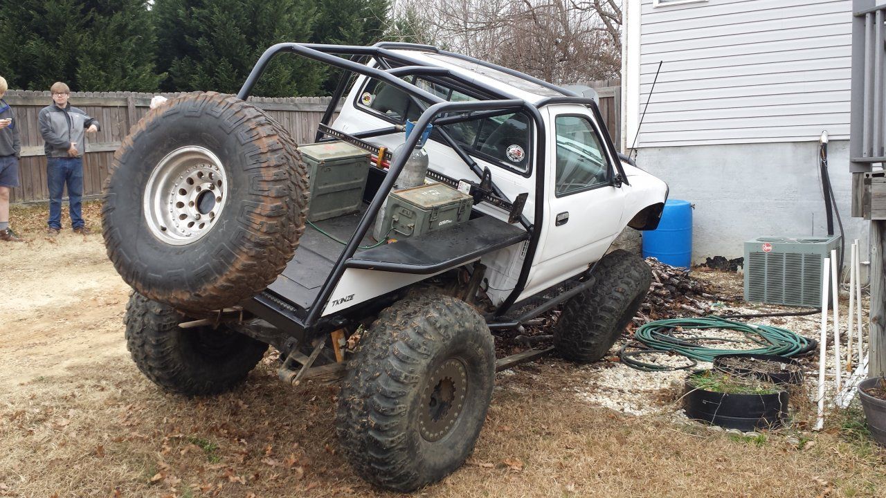

Unofficially complete, still a few minor things to wrap up but the big stuff is knocked out.
Thanks for all the help guys!!!
  1. install new cab 11/1 - 11/8
  2. Reinstall sun roof 11/11
  3. exo above cab 11/15 - 12/7
  4. fender tubes 12/1 - 12/7
  5. complete X behind cab 12/7
  6. Sheet metal bed 11/26-28
  7. install passenger seat 12/16
  8. new master brake cylinder and bleed 12/6
  9. new battery 12/6
  10. swap spare tire to beadlock wheel (New Tires instead) 11/29-11/30
  11. spare tire carrier gonna use the old one for this trip
  12. mount tool boxes 12/14
  13. mount hi-lift 12/14
  14. mount C02 tank 12/18
  15. paint hood 12/18
  16. paint cage 12/7
  17. purchase & install tail/brake lights 12/6
  18. rewire and reinstall backup lights 12/20

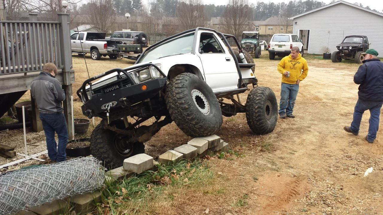

Rollin up the "Done" wall. Seems every time we complete a truck this is what we do.
