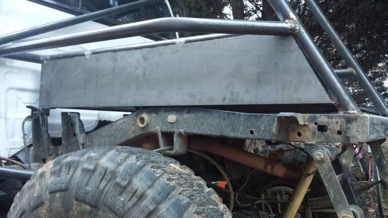

need to take a break, back is killin' me. Got the bed about done in the last couple of days, just needs a splash more of paint. Kinda on the fence about the black/white scheme, could use a little color.
Instead of hooks in the corners for tie downs I built a rail, 2 pieces of 1/2" round stock.

I wish you'd consulted me before you started with the sheet metal Ted. I want to cut all mine out and redo it with underbed storage and some sort of slide outs behind the cab. You had it all open, and still just did a flat bottom and flat sides. Tons easier, yes. But sooo much wasted space; space that could've been utilized to keep your CoG lower, tools & parts cleaner, and making individual items more accessible. Hell, since you're doing a new winch, that too can go underneath in the back to save space, protect the winch, and allow to pull front or rear with one winch. (Did you ever see my setup on ol' Rusty Red?)
As for the winch...
The first gets my vote in most categories. Looks cooler, more waterproof, has wireless.
However, the solenoid pack is not as easily moveable for remote mounting if desired and the whole thing weighs a lot more (probably a good thing for long term durability though). I'd say do the comp version with syn line and a Hawse unless you're going to consider mounting in the back like I mentioned above. In that case, do the regular steel cable.
Oh yeah, and don't worry about getting the cage extremely close. It does look better, but over time your cab will bounce into it and get dented up. It's also minorly annoying trying to get a strap fed through some spots for recovery efforts on occasion.
Yet another thing I just realized:
While I love your full-length tie down bar, do you have any provisions for tying down to the bottom? Think about low stuff like driveshafts or axle shafts; you can't strap stuff like that to a spot as high as that side rail (at least not very easily). Need at least a few eyes down there to cinch stuff straight down. Maybe find a way to make "pop-up" loops like a lot of truck beds have these days.
Keep in mind this is just the base for the next series of mods. As you already know storage is a constant problem with mini trucks, I still have a couple trick up my sleeves but just not enough time to do them all within the next few weeks.
Right now I plan to mount my 2 large ammo cans, one holds my 2 tool bags and the other contains all my recovery gear, a grinder an inverter and several other items. After that I'll build another storage compartment under the bed similar to the old one only much larger and deeper for fluids and other misc. crap.
Tie down(s) in the bottom are on the list, just haven't gotten to it yet and may not for a few weeks. More than likely it will consist of simply cutting a 2" hole in teh bottom shet metal and then weld a small piece round stock across the hole from underneath to create a simple hook point. It'll be clean, simple, keeps the bed flat and wont make any rattling noises on the trail.
I'm also hoping there's enough of the old rubber bed mat leftover to cut to size for this bed.
