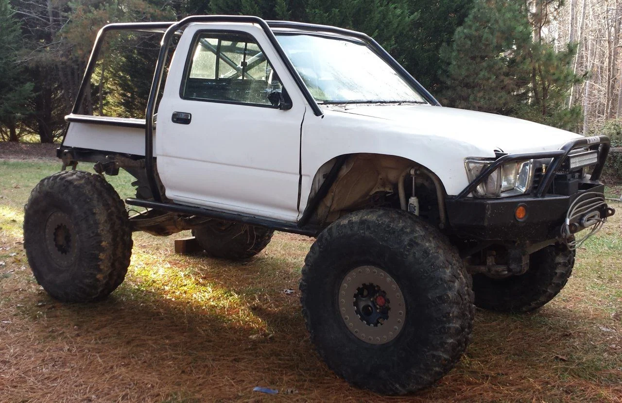

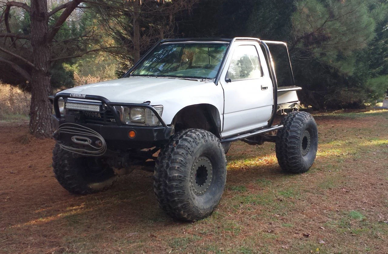

looking really good! i like the hidden fender bars a lot.
Just a thought, but do you have sold body mounts? Cage is ties to frame rigidly, body IF sitting on poly or rubber bushings will flex and may cause more harm than good if welded to the cage.... now if it is still mounted hard like when you had the internal cage then you should be good, otherwise I'd watch for cracked welds or torn inner fenders.
That aside I think it looks b!tch!n'!! Love the 39's
The body will flex some, I expect that and have even considered tying the cab into the roll cage further. But, it sure as hell wont flex like the old cab did with the rear cut out. I had stress cracks all over the place and it was just a matter of time before it disintegrated. It's turning out that the rollover at AOP has been both a good and bad thing, I guess.
Big tars make everything look better.
thanks guys, Honestly I've been on the fence up to this point and even wished I'd done it a little differently but the 39s really pulled it together for me. Now that I've finally seen a fender go on I'm really starting to like it and once i get everything back on like the tool boxes and Hi-Lift I trust it'll finally look "right."

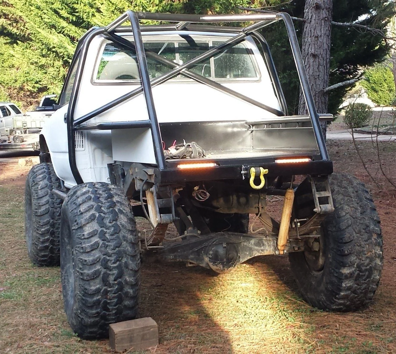

slowly knockin things off. Most of the heavy fab work is now complete. Finished up the Exo over the cab this evening and got one the tail light housing made. :clap:
Light was supposed to be red, oh well. :bang:

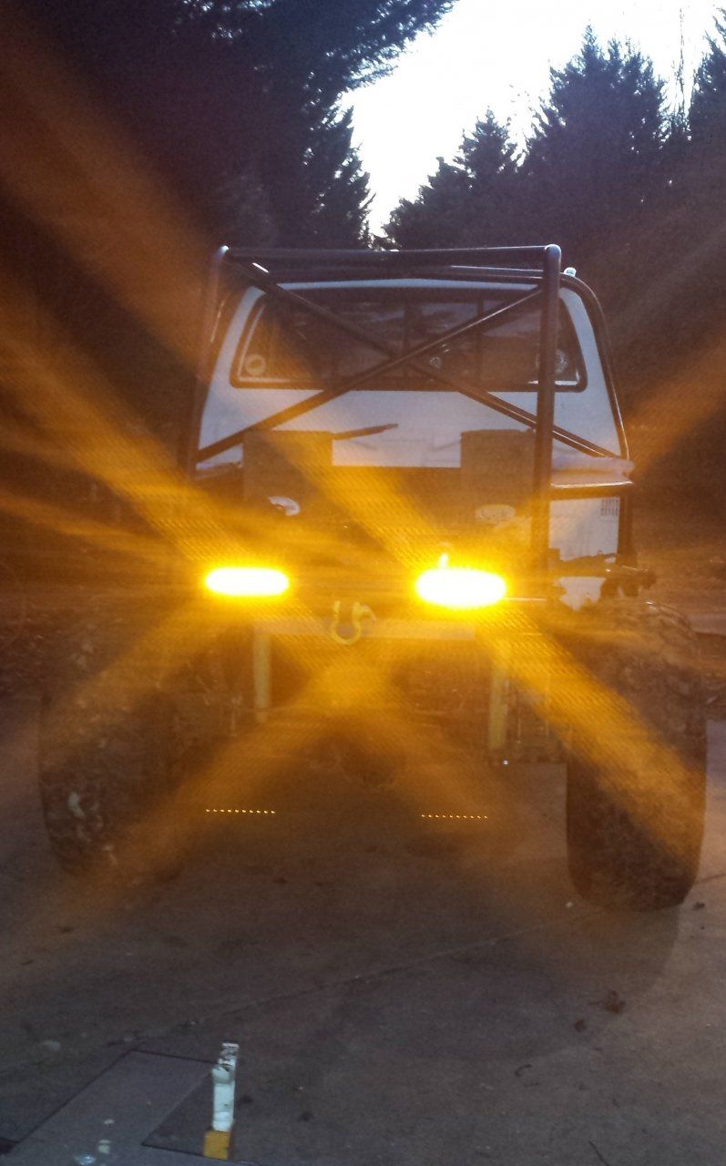

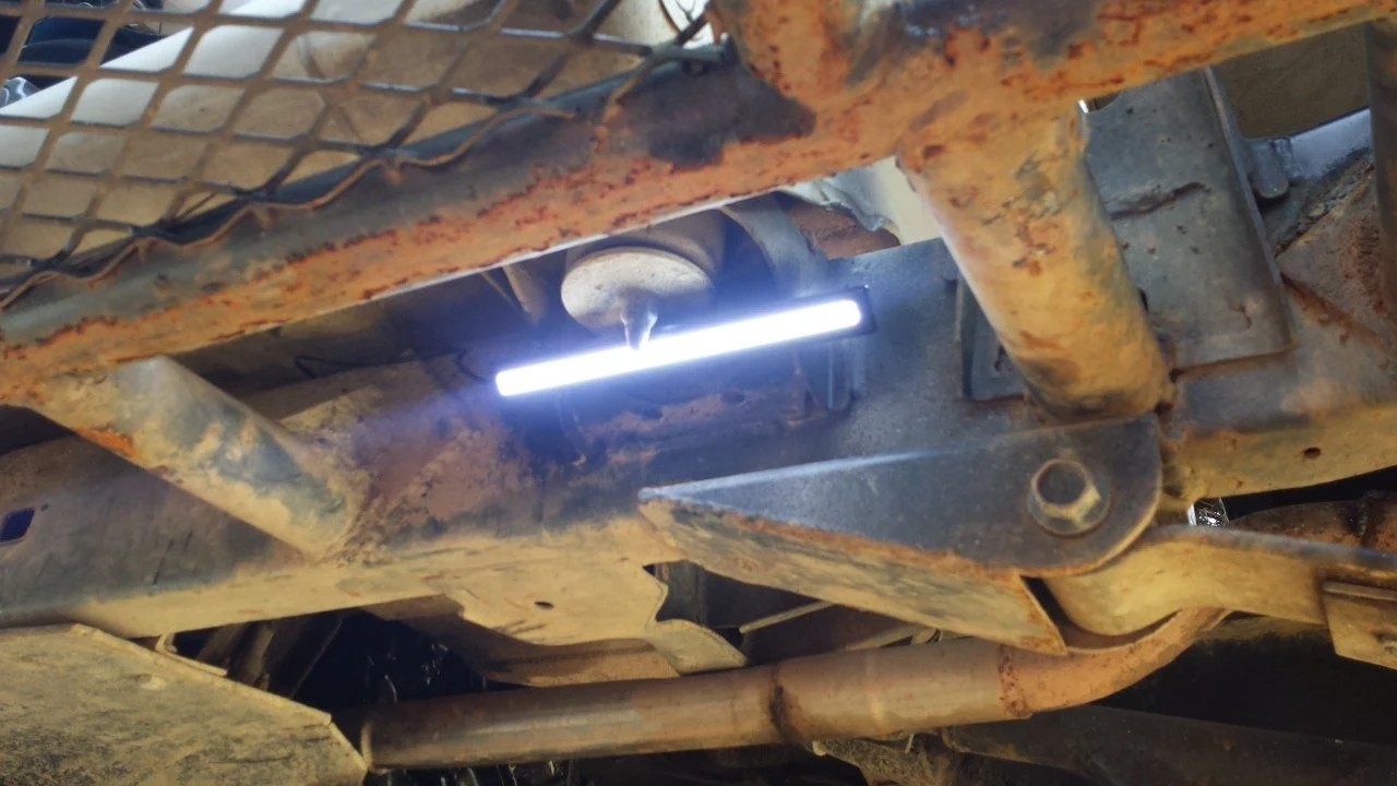

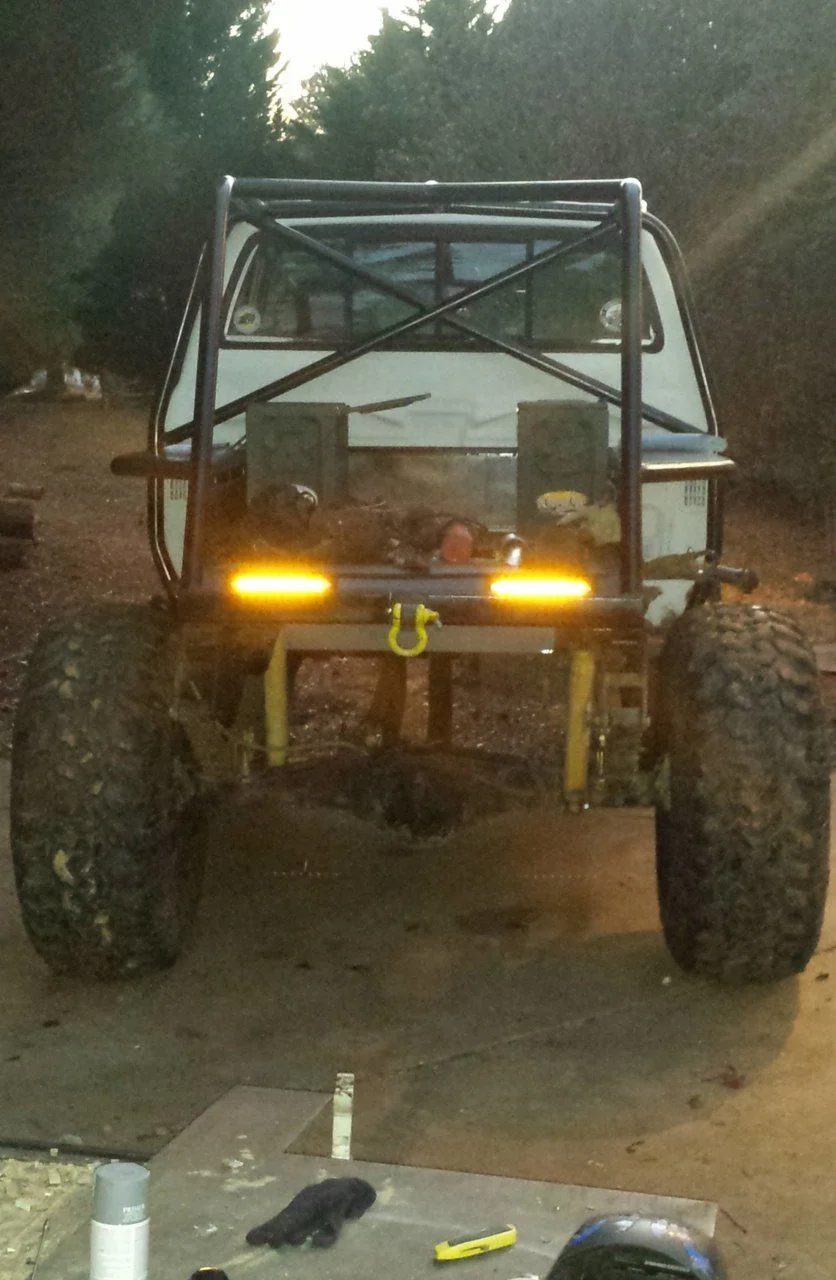

Startin' to see light at the end of the tunnel. Brakes done, brake lights done, Exo done, actually got 4 rock lights wired up and working. Damn those little things are bright, 2 more to go.
Then to get to storage. I dry fit 2 ammo cans--nope, need a plan B.

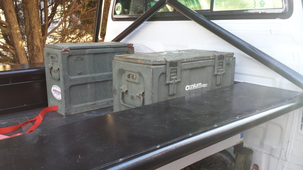

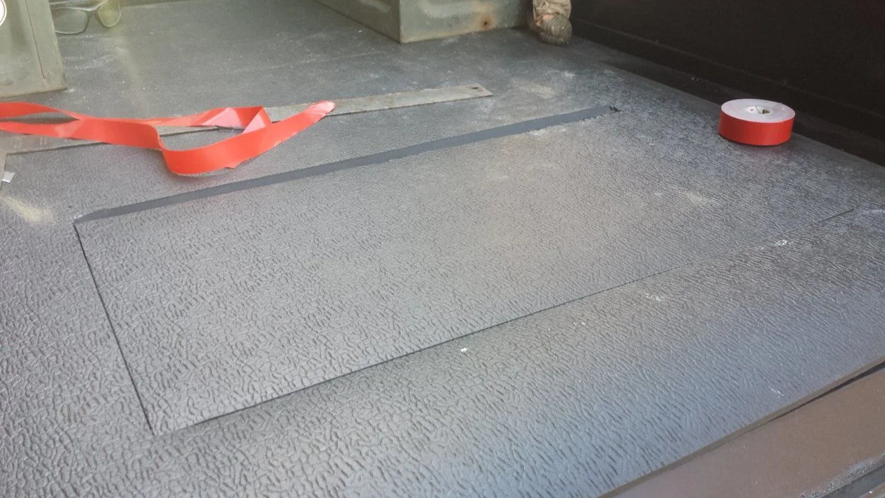

New under bed tool box is done and Ammo can boxes mounted.
24x13.5x8

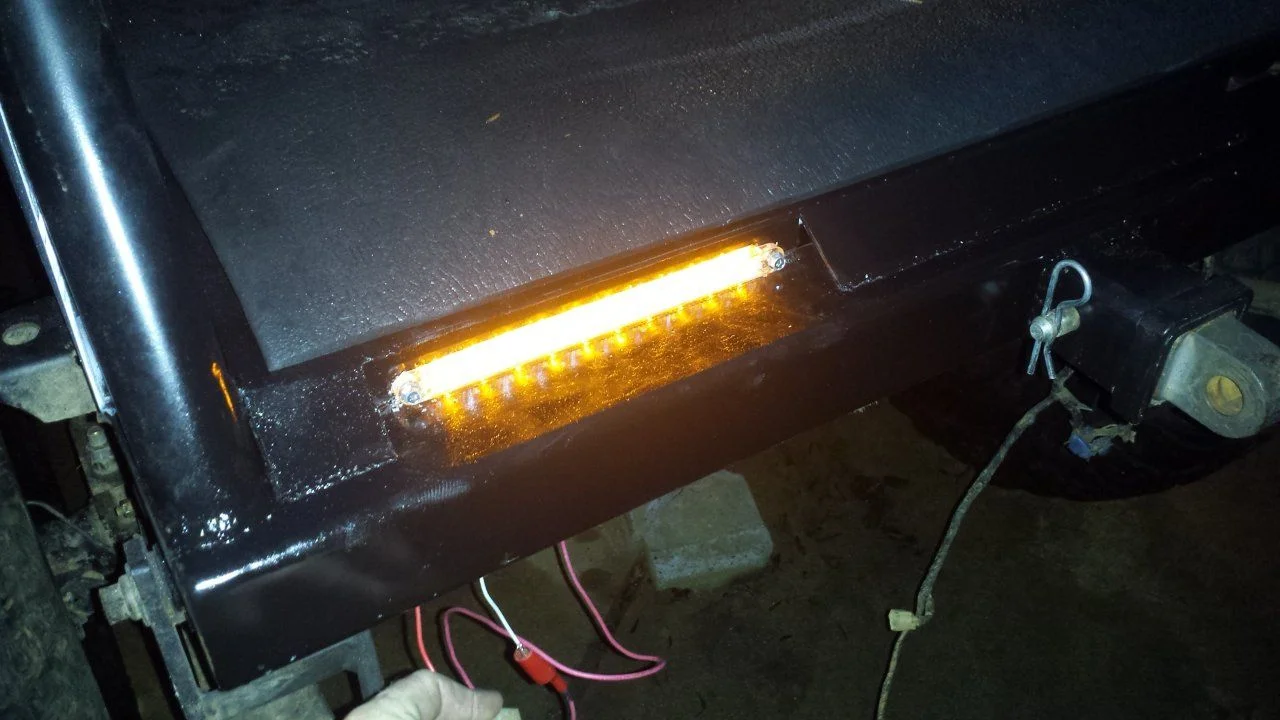

So just to show the tail/stop lights. Like said earlier they were supposed to be red but there was a screw up. Anyway, bright.
Thoughts?

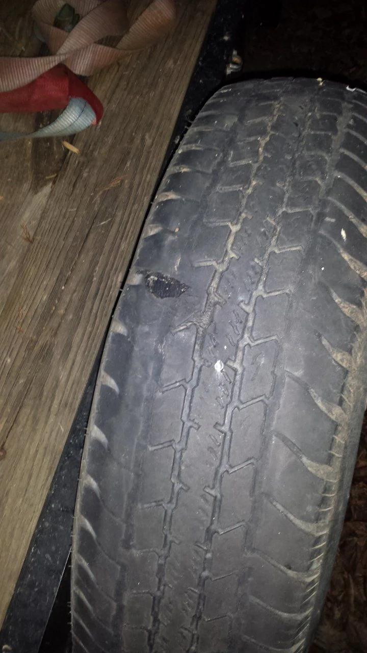

look'n like I need to get a new spare for the trailer before New years. :bang:
