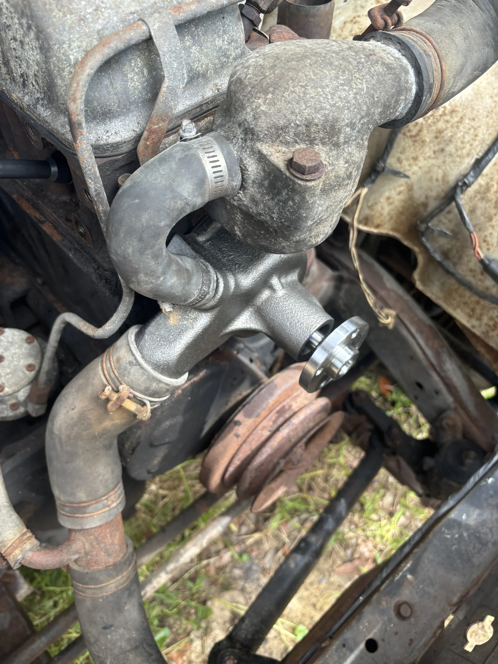

I got some parts in the mail for the 55 project. I bought a rock auto 1f water pump, Denso Plugs, NKG wires (blue wires), and points and condenser. I am planning on picking up a battery off the Island too. from what I have read the water pump should work. I am also happy to say I already have a belt from the salt wagon project that should work with this.

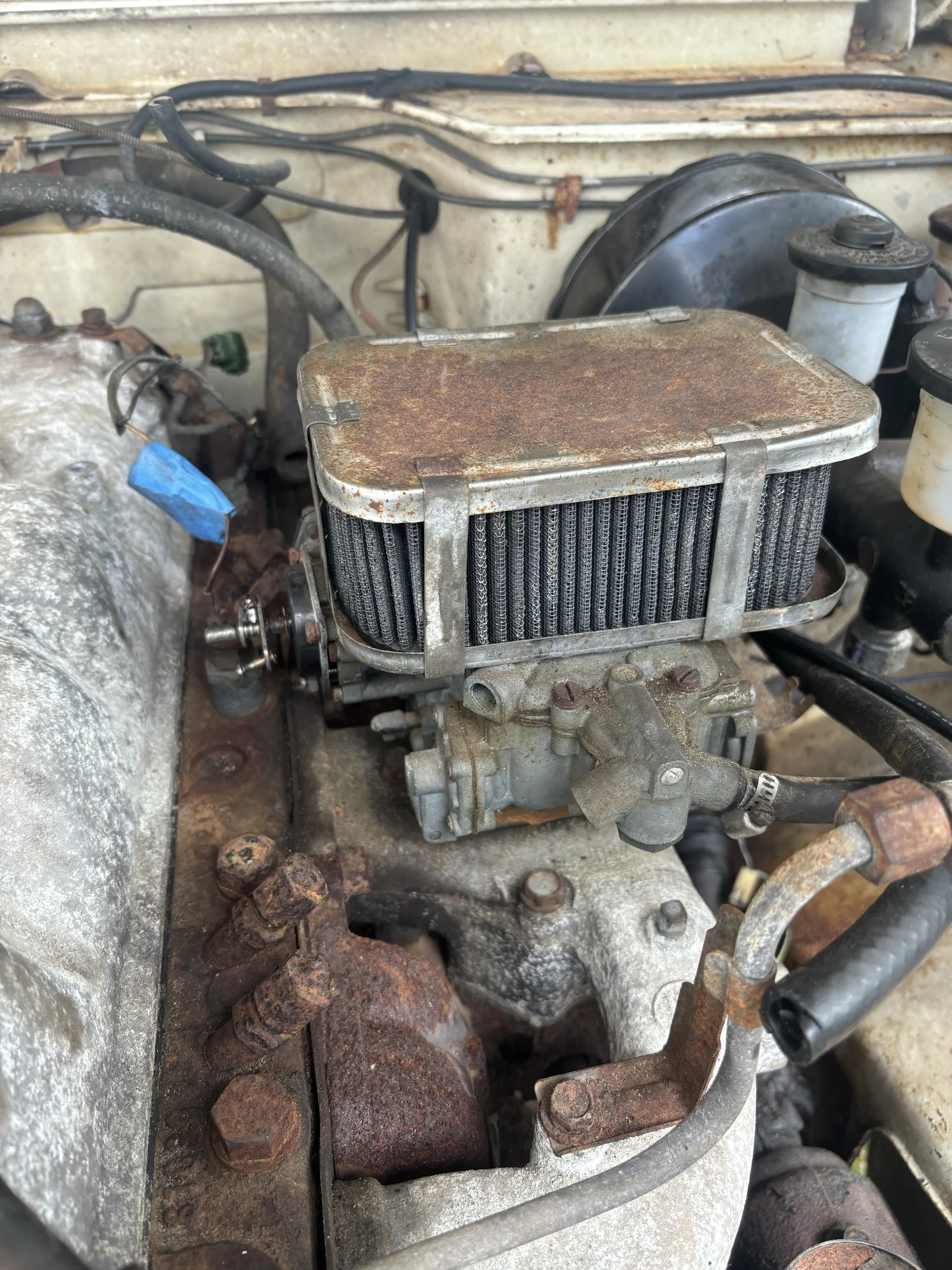

I Think I want to eventually do a holley sniper conversion after I get the kinks worked out. the 2f does not have the original carb any more either. it has a weber 38 that I think I will just rebuild. I was talking with Jonathan and as much as I like the aisin carb those webers are pretty simple carbs and easy to tune. and for me I have never had any issues on any of the 4 other vehicles I have had them on. Plus I know with the 2f air cleaner it has hood clearance issues on the earlier style hood and I know the weber air cleaner clears the hood. because of this I will probably keep it until I Holey efi swap it.

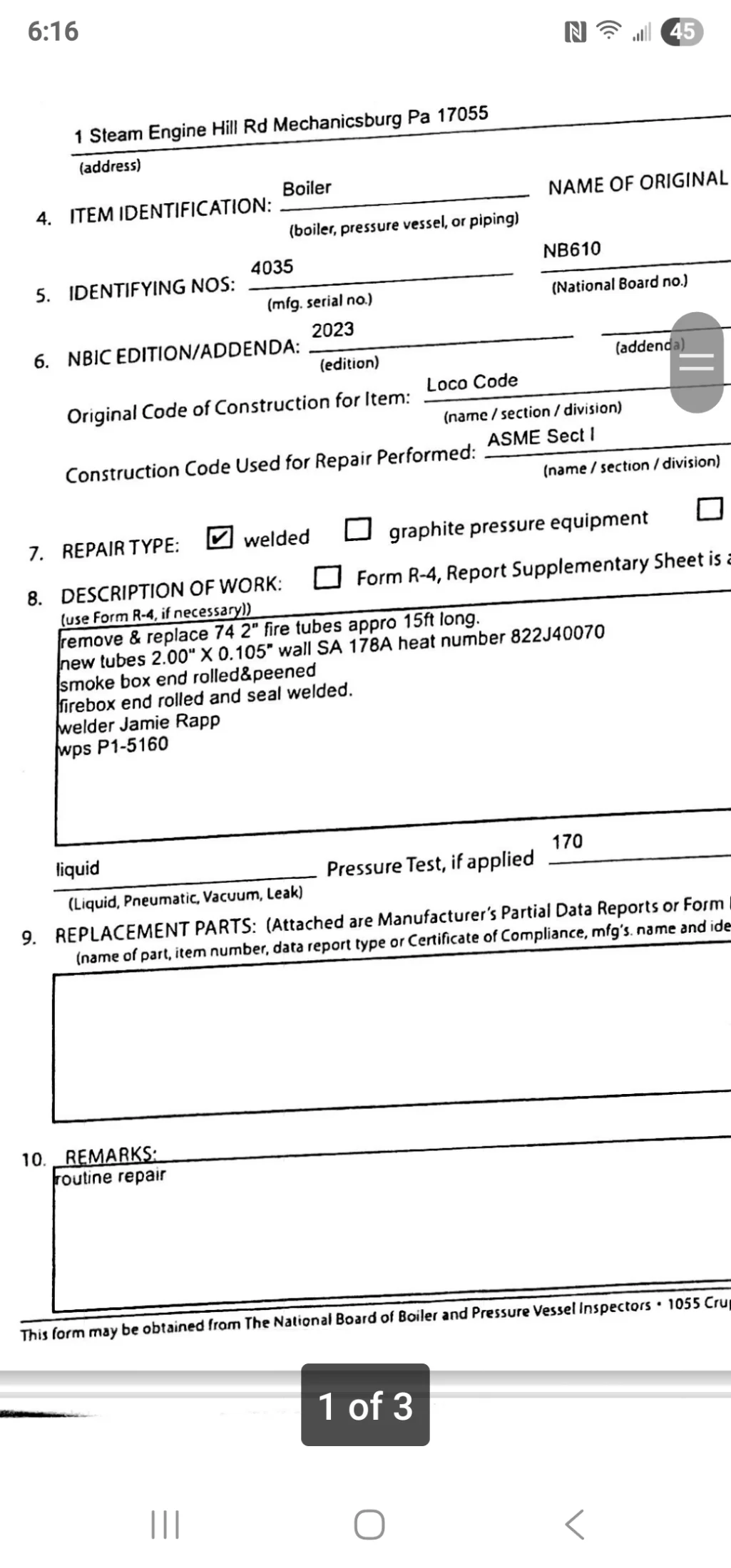

Compressed air stores energy - that's why they use water pressure to test boilers not air pressure.

Compressed air stores energy - that's why they use water pressure to test boilers not air prpressure.
But mainly because the water and infrastructure to handle it is already in place 99% of the time. And it is easier and quicker to detect any leaks.

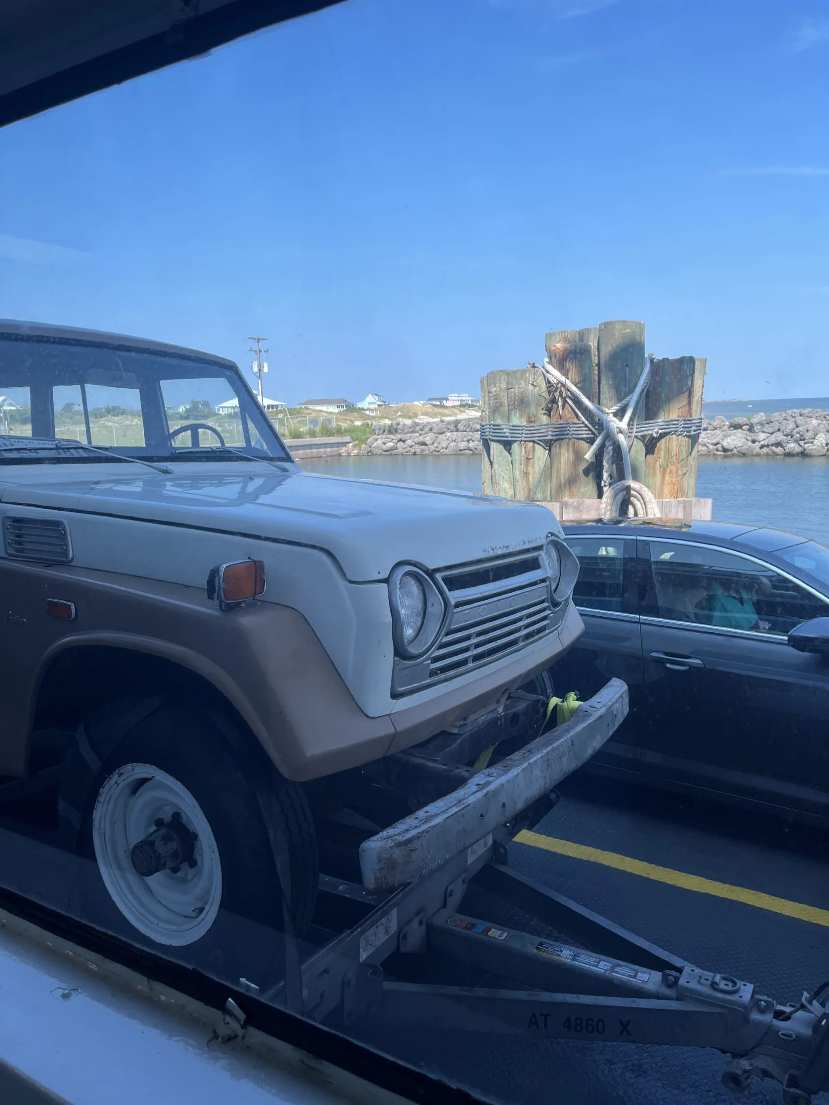

Early this morning waiting on that 7:30 to cedar island NC. One last adventure with the saltwagon fj40!
They put me at the front witch was really nice. Easier to get off the ferry.

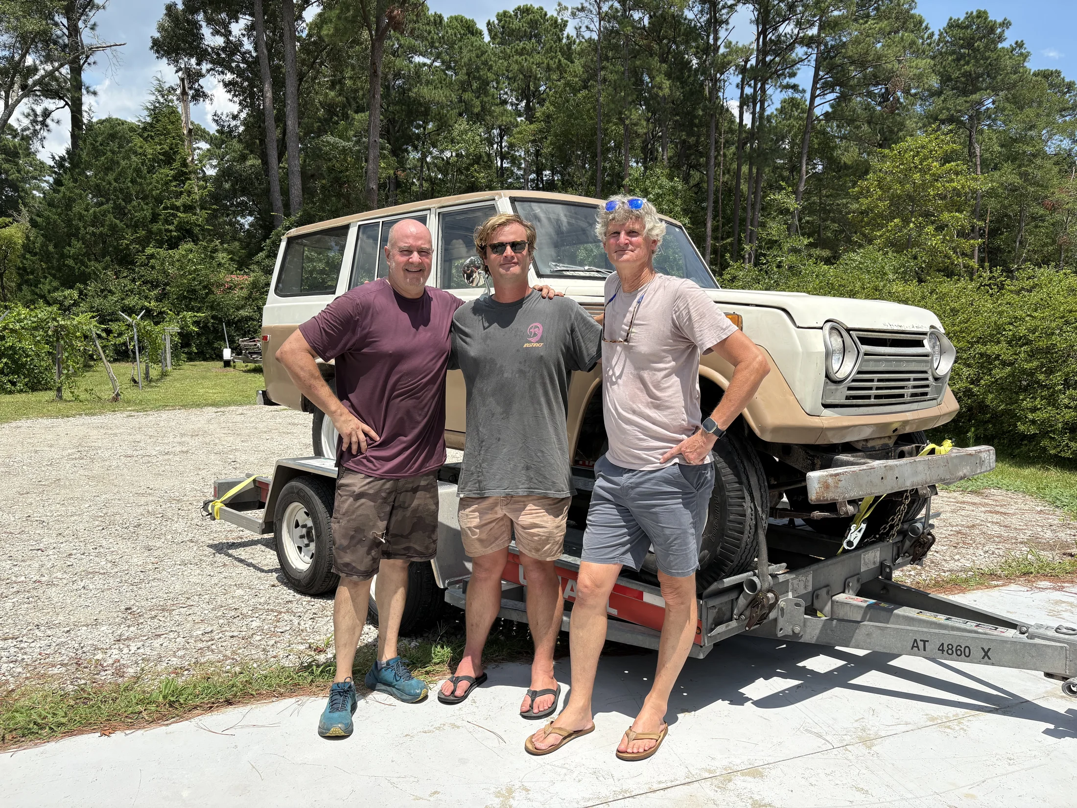

Mission success! I have acquired some salted pork! I was worried the uhal trailer was going to be too short but it was fine! with a hair to spare. I am so excited to get this thing home under the carport and cranking on it. My first Major goals are to hear it running. get the driveshafts back in, and the last major goal that will take 99 percent of the time on this build is to weld in front floor panels and supports, and the rockers. much like @roadstr6 did on his 1971 fj55. Bucky is certainly the inspiration for my build! I have rocker panels though that I think I am going to use. although the 2x4 looks fantastic and would go in that direction if Mark didn't give me the patch panels.
Much Like when I picked up the salt wagon, My dad went along and helped! he is not as much of a fanatical car guy as I am but I know he enjoys helping me out and the adventure. One of the things I never liked about the salt wagon is my dad and I picked the fj40 up right after my uncle passed (my fathers brother) and we cleared out some of his stuff on the same trip. That never sat right with me but I think It was a major distraction for my father in a good way. This trip however had nothing sad about it. All fun!
Side note: somebody asked about the split rims: they actually did come off my fj40! so kinda weird there. but they are not original to the fj55
we used a very cool 5 speed diesel 80 series to get the fj55 up on the trailer!​
Kathryn is one of the nicest people I know! She is awesome!​

Its been a busy day! I went this morning to buxton to drop off my uhaul trailer. I left my house at 6am and got back home at 10:00ish am. I then dicided I would start messing with some stuff. I had already purchased plugs and wires and a water pump. I got denso plugs and NKG wires. the water pump was a cheeper gates from rock auto. Its a 1f pump. I purchased it to clear the radiator. So I started installing that stuff. With the old plugs out I also made sure the motor would spin all the way over. I had heard it run from a video. but I knew that video was a little while ago. Motor seems fine in terms of turning over.
tomorow after work I really got to get my isuzu pup head back on. but after that I am going to try and figure out the coil, dizzy, starter wiring. Maybe start bolting up the alternator too. Ill probibly have questions as the coil wiring colors seem to be different colors than the fj40.
witch brings me to my first question for you guys. what belt do I need if I want to run my alternator on the passenger side like the 1f engines? I am Just running alternator water pump and crank. Ill take more pictures when I get home. I don't think I have the correct alternator pully for the thicker belt I have.
The next issue that I know I am going to have with the 2f over the f: the weber 38 carb is set up for mechanical linkage and this fj55 is set up for a cable. I Purchased a cable linkage kit for the carb that I think will work with the least amount of modifying. I know I am proibly going to rebuild this weber. It needs cleaning up for sure.
