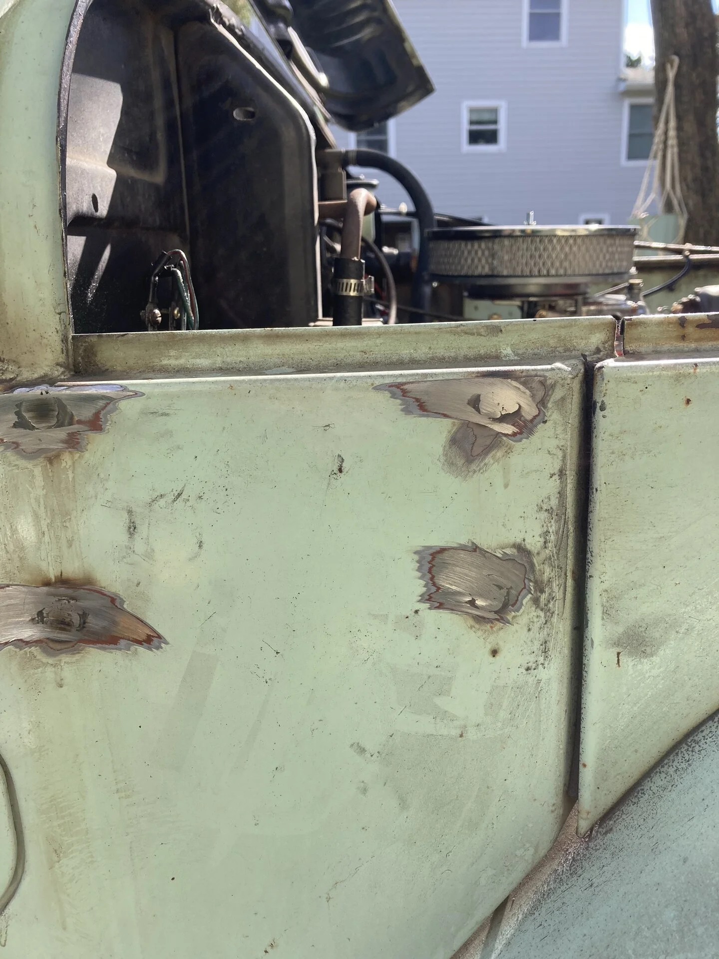

Plugged up some holes on both sides of the cruiser that I am guessing were fuel cans mounted there. did some practice for my rear sill and welded them up. I am about to sand and prime. I should have some spring green paint coming. These holes have been bugging me for a while. Next is to plug up where an antenna was on the passengerside. I need to make some patches for that I think though. The holes are pretty big.

Looks like you are using a grinding wheel. If so you may want to try some type of flapper/sanding disk instead.
Also, nice work and great looking 40!

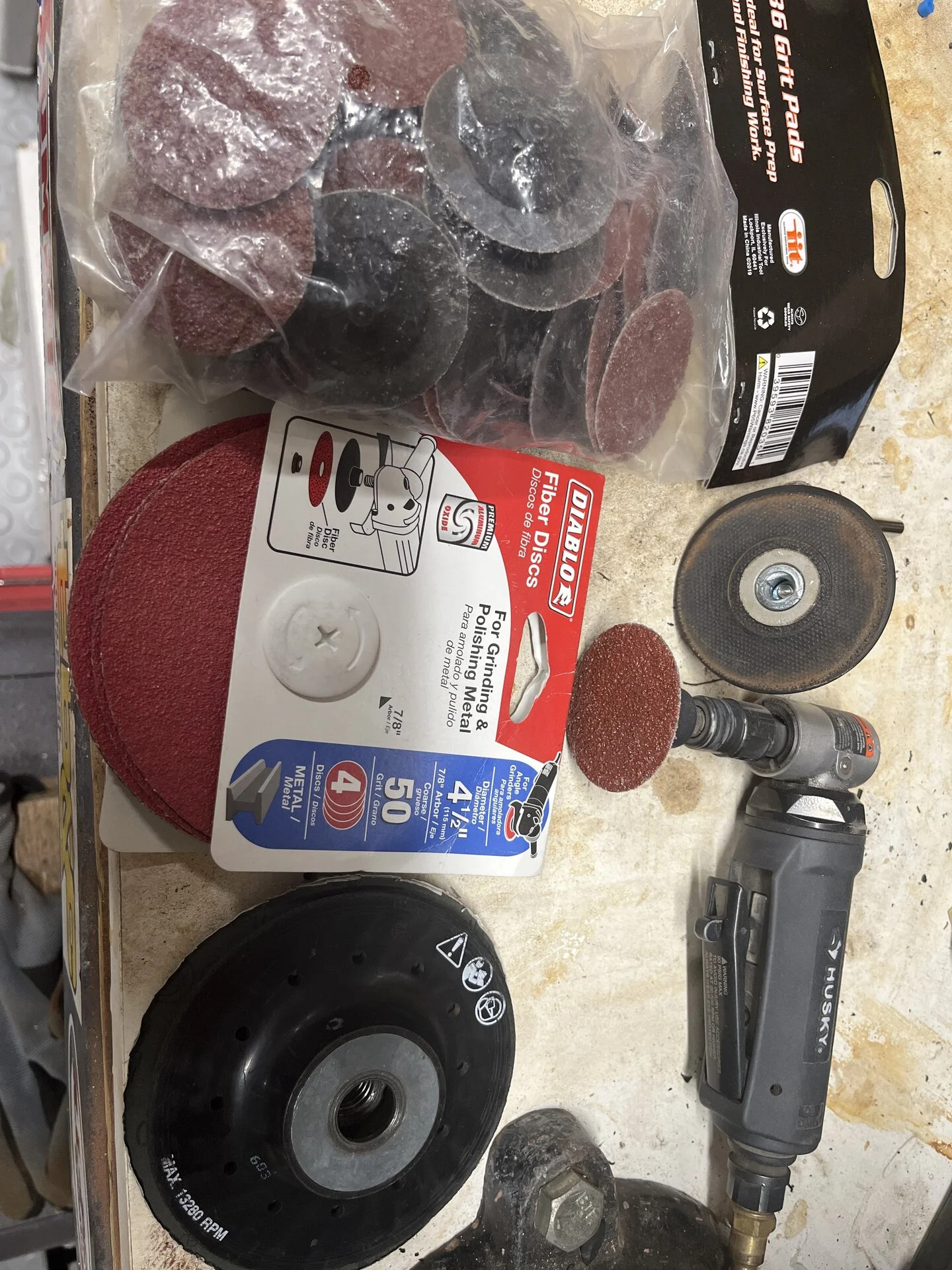

I am using the same set up in the picture actually. I think 40 grit instead. Yeah I suck with a disc sander though. I did order some flappy ones though. They should be here soon. I will say it looks like it gouged it pretty bad in the picture but I promise its smoother and flatter than it looks. Not the best work but I can do better. a di grinder sander would be nice. I need to get one of those. Do they make those in electric? My compressor is really too small to run air tools. anyways thanks!
Not sure if they make an electric die grinder. Definitely helps to have the small pads for inside corners. I have some of the 36 grit too, they are pretty aggressive.

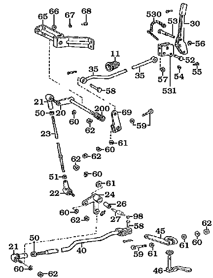

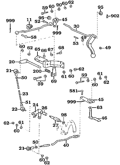

I need some of the linkage for sure. (images taken from SOR website) The 1969 linkage that I need looks to be the same as 1964. if sombody could confirm let me know. I know I will need the first arm that comes off of the transfer case. It is 40 on this. I am guessing I will need 45 and maybe 46 as well.
1969 :
1964:

yeah that goes under the truck to the tc - pretty sure i have that will check
my set up looked like the right side image - your probaby the left but parts may be adaptable - need to check with the early 40 gurus over in the 25 section maybe
most people dont know about this corner of the forum for early stuff like yours
I have 24 and everything back to the dash on those charts but everything from 24 all the way to the transfercase is missing. Thank you! you are awesome.

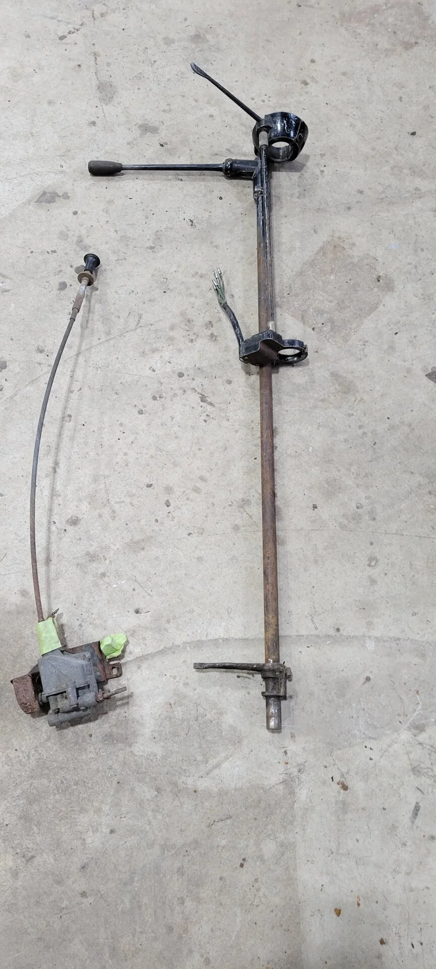

so looking at your earlier pics - someone added the floor mount shifter....you have a dash and a floor shifter - so they disconnected the dash linkage right? have you checked the 4wd operation to make sure it works? those vac systems (to ME) are more complicated than just a straight to tc shifter .. a rube goldberg set of linkages - again, check with the early guys on the 25 side but MAYBE someone converted it because it was problematic - i.e you might go thru a lot of trouble to realize the floor shift works better.

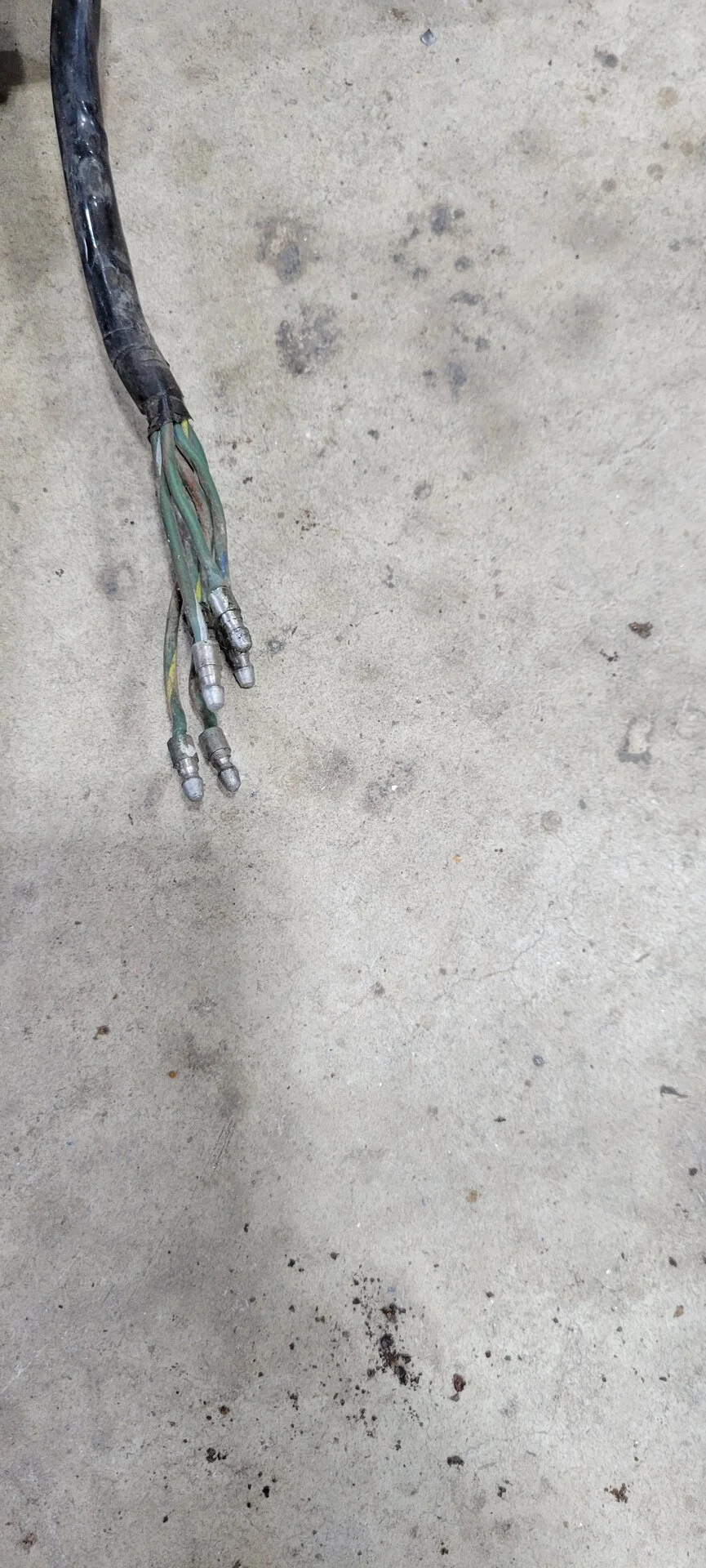

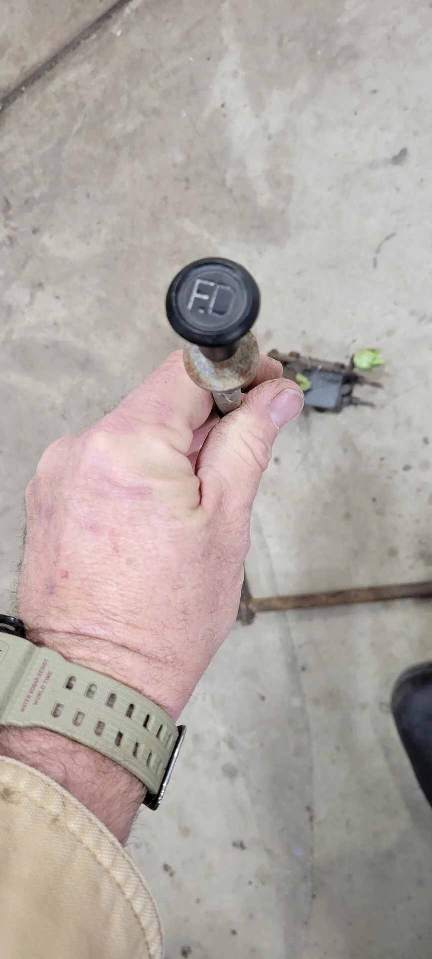

yeah the floor shifter 4x4 works. I have 90% of the parts to put back the dash mounted shifter to working order and take out the floor one. Just missing the one peice of the linkage and a few other parts I am hoping to find. I just bought a vacuum actuator for the transfercase because I actually want to make the old vacuum 4x4 work and take out the floor shifter. I know its alot of work but I want to make it as original as I can. And if it wont work I can put it back to the floor shifting operation as I have all the parts. Most people probably think I am crazy to put it back to the vacuum actuated 4x4 but In my opinion its the most unique in the land cruisers.

Yeah would love my 1964 to go back to mostly original in the interior. If I have to keep the floor shifter I will but I think I can make the 4x4 on the dash work again and clean floor. Plus its easier to reach to the dash to actuate the 4x4 than the floor. I actually use 4x4 alot out here. almost every day.

I dont! I love the original dash lever and FD knob and a clean flat transmission hump!
Thanks! I am excited to make it work again. The transfercase vacuum actuator should show up today! I need to purchase some other parts still though. I am thinking I will get to this on a non busy weekend. plus I really cant wait to see that little green light work.
