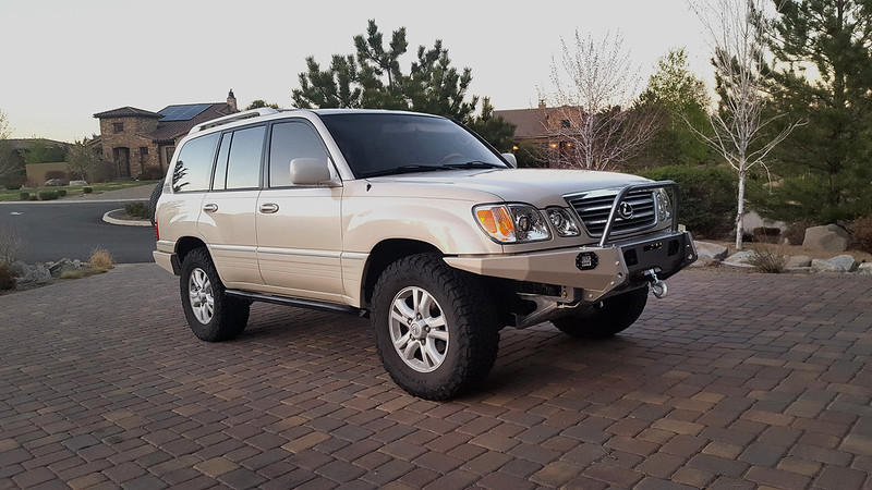

While not quite Rubicon ready...this is currently where I am at.
