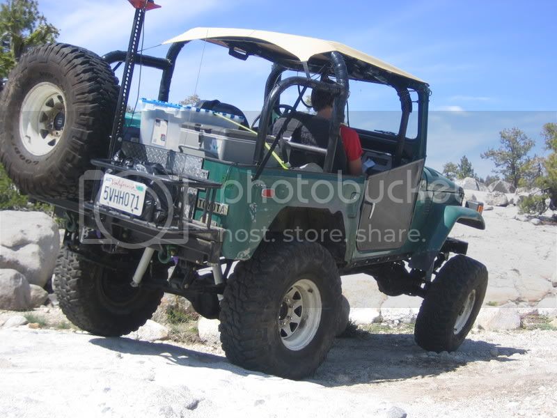

can you tell you have wider axles?
I've never driven a SOA on standard FJ40 axles, so no real basis for comparison. The stability issue was one that had me a bit worried, and honestly it was a non-problem. Even on the road it was stable. The real test was the slabs at Rubicon and I was glad to have every bit of available width. Plus I have relatively stiff springs, and I run my shocks almost as stiff as they will go.
