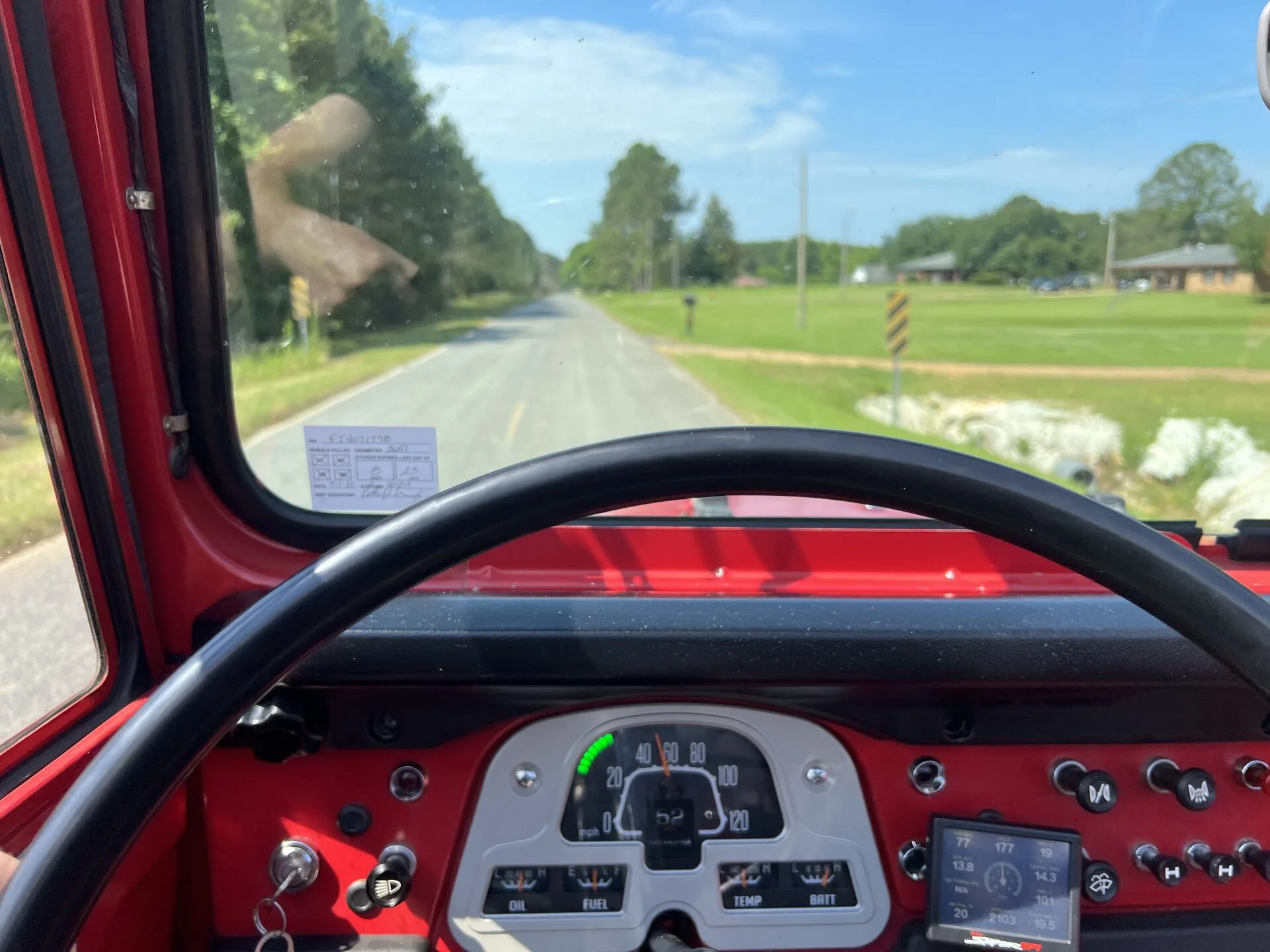

Got my final parts in and did one more clearance on the header and stuck it all back together and went for a nice long ride this am

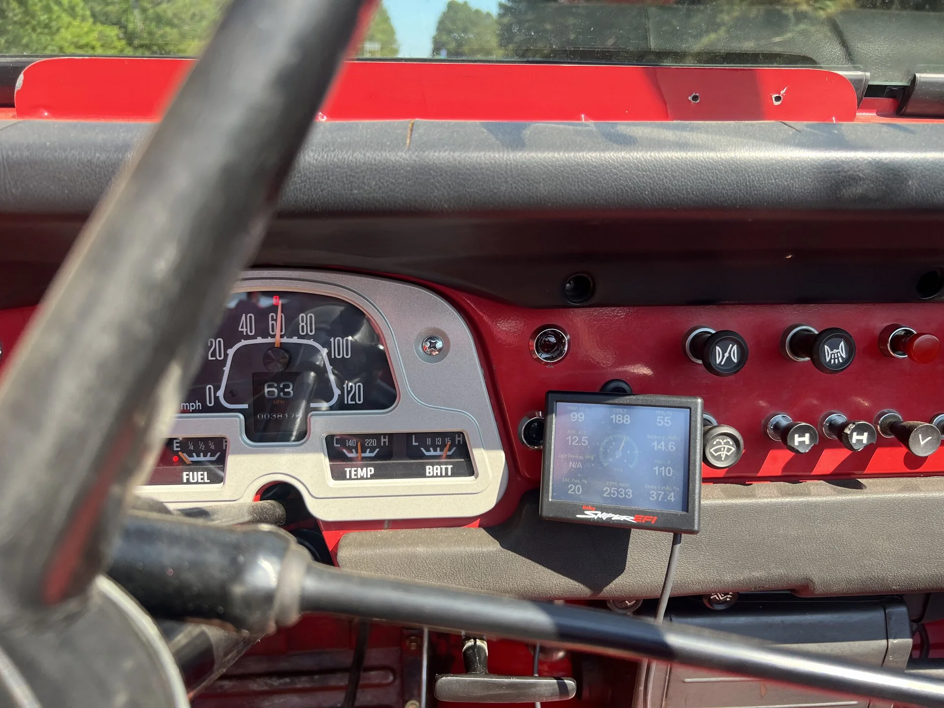

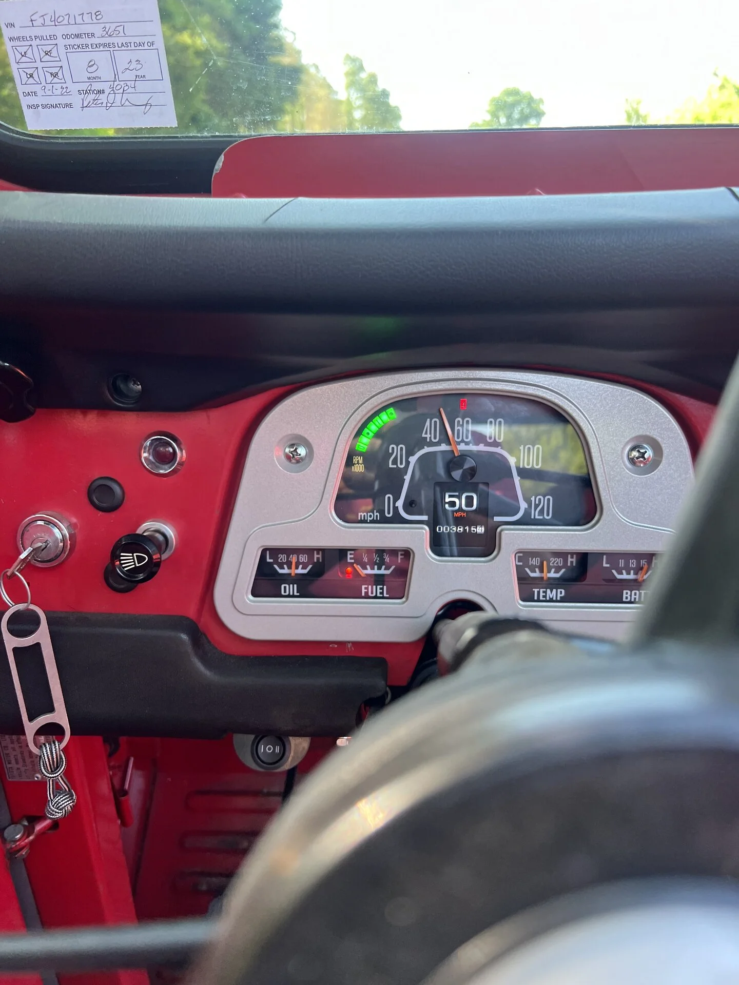

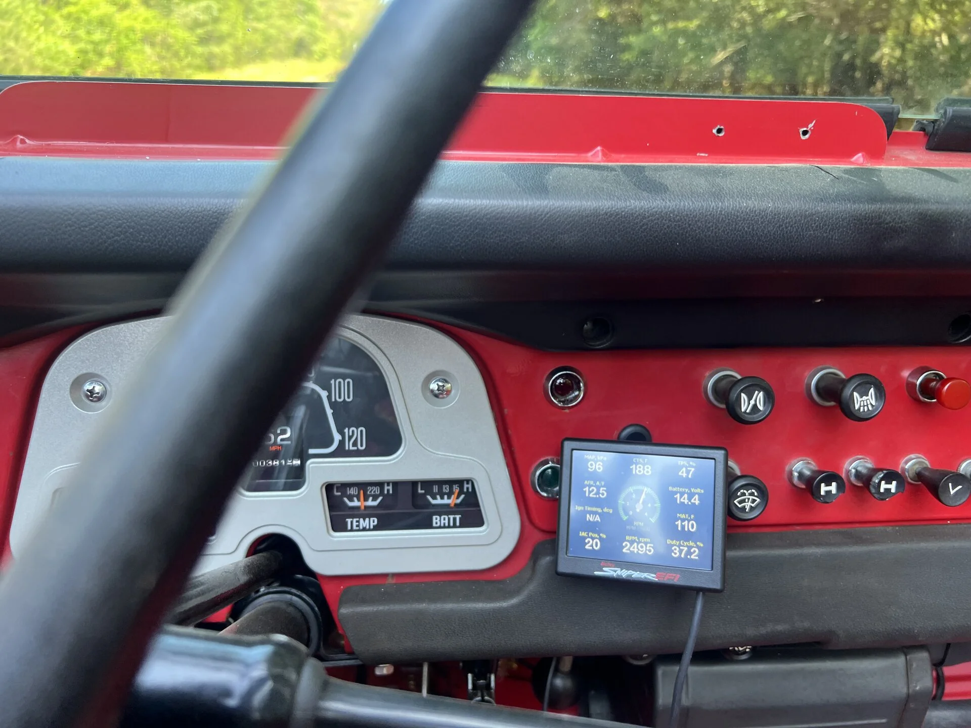

Had to program the speedo. The little brass tang that rides in the housing was spinning in the wire so I had to clamp on it a bit to make them talk.
I got back and started monkeying with the fuel gauge.
It was saying the fuel was open meaning no signal from the sending unit to the Dakota. I redid some grounding and it came to life.
I pull the sender out and did a manual cycle since none of the presets work with a Toyota sender on the Dakota.

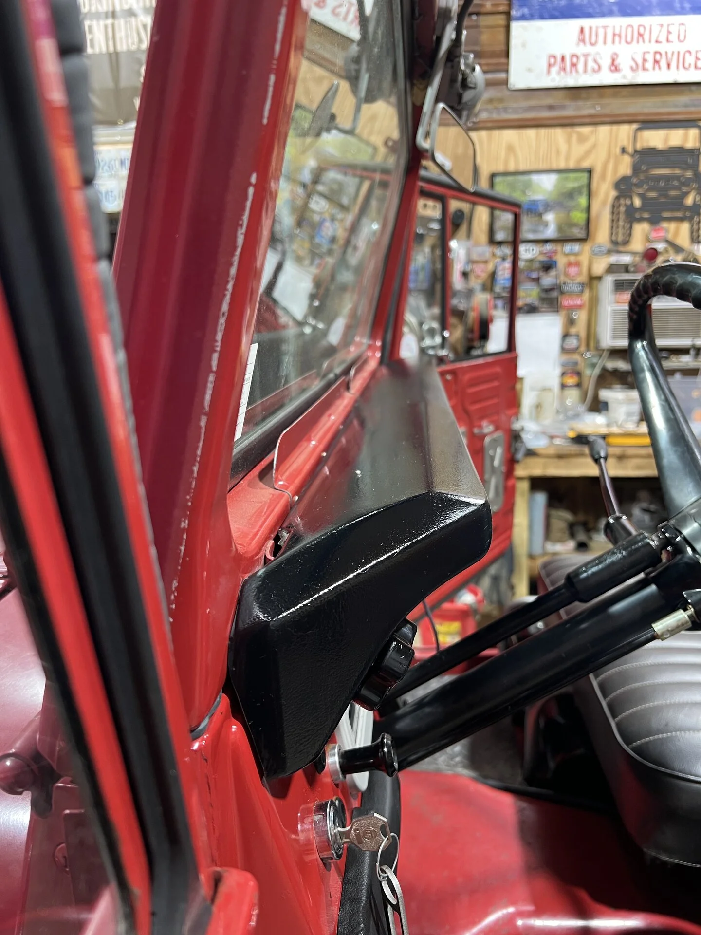

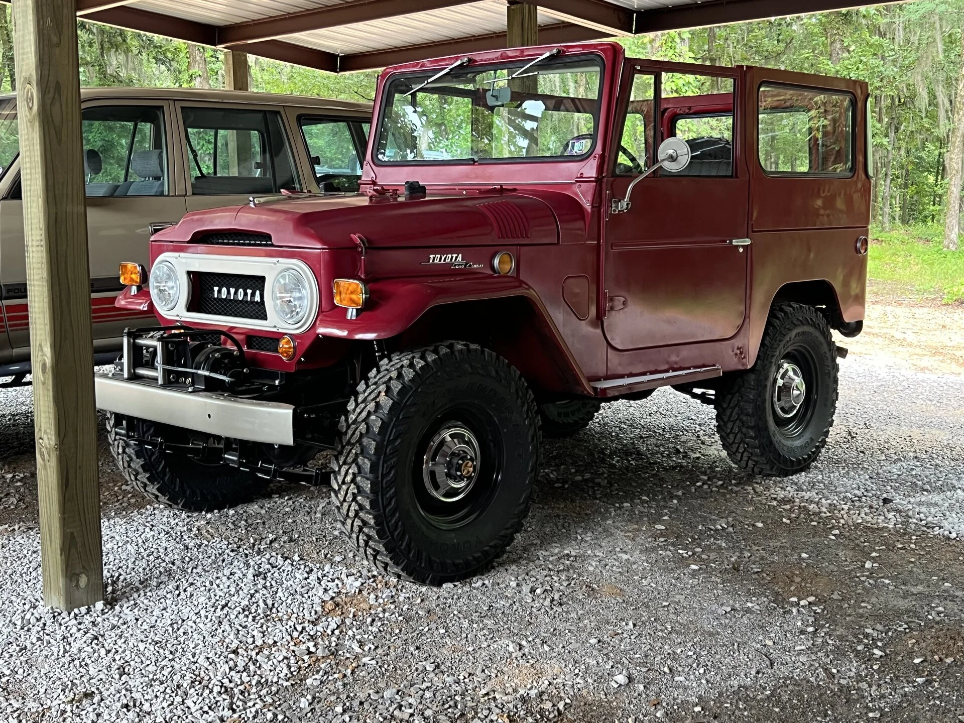

I think I finally bolted the last OEM part on this one from Brendan’s mighty stash with these sun visors
Just got back from another ride. Other than the turd 3 on the tree ….. 😆😆
I’ve never actually driven one that’s been rebuilt by the master or one new enough to not feel clapped out. It’s not as bad as I thought it was going to be
It’s part of the charm Nolan
Part of the charm
Looking real nice real nice 👍
Some people roll around in these trucks with a few .22lrs in the ash tray, a pack of pall mall non-filters, and a rack of yellow jackets bang shifting that 3 on the tree and standing on them drums just to think about when America wasn’t full of s***
I digress, again amazing outcome

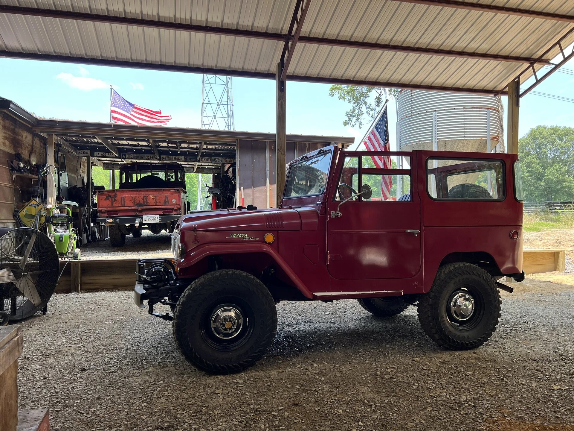

Feels like this one has been here a long time but I just went back and looked and it’s only been 2 full months.
I love projects that flow like this one has.
What's it like driving without the fiberglass top? Is it obnoxiously loud and turbulent inside the cab?

It's hard not to love those Dakota dashes; I just wish they had a real tach...
You can get one with a tach but it’s ugly as hell. The beauty of these is they look stock. I would not install the other kind.
I'm totally with you on that.
I actually like the one with an actual tach. Personal preference.
