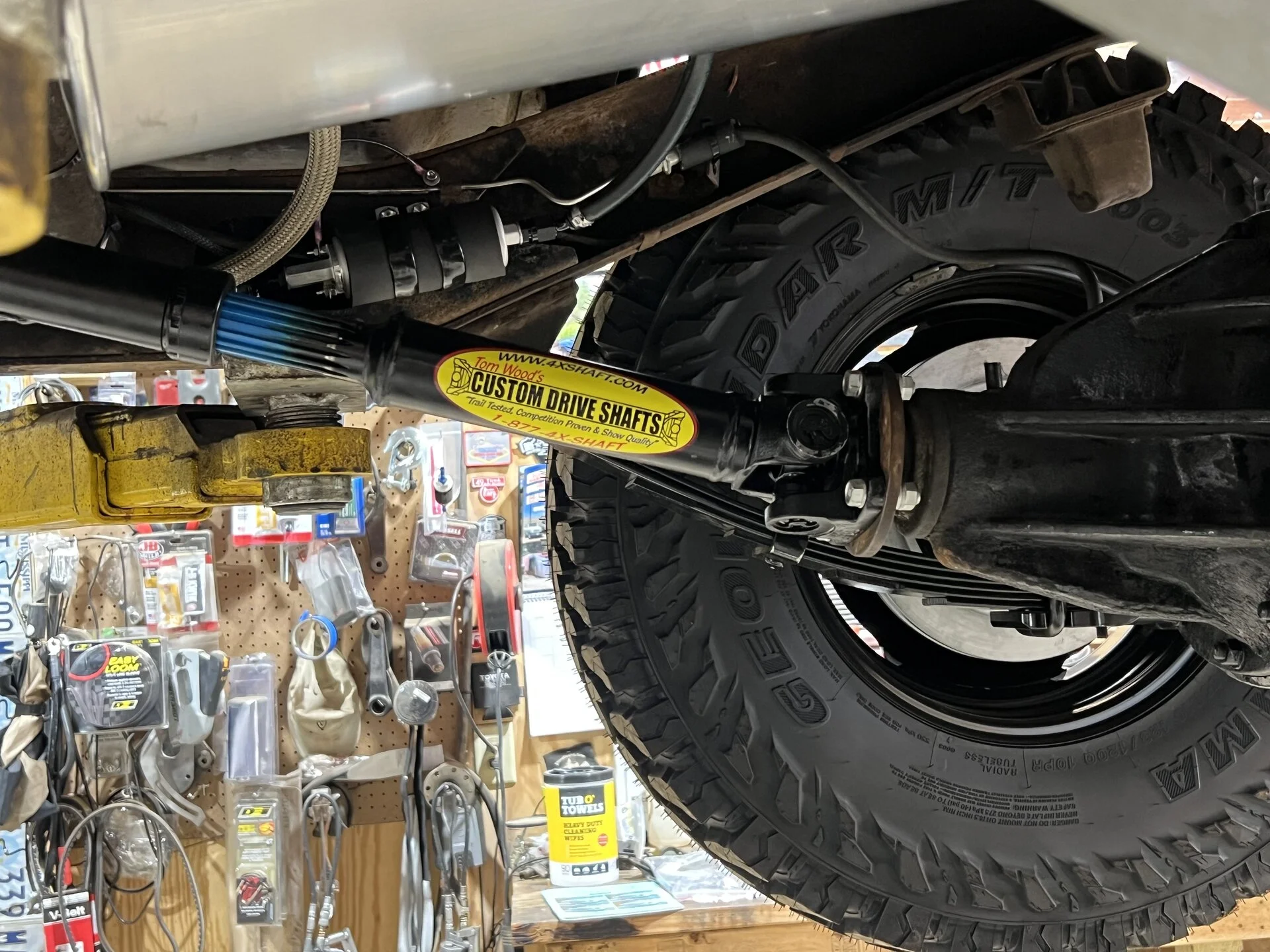

Got the driveshafts in. Gas in. Sniper primed up and went to crank it and I’ve got a runner but it’s ramping up the RPMs like crazy.
This signals a vacuum leak.
I broke out my smoke machine and it’s got a leak under the intake.
I’m gonna tear it apart and see what I can find.
Bummer. Was hoping to drive it today.
Oh well. I’ll figure it out.
