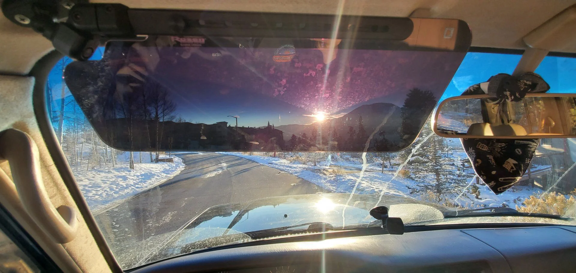

Mine are doing great. Awesome upgrade youncan drive right into the sun with glasses on.

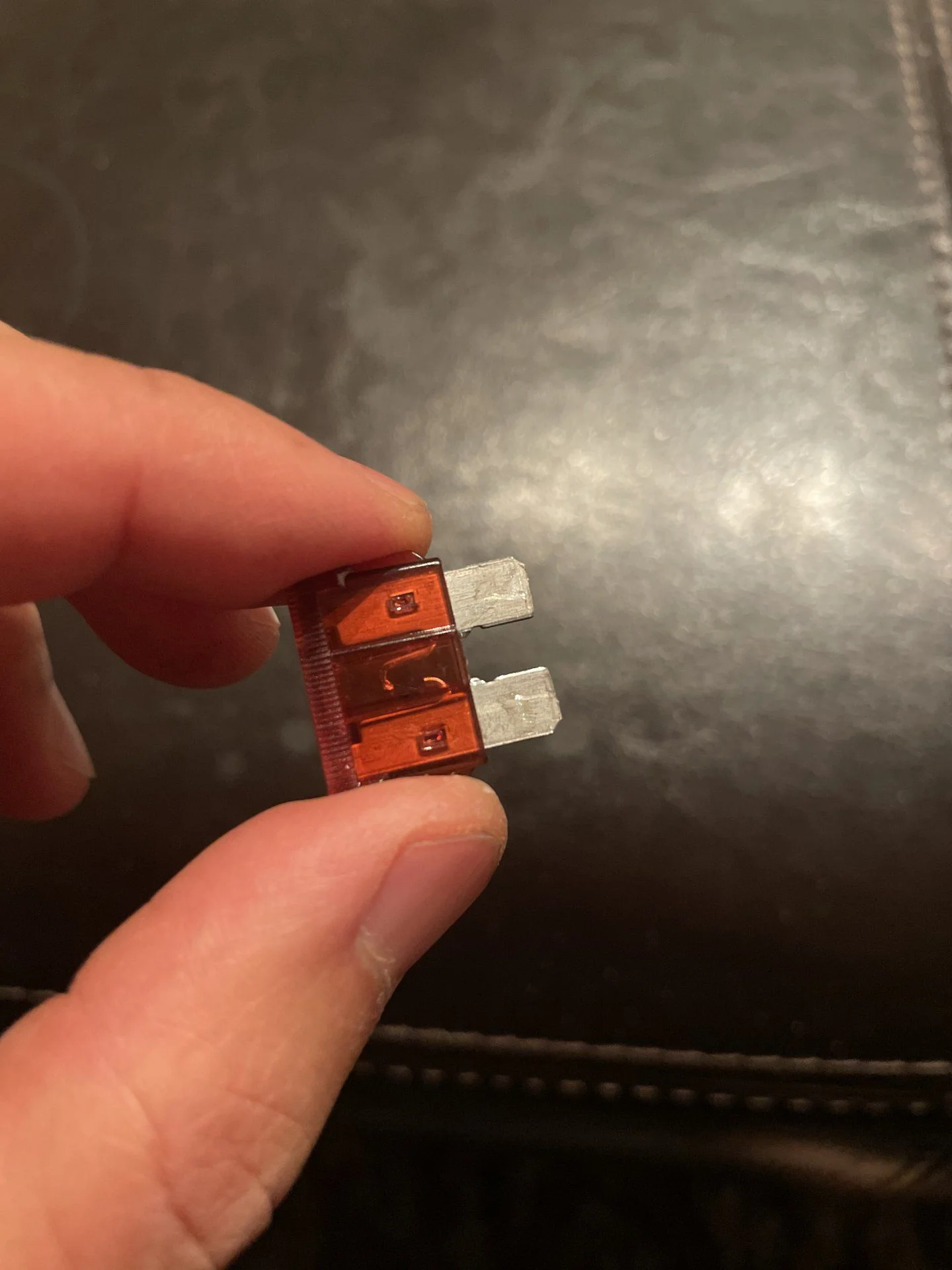

Any of you who installed these have issues with your rs3000? Not sure if related but my rs3000 unlock lock and led security light all don’t work. Dome lights and door puddle lights as well. Not sure if coincidence. Many thanks.
May have pinched a wire from the stock sunvisor courtesy light and blew a fuse. Check the fuse, then pull the visors to check the wires.
Bingo
It’s good to have 80 friends who can help this .0001 banana. @midfat @NorCalFJ100 ❤️ KBBQ 🥩🍖on me next go around.
Not sure what I did wrong, but turned out to be a blown fuse under the hood. Dome.
Wrapped the wires with electrical tape just in case. Visors are siq!

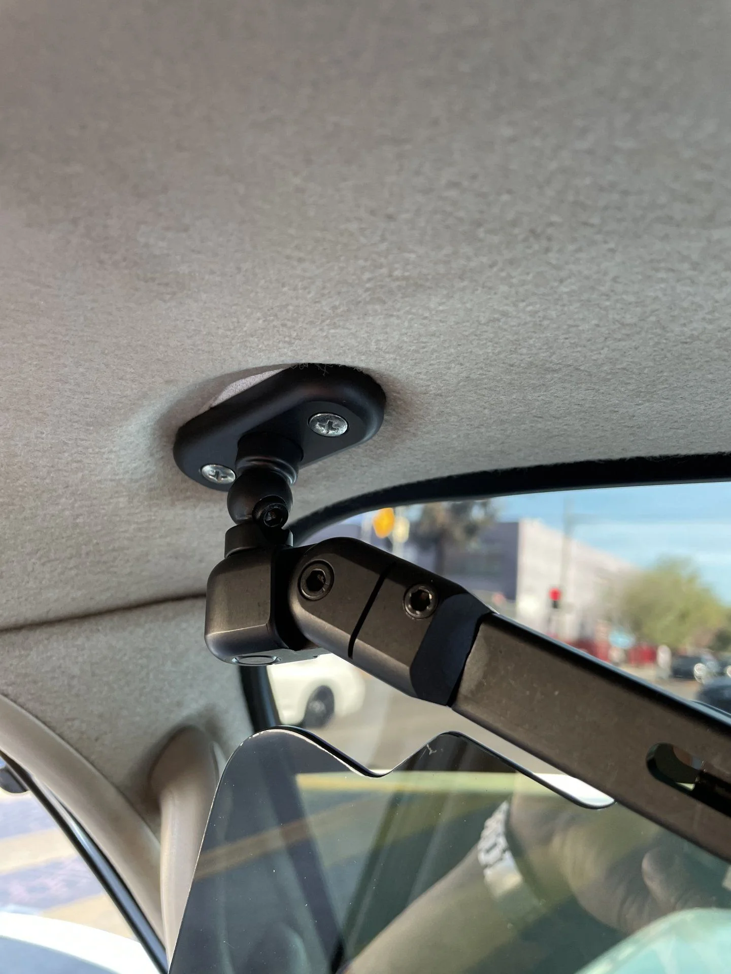

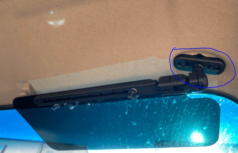

Okay... seriously thinking about picking up a set of these for my Troopy. I know @jmlockwood did his Troopy and 80. The OEM visors have that clip that provides extra support when they are "parked" toward the front so they aren't free-hanging from just the pivot point. The Rosen's don't do that. With the Rosen's free-hanging do they tend to vibrate/shake as you are driving? Is the pivot point along enough support for these?
Mine only vibrate a tiny bit when they are covering the side windows in the full extended position. When the Rosen visors are in their "stored" position like the OEM I have never noticed any movement.

I've had mine for a few months now mountain snow trip sun in the eyes, Wheeling, road trips with the family
The sun visors are Epic
