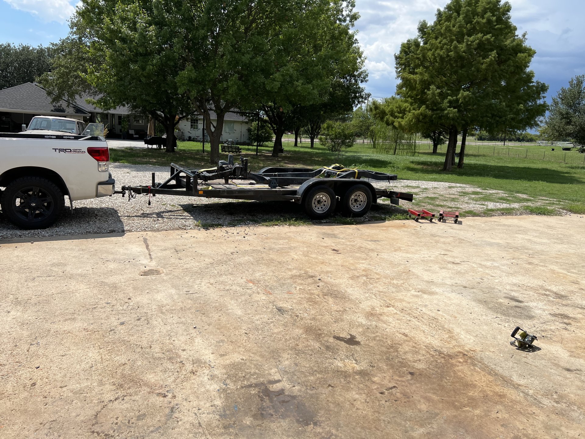

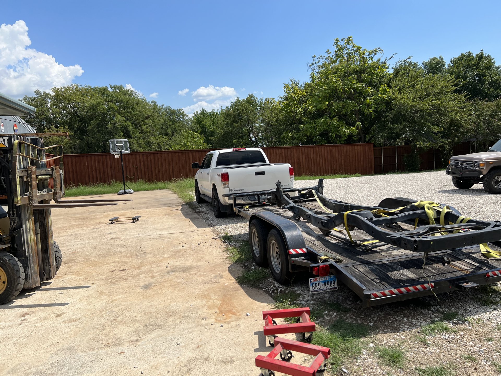

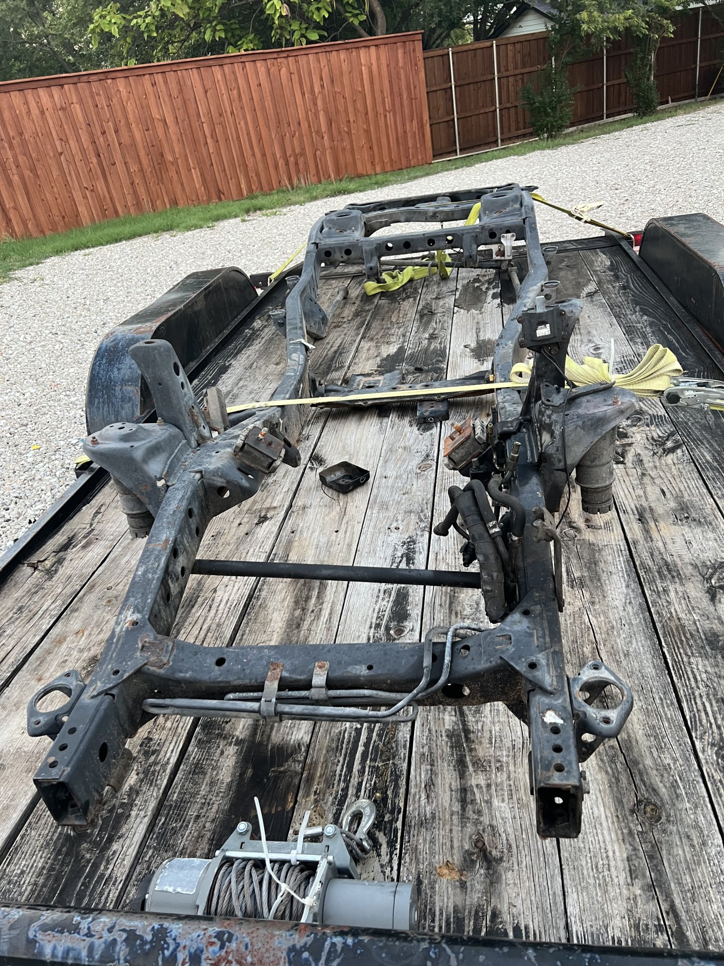

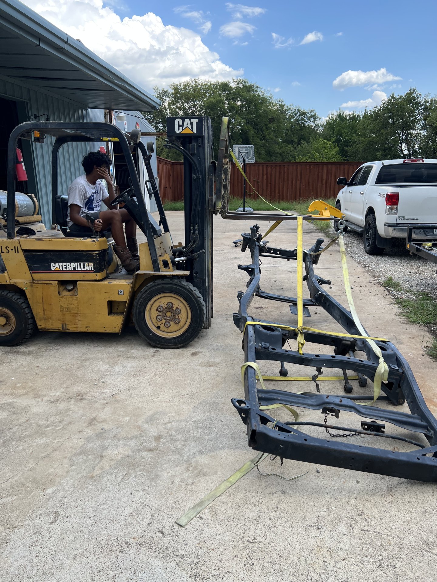

Its home. Work begins. Got to visit with @fl4031003 on lessons he learned. I met @TexFJ at SAS. Pinged to connect while in Austin. Turned out he was about ten minutes from pick location and helped get the frame on the trailer. Awesome we connected.

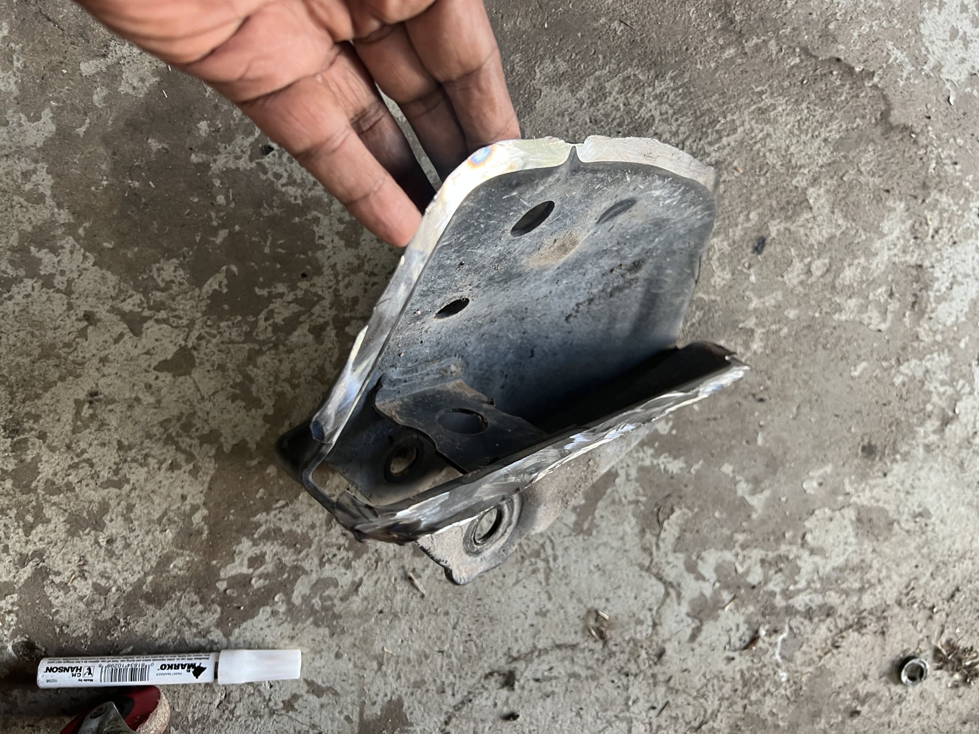

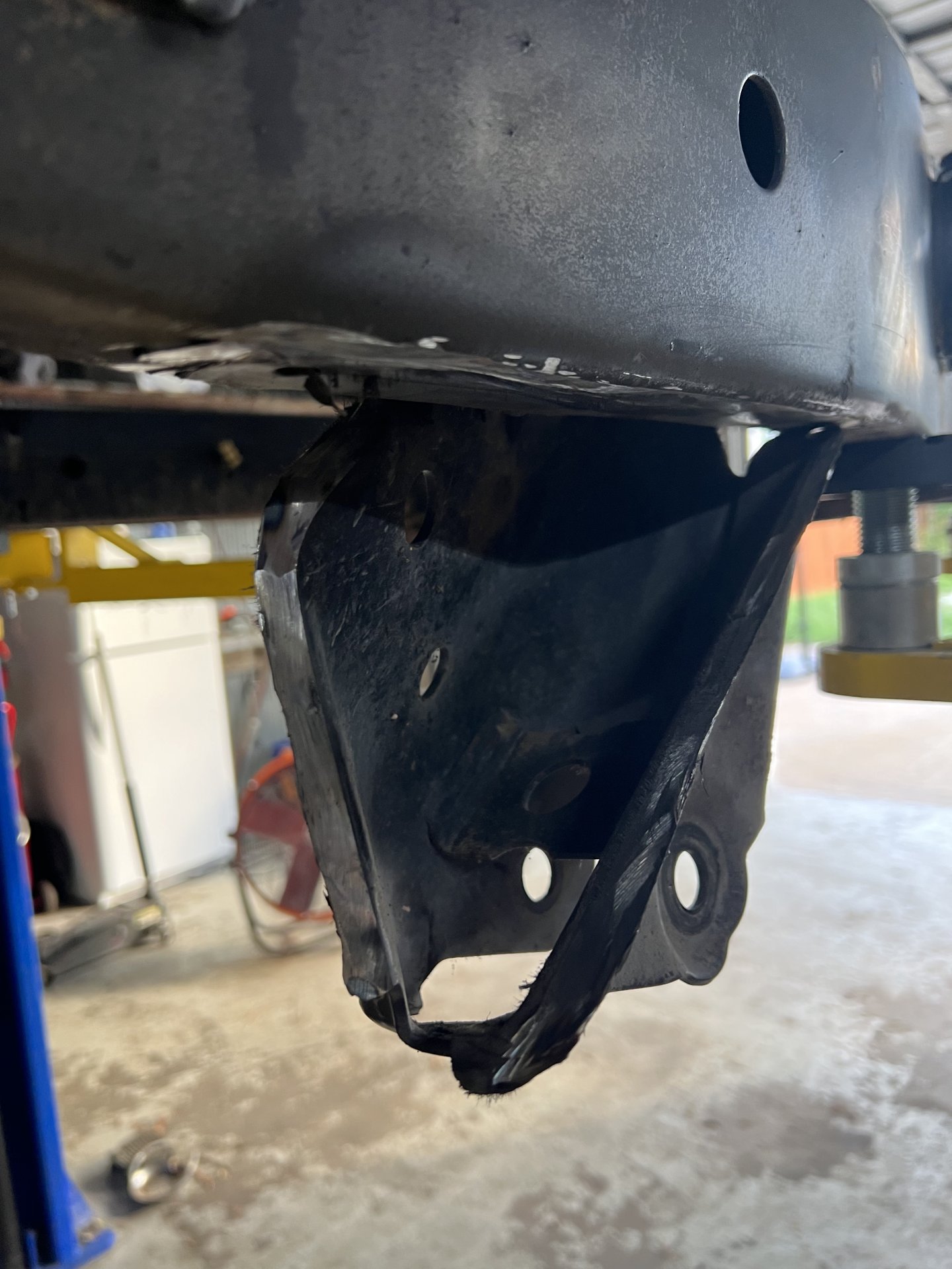

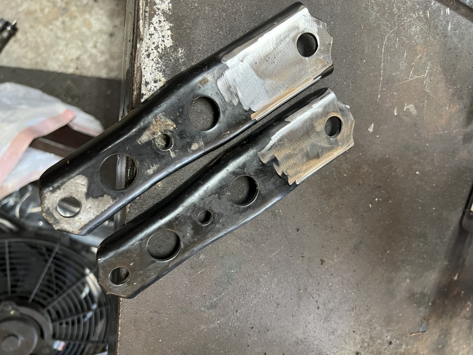

Collecting the bits. Would like to assemble the pile before I start. Get ahead faster that way. Frame swill be stripped of brackets this weekend and Prep it for a chop and tack.

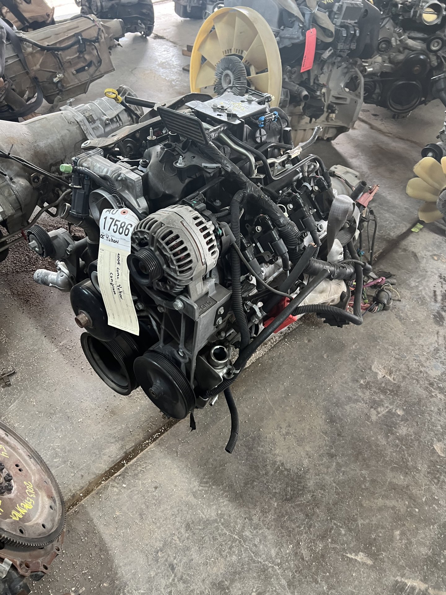

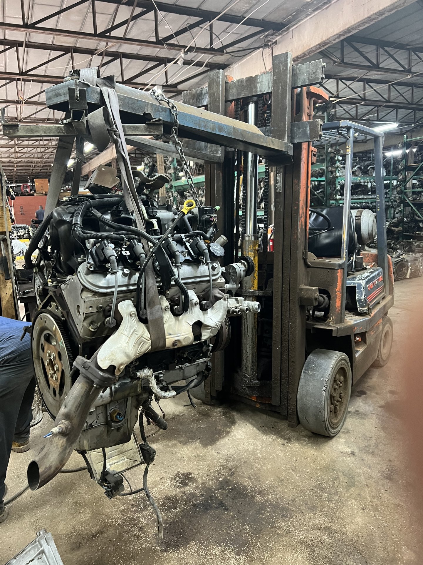

Big piece in. 2005 6.0L from a Yukon Denali. 120k miles. Clean.

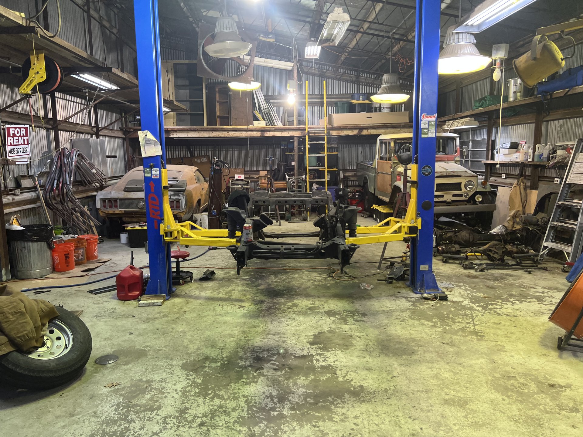

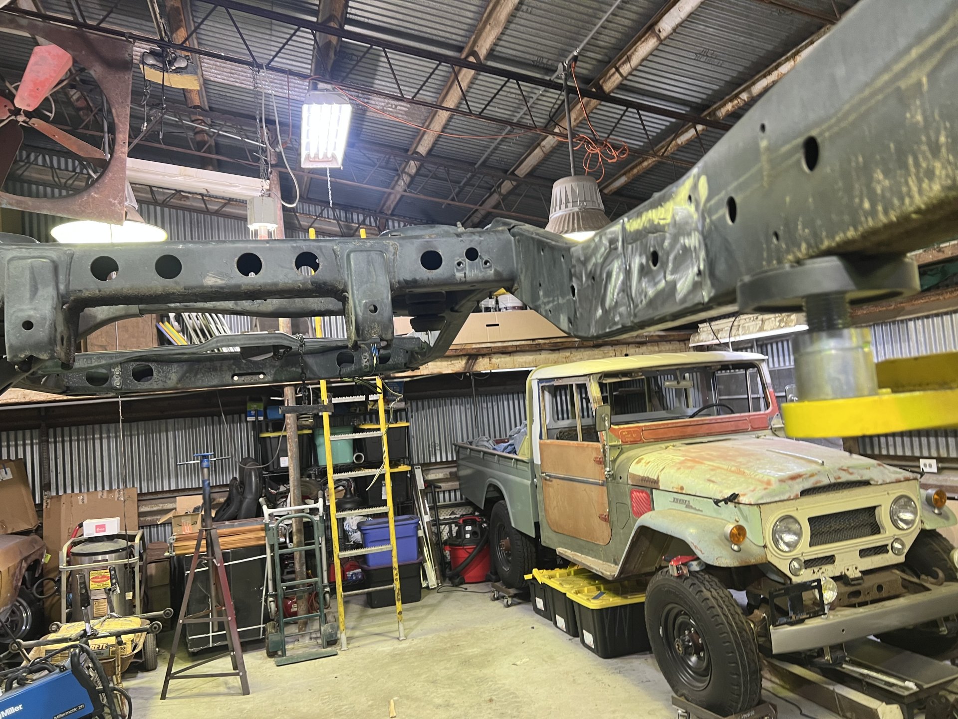

Offloaded for surgery this weekend. @Cowboy45 is a master at the wheel on R2D2. Had some pretty heavy storms just as we were done. Staying out till lightning stops.
Gen Z and their tools... we used our muscles to move frames, in the snow up hill, and we liked it.

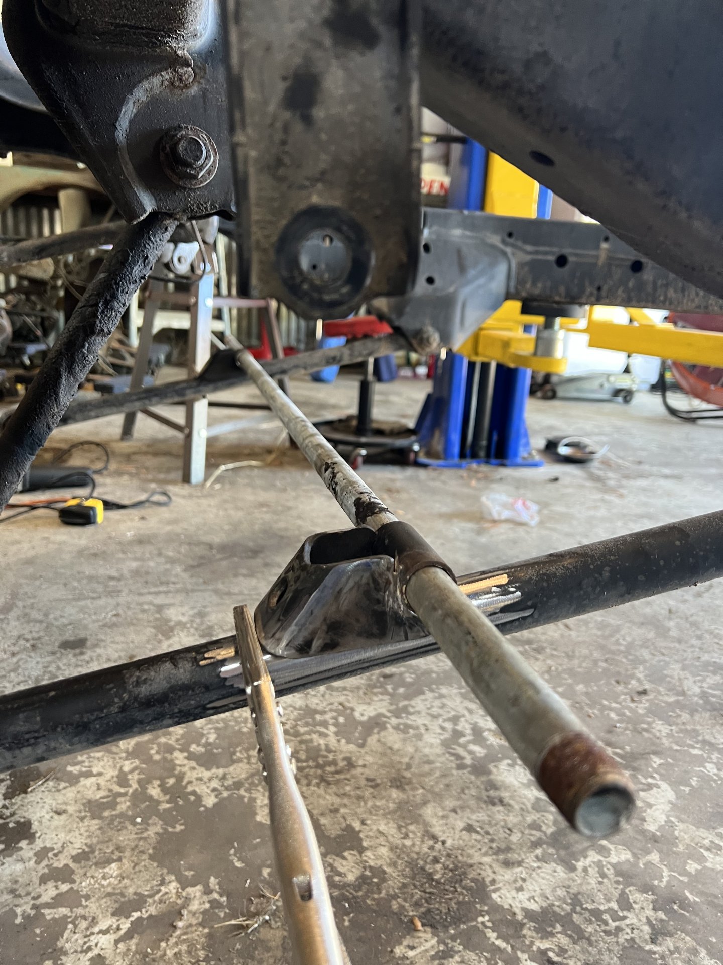

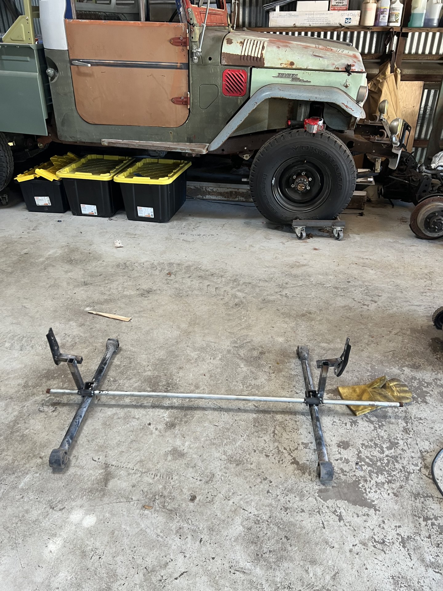

Had some hilux bumper brackets @SipLife did not use. Cobbled up a rear upper control arm spacing jig using sway bar bracket. Once the frame is shortened, there is no guess work in repositioning the upper control arm frame brackets. I can’t take credit for this. Ryan Reddy here on Mud did this with a similar set up. Now to chase down some iron to level the frame readying for a chop.

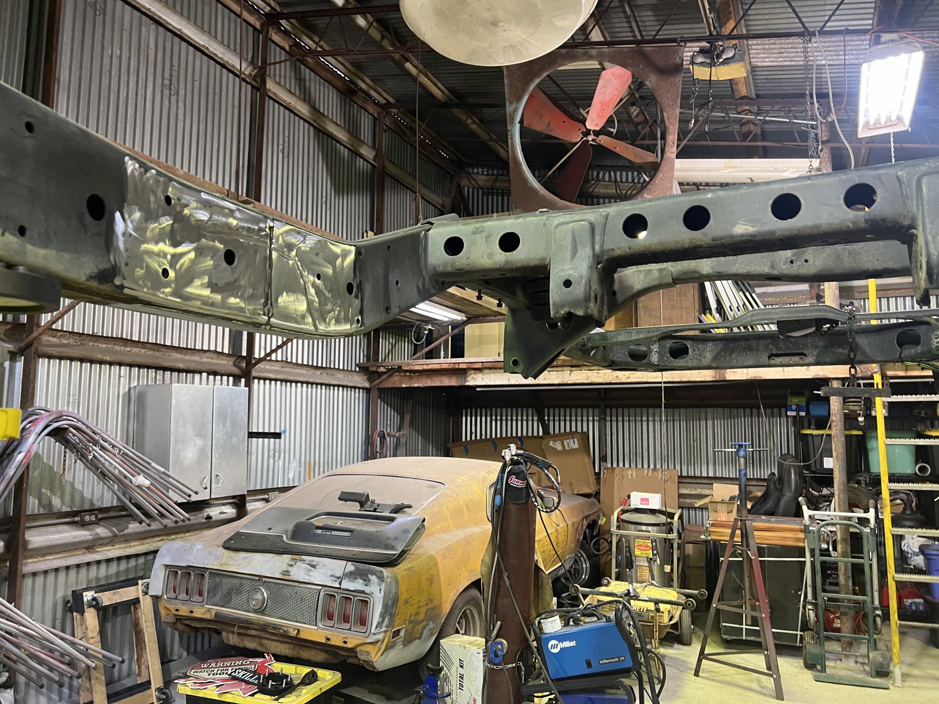

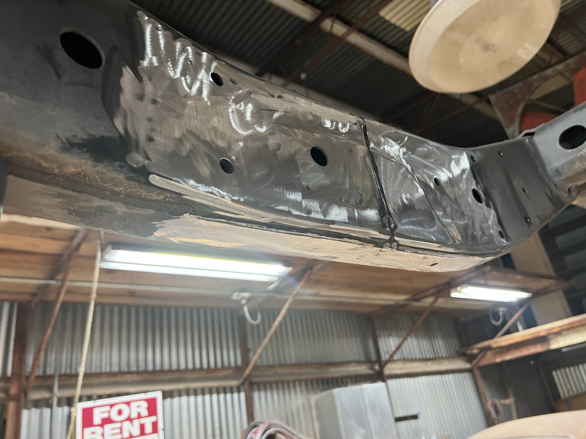

No going back. One down. One to go. Welds are beefy!
If this fails, it will make a nice beer holder
Done for the night! Whipped. Tomorrow measure 10x cut once.
