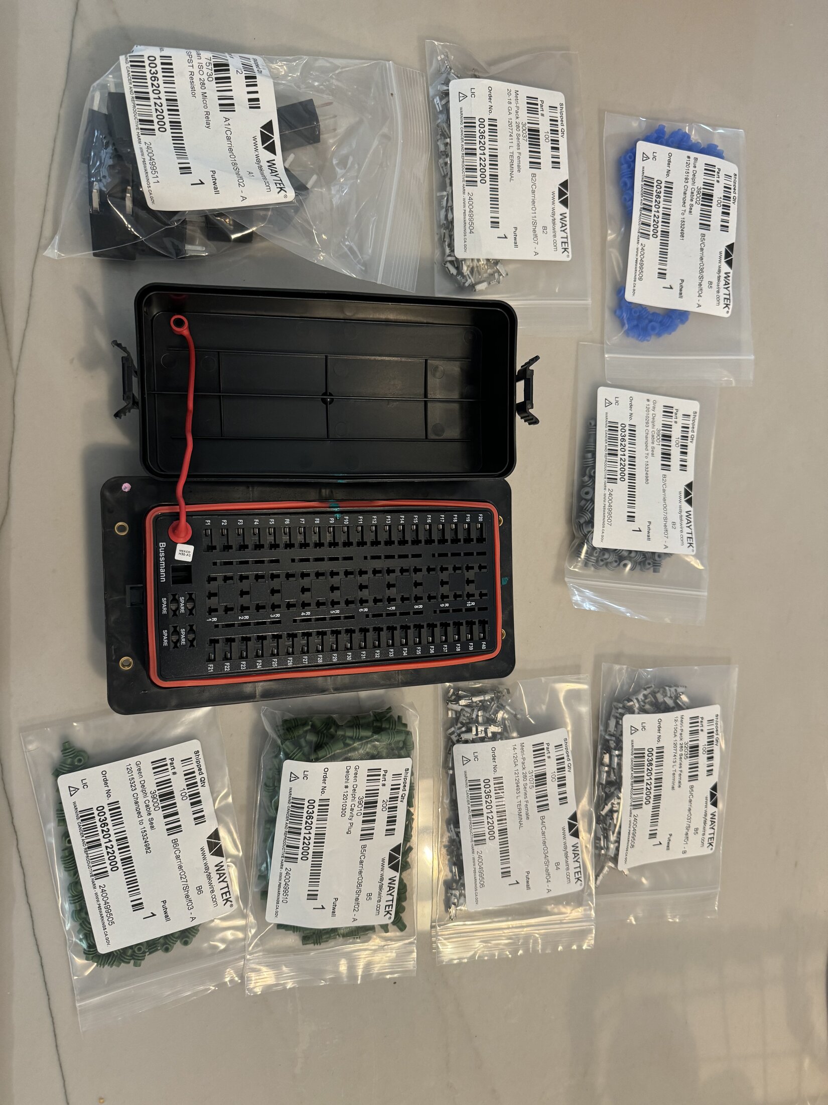

Fuse panel parts came in from Waytek!

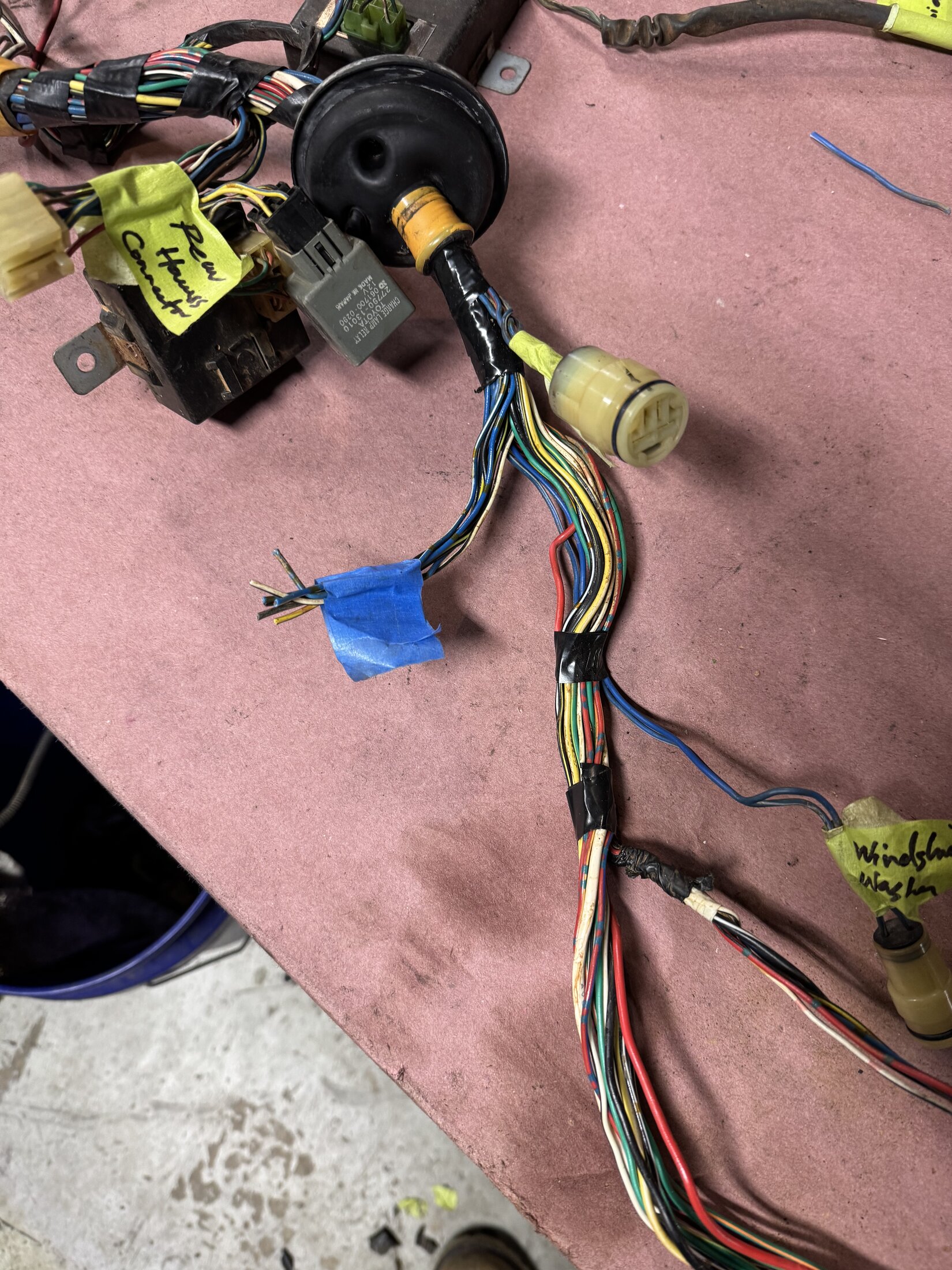

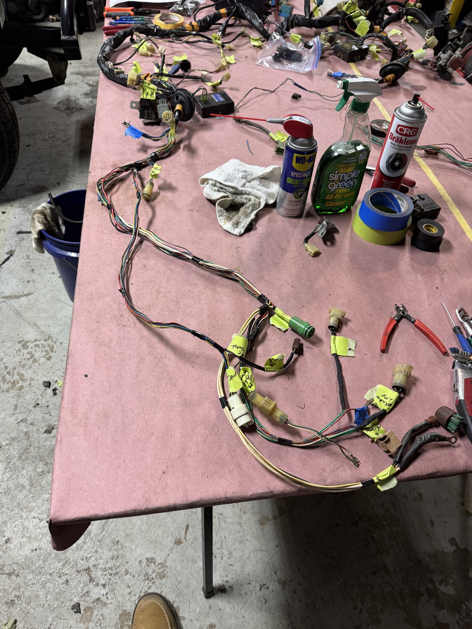

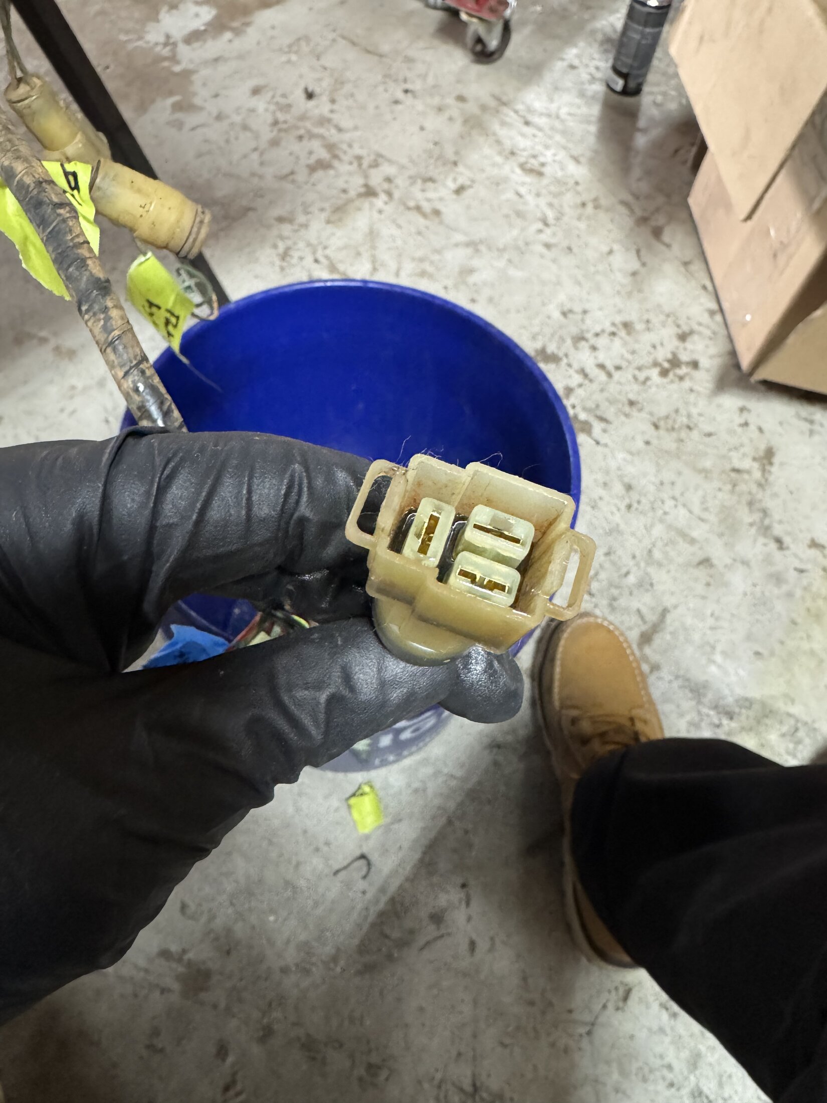

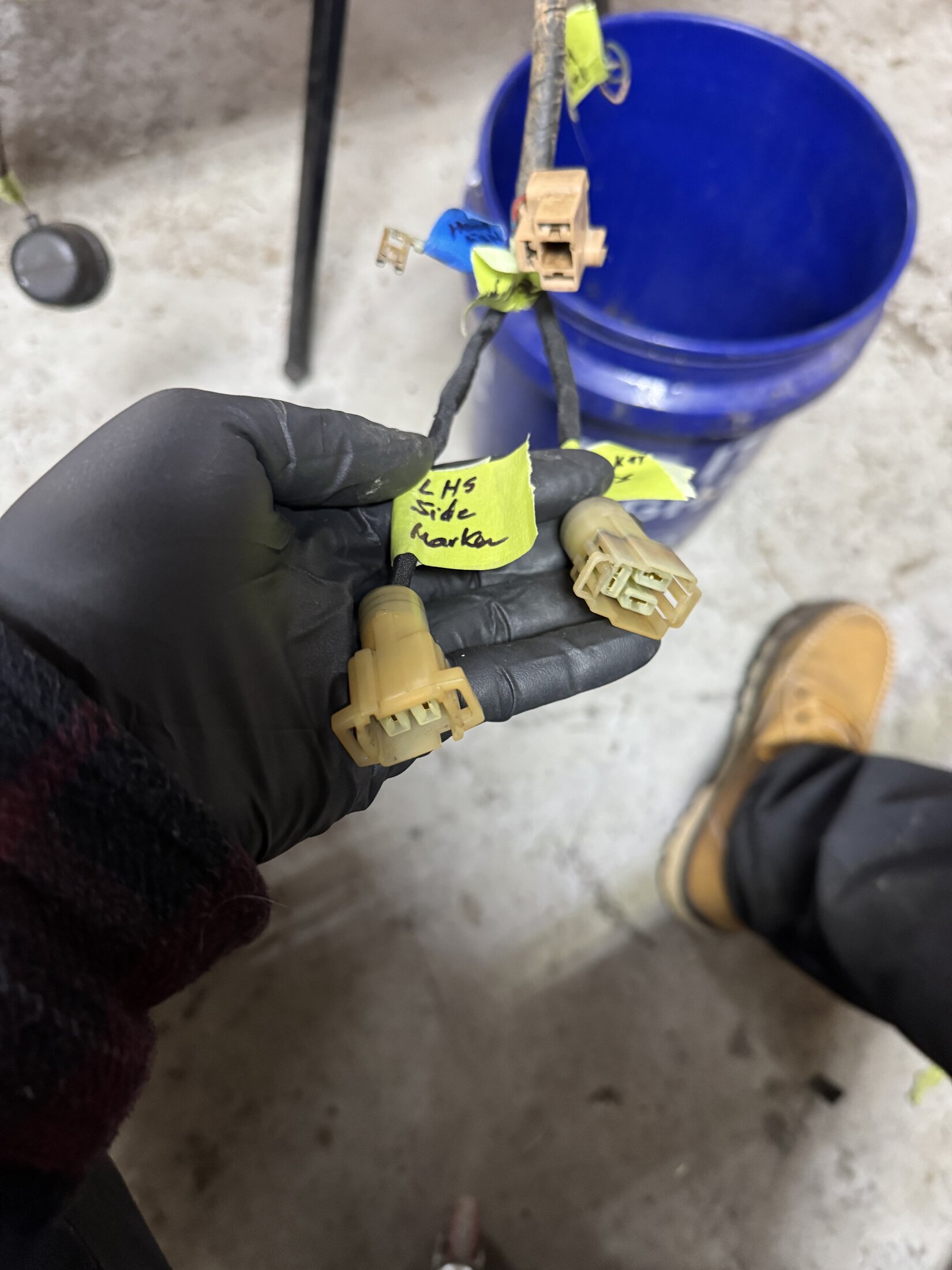

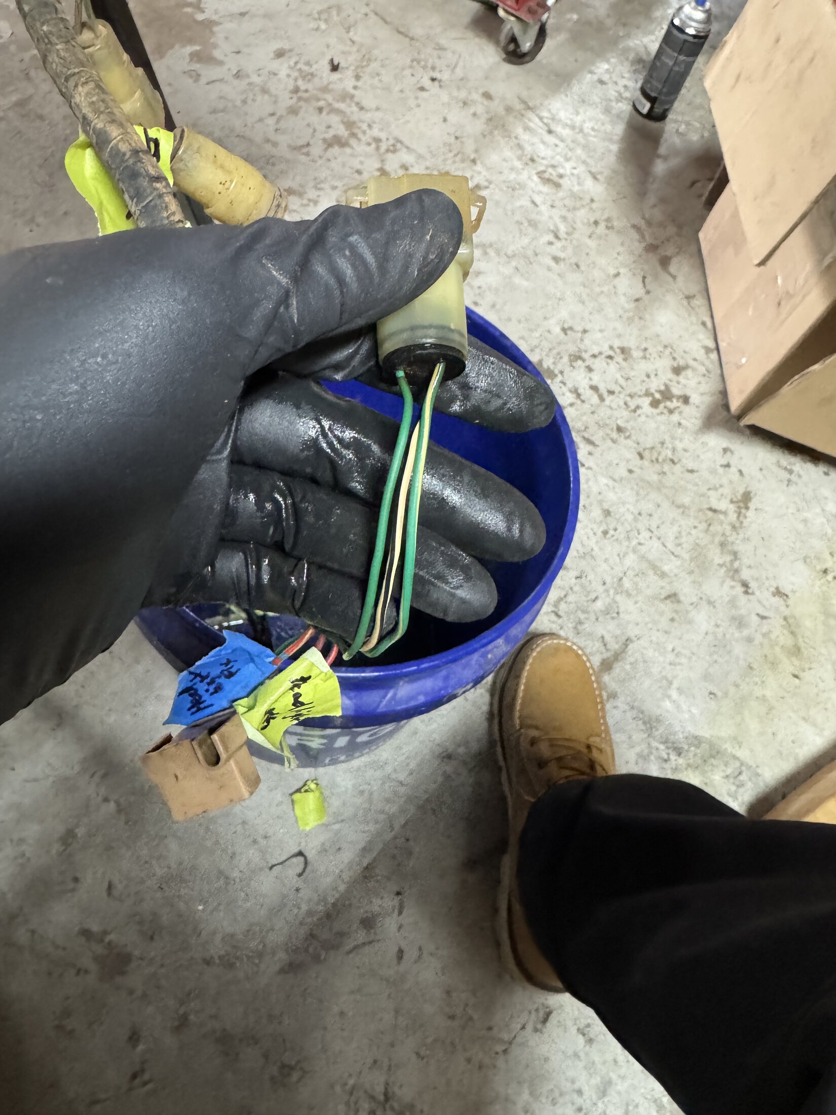

Having prepped LS standalone harness for custom layout. Next was prepping the 12v FJ60 harness for transplant. I bought a complete 12v harness from a late model FJ60 to install into Rootbeer because it has a 24v harness. I did not want to “hope” it would work. One struggle I had was identifying all the connectors on the FJ60 harness. Searched on line and could not find much information. I have the FJ60 EWD but it does not show connector details like the fzj80 EWD. Called @CenTXFJ60 for some help. Luck would have it that he is working on a FJ60 with the dash apart for some work. In about an hour I was able to get all the connectors nailed down. This would have been an impossible task otherwise without a 12v gasser 60 in the barn. What luck and what generosity to take some time from his day!!! Green taped label pics show the connectors identified compared to pics without. I will take detailed pics and labels so that others can benefit from our combined efforts. One step closer.
Need to find some good connector cleaner and “emory paper” to refreshen connector tabs. I bought a 12v supply to test all the circuits for continuity before I install.
I will also remove old loom and reloom.
I am thinking of leaving unused harness connectors uncut so it stays original but hide them. Going to ruminate on that.

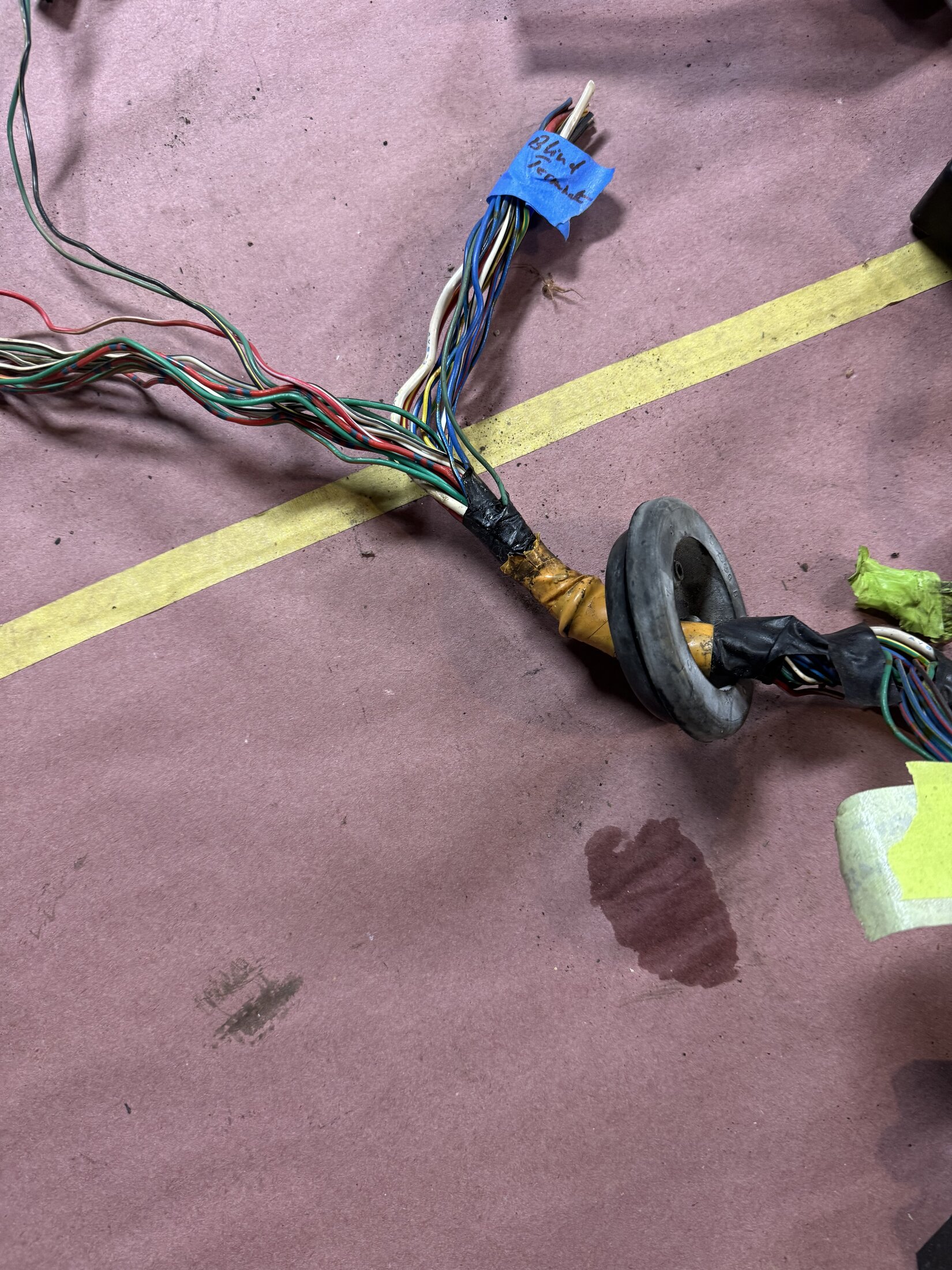

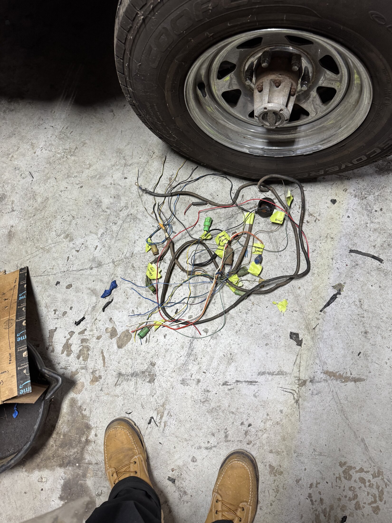

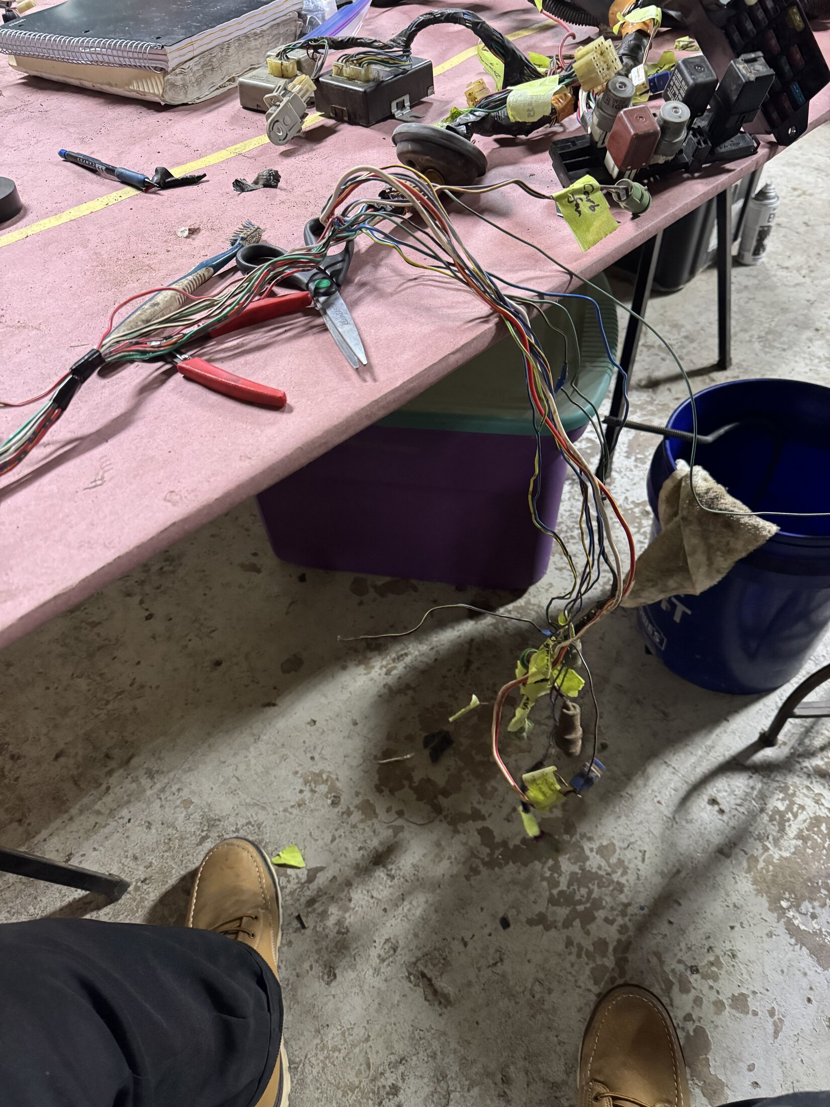

Thinned out the 60 harness on engine side of firewall.
On the DS:
- all smog connectors
- temp sender wire
- AC idle up
- Idle cut off solenoid
- Headlight washer wiring
On the PS:
- alternator plug/charge wires
- Coil wiring
- Oil pressure sender
- Distributor wiring
This wiring harness is in great shape. I did not unwrap the harness bundle running across the dash on the inside because TEQ has an awesome anti-shafing wrap. It is far superior to Tesa tape. So leaving it. I also decided to cut unwanted wire in the engine bay about 6” from the grommet. I am going to add butt connectors to each wire and wrap it up with Tesa tape. This gives me some flexibility if i need a wire. I can pick it up on each side of the grommets.

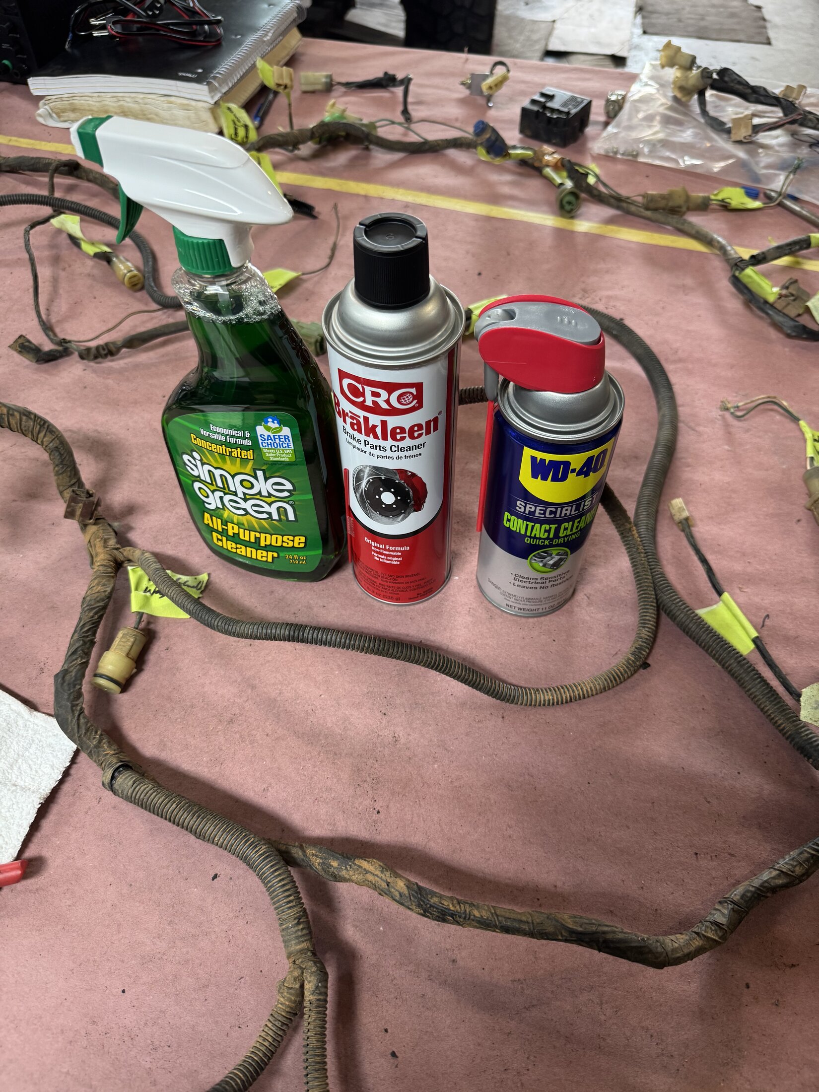

I went through all the harness connectors and made sure the wires were intact at the connectors and where corroded, pulled the terminals and cleaned them up. I used a regimen of simple green and brake kleen to get the connectors free of grime. Then I flushed all the connectors with WD40 connector cleaner. This is a quick dry formula. I will see if I can get some dialectric grease into the connectors.
I will check the harness for continuity and short circuiting and voltage drop. Bought a bench DC power supply for this purpose.
