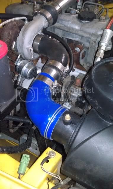

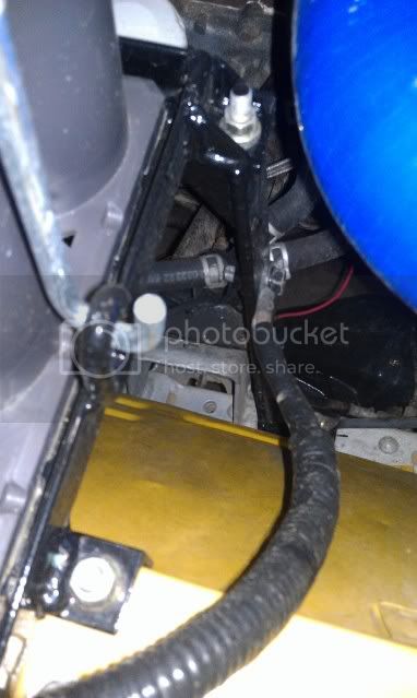

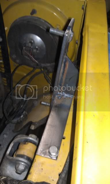

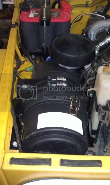

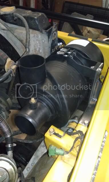

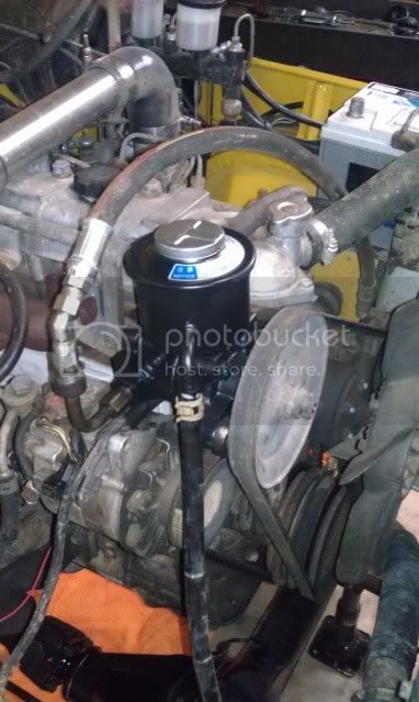

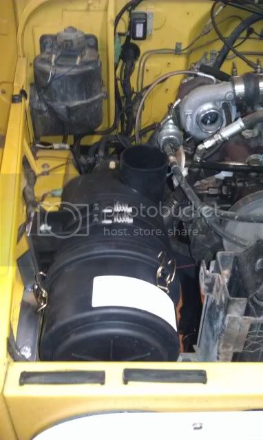

I havent updated this thread in quiet some time and have done a few things to the rig since last summer. The truck was in desperate need for a proper air cleaner, I had driven through some pretty significant dust storms leaving death valley while driving through Olancha and was litterally cringing at the thought of the flimsy filter i had at the time. Soo I made this custom bracket and mounted a Donaldson air cleaner. I had previously a remote resevoir power steering pump and i replaced it with a new toyota 3b power steering pump with the reservoir on the pump. This gave me the room I needed on the fender to mount the air cleaner. I welded the bracket and then powder coated.

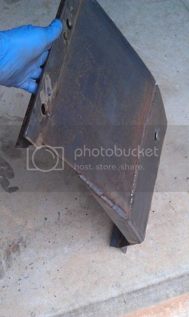

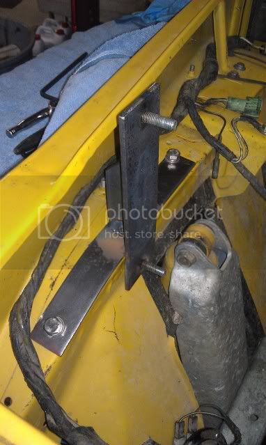

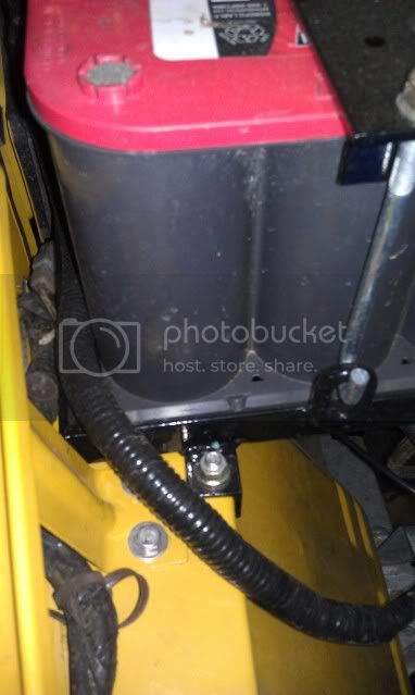

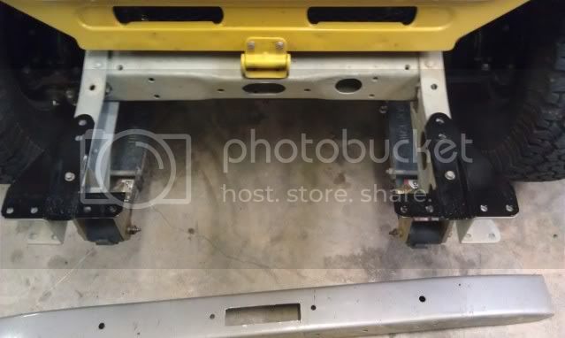

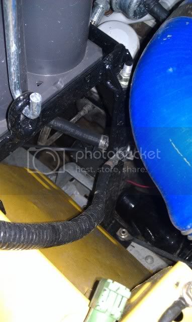

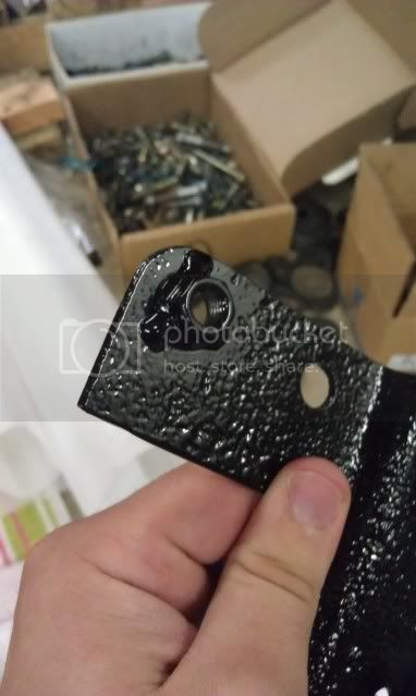

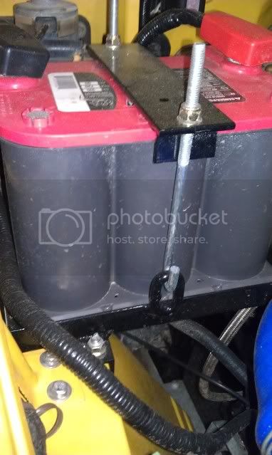

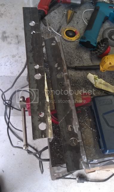

Next up I really needed a second battery to crank over the high compression 3b. Eager to try out my new welder i fabbed up this battery tray out of angle and flat strips of steel. I forgot to take pictures of it in process so these dont do it so much justice. I would have to remove the battery to get some better photos of it. It is a two piece design. There are two legs that bolt to existing holes in the frame and and a battery tray that picks up the fender and the two supports that drop to the frame. I welded captive nuts on the battery frame for provisions to attach a ground wire. I also welded a couple of chain links to the battery tray for hold down j bolts, and lastly i made the battery tie down itseld with a piece of flat and two pieces of angle. The frame is fully gusseted at all the joints so its extremely solid.

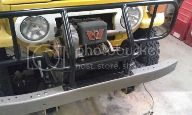

After this little predicament i decided i needed a winch. Two heeps pulling it and it still wouldnt budge. fortunately someone came by with a chain hand winch.

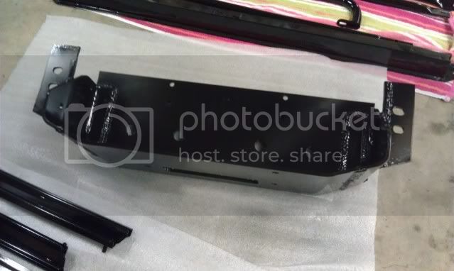

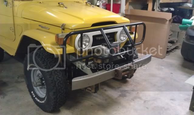

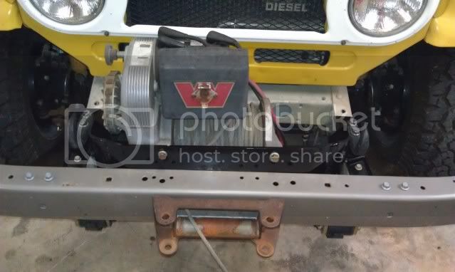

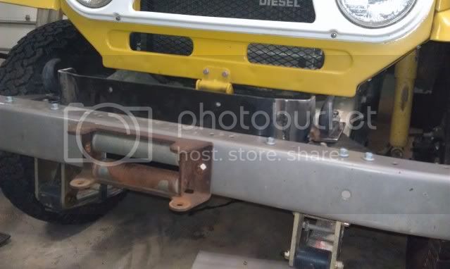

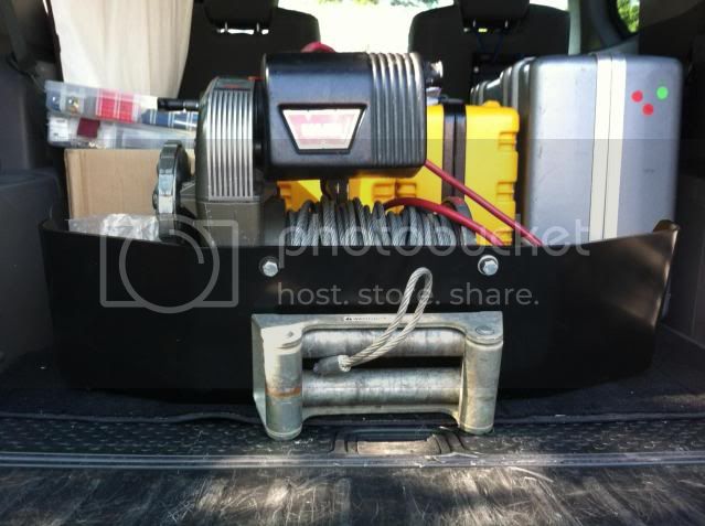

A friend of mine gave me this warn winch plate that appeared to have been designed for some sort of full size pick up.

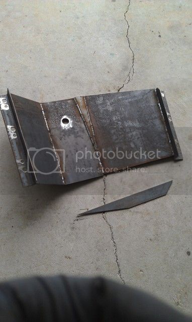

Sooo i started cutting
I came up with this

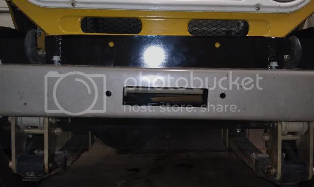

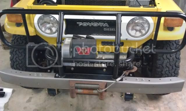

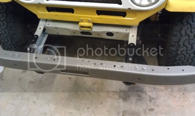

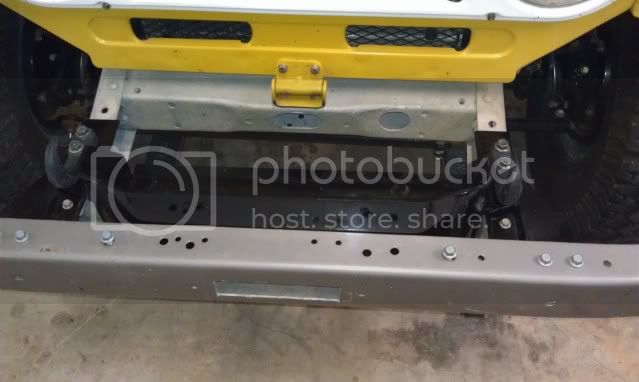

I wasnt entirely happy with this at this point because the winch is so tall it blocks a good bit of air flow across the radiator. soo back to the drawing board (or dirt and stick in my case) and i decided to drop the fairlead down to the front bumper. I cut an extra set of frame gussets i had laying around and cut a whole in my shiny new bumper.

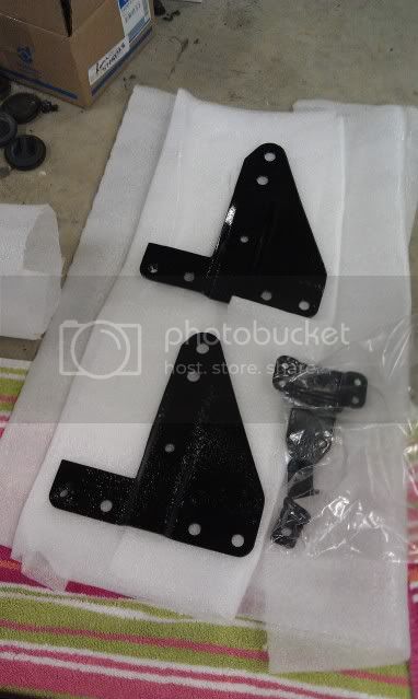

here it is finished and poweder coated

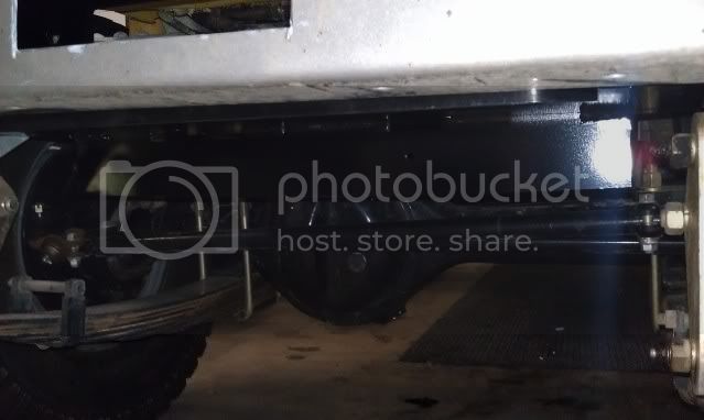

Next up im going to build a skid plate and refinish the rear axle and install my rear ubolt flip kit i got from dave (lcwizard). Also need to replace the radiator and make a proper fan shroud and install a/c before my next road trip in June!

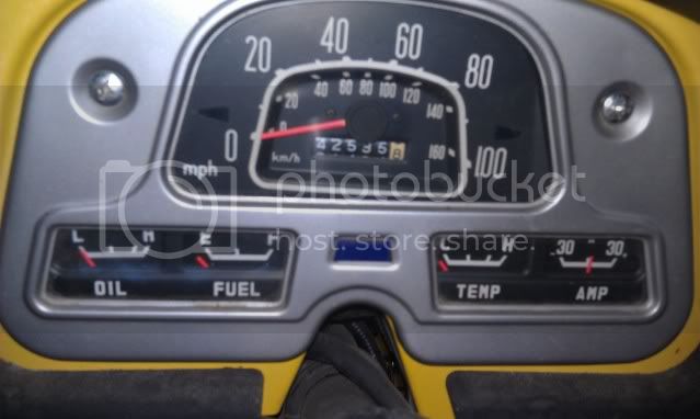

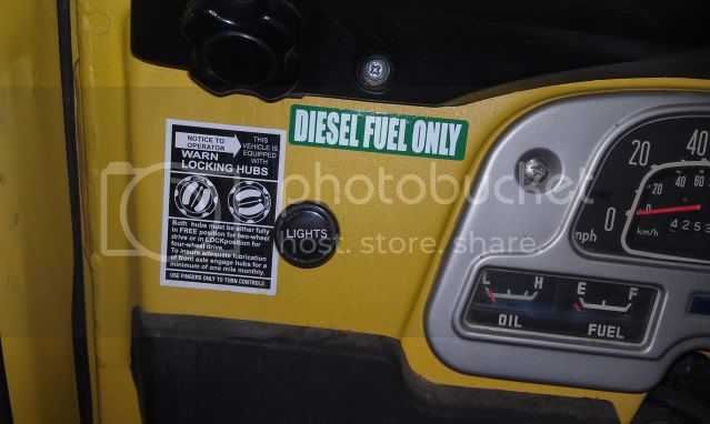

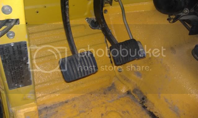

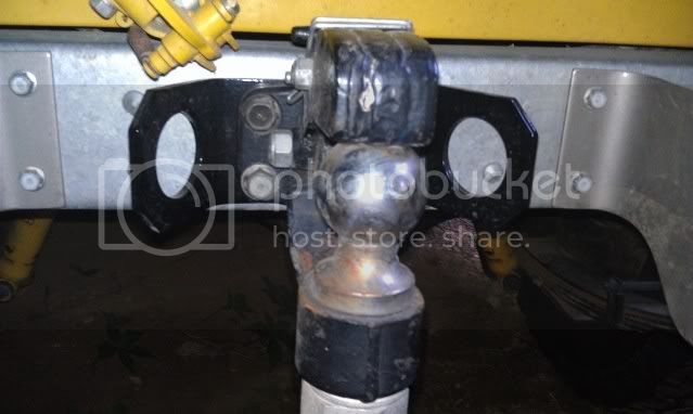

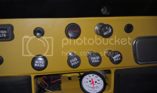

couple of more little things as well found a pintle chain plate powder coated and installed. Refinished my pull knobs, painted my needles in the instrument cluster, new peddle pads and put this sweet sticker on :)

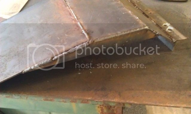

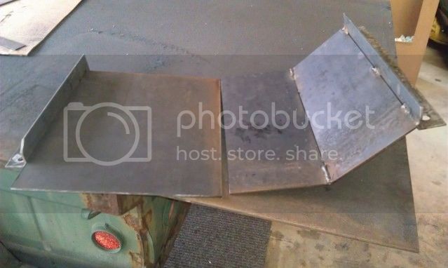

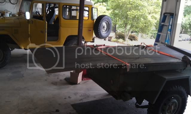

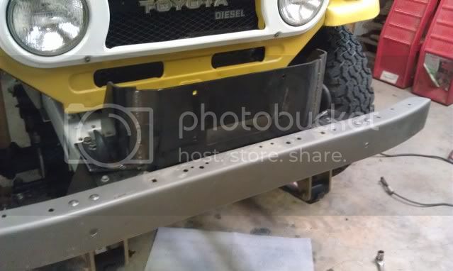

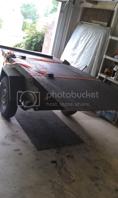

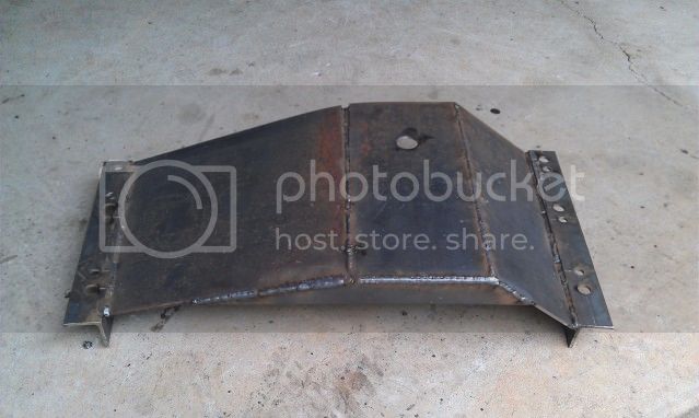

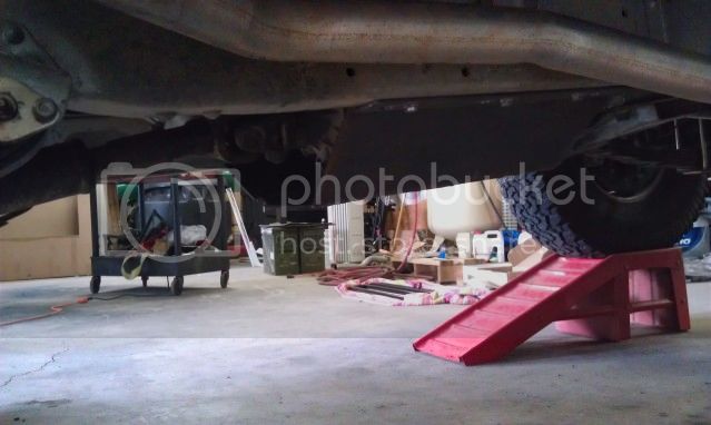

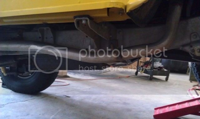

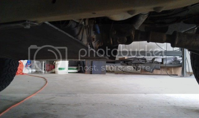

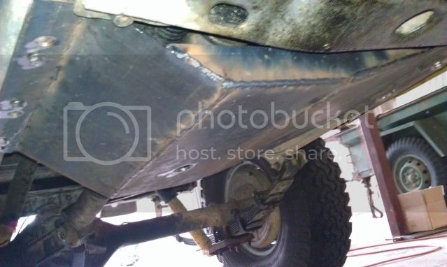

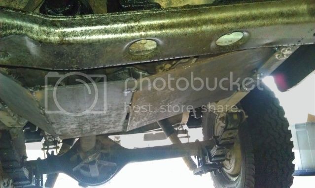

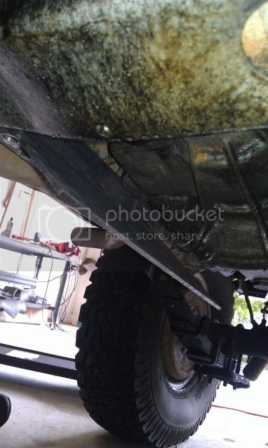

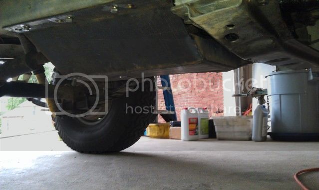

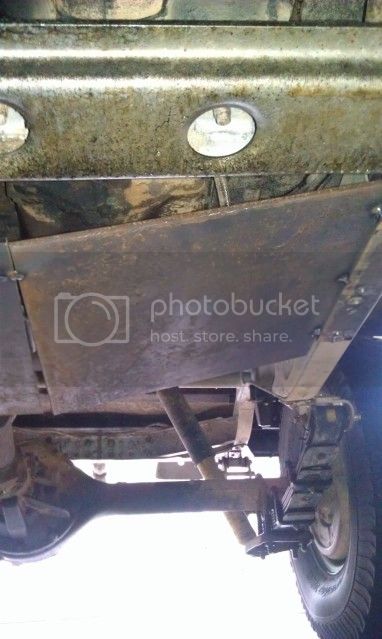

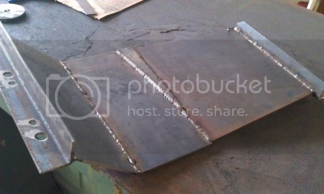

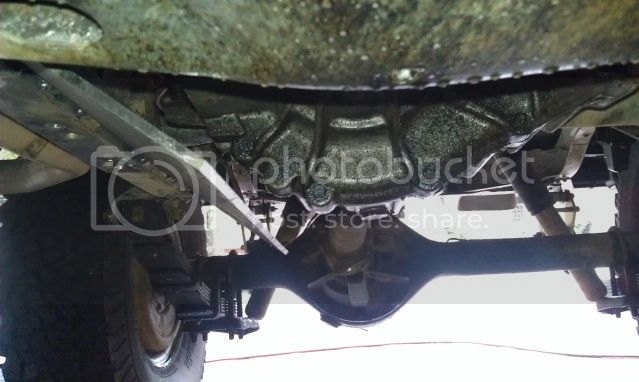

picked up a sheet of 3/16 plate for my skid plate and to make a new floor for my trailer.

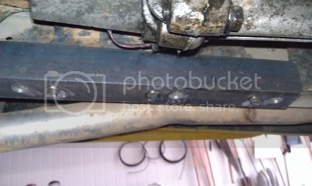

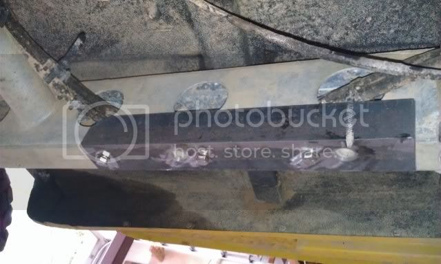

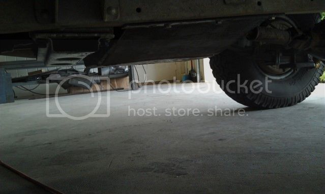

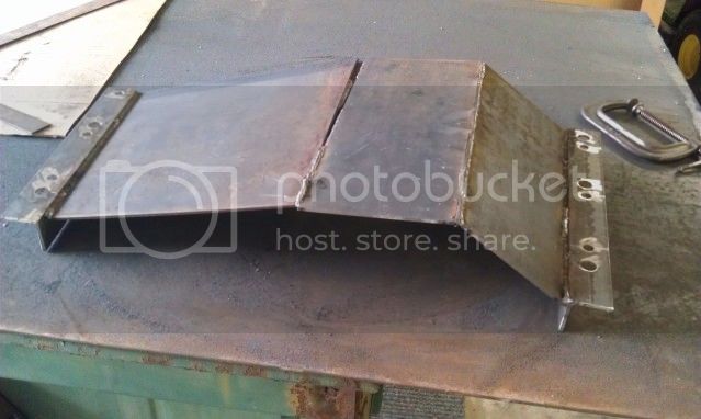

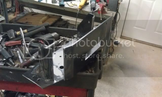

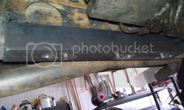

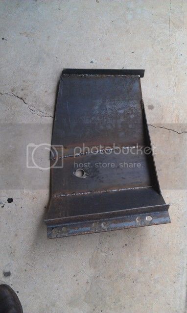

I also picked up some 2'' 3/16 angle and cut it to the length of the skid plate and drilled holes in it to clear the rivets on the bottom of the frame and bolt on using the original pick up points from the factory skid plate.

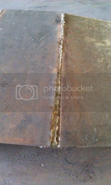

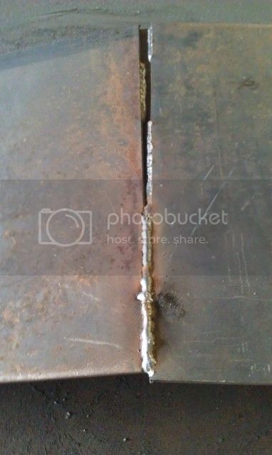

Here is the first plate tack welded in place.

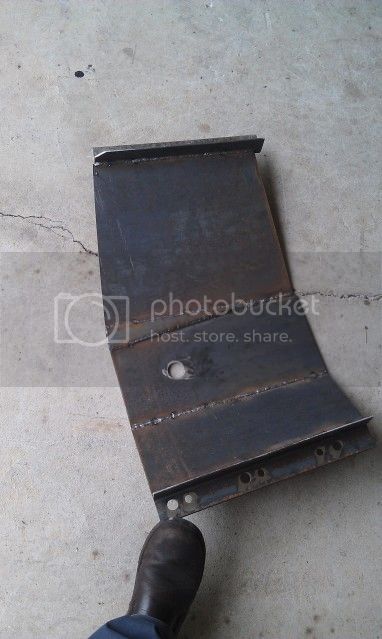

Two more plates tack welded on.
man those last few pictures turned out horrible. It's done at this point i just need to pull it back off when the next batch of powder coated stuff goes in and get it coated. Im really happy with the way it turned out because of the angle and direct impact from the bottom is going to push on the insides of the frame instead of just pancaking the skid and shearing the bolts. Im pretty sure i can lift the entire rig up with a jack underneath the skid.
