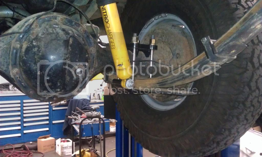

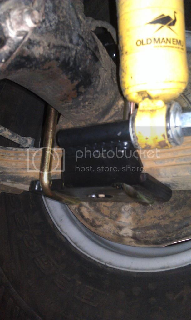

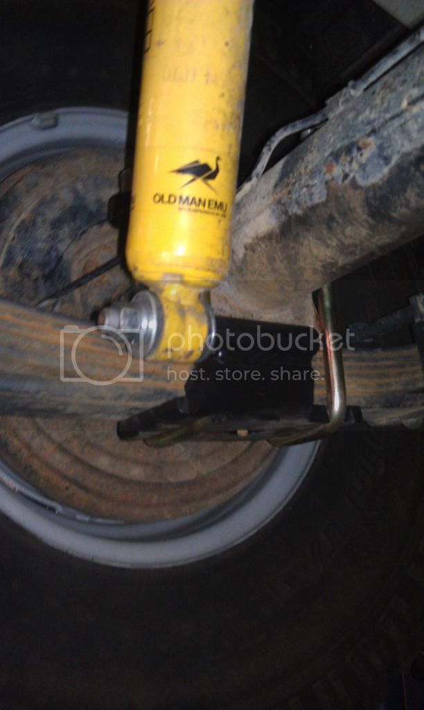

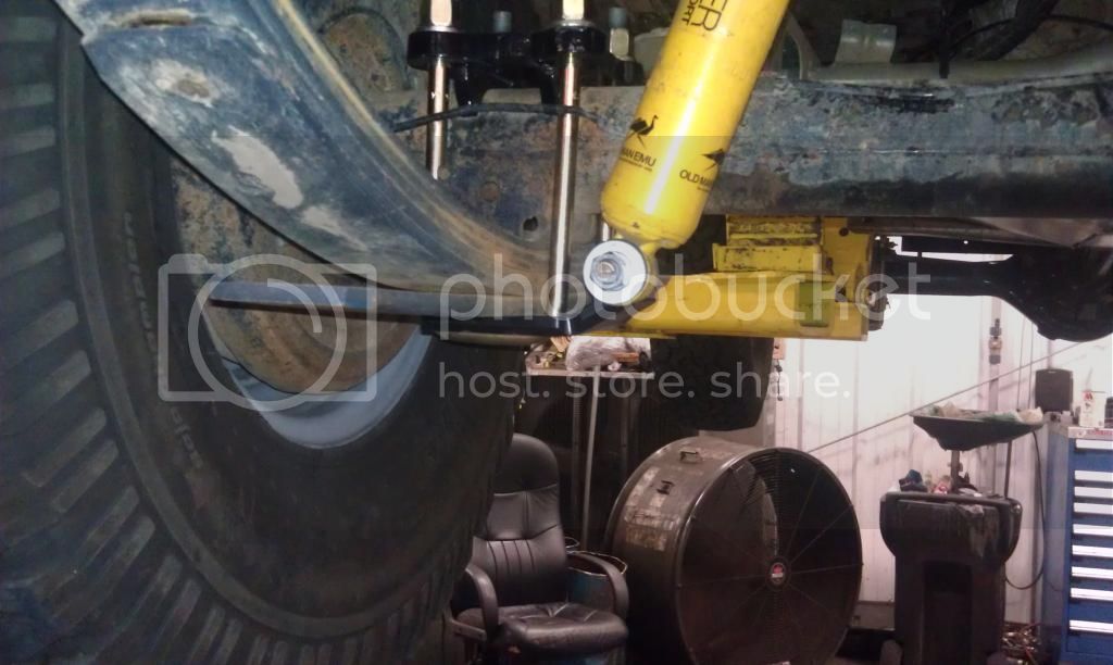

The u bolt flip kit gives it a bit more ground clearance because the u bolts are the lowest point on the under carriage underneath the axle and often get hung up on obstacles. I actually got hung up on a tree root myself recently before I installed these and had to be given a tug to get moving again. I haven't experienced it but apparently its not uncommon for the them to even be sheared off on the trail.
