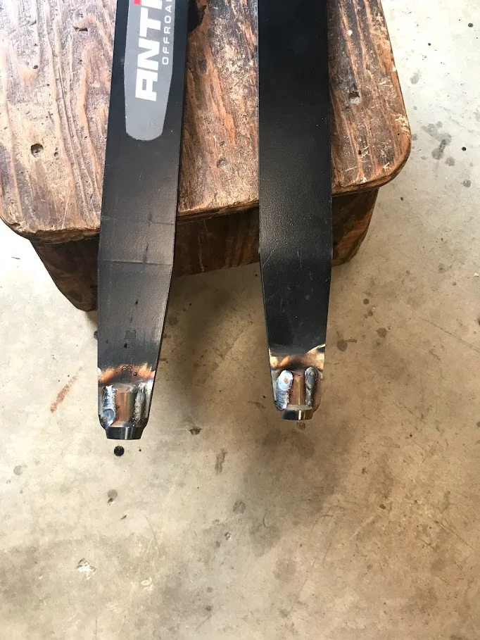

Yes and I’m pretty sure this is the kit although I ended up cutting the arms down to 18” to match the length of the arms on the stock bar. I then notch the forward end of the bar and welded a threaded bung with hole facing forward same as @Broski. Doing this made it easier to fit the package into the limited lateral space.

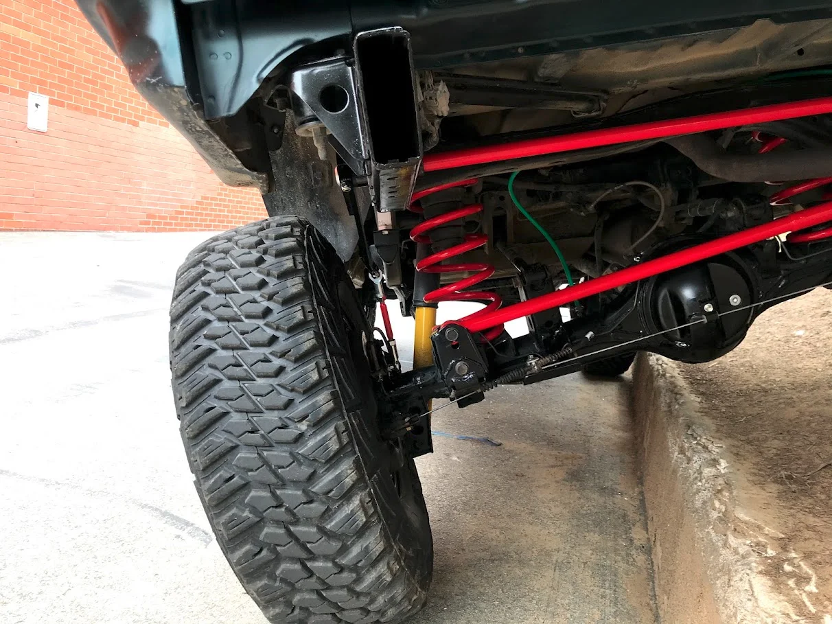

Here's my set up

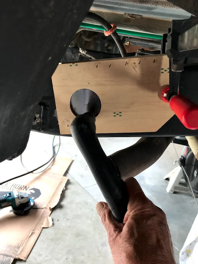

Testing for clearance
Frenched through the frame.

Bungs welded in the arms, it's really tight between the frame and tire.

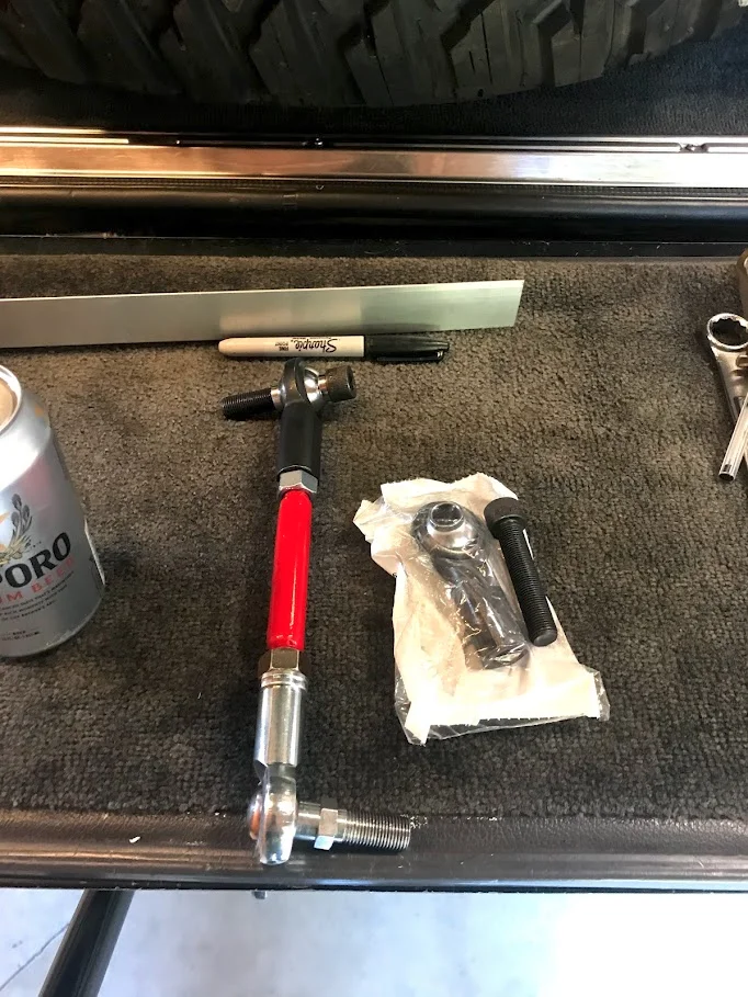

Shortened and sleeved links
I can't remember the numbers but the heim joints that came with the kit were binding at full articulation so the upper ones were replaced with one's with 55* of miss alignment if I remember correctly.

In short a lot of Fab work to get it to work on a stock set up but totally worth it :cool:
