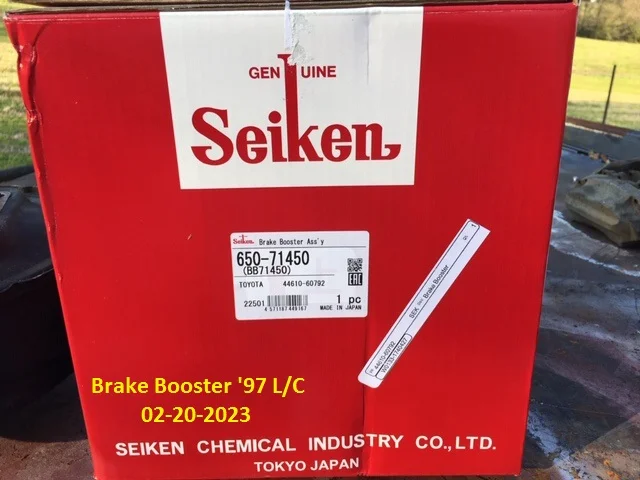

Depending on your diagnosis, I have Seiken boosters and Advics (subsidiary of Aisin) MBCs in stock. They come with a 2 year warranty. I haev a lot of people buy both and tackle the system at one time since these trucks are 25-30 years of age and a lot are still on their original units. Buy once, cry once as the saying goes. It's better to be proactive than reactive IMO, especially when dealing with critical parts.

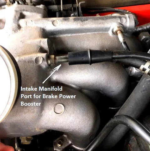

Classic Brake Booster (failed or failing) symptoms, but check the vacuum at the supply line first, next the grommet and check valve on the booster, if all checks out OK....declare it dead and replace. Use the Seiken model.

Thanks to all and advice about the pedal assembly saved my ass. Did it myself in about 2 1/2 hours. Had a bear of a time getting past the manifold then had to readjust the brake assembly to allow the 4 studs to go through. Shout out to ARCTERYX for his quick response and shipping. Did not even order until late Monday and had part in hands Thursday. New SEIKEN fit perfect and came with the two gaskets. Brakes are back. May do rotors and pads next. Put it behind me.
