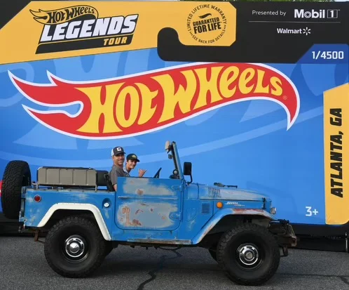

Planning on taking my 40 probably 100+ miles. What would y’all recommend changing out/ checking before we go? Changed the oil already. Need to be able to make it home at the end of the day.
A AAA card? A chase vehicle with tow strap? Seriously though, hard to answer without knowing anything about your 40. 100 miles isn't far so If you're worried about it making a 100 mile trip then maybe you shouldn't take it.
For 100 miles and close to civilization just the basics in my opinion. 100 miles in the middle of nowhere is a whole other story. Agree with @WarDamnEagle but I always find it useful to keep a socket set and wrench set with me. Fuses are always a safe bet. Looks like new tires and wheels so make sure you have something to tighten lug nuts just incase.
