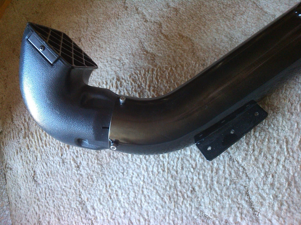

What are the right sort of rivnuts to use in the a-pillar to fix a custom stainless snorkel to the body with?
There isn't really any way to easily create a 'nutplate' to fit inside the complex curved a-pillar, and last time I checked I figured it would be difficult to use regular nut and bolt fastening methods since there isn't an easy way to manouvere nuts and washers inside the back of the a-pillar.
So rivnuts seems like the only workable option.

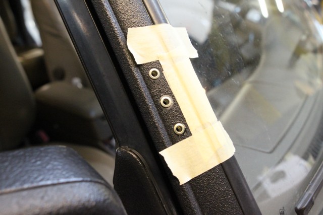

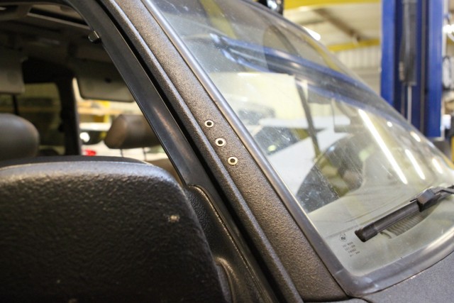

While id normally agree with the above in my experience the snorkle moves too much in relation to the A pillar ( or maybe its the Rhododendron :D ) but the rubber well nuts did not last in this application for me. on the 3rd try i went with the standard metal rivnuts like above and used a tool to install after painting the hole and adding a bit of sealant which wiped away easily after it displaced once the nut was fixed.
actually that mcmaster page has a few cool hybrid options.
cannot link individual styles but check out the metal with a rubber gasket variety for thin metals
I have to defer to Jason, as I don't have a snorkel on my 62 and have never installed one. If you have never looked at mcmaster, it is a great source for all kinds of hardware. They ship quickly and the 800# is very helpful.
What are the right sort of rivnuts to use in the a-pillar ...
The A pillar is pretty thick, we have drill and tapped. That way when it gets ripped out, have the option of going to a larger insert.
If you want a Riv Nut that will seal you could go with some Well Nuts, they install just like Riv Nuts do.

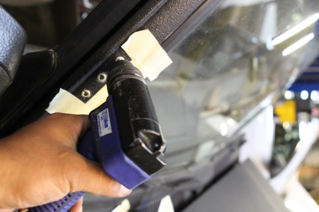

Also, what's the best way to 'set' them? I do have a rivnut setting tool that I found through an Ebay seller but it's not like a rivet tool.

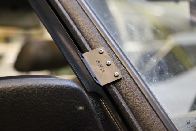

I have a few pneumatic guns for installing them...
Gallery
FZJ80 Dorkel Install — Postimage.org
